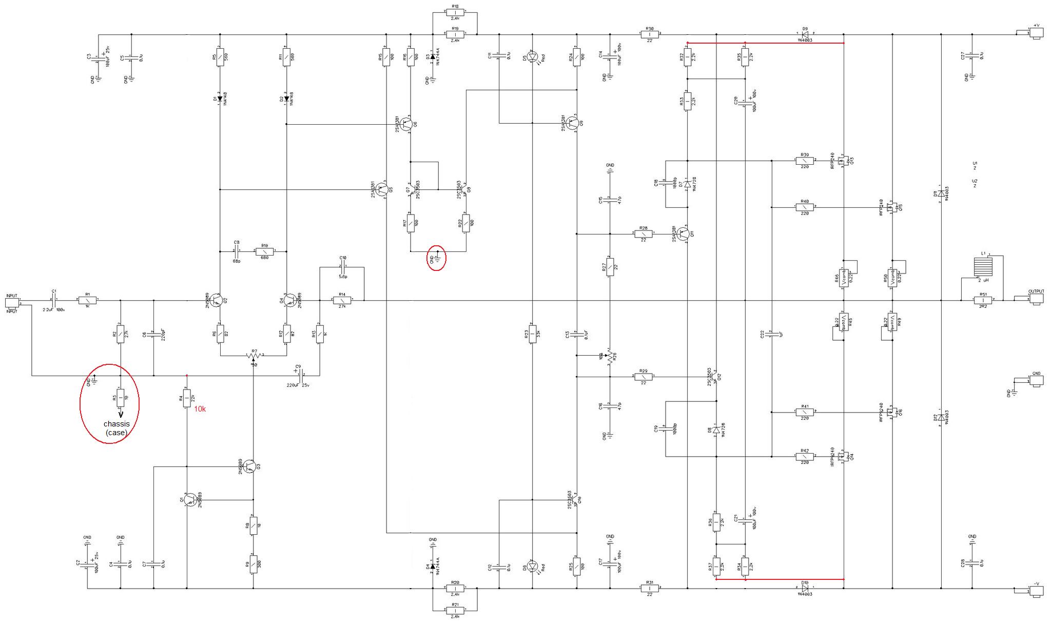

Some observations.
A (little) part of the output is on R3 via the feedback.I don't like that.
C14 and C17 are charged by the bootstrap since decharge is prevented by D9 and D10.There voltages will go up with the output level.
And other little things 😀
Mona
Mona, thank you for the comments.
I like the point with regards to the diodes and - connecting the bootstrap circuits your way make a lot of sense.
R3 - normal lifted ground. The feedback is high-impedance enough, so 10 ohm does not really hurt. Anyway - in case somebody does not like the lifted ground - R3 can be shorted.
Connecting R17 and R22 to the ground is not a good idea for a number of reasons:
- I'd like the power consumption of 15V parts of the front-end being the same;
- CE voltages and power dissipations of Q5 and Q8 must be the same for the best result.
Valery
Did you fit the bypass cap to the drivers' collectors?
Good one. I didn't try it like this - will play with it in the sim and see.
In this topology, the drivers' bases are rather close to each other, so their BC voltages will appear rather low...

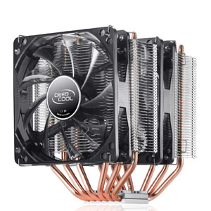

You might want to try simple fan attached to a much smaller heatsink - like a CPU cooler. They can achieve some dense cooling. The noise of fans bothered me but I find adding a 100R 2w resistor in series with 12v fan allowed it to still work well with regards to hear removal but be inaudible. Here is an example of two VSSA boards being cooked by single tiny heatsink and pair of fans. Heatsink barely gets warm. A larger sink and larger fans might work very well for your case. In the end costs less as huge heatsinks are expensive big and heavy.
I have it blowing through edges here but also works well with screwed directly to sink face.
But if we take anything from the PC industry - that is use of heat pipes and fans for best heat transfer. Heat pipes are the highest heat flux devices available - when properly designed can have up to the same flux (per cross sectional area) as heat from surface of the sun (!).
6 Double ended heat pipes and dual fans. This looks like it could fit directly to one IXIS.

Fans help immensely with cooling, but are noisy. I plan to mount these in the back of a pair of subwoofers that are going into my home theater system, so fans are out.
That was my point - add a resistor between 12vdc and fan to lower speed until inaudible. It's amazing how much cooling is still left at this point. I can't hear my fans.

Some observations.
Mona
I have checked the situation with C14 and C17 - their potential is not dependent on the output swing. At high swing (clipping) there is subtle modulation of the voltage at C14, C17 - some 25mVp, not an issue.
The current through R32 || R35 and R34 || R37 changes direction, but has the same positive and negative value, keeping potential at the rail unchanged.
