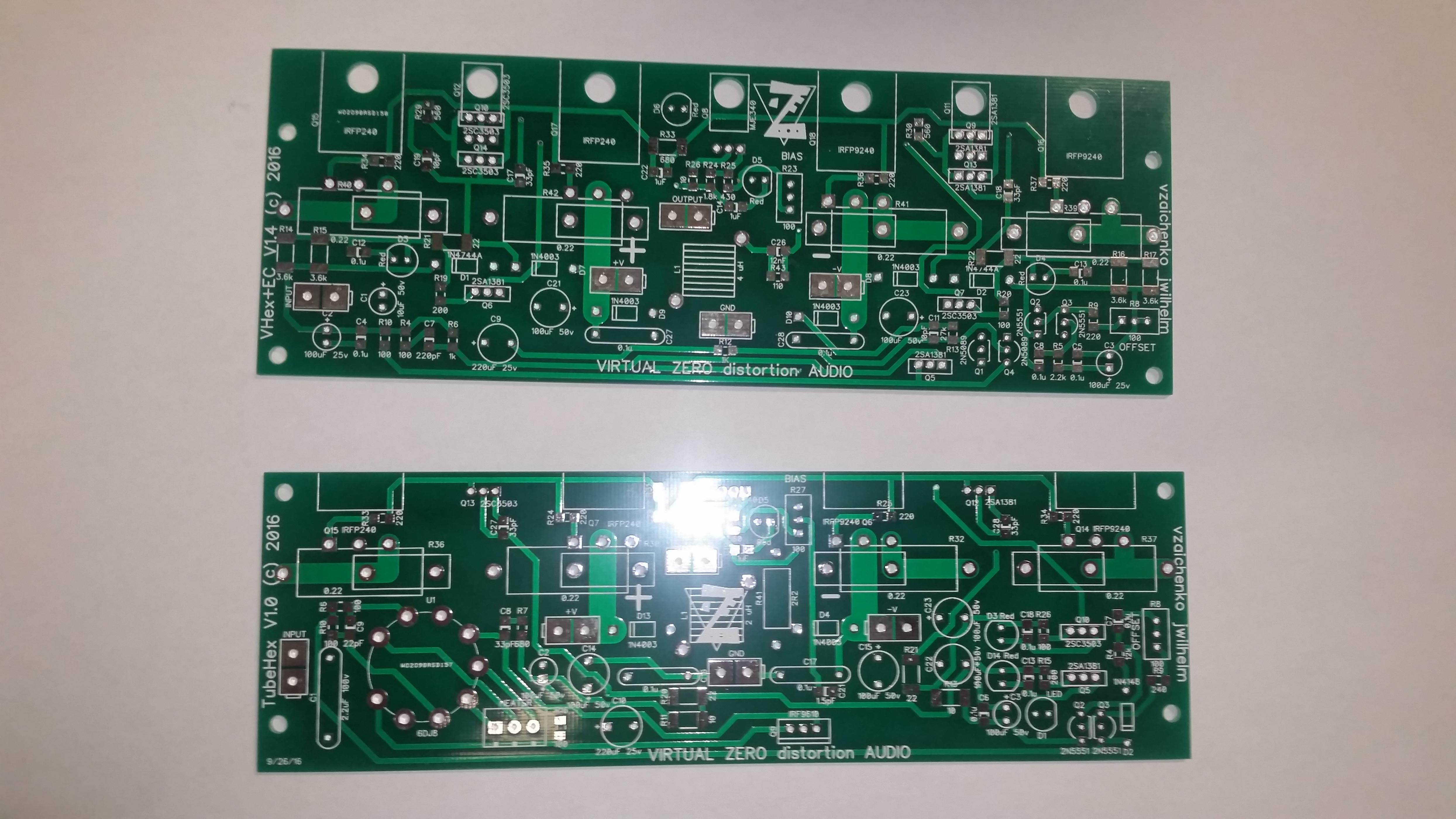

Nice boards!I've just received a couple new variations of the VHex for testing. Tube Hex and VHex+EC are waiting for assembly.😀
Looking good Jeff!

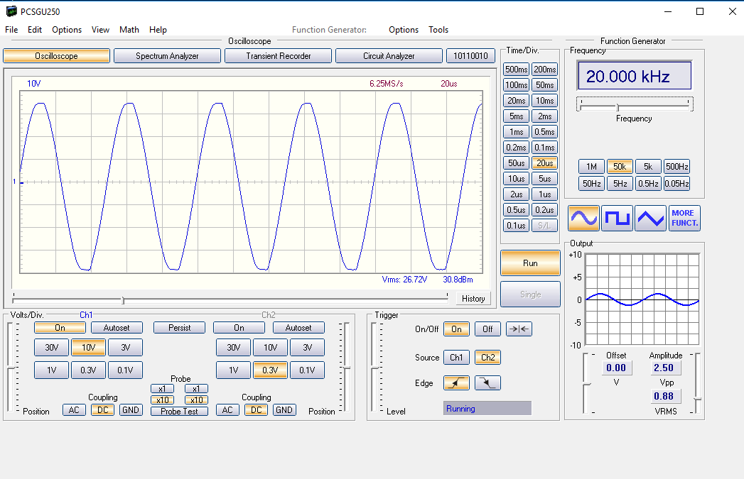

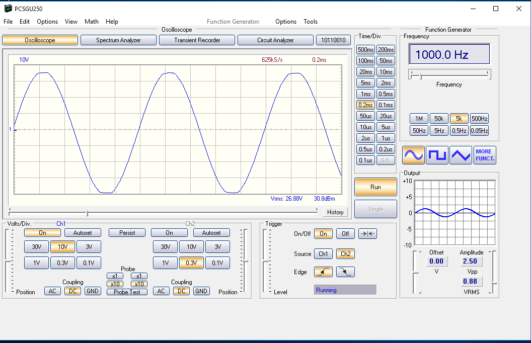

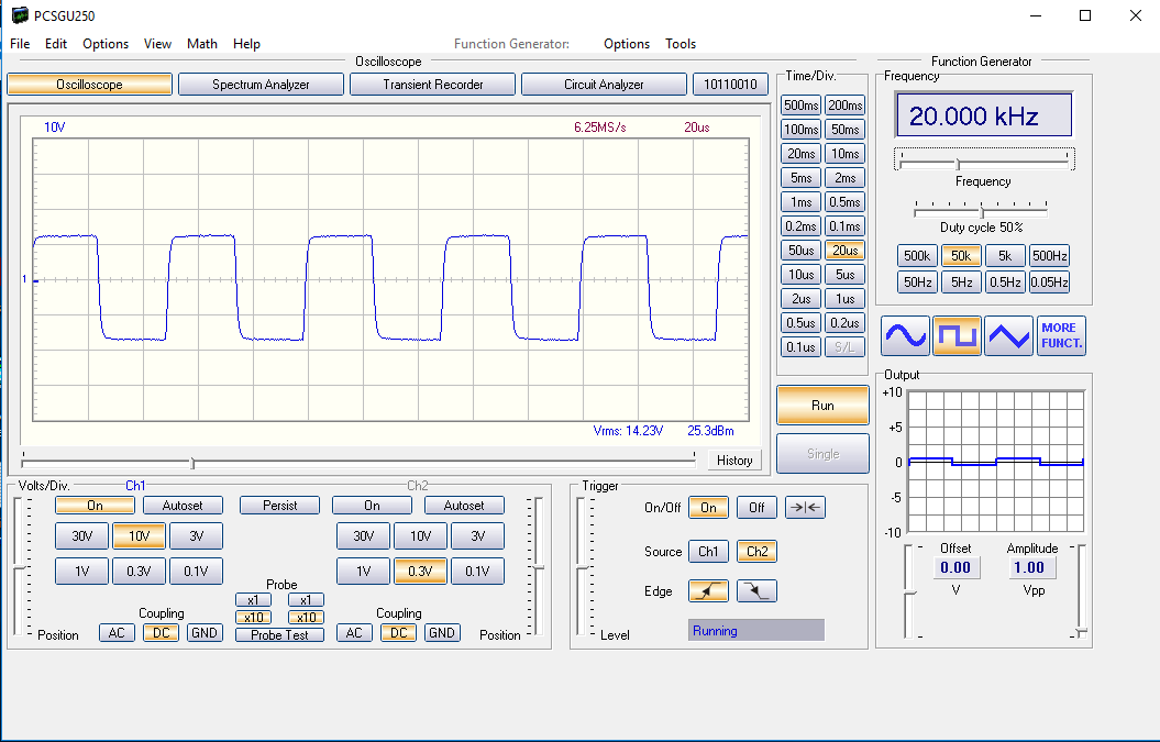

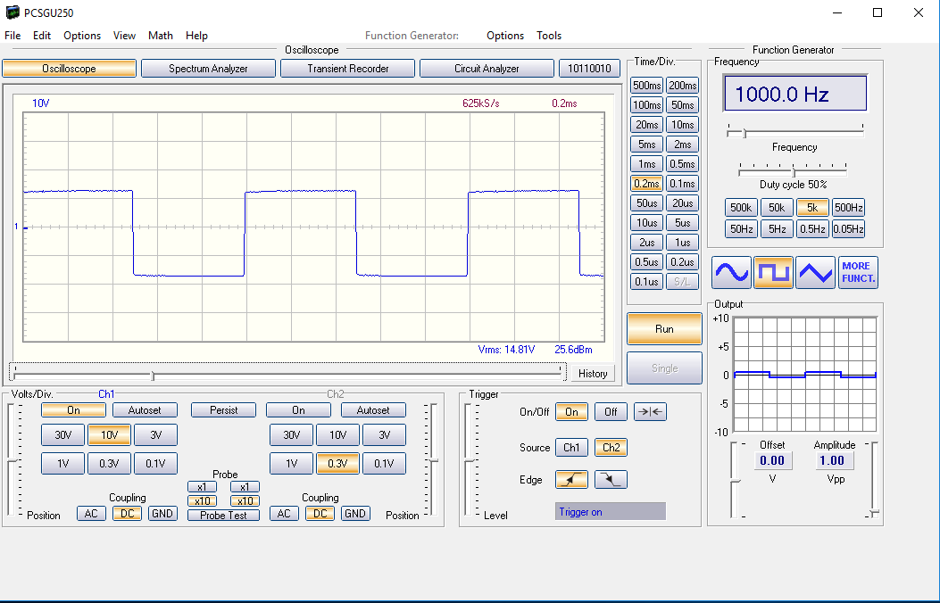

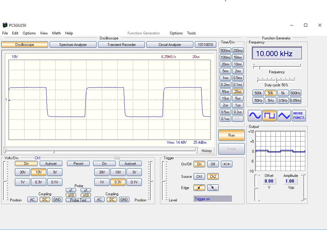

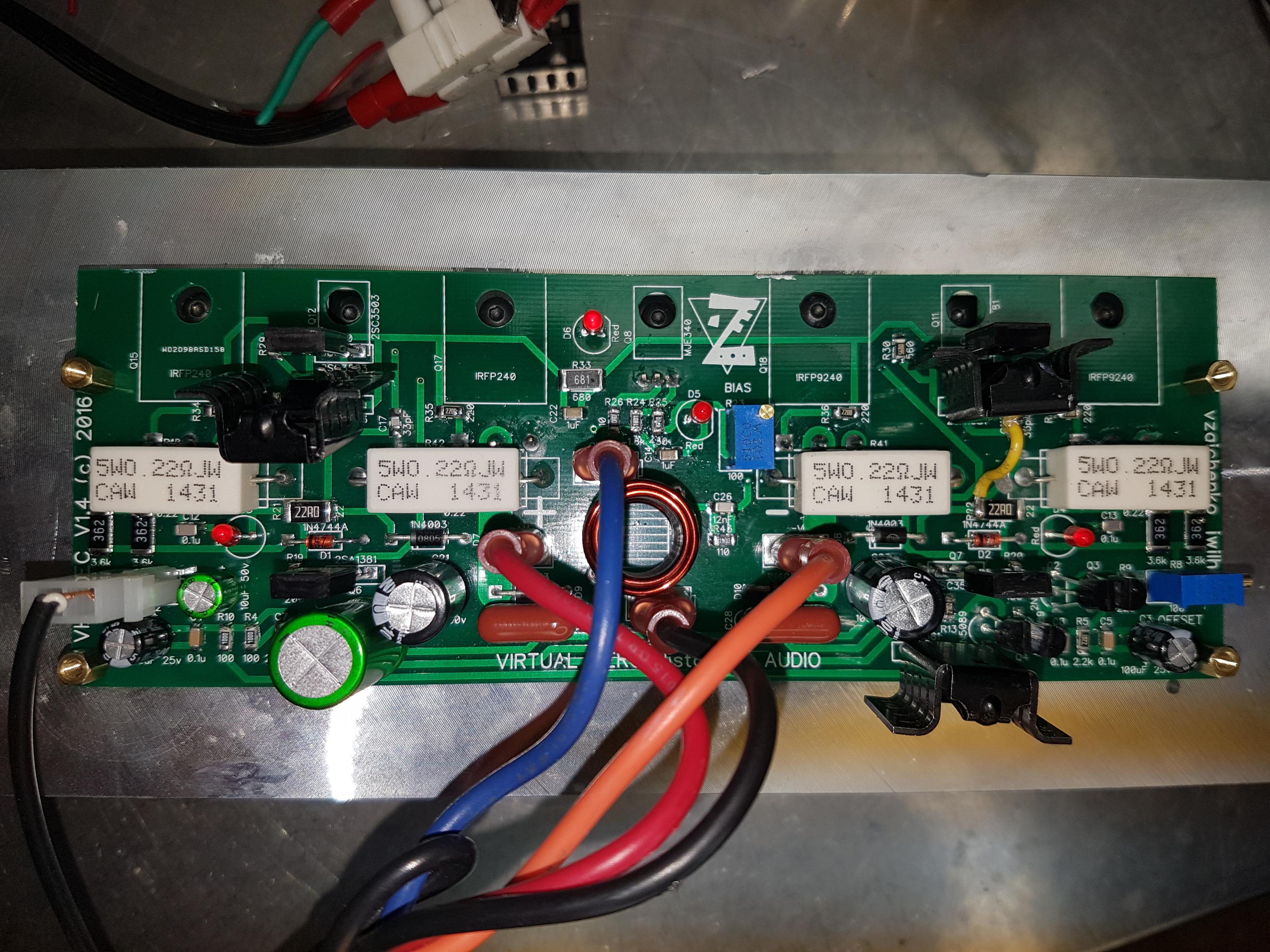

I've had some time to begin testing the VHex+EC. After a couple hiccups in assembly it's up and running beautifully and sounding excellent. It's very stable and the bias drops very slightly as temperature rises. Clipping is nicely rounded at 85W with +/-48V supplies and an 8 ohm dummy load. Here's some initial test results.
Board look really nice, I especially like how bundled together the cables are. A question regarding the messurements: is it normal that in each one +V and -V aren't of the same value? For example (if I interpret the reading right) in the first pic you have a max of +35V but a min of -40V
Good looking board!
Is there a schematic to accompany this board? Apologies if already posted earlier in the thread.
The zero line isn't centered on the scope screen. Output is + & - 26VRMS at clipping. The scope I use for initial testing is a POS USB scope because it's quick and easy. Proper testing is done on much better equipment.
Ah, I see. Thanks for explaning.

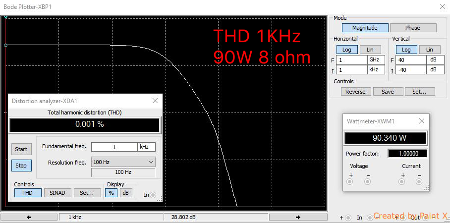

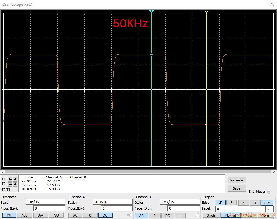

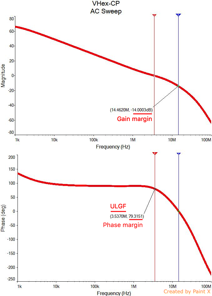

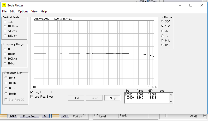

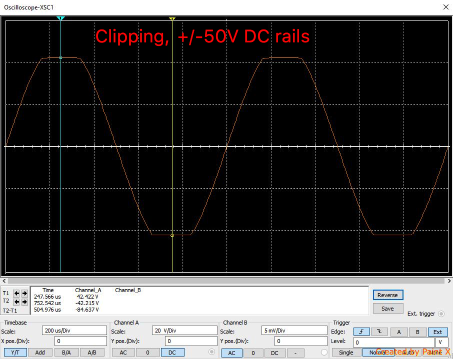

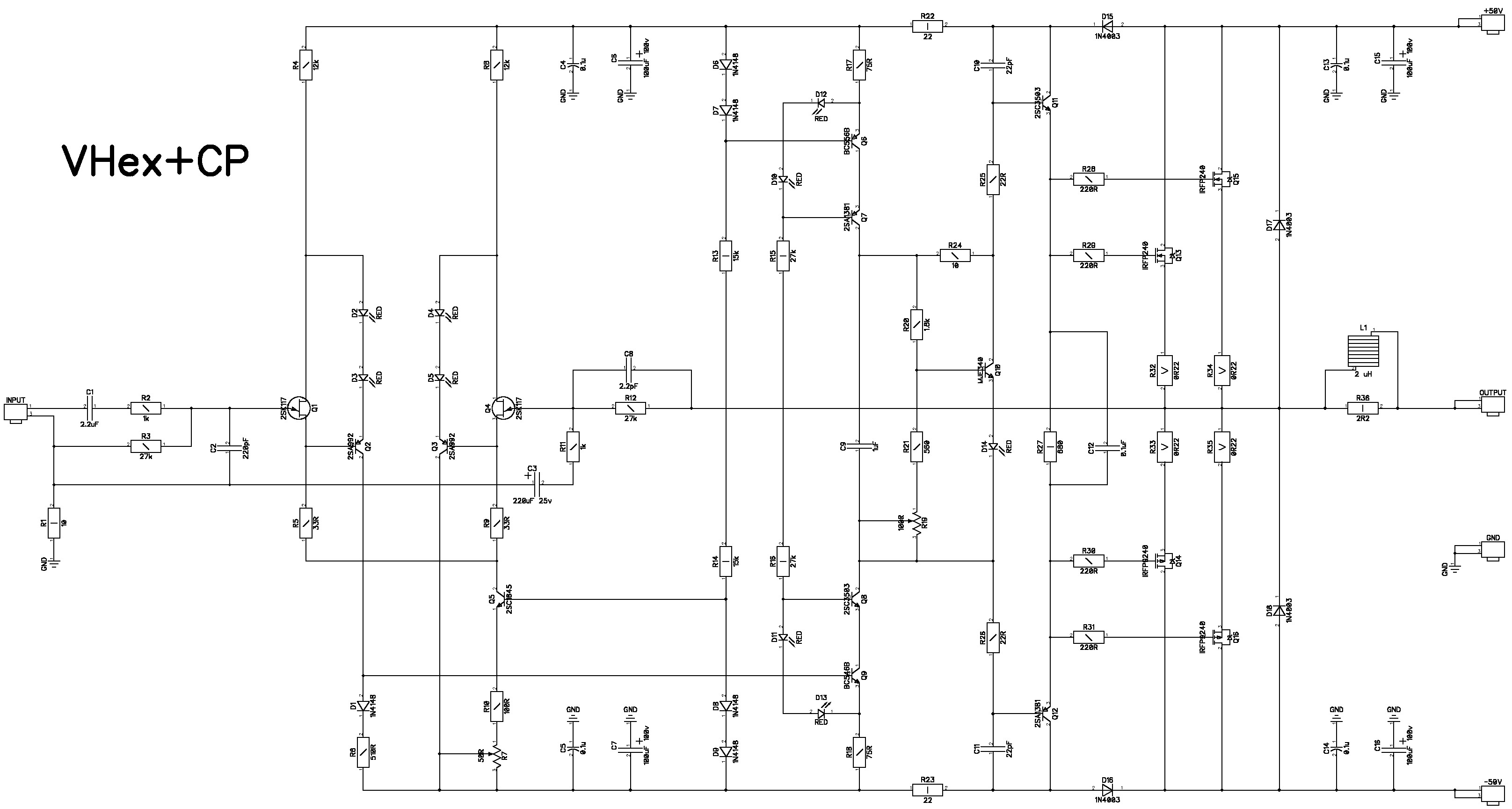

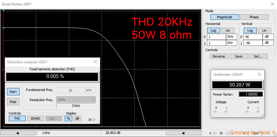

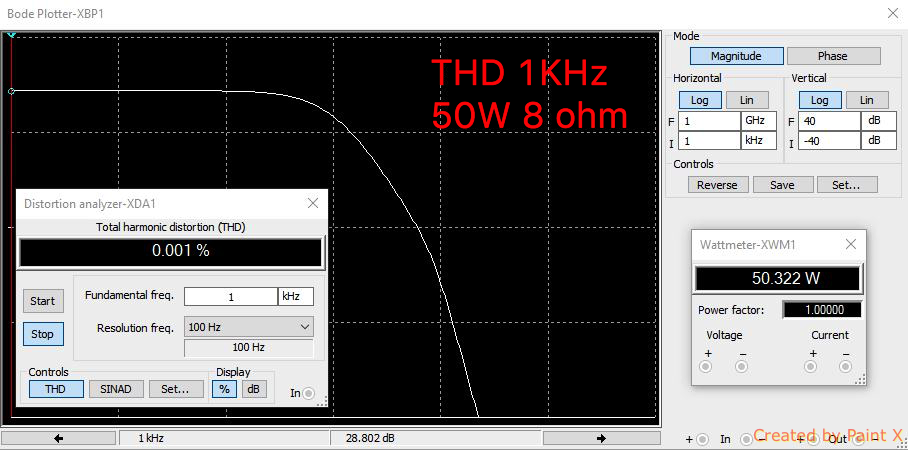

Current Drive + Constant Power
Hi All,
I'm continuing thinking in the direction of combining the principles of current drive in voltage amplification and as-close-as-possible-to-constant-power operation of IPS and VAS stages.
Attached is a new design, based on these principles.
V-to-I convertion in the input LTP, then current scaling with the mirror, then I-to-V conversion by the common-base cascode, loaded by a high-quality CCS.
High linearity and low phase shifts in every stage allow very light, simple compensation - a little bit of shunt at the VAS output (22pF || 2), plus a small lead capacitor (2.2pF) as part of NFB network.
OPS can be built with a single output pair, although I prefer two pairs for safer operation at lower-impedance loads. 100mA of quiescent current per opuput pair is enough.
Clean clipping, good step response, low distortion and excellent harmonics profile are promising delicious sound in a good build.
Valery
