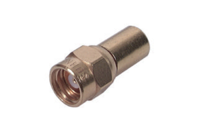

I think that's the SMA connector.
What is an SMA Connector? | Wellshow -RF Connector, RF Coaxial Cable Assembly, GSM, GPS, WiFi Antenna Manufacturer
The performance is even better than u.fl and is also very easy to source.

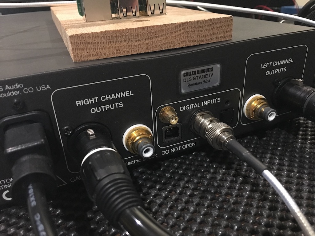

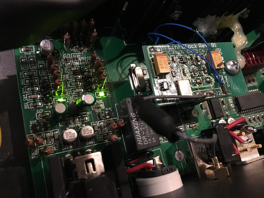

Hi, i am using Raspberry Pi 3 + Rune Audio to stream to External DAC with built in XMOS USB. Does it make sense to add a i2S Reclocker + Isolation with dual USB out and SPDIF out card supporting DSD signal? If yes, can you supply? Thanks
Ian
Would a terminator make sense if not using MCLK in— Did I essentially add an antenna to this?
