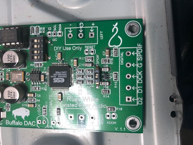

Looking to verify a question concerning my first gen Isolator. It's been sitting since I received it back in 2017. I'm looking at connecting my Isolator directly to a first gen Buffalo, that does not have u.fl connectors. I did purchase some loose u.fls with my order. I assume that we are only looking at a single conductor for each connection instead of two conductors that are present in both the u.fl and the coax cable (also part of my order).
Since it appears that the inner conductor is the one we are looking at and the one that should be used on the Buffalo board, I would like to verify that.
Secondly, since the Buffalo board is not set up for u.fls (just a through-hole, no pads for outer tabs), are there any suggestions for attaching these?
