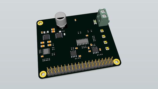

I am looking at the sketchup rpi isolator model again. Are there any changes that have been done on the actual board since I made the model ages ago so that it does not look right to you IAN?

Hi gwikse,
The 3D model looks very very nice. It makes me feel really good seeing it again after months. Thanks!
Here is the update of IsolatorPi. Just hope you like it 🙂

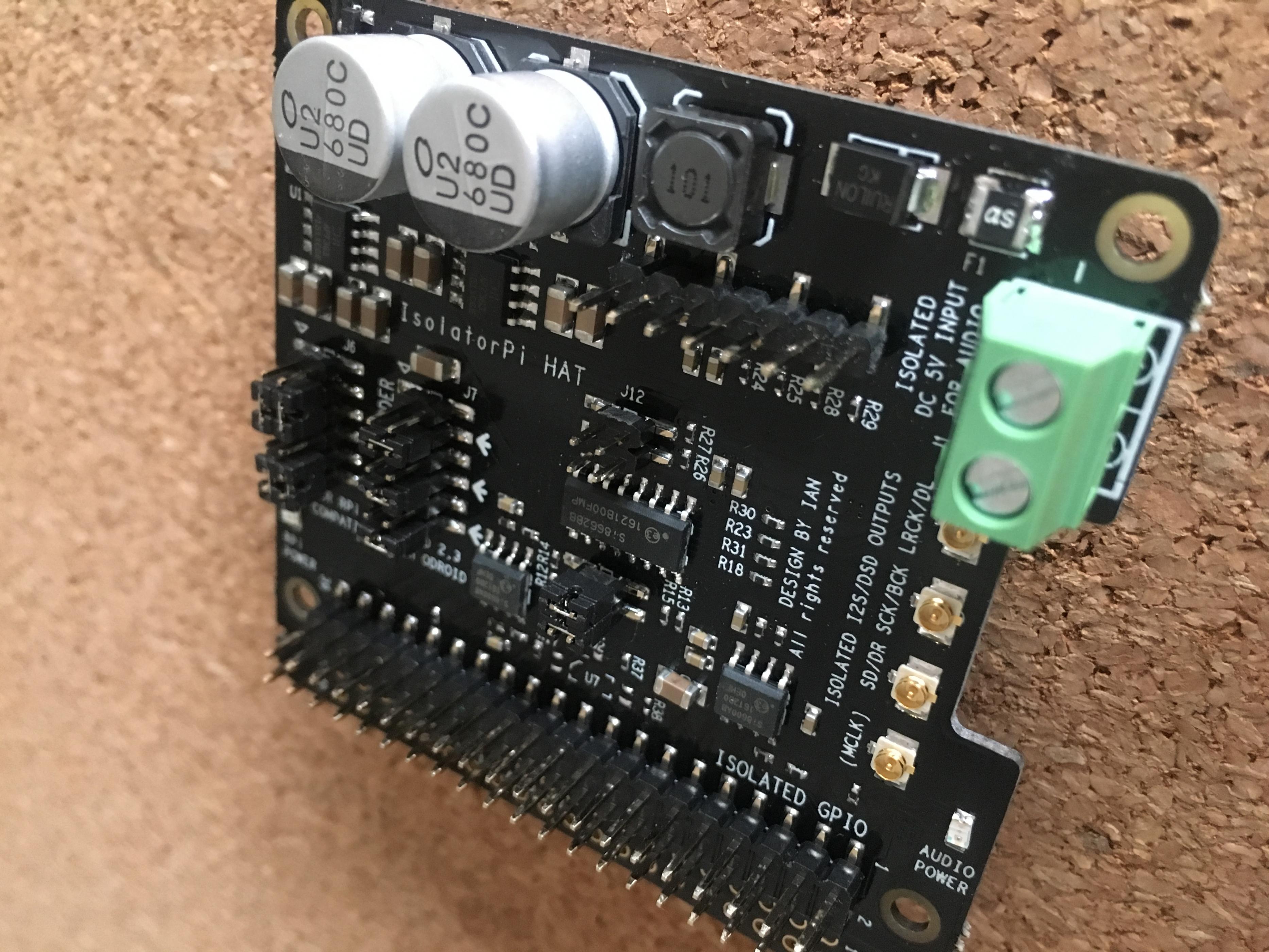

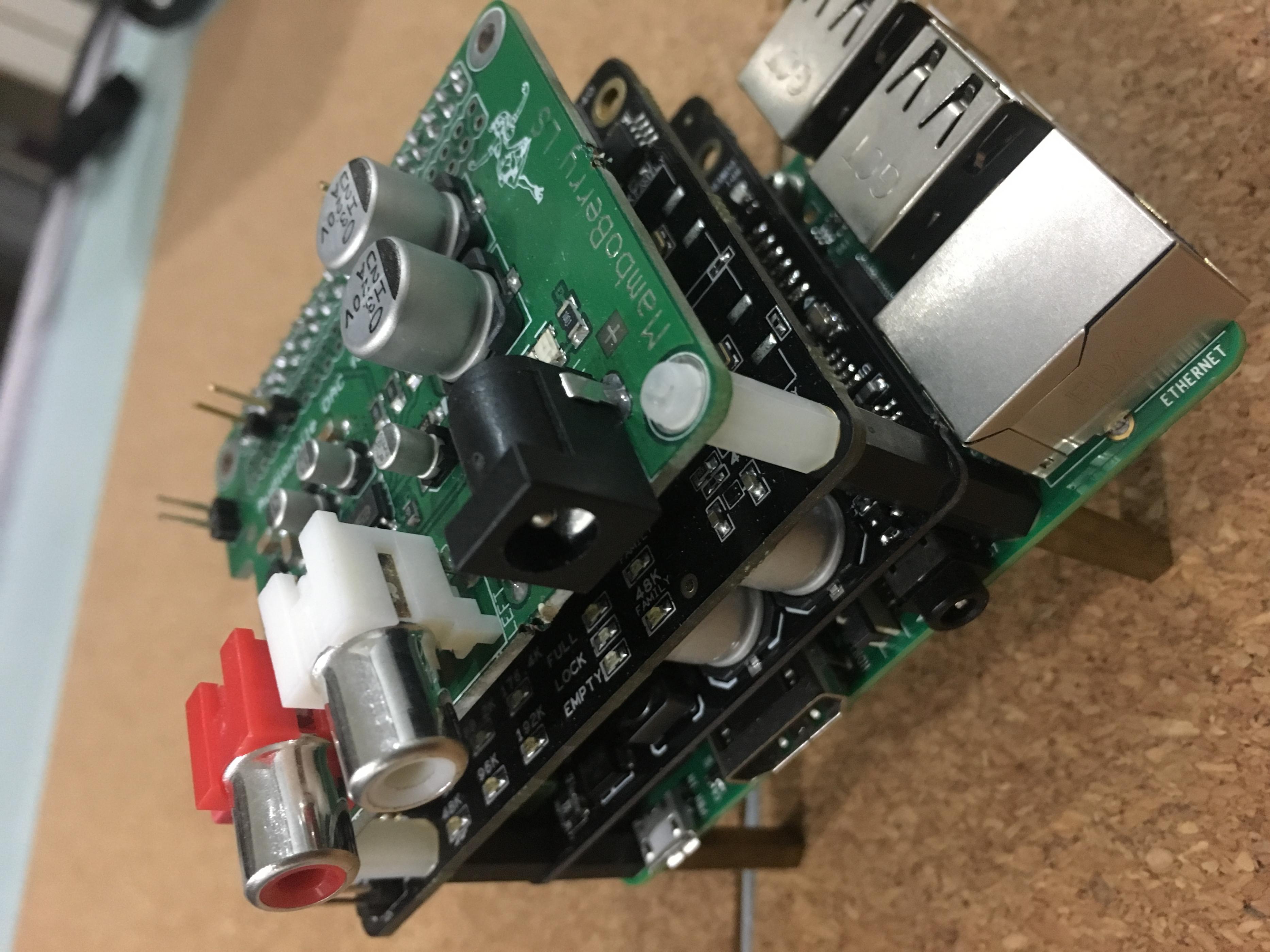

Sucessfully tested Isolator Hat
Hi Ian,
I have tested the Isolator Hat with my RPI setup and I can confirmed it works magnificently after some figuring. I will post some the step by step (with picture for illustration) process of my test setup in the next few post 🙂
Rgds

Have I missed something here? How is it that you have one, are you on the test program?
Looks like you are running the same set up as me, with a Kali and Mamboberry LS+
Now I'm keener than ever for my two isolator boards...
