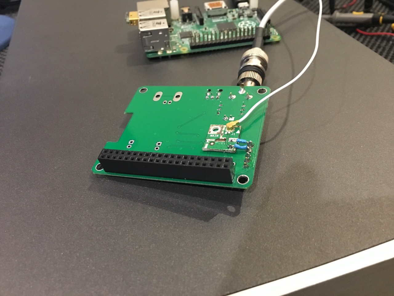

Hi Ian,

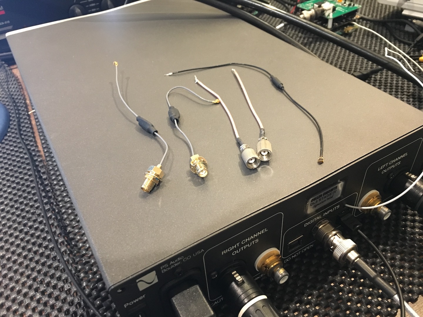

Do you know of any nice tiny pre-built u.fl daughterboards (single or multiple) like the one I hacked off an old wifi board in the pic (added to a Digi+PRO for MCLK out) ? Or a better solution to that?
Thanks!
And on the other side soldered the coax directly in for now.
Thanks!
Ok, google photos is odd sometimes if you're logged in or not, even if it's public...

Hmmm, not quite-- I like that little pi board! Is there anything special about the u.fl jumpers you use here and there in pics, is there a certain spec (ohms, shielding) for those in this use? Do you try to keep those short?
Thanks!
Thanks!
Hi sckramer,
u.fl is a standard RF connector which was first introduced by Hirose.
https://en.wikipedia.org/wiki/Hirose_U.FL
It's a good solution to transmit clock signals from board to board up to 6GHz. The impedance is 50ohm. So, 50ohm u.fl cable is also required. Shorter would be better but doesn't make big difference. The most important thing is to keep impedance continues along the clock trace.

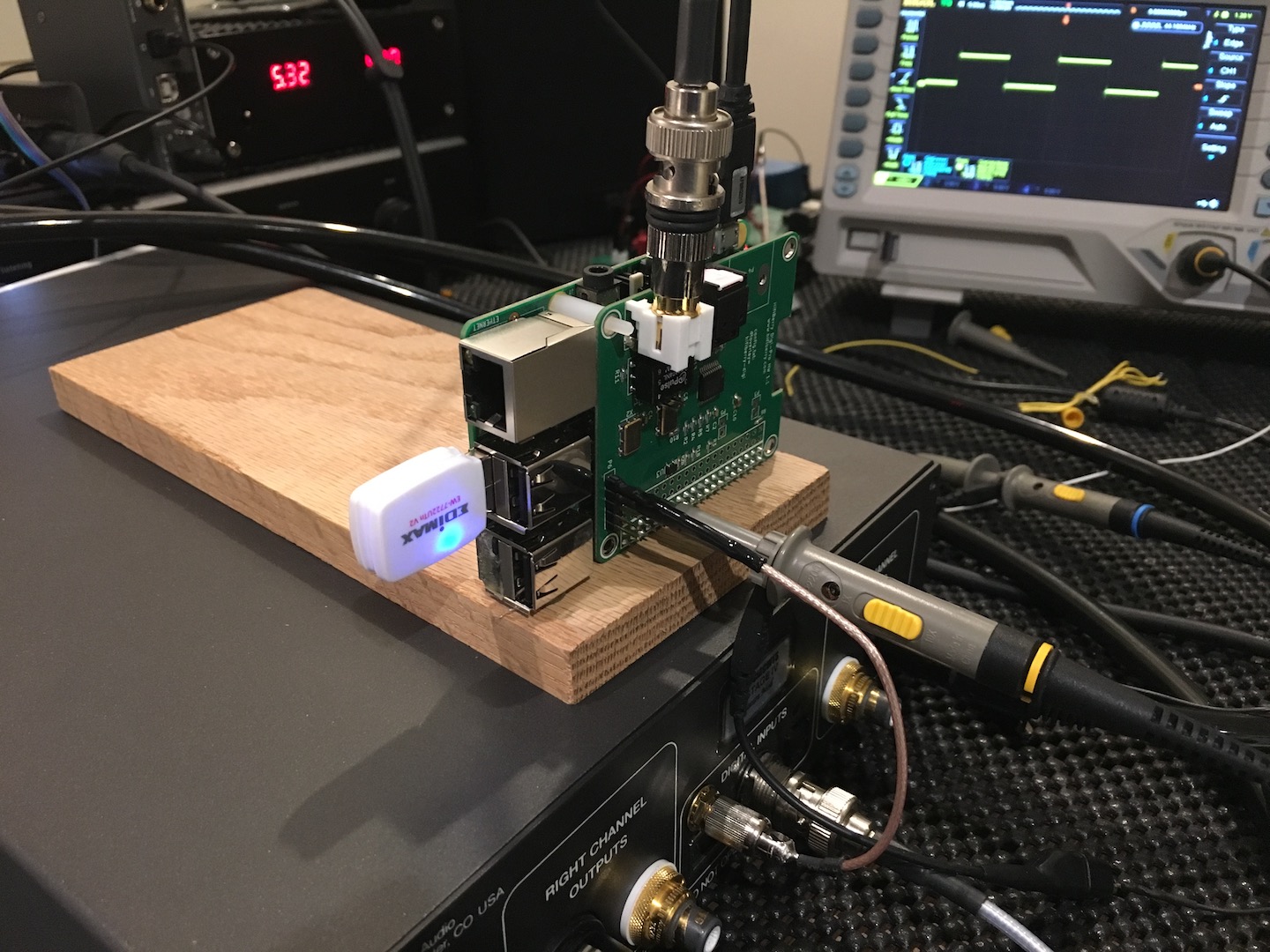

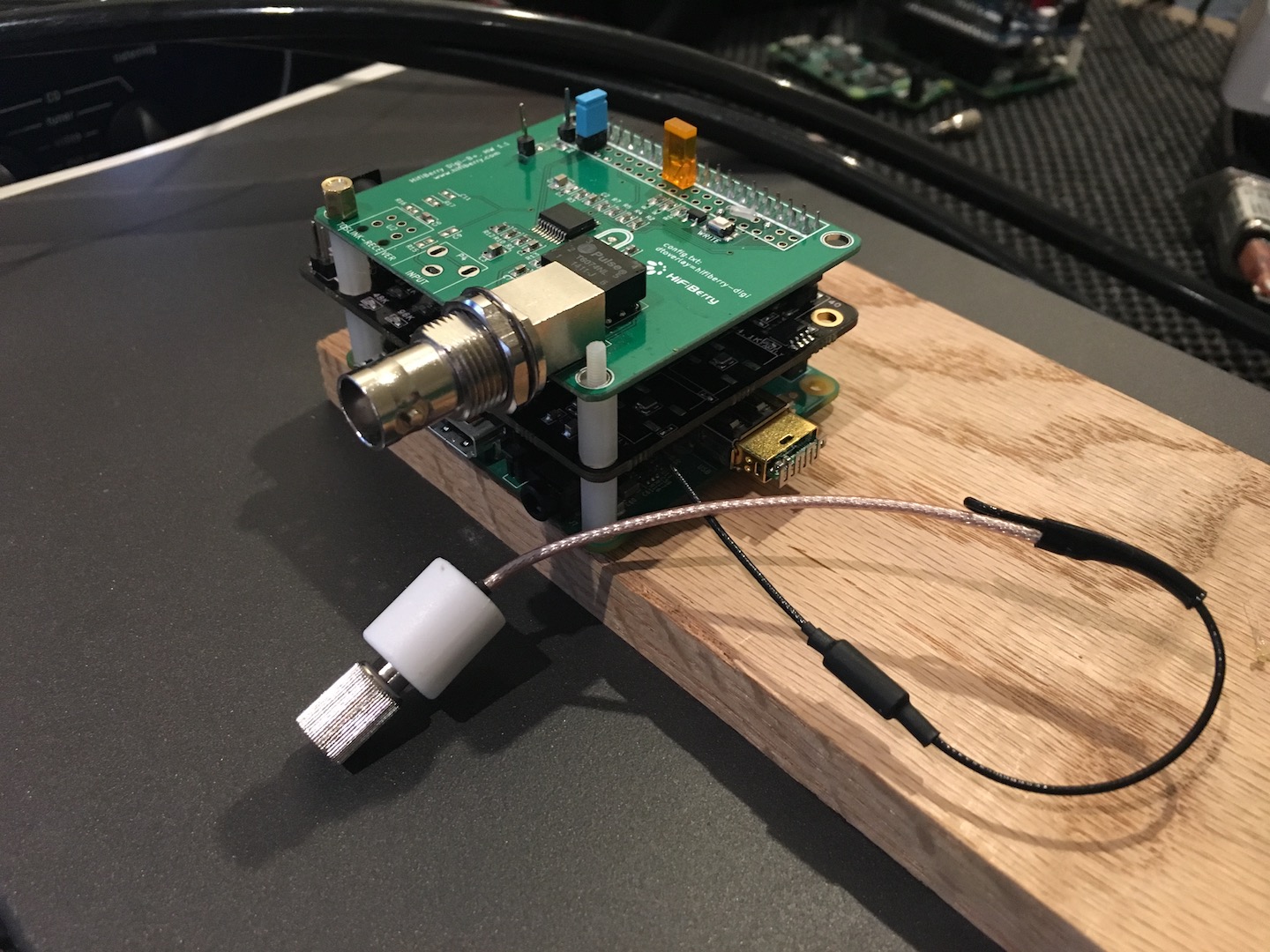

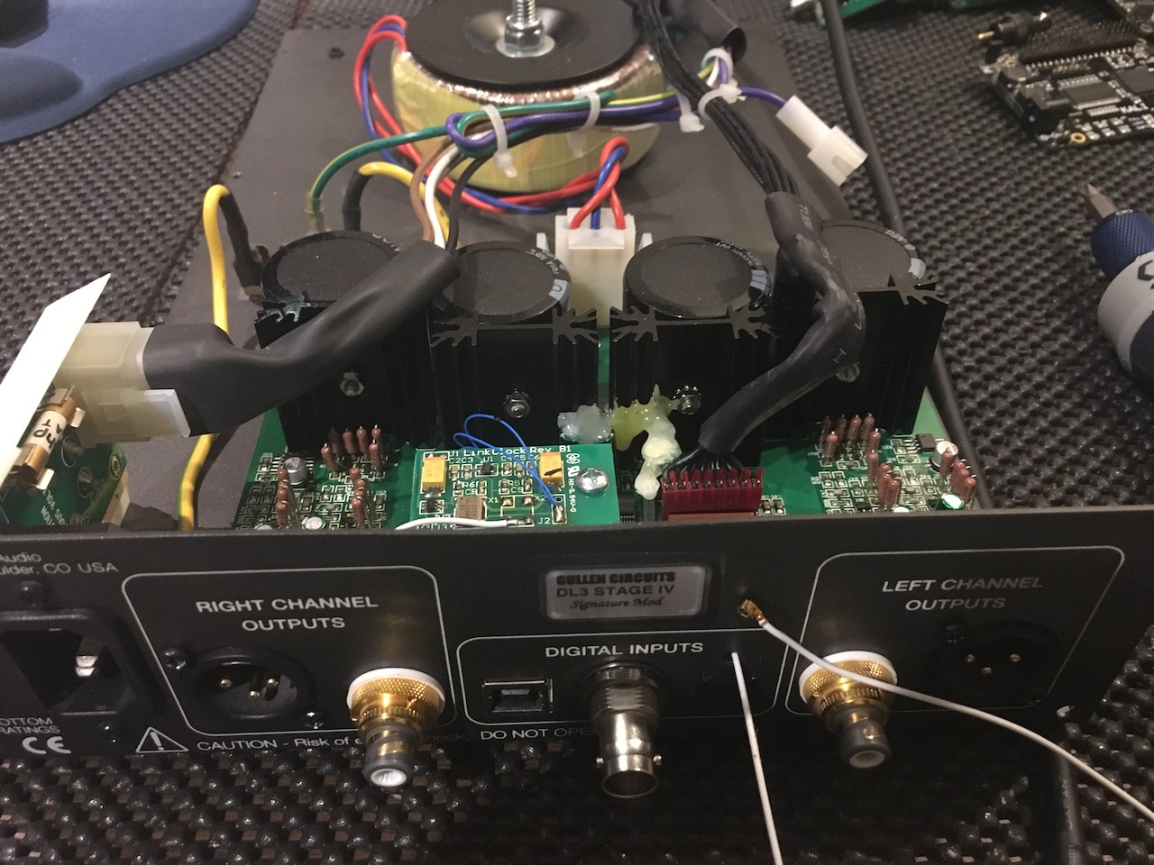

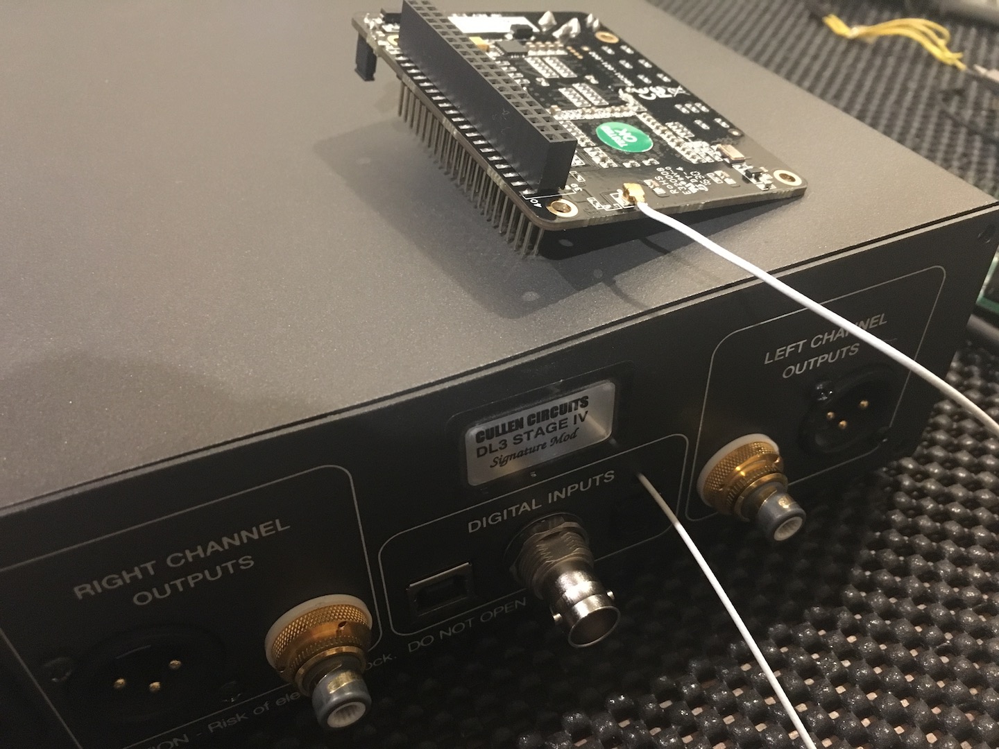

Hi Ian,
So I went researching u.fl a bit more and it's really is a delicate connection meant to be connected once or very few times, good for internal or if you have a project done and not gonna touch it anymore. Not nearly robust enough for this.

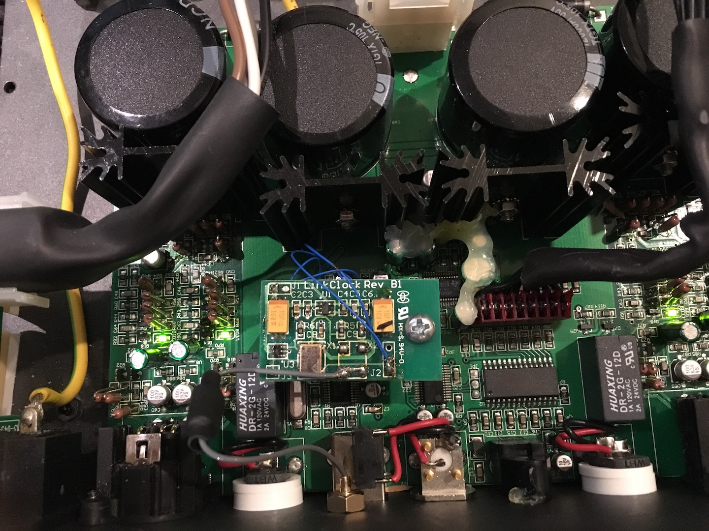

This project started as researching adding i2s in, so removed the crystal but it was just mute. Got to know the circuit really well, and decided to try ext. MCLK in. ( might revisit i2s later, may know what it is now )
(This is a PSAudio DLIII)

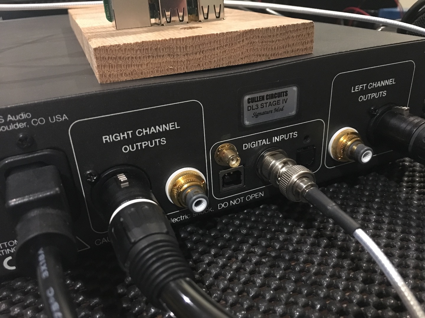

Found theres a nice medium connector between u.fl and full BNC... and look what I found in an old wifi router, all kinds of good stuff:
Here's how I ended up doing it: (left the ferrite bead)
ext. nice medium sized connection: (added above the usb)

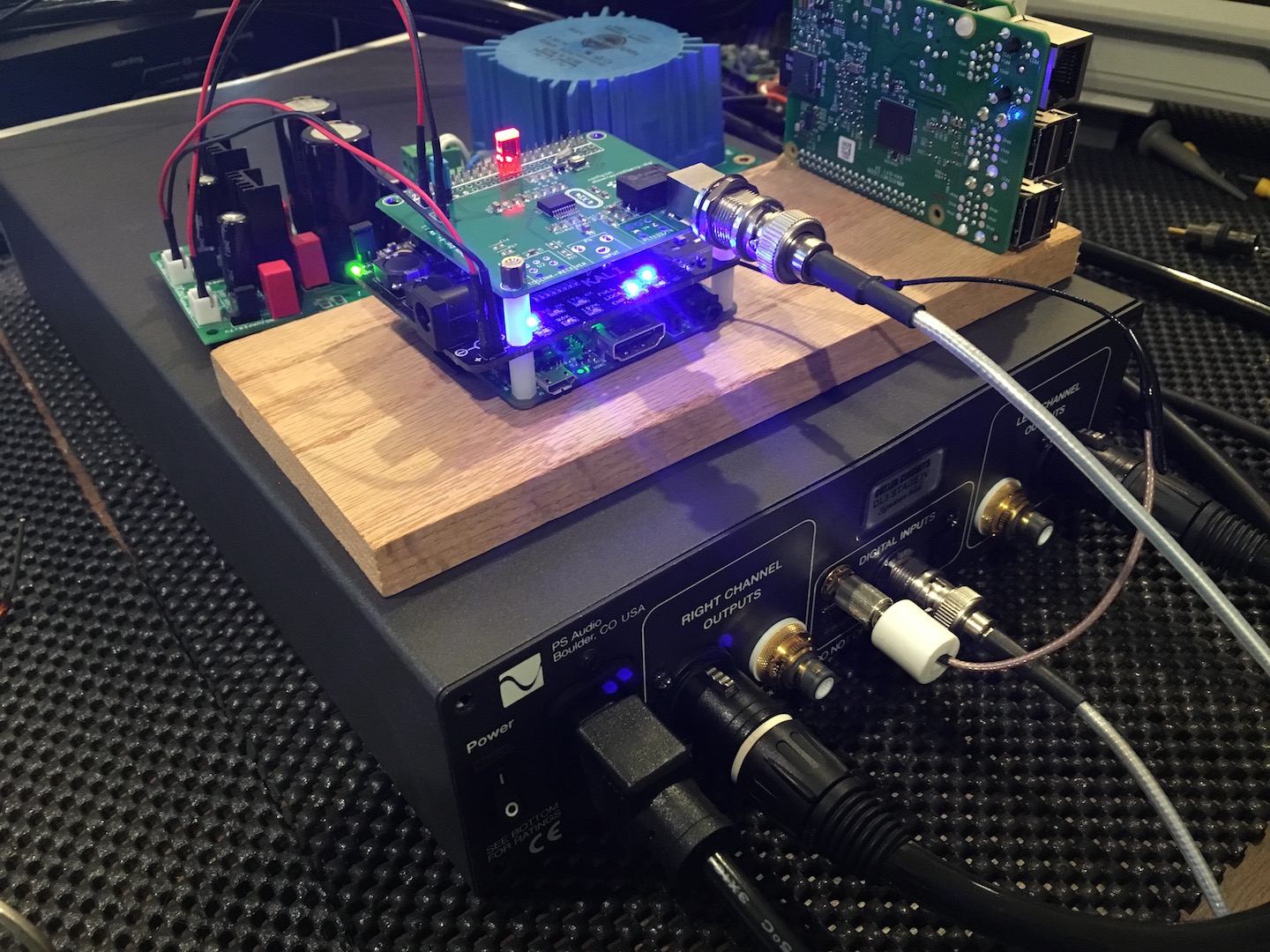

Made an adapter for pi headers: (working on digi+ pro)
Made an adapter u.fl to that medium coax: (my slaved digi+ on a kali -- kali does have a u.fl for MCLK underneath, attached there and strain relieved)
After listening for a week with the lash up (that original chintzy white wifi u.fl wire in prev post) to a Kali/slave Digi+ just had to make it permanant it is such a fundamental jump in sound quality!
Any thoughts or critiques please?
Is it the single clock domain (source), instead of 2 (source/dac) giving such a difference? This Dac had a good 6 year run and my "reference" -- so I'm fearless 😀 Also the beauty of this is... just select 96KHz on the front and it's back to stock operation! Never used the 192KHz upsample setting anyway (why I chose to rip out that supporting clock 🙂)
It was fun analyzing the clocks on the scope, attached one channel on the dac, one on the source (the internal i2s lines)... and you can see the deviation, and jittery in relation to each other... now everything's in lock step.
Thanks!

Scott, thanks, very interesting to read.
One question: Why didn't you use Kali's pin 29 for the MCLK?
Thanks! Look closely at the top of the digi+ -- pin29 is connected to pin36 (the digi+ WM8804) MCLK in... need it there when slaved... cool huh! (also notice the digi+ crystal is removed)

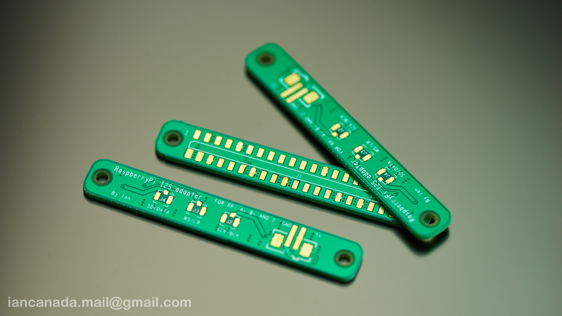

Hi Balou,
I can give you two of the Pi I2S adapter PCB for free if you just need the bare PCB.
You can PM me.
Ian
