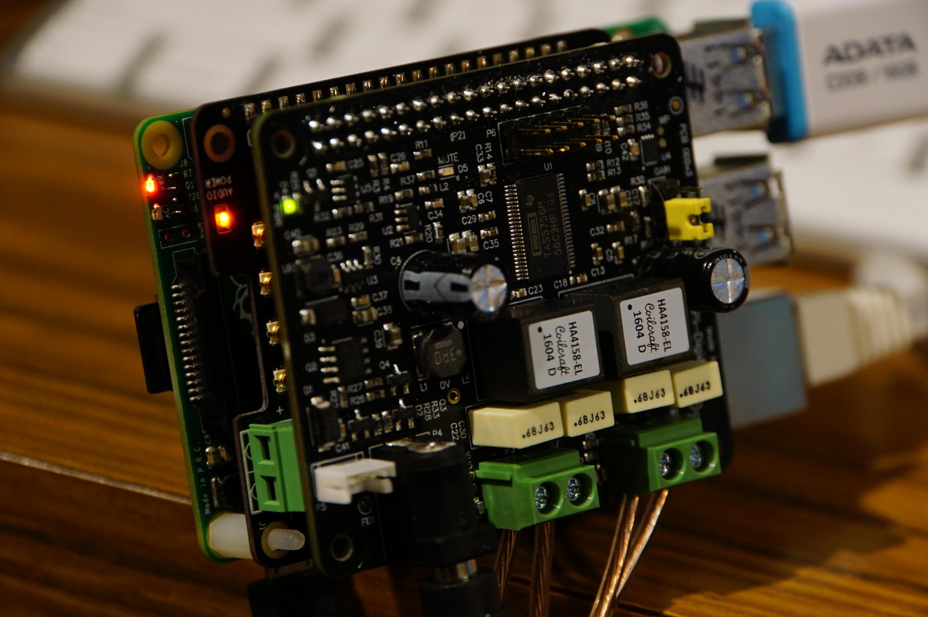

Works with Pi-DigiAMP+
Tested works with Pi-DigiAMP+.
Pi-DigiAMP+ is a DAC/class D amplifier. It has a 12-19V power supply, so no need DAC power connected to isolator. Pi-DigiAMP+ is totally isolated from the Pi power in this configuration. It sounds wonderful with this isolator.
Ian

This looks amazing!
For the complete newby as myself, exactly what does 'sounds wonderful' mean? How does it change the sound to a setup with the Amp directly connected to the RPi?
Thaks for any feedback, looking forward to learning about this stuff, best regards,
Rafa.

Thanks guys!
In digital section, two things need to do to improve sound quality.
One is to cut the EMC noice by isolated DAC ground with PC ground.
The second is to replace audio clock with a better one.
This isolator is doing for the first thing.
To do the second thing, we'll need a FIFO or other low jitter clock solution.
Ian
