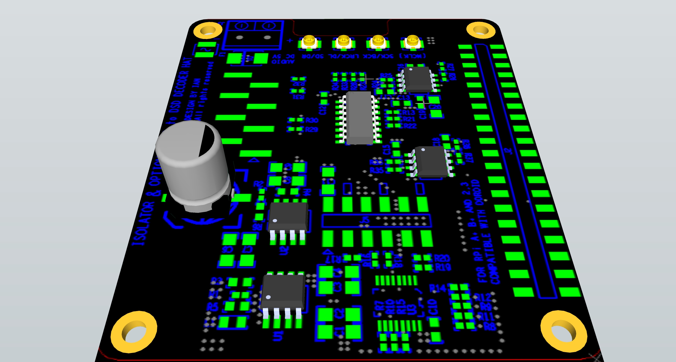

Do you have an image of the rear side of the board?
I am creating a sketchup model of it and would like to place components correctly if there are any on the rear side (I take it that there is a header for the pi and one for i2s from the Odroid)?

Great project. Following with interest. Will you offer these boards as bare pcb`s or fully/partially populated pcb`s ?

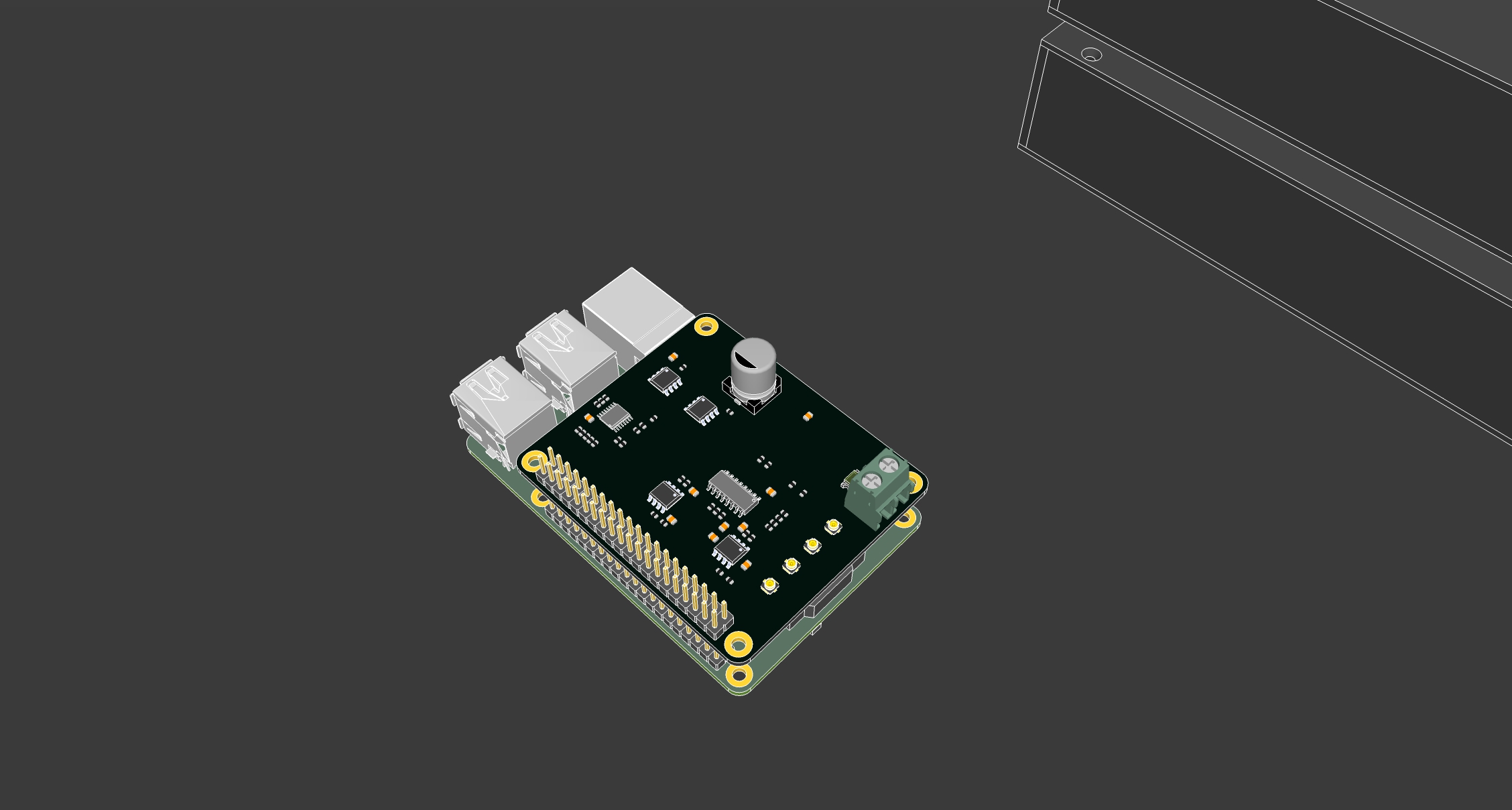

Its a 3d sketch with no other function than to illustrate visually the board in a 3d model. I use that for planning my builds. Makes it easier to spot any problems with physicla locations of differnt boards inside an enclosure. I use sketchup for that as it is easy and fast for this sort of thing and has a large collection of models online for download.
I just simply took the picture from your post and made it into a textured material (paint) and painted the surface of a board (copied from a RPI model so that the mounting holes line up) and populated the board with the components that looks correct. When you put up a parts list I will adjust the model so that it is more accurate.
I did the same thing with a lot of other boards. Took the picture of a bare PCB and populated it according to the parts list. That way it is easy to illustrate things without having to take a photo of an actual board.
Anyways, I am looking forward to seing the finished solution, and incorporating it into my DAC solution (with i2c control of an ESS9018).

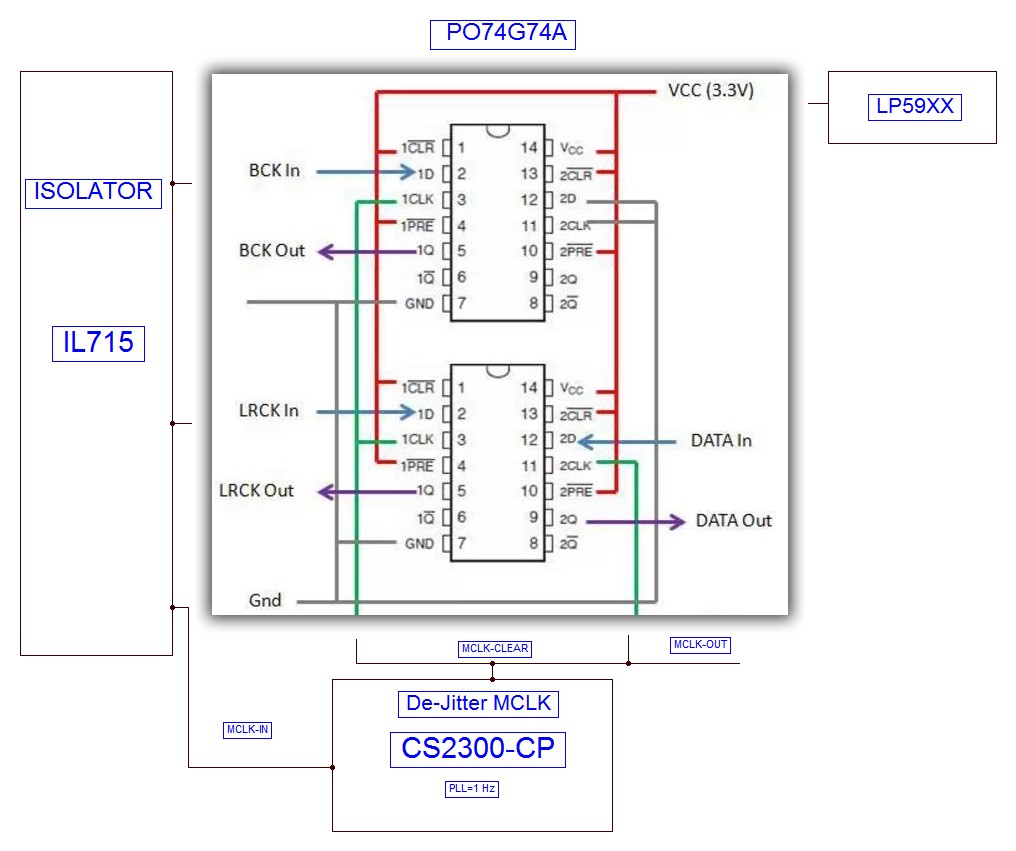

Conclusion I2S bus from Pi-circuit board has a lot of jitter, here measuring Comparing the I2S Capabilities of the RPi and Odroid C1+, in ODROID slightly better than of Pi, but all the same level > 1ns (1000ps), Crazy Audio approximately 800ps showed Raspberry Pi I2S output working, сompare Amanero USB board has 2 ps.
Quality I2S bus can correct board, something like a synchronous reclock no frills for the price, such as here Master clock and isolator for the MiniDSP USBStreamer
Obviously, the Ian's FIFO board is the best solution, but it is very expensive compared to PI boards.
ODROID can only operate as a master I2S bus, but the Raspberry Pi can be as a slave on the I2S and Raspberry Pi has Blck input, BeagleBone Black has MCLK input to the SOC.
It may be cheaper to make the isolator/reclock under the scheme, only the idea.
