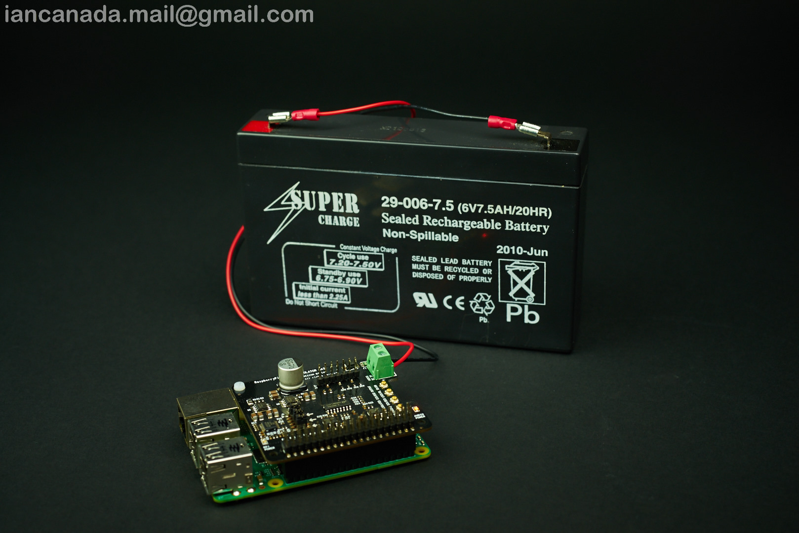

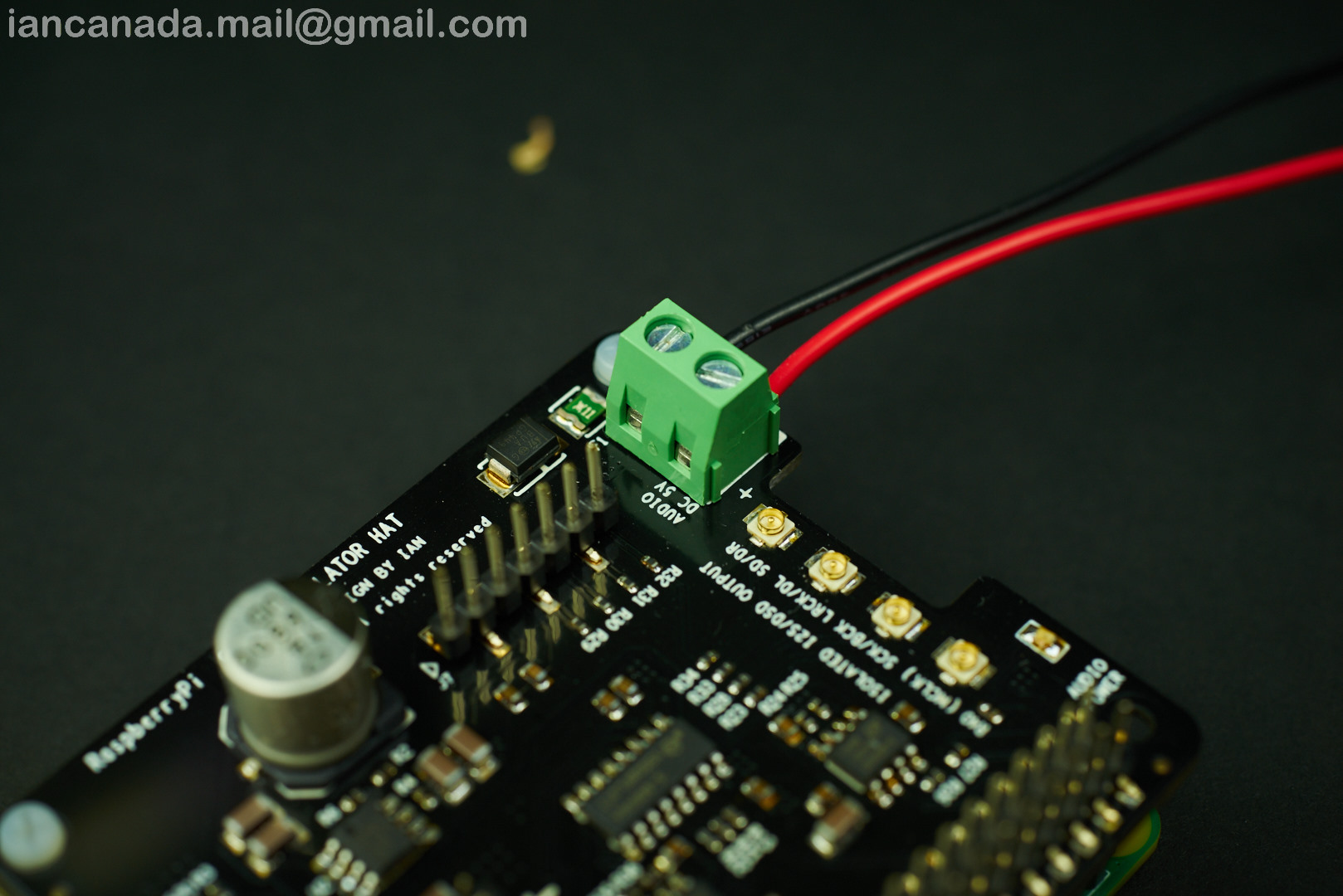

Hello Ian, does the green connector named "Audio DC 5V" allow to feed 5V power instead of the Pi's microusb power connector?
Which is the power for DAC, 100% isolated from Pi power.

Isolated power supply
A brand new isolated power supply is fed into the isolator. This new power supply will power PRI DAC that is stacked on top of the isolator, as well as half of the isolator, both 5V and 3.3V.
This new power supply will be 100% galvanic isolated from RPi. Ground loop will be cut completely to eliminate EMI noise introduced from ground. In this case, new power supply can be treated as audio power supply.
Linear power supply would be highly recommended, and, for even lower noise level, battery power is also possible.
Ian

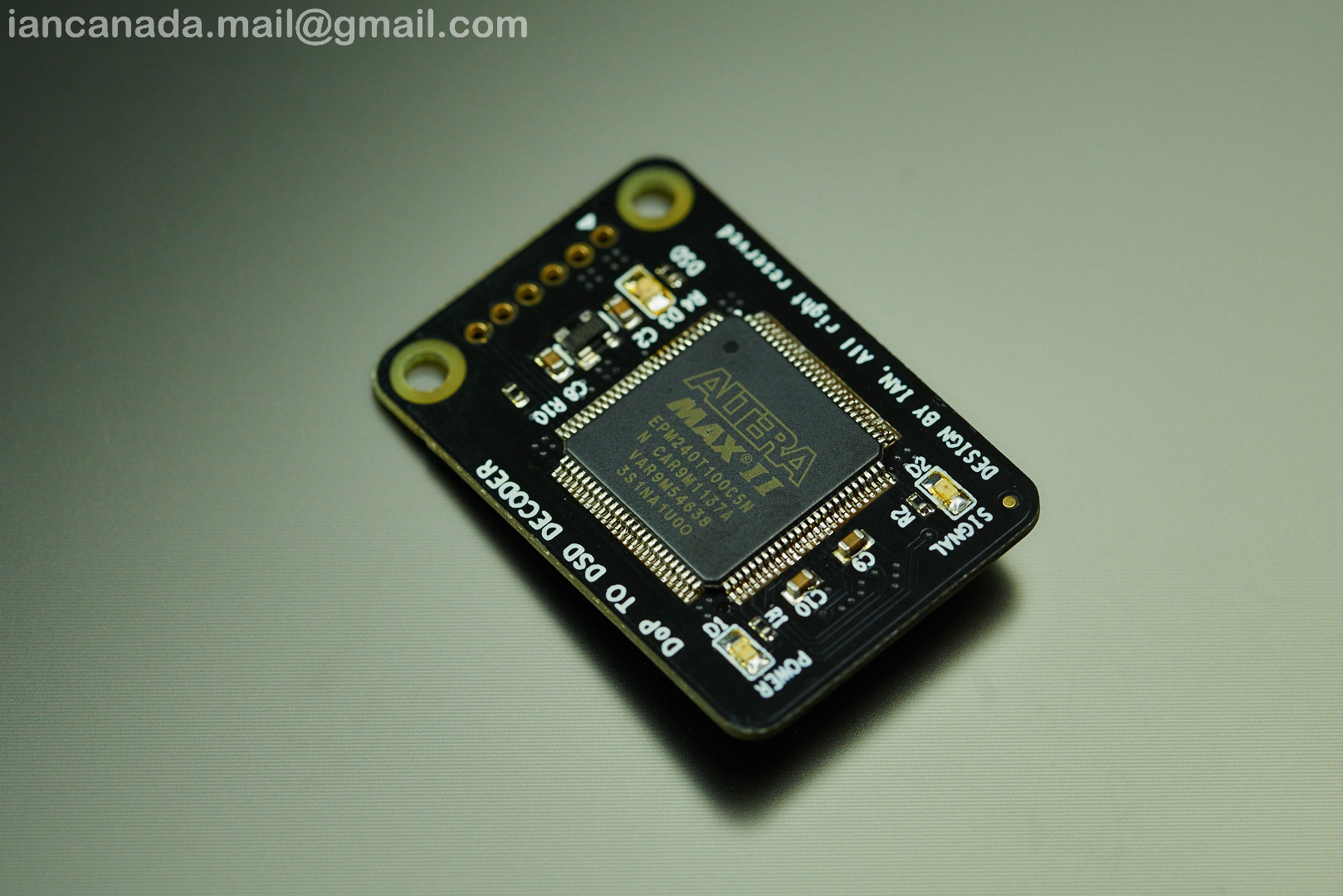

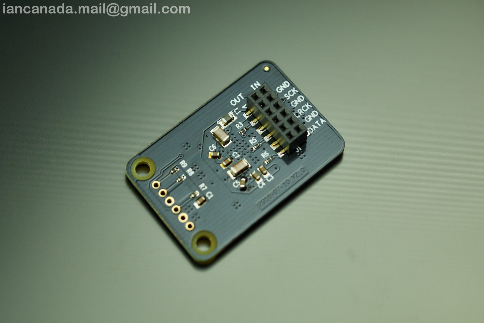

DoP decoder board
This DoP decoder board was designed for RPi to enable its native DSD playback features. It has a 10P board to board connector at bottom of PCB to stack on top of my isolator. But actually it can be used for any DAC that capable for both I2S and DSD.
To make it easier to understand the way it works, here are some Q.A about DoP and this decoder.
What is DoP?
DoP is a protocol to transfer native DSD data over 24bit I2S package.
Why DoP?
The purpose of DoP is to send and receive DSD data by making use of existing I2S or S/PDIF I/O and devices.
Can DoP stream be converted to native DSD again?
Yes, DoP can be converted back to native DSD by either software or hardware based DoP decoder.
Is DoP a lossless protocol?
Yes, DoP is a bit perfect protocol. Native DSD stream can be re-generated losslesslly. There will be no difference with the original native DSD stream after decoding.
Does the DoP decoder still compatible with I2S music?
Yes, a well designed DoP decoder decodes DSD stream only when DoP mark is detected, normal I2S data will pass-through without any change.
Ian

DoP decoder works with RPi isolator as a daughter board
DoP decoder works with RPi isolator as a daughter board.
DopDecoderIsolator1 by Ian, on Flickr
DopDecoderIsolator2 by Ian, on Flickr
DopDecoderIsolator3 by Ian, on Flickr
Ian
