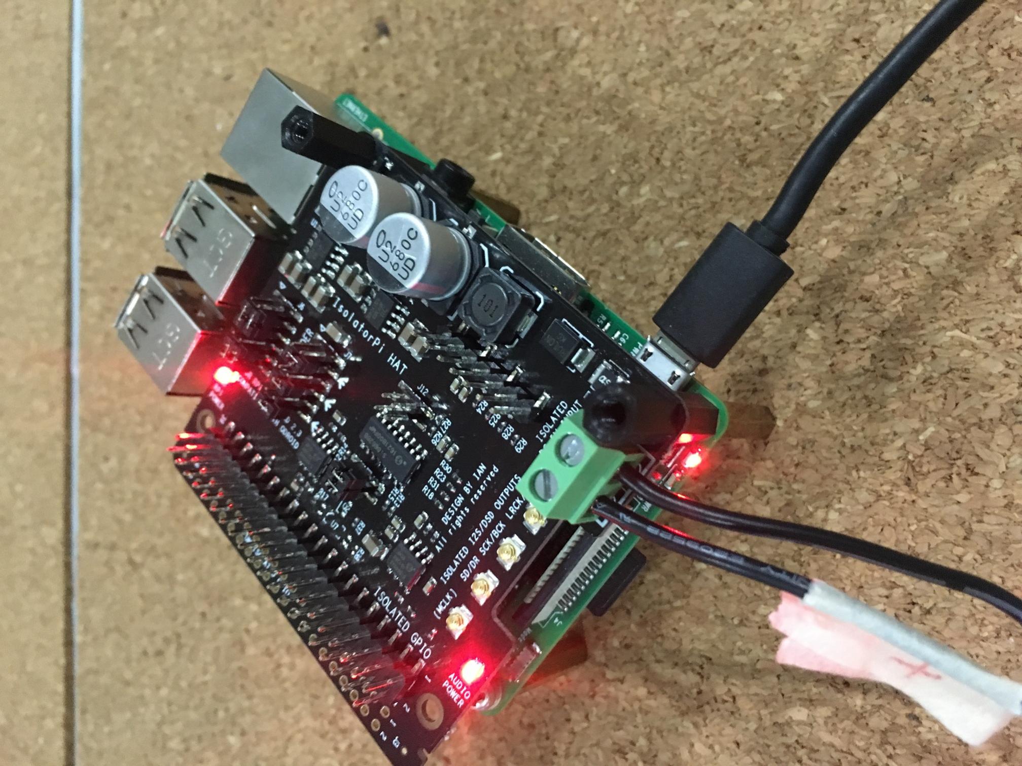

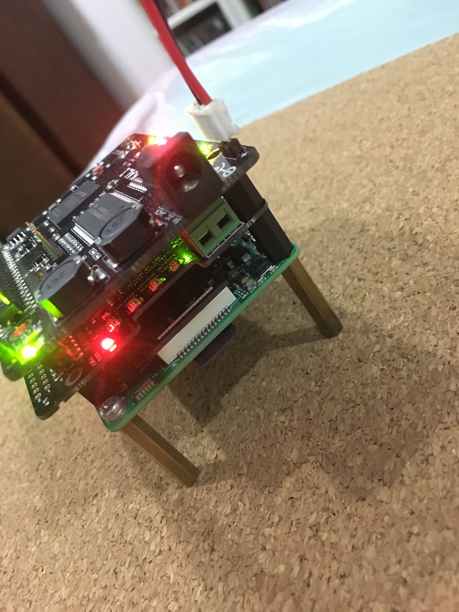

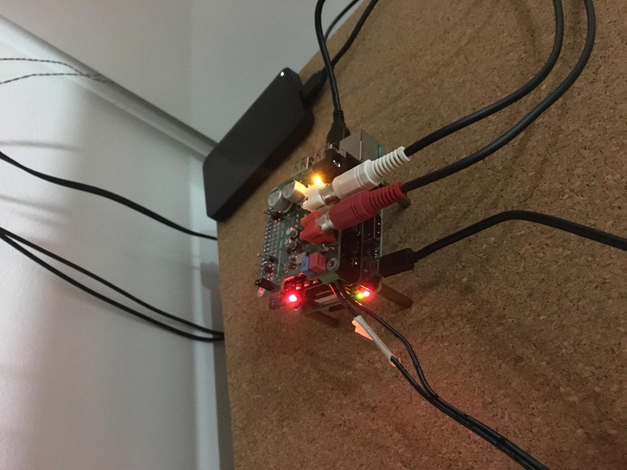

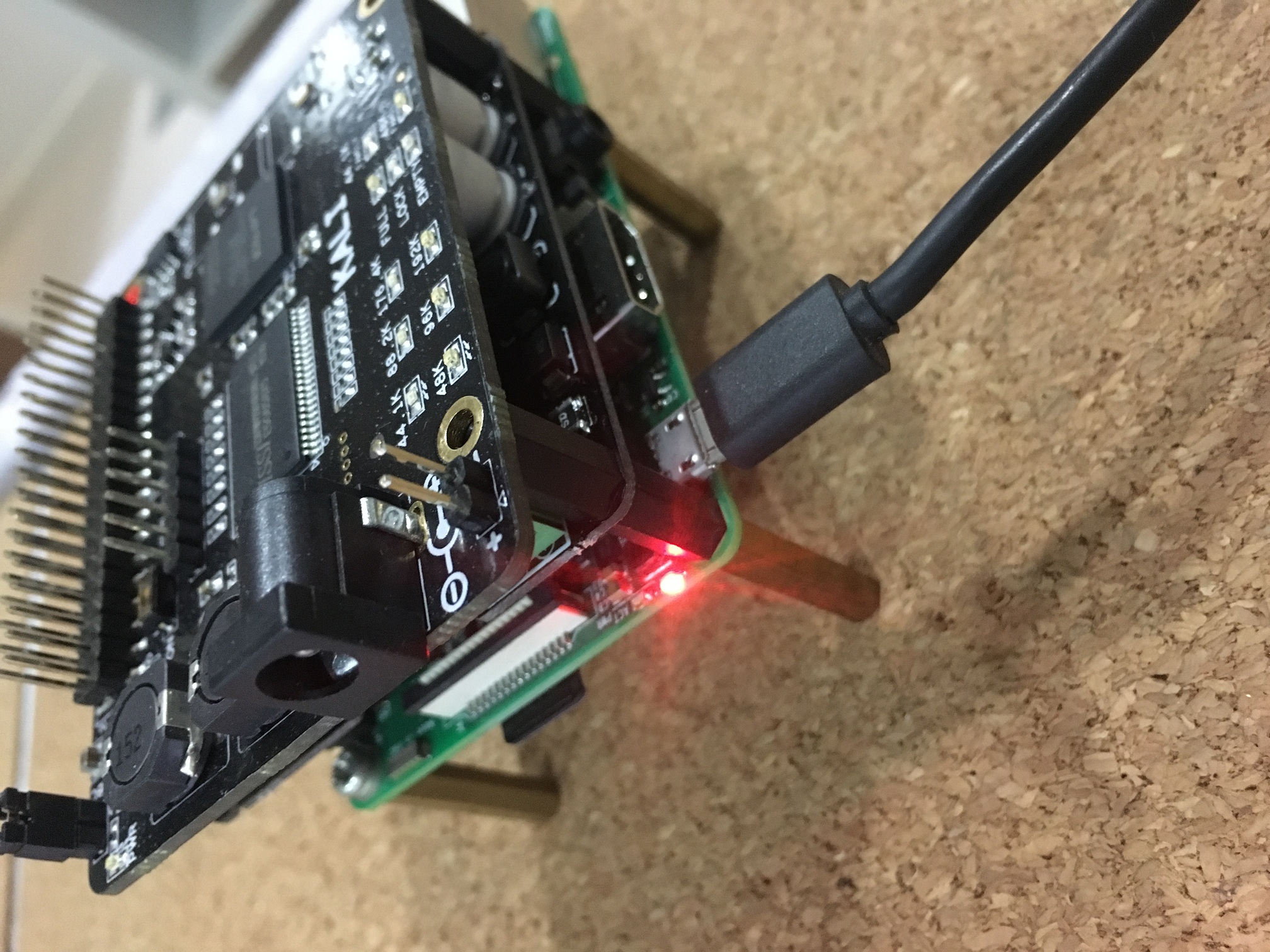

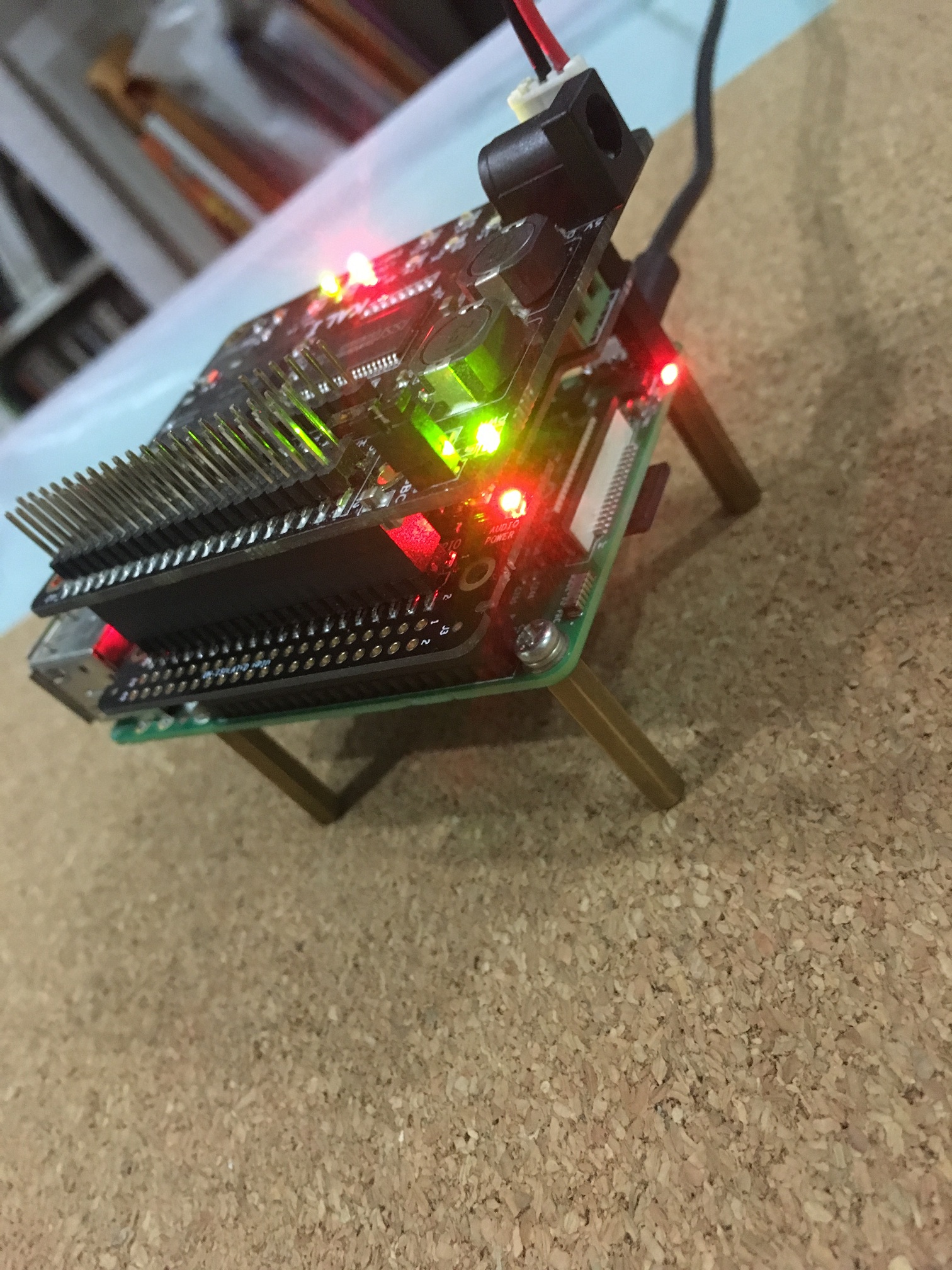

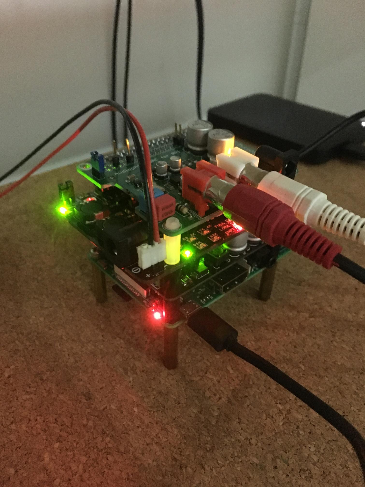

Test setup with RPI - Isolator Hat - Mamboberry LS Dac
Hi
Image 1 & 2 - Feed the 5V PSU to the RPI and it power the non-isolated side (RPI Power Led lights up) of the Isolator Hat. * Notice the Kali is stacked on top.
Image 3 - Feed another 5V PSU to the Isolator Hat and it power the isolated side (Audio Power Led lights up) of the Isolator Hat.
Image 4 - Feeding 5V PSU to the Isolator Hat will also power the stacked Mamboberry LS Dac.
Rgds
2. Only RPI Led lights up on Isolator board (Notice Kali is stacked on top).JPG896.5 KB · Views: 616
3. PSU to RPI & Isolator board (Notice both RPI Led & the isolated side [Audio Led] lights up).jpg364.3 KB · Views: 581
4. PSU to RPI & Isolator board (Notice it power the Mamboberry Dac).jpg320.7 KB · Views: 575

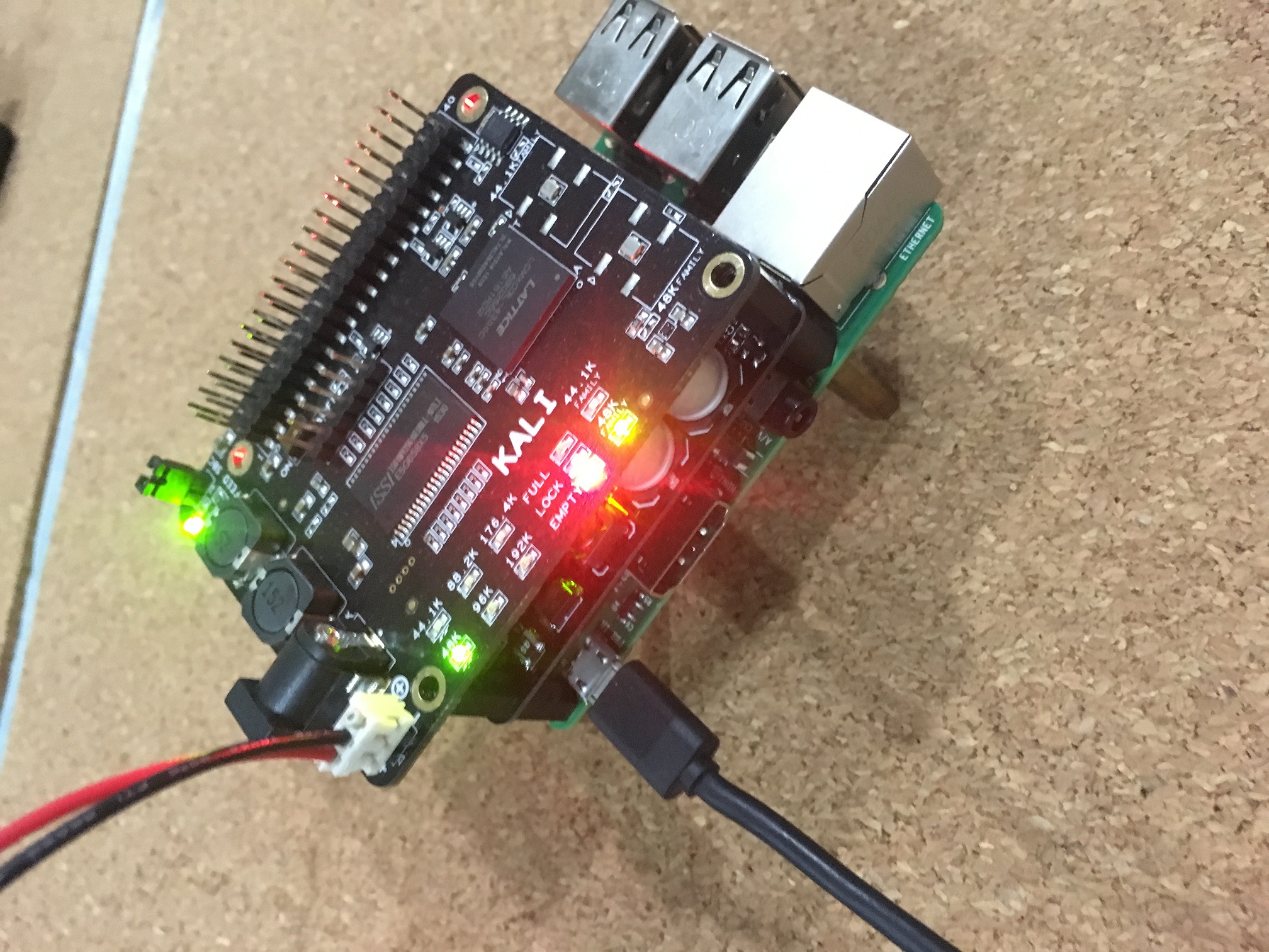

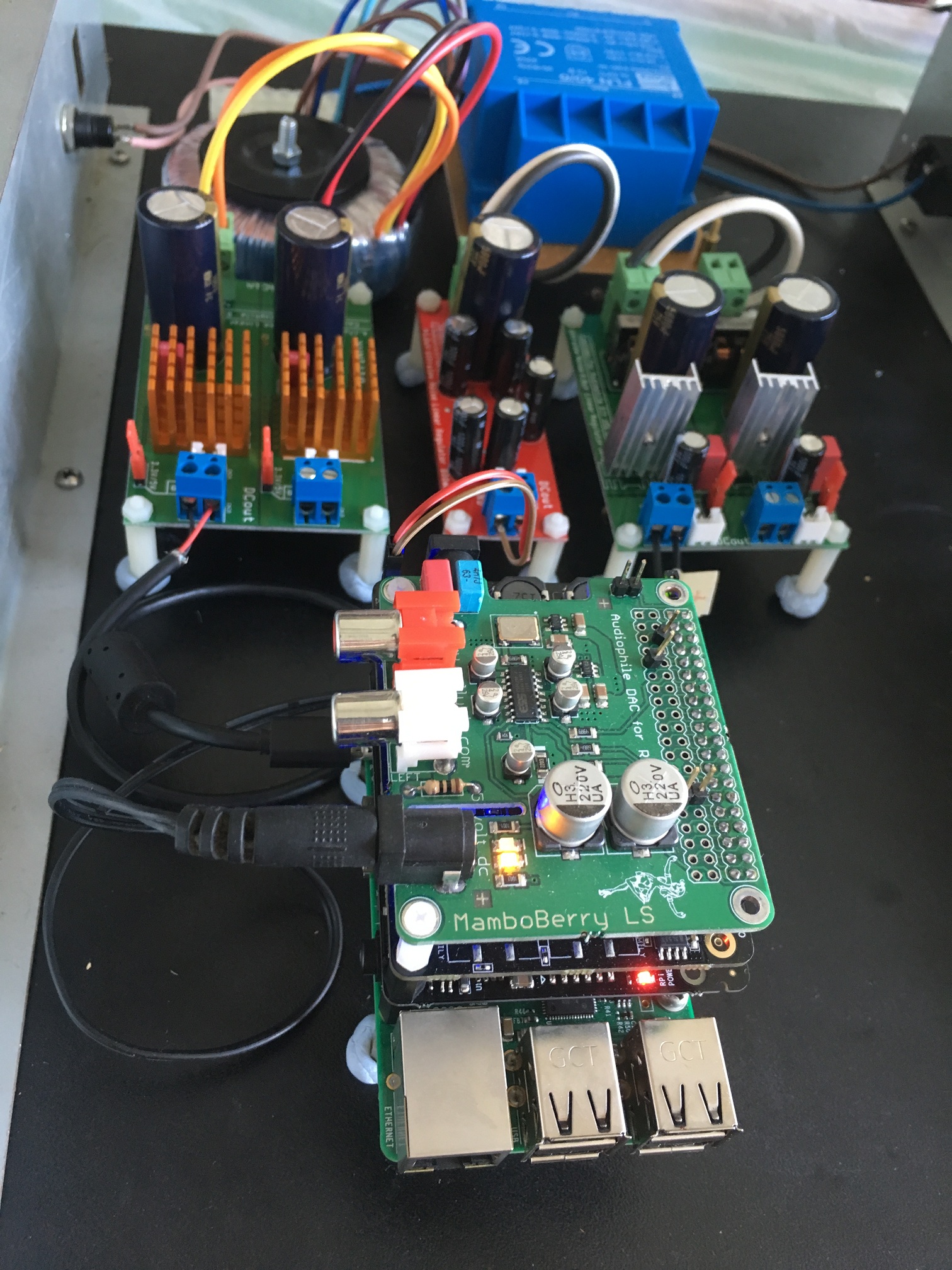

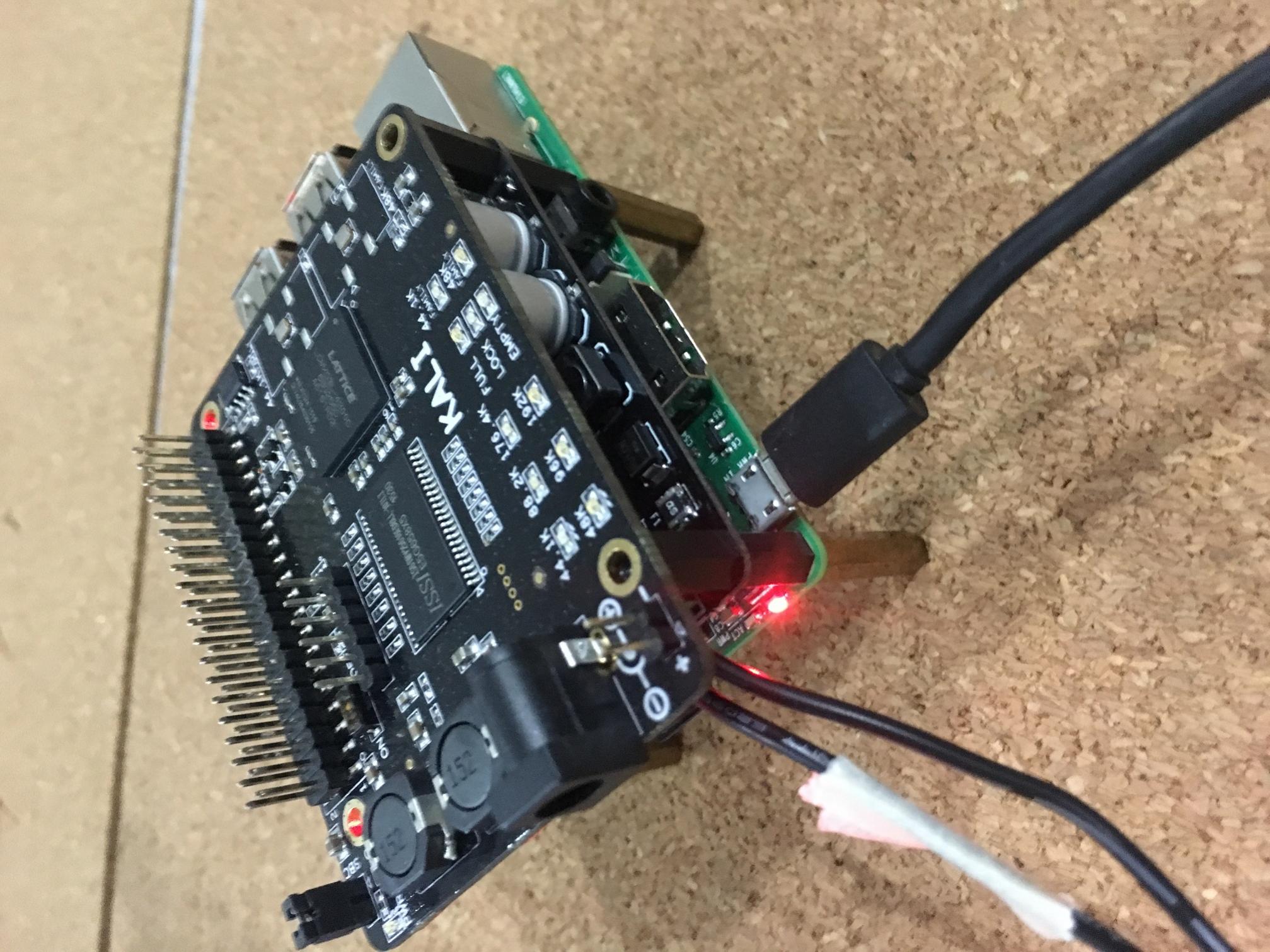

Test setup with RPI - Isolator Hat - Kali Reclocker - Mamboberry LS Dac
Next. A little complicated, but I hope it will be useful for some of us who already have the Kali.
Image 1 - Feed 5V PSU to RPI & Isolator Hat. Notice it does not power the stacked Kali Reclocker. (Remember, previously we need to power the Kali to feed the RPI)
Image 2 & 3 - So I decided to try feeding 5V PSU to the Kali Reclocker only. Notice it power the Isolated side of the Isolator Hat 🙂
Image 4 & 5 - Feeding 5V PSU to both RPI & Kali Reclocker only. Notice it power the isolated and non-isolated side of the Isolator Hat.
Image 6 - With the above power configuration, we will be able to use the Isolator Hat with the Kali Reclocker as well as the Mamboberry LS Dac stacked on top 🙂
Hope it helps.

6. PSU to RPI & Kali only (Notice it power the stacked Isolator Hat and Mamboberry DAC).jpg334.3 KB · Views: 255
5. PSU to RPI & Kali only (notice it power both the non-isolated & isolator side of the Isolator.JPG908.9 KB · Views: 227
3. PSU to Kali board (Notice it power the isolated [Audio] side of the Isolator board.JPG888.6 KB · Views: 241

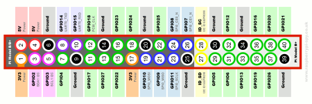

Could you help me checking the option feeding 5V PSU to the Pi via un-isolated GPIO pin on isolator board?
Thanks in advance.
Trung
Thanks in advance.
Trung

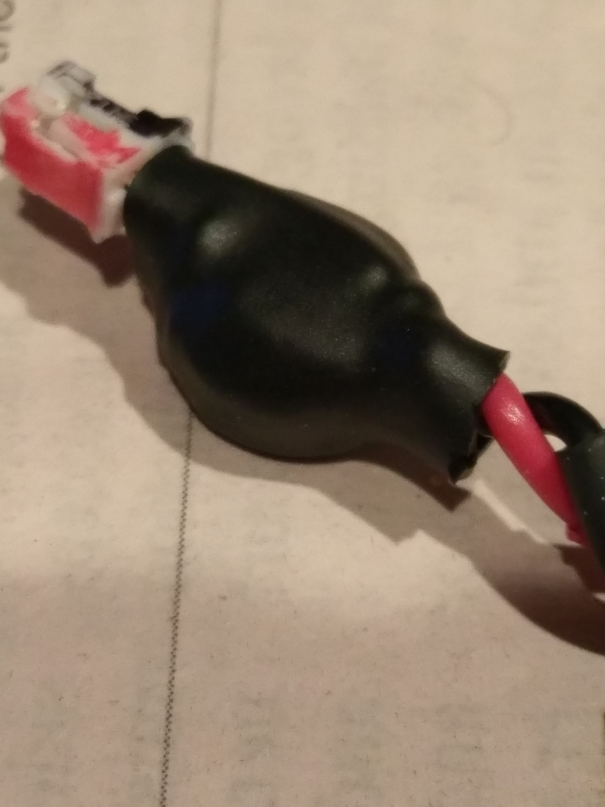

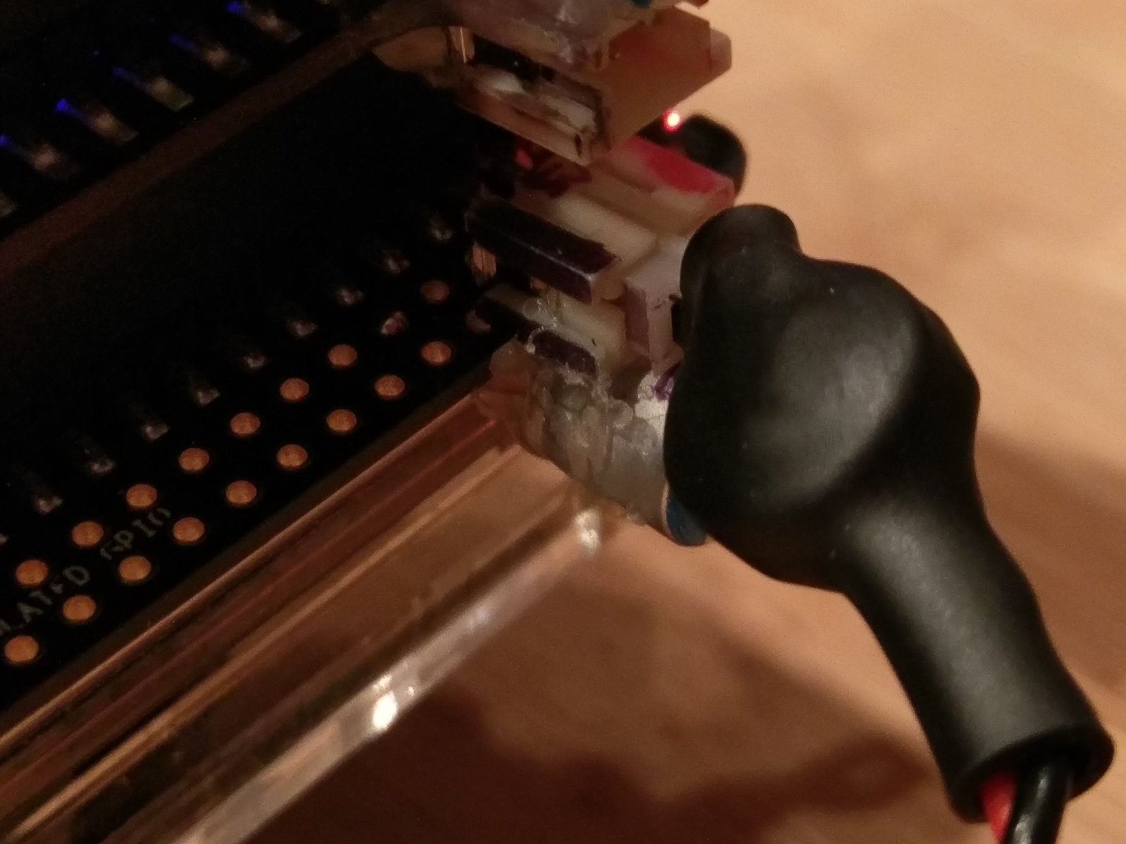

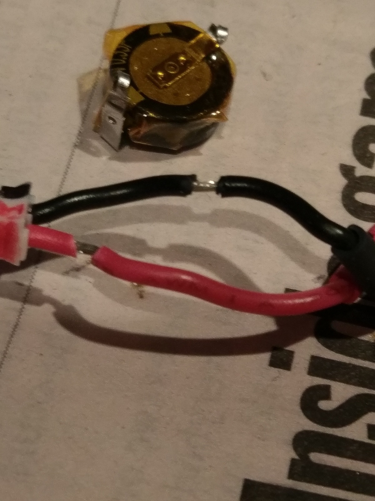

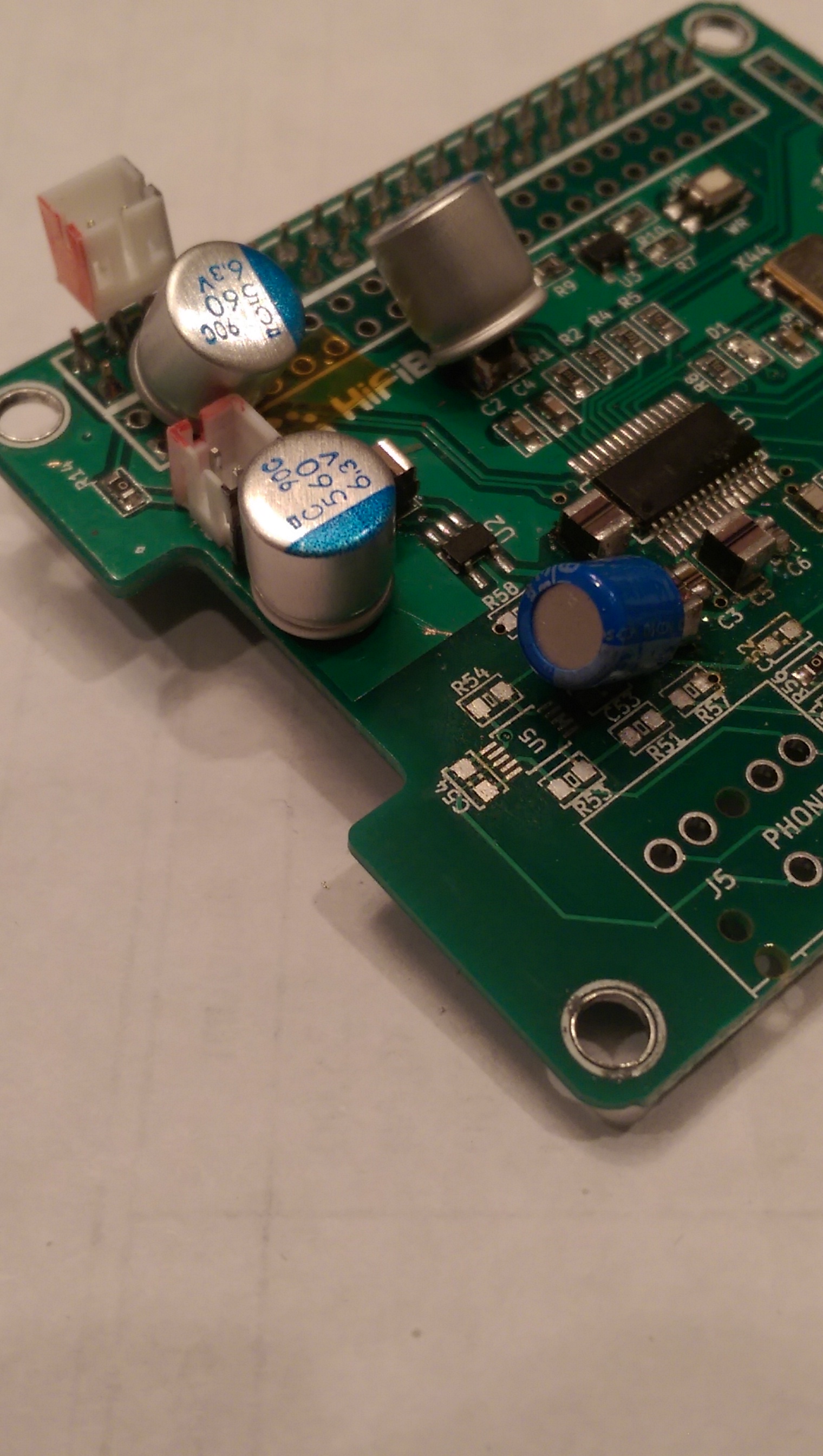

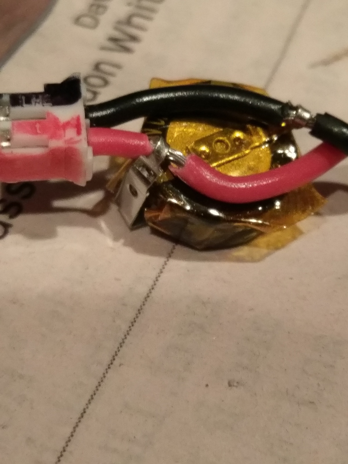

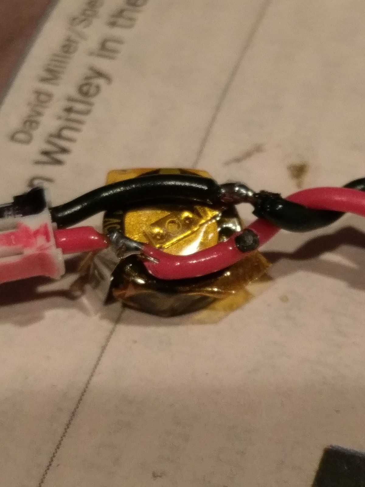

trung224,
There is not an easy way to feed power into the expansion header 5v/ground pins except by soldering.
One way to do it is to solder your + & ground wire to the bottom of the R-Pi... I've attached the pinout of the expansion header.

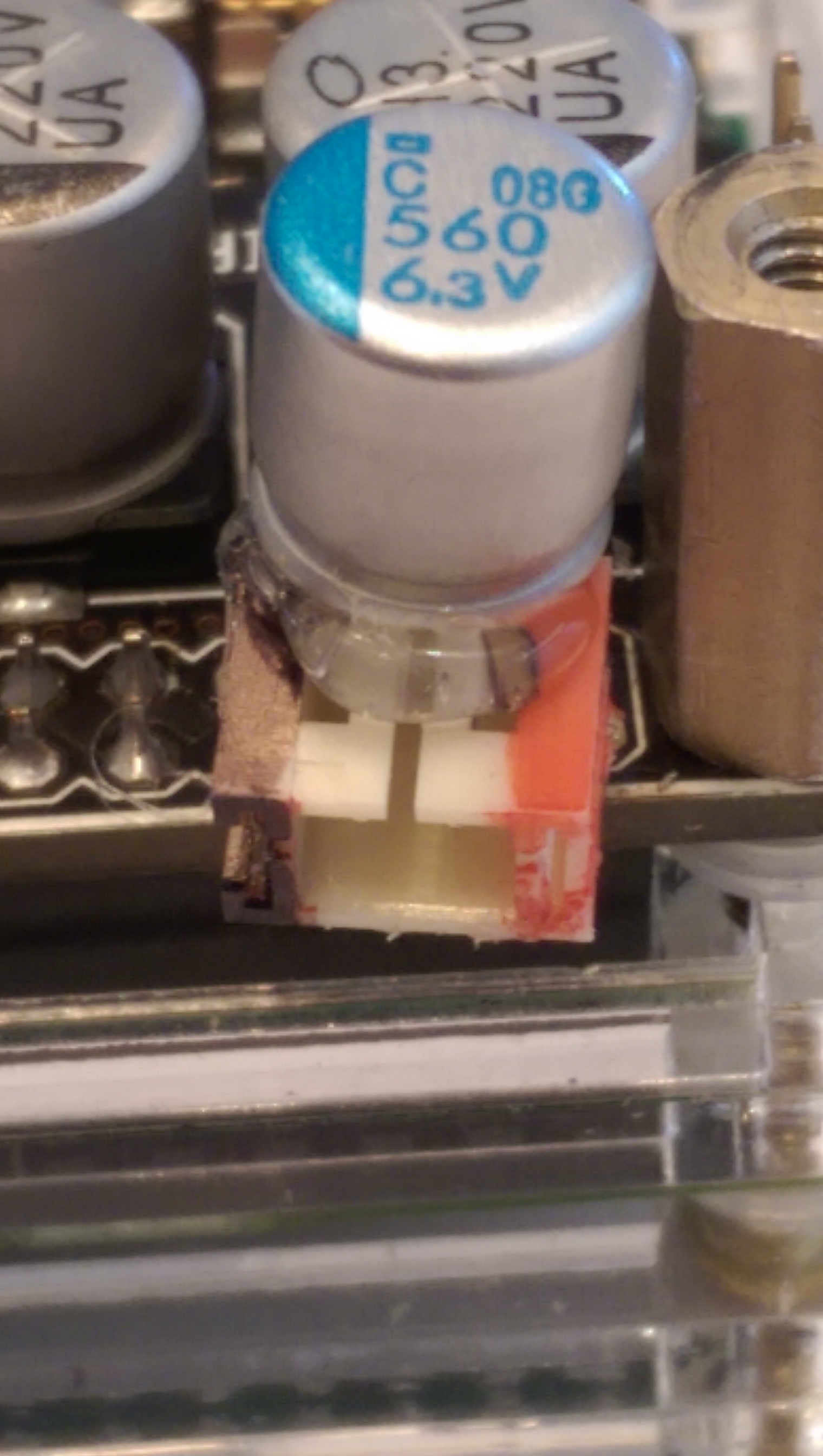

It can also be done by injecting power into the pins of the upper card like Ian's Isolator.
I do this by soldering a small connector to the appropriate pins of the card that is mounted directly. I will often place a 560uf/6.3v conductive plastic capacitor on that connector to help provide additional filtering.
I've attached pictures showing this on an original Mamboberry and a modified HiFiBerry DAC+ Pro. Sorry, I don't have pictures available yet of this on a Kali or Ian's Isolator, but it works well on both of those too.
Of course, unless you can separate the power of the attached card from the Pi power (like with the jumper on the Mamboberry or Kali or by removing a 0R resistor on the HiFiBerry DAC+ Pro or moving one on the Boss), this way powers both the card and the Pi.
OR in the case of Ian's Isolator, it powers the R-Pi side of the isolators.
In my experience, separately powering each card (R-Pi, DAC, and Kali and/or an Isolator if they are used) makes a positive difference in the sound quality produced. For example, when I run my modified HiFiBerry DAC+P (which has separate power feeds for the analog and digital/clocks side of the card) on a Kali on an Ian Isolator on a Pi, I use 5 separate supplies.
I can provide more detailed pictures of how I do this later next week. Please let me know if you want me to do that.
Greg in Mississippi

Thanks Greg for your helpful answer. Actually, I knew about feeding Pi via GPIO header (Pin 4 and Pin 6) when I had FIFO board. But this isolator board is a bit different as they are linked by header connector, so there are no space on Pin 4 and 6 to put power connection in. I prefer not to mess up aka do anything directly to Pi board like soldering. Therefore, I want to ask if I could simply put a connector to Pin 4 and 6 on the un-isolated GPIO, and feed 5V to Pi through it.
I also have some question regarding the capacitor. Do I need this filtering cap if I have good LPS like Salas Reflektor D or LT3042 base PSU? And why you choose a 560uF Cap? I am a newbie in diy, so it will be great if you can provide some detailed pictures 😀
Trung
Trung
Trung,
DUH on my part. I'd forgotten about the non-isolated GPIO... AND that is how I did it. That works and works well.
Short answer on the 560uf cap is that it is likely worth it and cheap insurance. Nowadays I also put a .33F/5.5v Supercap at the plug end of most of my power supply leads as recommended by Joe Rasmussen AND implemented by Allo in their Boss DAC card. Together they seem to work well to provide a better sense of solidity in the overall sound. BUT I am careful where I use the .33F/5.5v Supercap... the upstream regulator has to have current limiting such that it won't burn up with turn-on. The Salas SHOULD be ok with that, but test at your own risk (I haven't yet). This may also be a problem with a SMPS as the raw DC source.
& I'll post detailed pix when I can, I'm pretty busy with work the next 6-7 days.
Did I do a better job answering this time?
Greg in Mississippi
