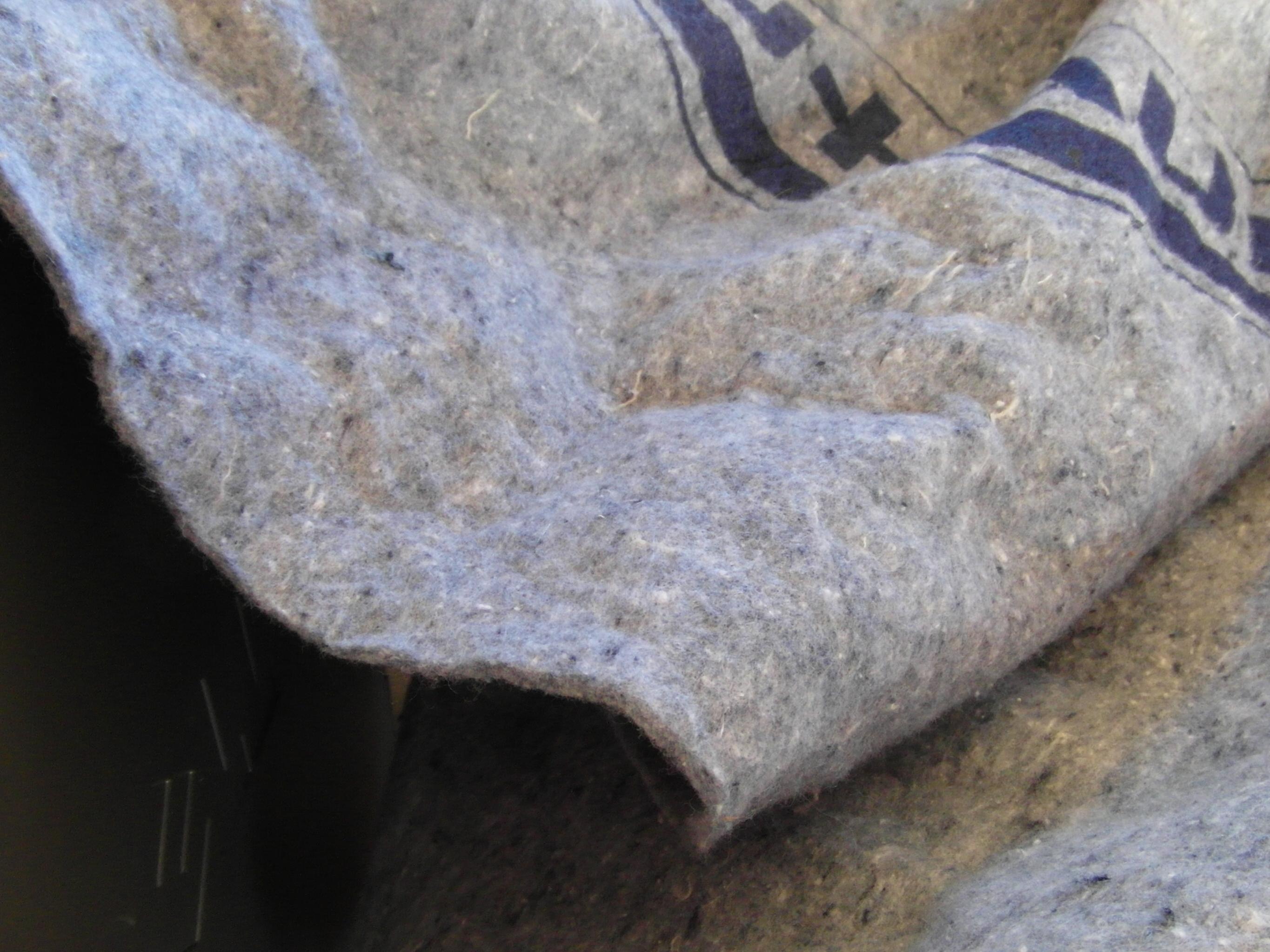

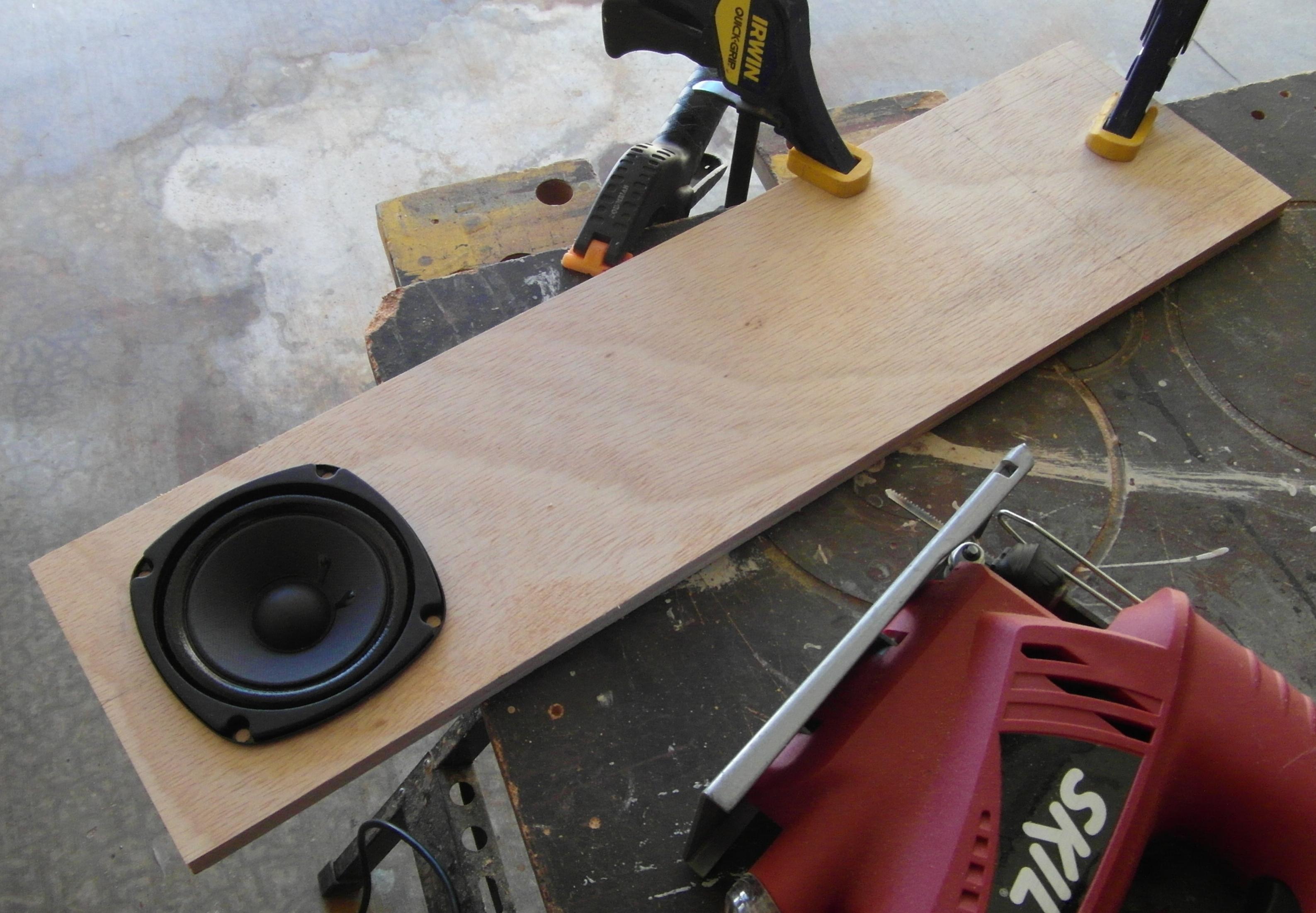

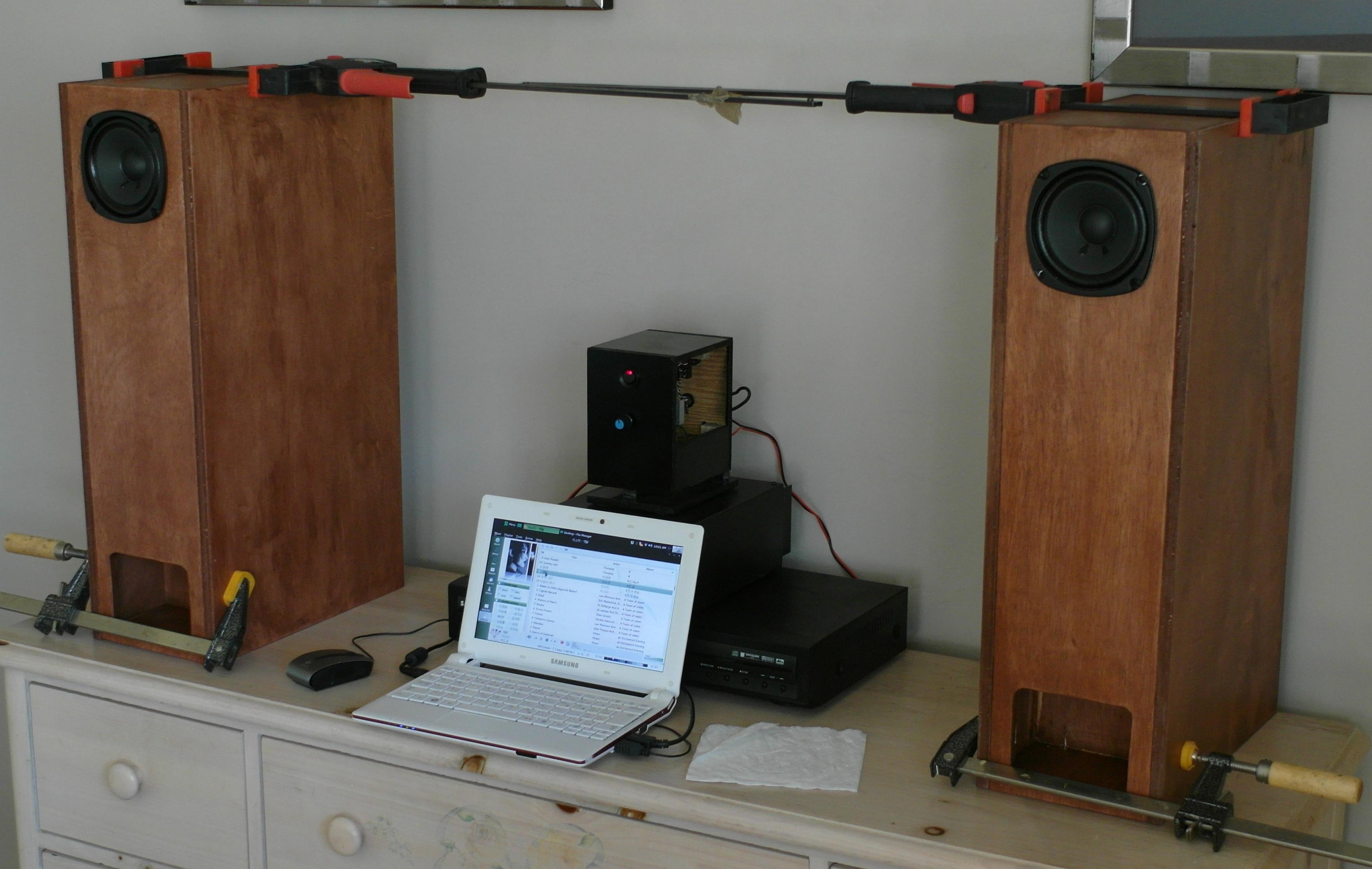

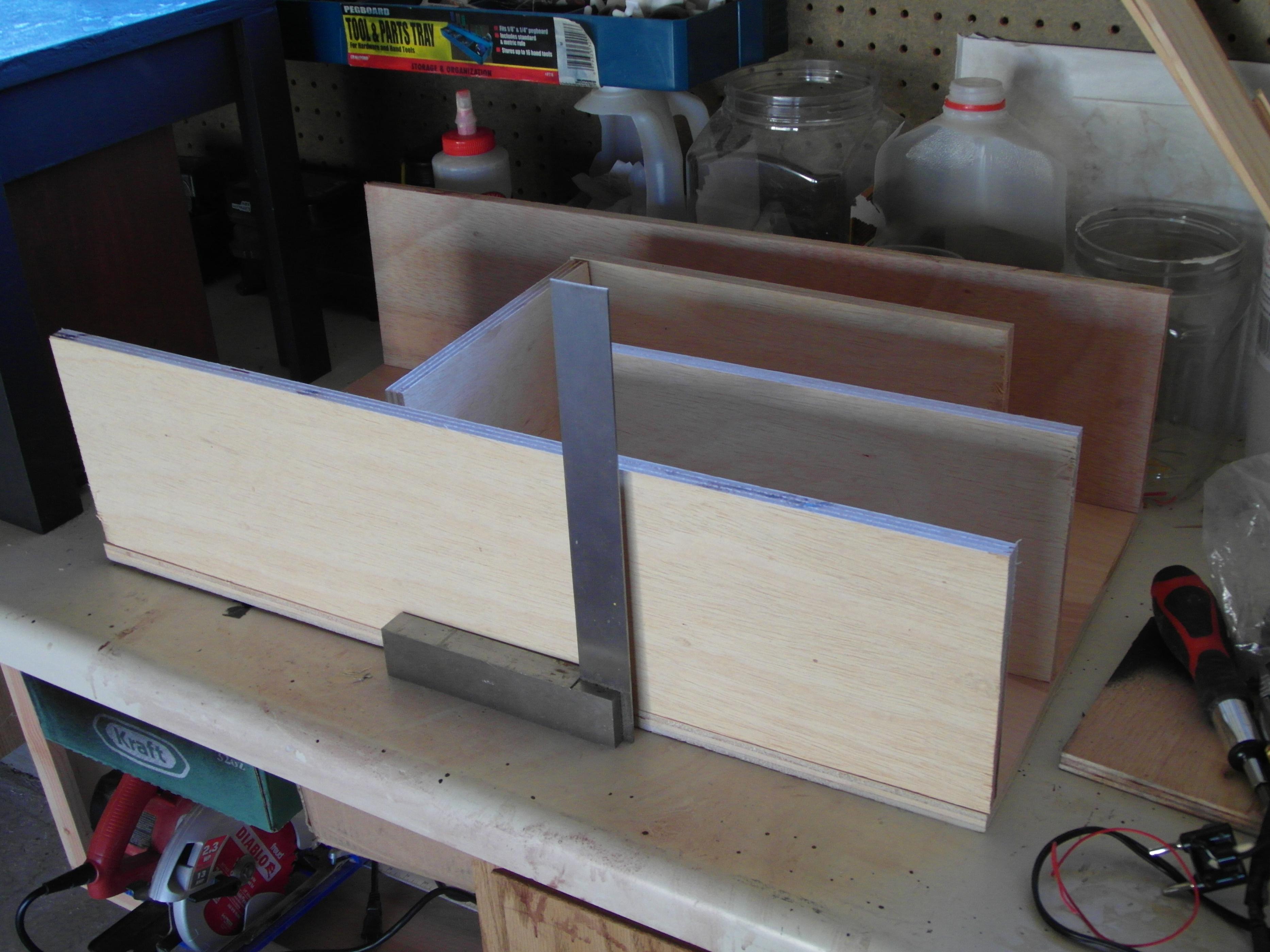

Built the 13mm cabinet suggested by vvxuan, here it is.
Pioneer A11, "el cheapo" speakers I had laying around, new drivers never used, unfortunately long discontinued. I followed the steps and I lined it with the felt pad I had gotten it from uhaul when I moved, no polyfil etc. Works like a charm, lined about 80% of the inside.
First day of listening and sounds full, checked with "online tone generator" and I hear a little rumble down to 50Hz, amazing. Still have to put on finish and going to make a pedestal and make a room in my home...
Here is the video I uploaded on my youtube channel.
https://www.youtube.com/watch?v=8Nw7gtHN39k
thanks vvxuan.

Oh, very nice. Thank gychang for believe me! 50hz for driver only 13cm is very good.
Small Tip for you: One way to record video clips with sound quality is better and simpler. When recording video you should use a laptop with webcam its software.
I have a camera Nikon D7000, when I use Nikon - video good but audio no good. I use web cam on laptop video no good (no need) but audio quite good.
All my video, I used toshiba satellite L645, I think if you use Sony or Aple will better. Very easy! 😀, You try to record your music using your laptop to see the difference.

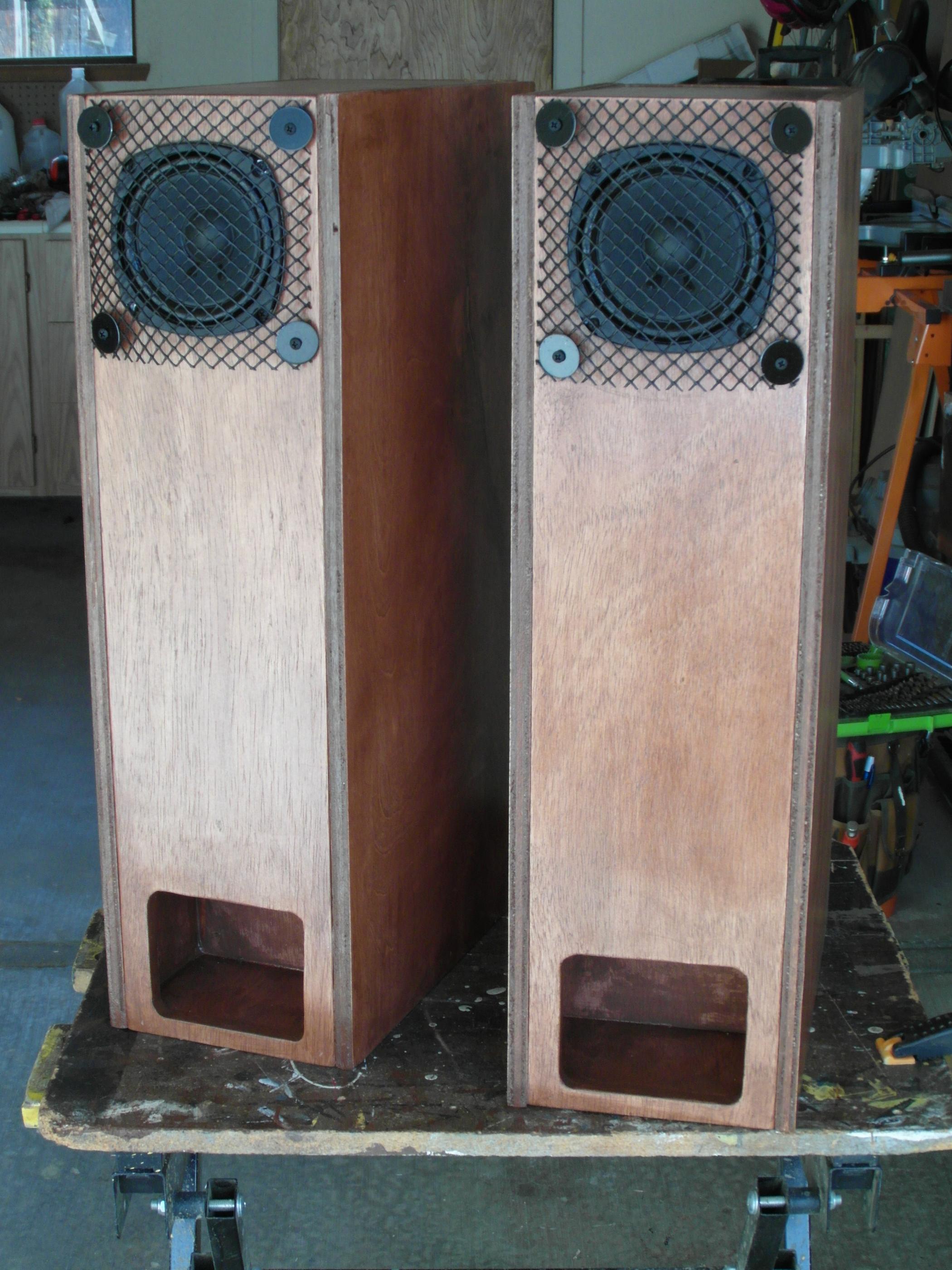

finished product
I put 2 coats of polyurethane and put on the speaker cover of my design. I have a grand daugher who is curious...

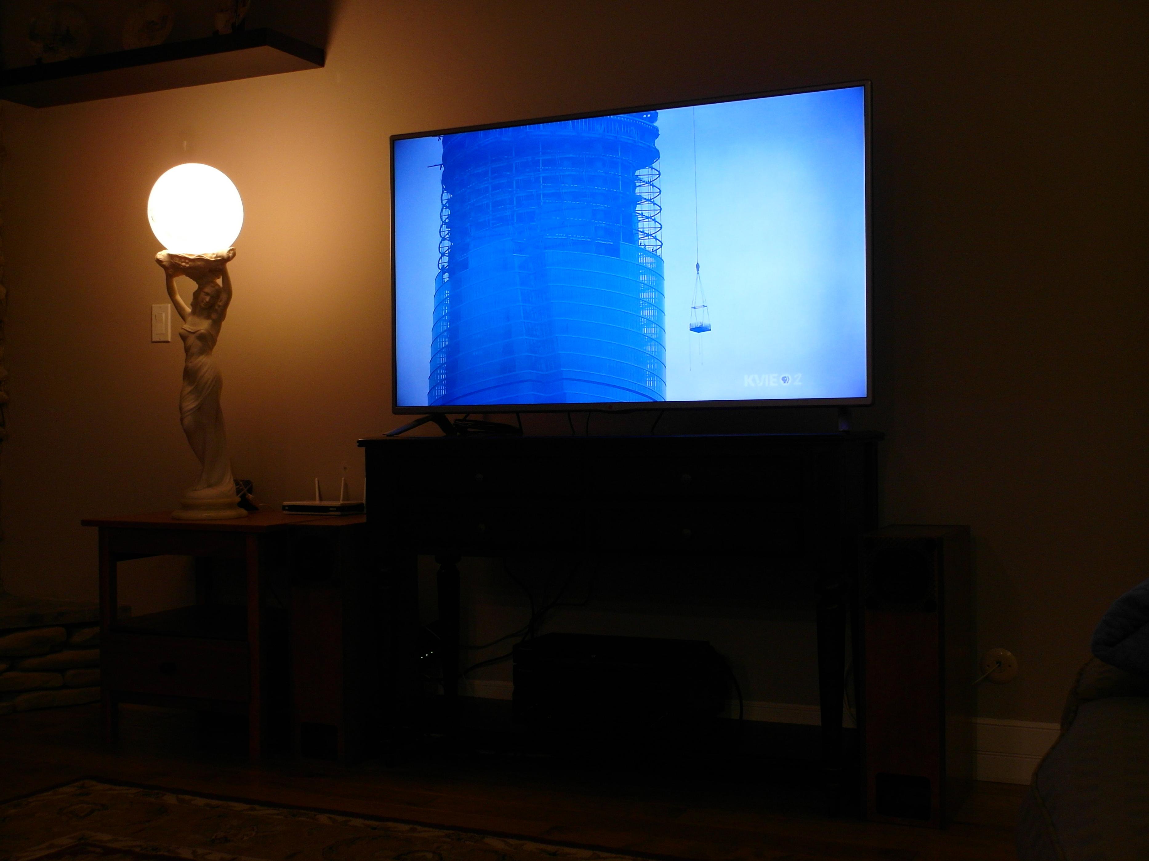

Wife likes the speakers for movie watching, I am thinking these speakers are too low, is there a taller design ( 3-4 feet) for the same 4 1/2 inch driver. Same as these GRS 4FR-8 Full-Range 4-1/2" Speaker Pioneer Type A11EC80-02F 8 Ohm
The picture is dark, TV is much taller than speakers on the sides so I like to a taller design.

Ok! gychang.
How size do you want?

Hi gychang!
I've drawn the design enclosures for 4,5inch type. if you use the 1.5 cm thick wood, the size of the enclosures will be H110cm W17cm and D29,5cm.
