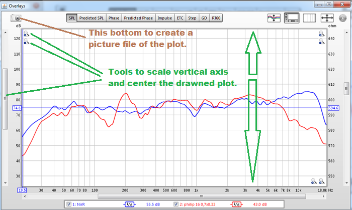

VUXUAN thanks sharing your nice work.
Did a listen your 8" diy box design it sounds good. When comparing sound your box design to the Nirvana design i perceive your design adds a long reverb tail to the kick drum transient and for me this reminds they have a signature as a nice live concert 🙂.
If interested attached is a picture (copy) of one of your plots added some small guide.
Try by exercise to create a picture file directly from REW program instead of capture the hole program window (gives cleaner plot area as the one xrk971 uploaded), first prepare the scale in the plot area with the green tools seen in attached picture and last create the picture file with the brown tool.
For info latest REW now at "v5.01 Beta 24 build 3556" it's free software though needs a user registration profile and active logon. A possibility is try in your current version hit "Help" menu then "Check for Updates Now".
