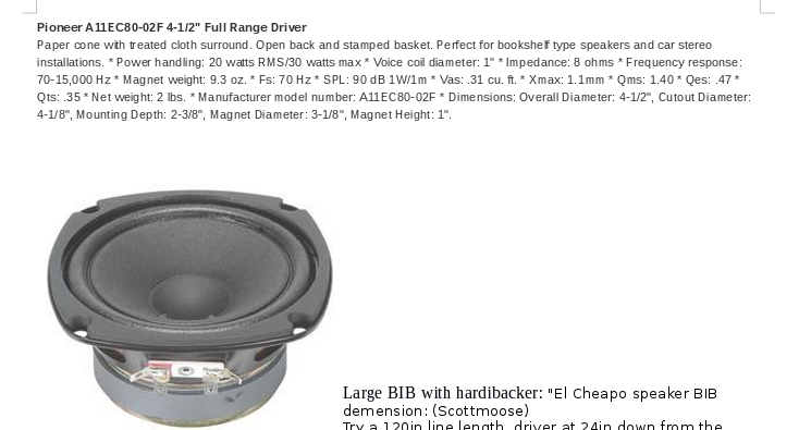

You try to follow my design for driver 13cm, I'm sure there will be good results. If you want a more suitable design for your speakers, you just tell me what size you want your cabinet finishing is how much? (H = ?, W ?, D?).I have two 4 1/2" drivers, which cabinet do you recommend, like to try your design.
I have the same driver as this cabinet I built several years ago and I like that size. http://www.diyaudio.com/forums/full-range/89831-bib-underwear-nothing-top.html
I like to try your cabinet H=60", W:7", D:10", all inches and inside dimensions. Would appreciate your suggestion.
oh, very interesting. Your box is big, you have large listening room. I'm always looking for to minimize the size enclosures, because listening room of every body about 15-25m2. For the speaker driver <5inch, I just do bookshelf type, because it can strip down deep bass, but the music scene that it performed relatively small, to have a wider music scene you have to use the driver with a diameter> 6,5inch.I have the same driver as this cabinet I built several years ago and I like that size. http://www.diyaudio.com/forums/full-range/89831-bib-underwear-nothing-top.html
thanks, will try your 13mm design.
