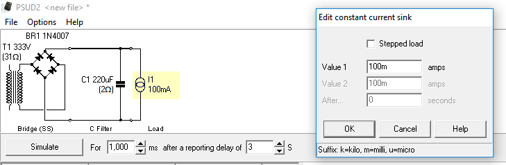

1. Does PSUD compensate for the warmup time of the load on the B+ ?
Example, start with a cold 6L6, EL34, or KT88 as the cathode comes to final temperature?
Zero current at power-up, finally reaching the amplifier's designed quiescent current.
The load on the power supply varies at the same time the power supply caps are charging to final voltage.
If it does not include the slow and non linear increase of output tube current at power-up, then it needs to.
Otherwise, all those fancy graphs are just a simulation.

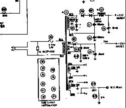

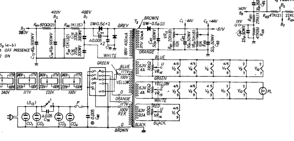

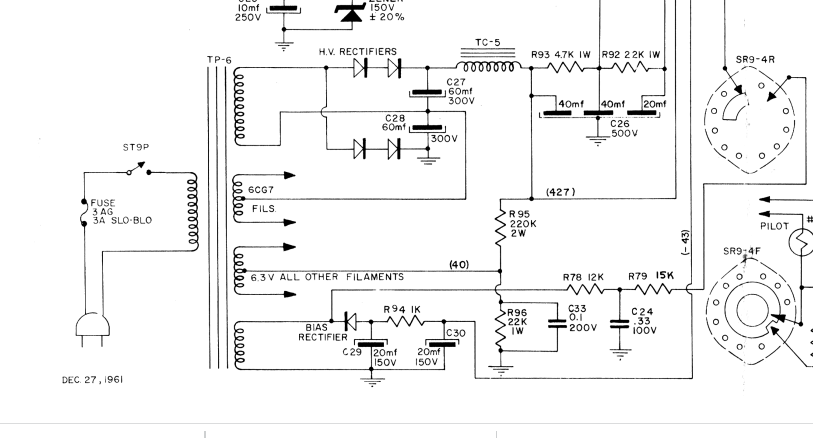

that is why i have stayed away from full wave center tapped power supplies, for me a single secondary with the usual tube rects aided and abbetted by silicon rects....
even better is a full wave bridge used in the Marantz 9, HK Citation II 6500 pp amps and several Japanese amps like the Sansui Au-111...diy is about having lots of fun!!!!

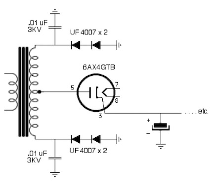

Although the technical aspects are over my head I've been kinda sorta following this thread to the best of my abilities.
On my current breadboard project I'm using a version of the "cockeyed bridge" that Eli Duttman promoted fairly often here on DIY and also at AA. Part SS and part tube using a 6AX4GTB for slow start.
I'd be interested in any comments about such a design and how it compares to others being discussed.
Also, I've used PSUD for basic voltage predictions but not much beyond that. I'm guessing that it is not able to simulate the design I'm using. Or can it?
