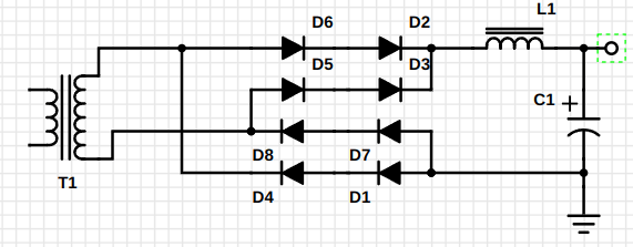

Interesting, in what position did the small mH choke go, just in series with the big L1 input choke or right after the bridge?
Like this?
Bridge --> .047 HV cap --> small mH (high current) choke --> Big L1 input choke --> C1 filter cap --> ... etc.
or like this?
Bridge --> small mH (high current) choke --> .047 HV cap --> Big L1 input choke --> C1 filter cap --> ... etc.
Tom
Like this?
or like this?
3-phase bridge, then .047 cap, 2-300 mH choke, few hundred uF electrolytic caps, designed for 30-35 amps DC (input for a big switching supply). Before adding the cap, we were able to induce diode failure repeatedly with a few hundred AC on-off cycles, pretty much unloaded (< 100 watts).
Capacitor charging current is limited by DC resistances of transformer windings. Choose diodes with enough current capability, and there is no problem. Voltage surge in choke input supply is what kills the diodes, not charging current surge.

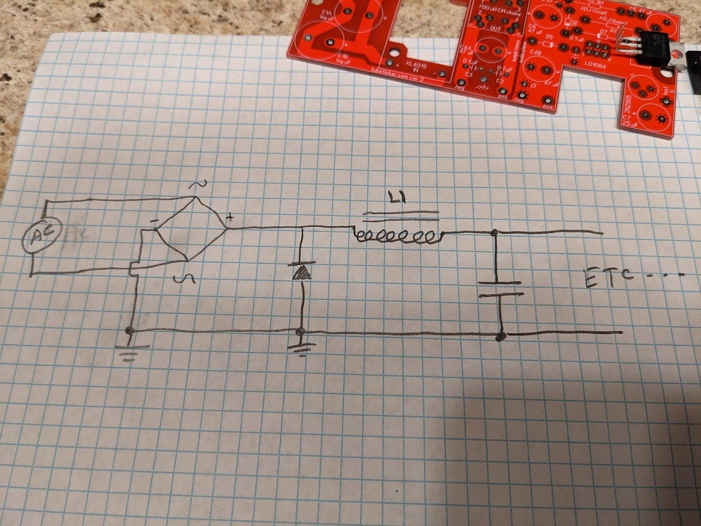

This voltage surge can be killed by a reverse diode from the choke's input terminal to gnd.

"This voltage surge can be killed by a reverse diode from the choke's input terminal to gnd."
I'm breadboarding experiments with SS rectifiers and choke input at this time too. So as simple as this?
Yes, this is exactly what I meant. The diode allows continuous current flow through the choke even during the rectifier's commutation.

Additionally, but not drawn above here might be a pulse rated HV capacitor of maybe .047 - .15 uF just ahead of the diode? Like a WIMA MKP10 3000 VDC? (page 8 on this datasheet).
WIMA MKP10 Pulse Rated Capacitor
Ya, nothing wrong with that. If it's that small, it'll still be "choke input" and it'll just smooth any HF spikes I believe.
3kV is excessive though... 1600V should be ok I think.
