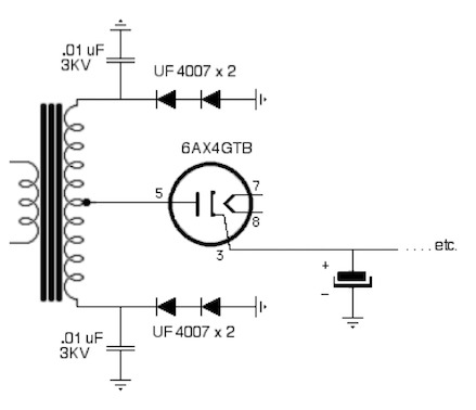

On my current breadboard project I'm using a version of the "cockeyed bridge" that Eli Duttman promoted fairly often here on DIY and also at AA. Part SS and part tube using a 6AX4GTB for slow start.
I'd be interested in any comments about such a design and how it compares to others being discussed.
Also, I've used PSUD for basic voltage predictions but not much beyond that. I'm guessing that it is not able to simulate the design I'm using. Or can it?

The cockeyed bridge should simulate almost exactly - if you edit the rectifier scheme and choose vacuum tube → full wave.Anyone??
Both of these regimes are full wave rectifier where the peak current meets one vacuum diode; the cockeyed also meets two series UF4007 plain silicon diodes, but that difference is negligible.
Similar performance can also be achieved with a secondary winding without CT (so, half the voltage): just build a normal bridge rectifier for it using UF4007 diodes; and then insert the vacuum diode between the bridge output and the first capacitor.
In both cases, the vacuum diode is just a series element of the peak current loop. It prevents reverse currents during recovery-time of the UF4007s, because its very low value of blocking-capacitance; it also softens the forward current pulses (high perveance of the usual vacuum diodes) and it warms up slowly to prevent crash-starting of the anode supply. In other words all the desirable features of vacuum diodes that minimize noise, and produce a gentle startup.

Thanks Rod . . . Any comment on the the SS diode portion? Does the SS / tube combo offer any advantage over a tube only design? Are there any downsides to the cockeyed bridge?The cockeyed bridge [has] all the desirable features of vacuum diodes that minimize noise, and produce a gentle startup.
I ask because, although Eli Duttman often recommended it, I rarely see it being used.

The great advantage of the cockeyed bridge: it offers fullwave rectification with only one vacuum rectifier section. This means that a single damper diode can be used. These are tougher, and lower drop than the usual 5AR4s 5Z4s etc; they often have excellent slow warm up, followed by slow rising ramp of voltage: a great advantage in itself.Thanks Rod . . . Any comment on the the SS diode portion? Does the SS / tube combo offer any advantage over a tube only design? Are there any downsides to the cockeyed bridge?
The UF4007 diodes are known-good for the purpose; they see high voltage when reverse-biased, so two or three in series is a good idea. The little caps are an attempt to protect them from transients; these should be rated for 2000V or more.
Short wiring should be used around each diode and to the PT; the ground ends of the UF4007s should terminate near the cap negative.
Overall, it's a good solution, and can be used with confidence, if you have some dampers and a fullwave PT (with CT).
If you have PT without a CT, similar results can be had with a bridge of UF4007s and the damper between the bridge output and the cap's positive.
