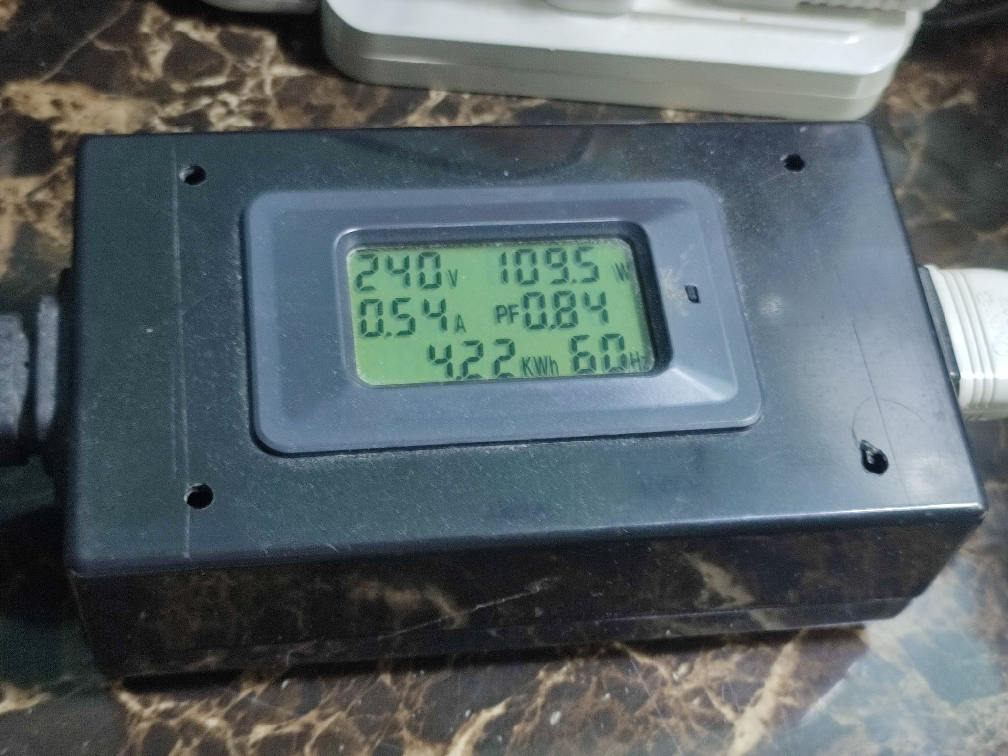

actually in any tube amps, there are two steps the filament heating up and the B+ coming up, filaments need at least 11 seconds to fully warm up, meanwhile the B+ rises to maximum level that it can achieve, then as the tubes start to draw currents, this B+ whilst at maximum starts to drop to the operating level.....
now i dare PSU2 to capture these.....
how do i know? I use a power monitoring device better than the kill-a-wat...with this i am able to observe the power as it is being drawn the the slowing ramping up of power draw righ after the filaments have warmed up and as the power tubes draw plate power....
