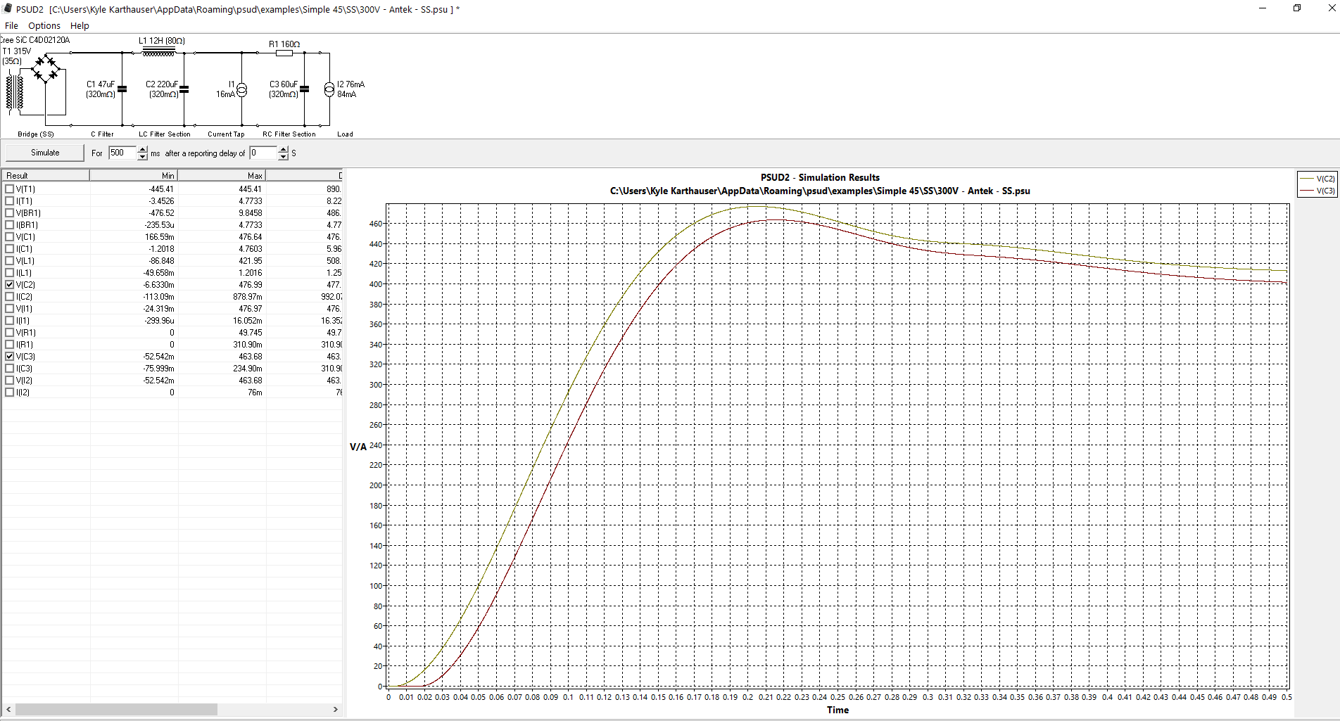

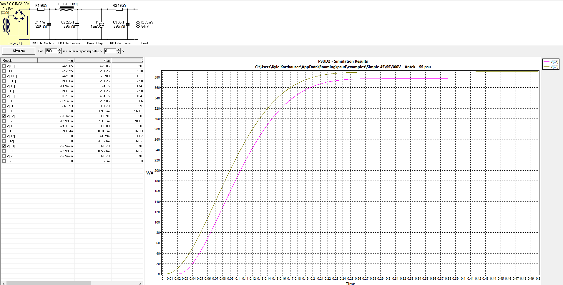

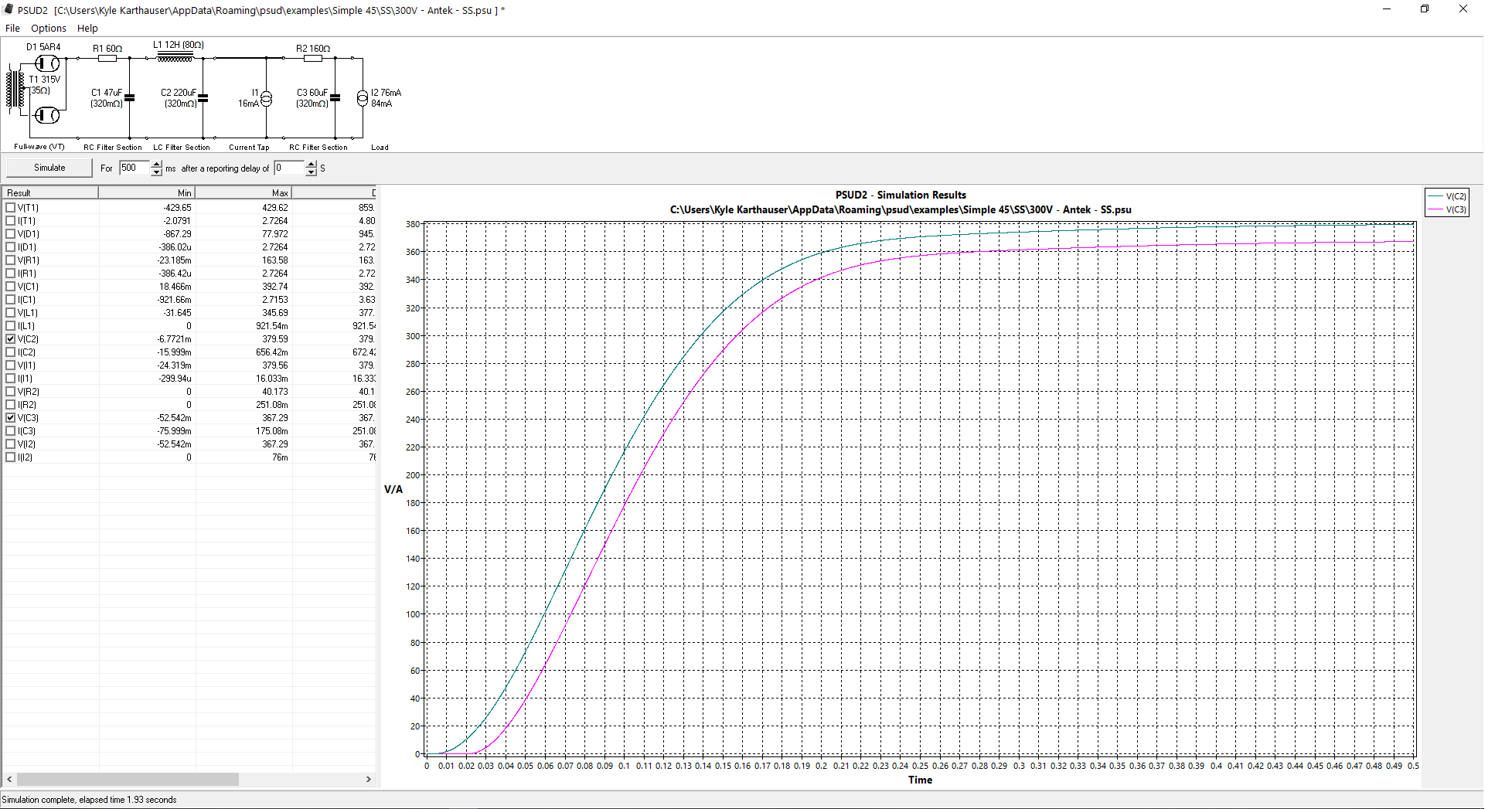

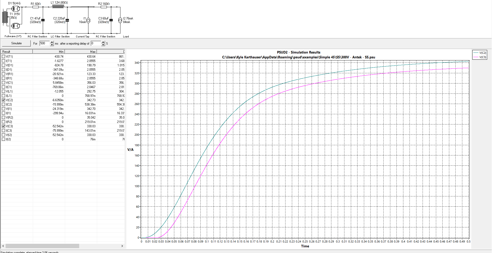

Here's why PSUD2 is so useful.
I am going to attach 4 images.
They show a power supply I am using for a 45 amp with Ale's gyrators. My choke and transformer are Antek and the shown resistance values are as measured. The exact details don't really matter, and in any case, I tweaked the final current draw (the 76mA to 84mA shown) for a small test. Forgot to revert that for these screenshots!
The point of all this is to show what you can learn from PSUD2. I am not an expert and this is just based on my experience in building and optimizing two different SET amplifier circuits (one SS, one 5U4GB). All of my interpretations of PSUD2 output are based on my reading DHT Rob's guide:
https://www.dhtrob.com/overige/pdf/dhtrob_psu.pdf
The curves in the images below are the voltage starting at 0 seconds at capacitors C2 and C3. I show:
Because of my low transformer secondary impedance, a circuit using SS rectification without any added series resistance is not sufficiently damped. You can see this as the "hump" in the voltage plot. This is not something you want.
So I added 60 Ohms in series before C1 and you can see what happens. That initial surge is damped.
Just for illustration, I switched the SS diodes out for a 5U4G rectifier. This is with no other changes. I don't endorse this circuit but did it just for illustration! The ramp up time for the power supply is much more drawn out.
And, finally, a 5AR4. The voltage drop is less AND the ramp up time for the PSU is much reduced.
Personally, I'm really interested in this discussion since I have always wondered what differences would be audible, if any, between a power supply which showed the exact same behavior in PSUD2 but were not the same in construction.
So, for example, a SS rectified PSU that, when you compared the first 1.5s of behavior with a 5U4G rectified supply, looked more or less the same in PSUD2.
This may be hard to accomplish and would require some very different component values (chokes, transformers, resistors, capacitors all would be different, I expect).
Hope this has been informative. If you could get this working on your computer, you could say, "I like the sound of an insufficiently damped power supply." There are some, for example, that prefer AC heated DHT filaments. Some would say that they like the IMD that results from this approach. There is also an approach to power supplies which stresses that the series resistance of the PSU must be as low as possible. The counter-argument to this approach is that what you likely end up with is a bunch of "noise" in your PSU due to under damping.
- Undamped SS rectification
- Damped SS rectification
- 5U4G
- 5AR4

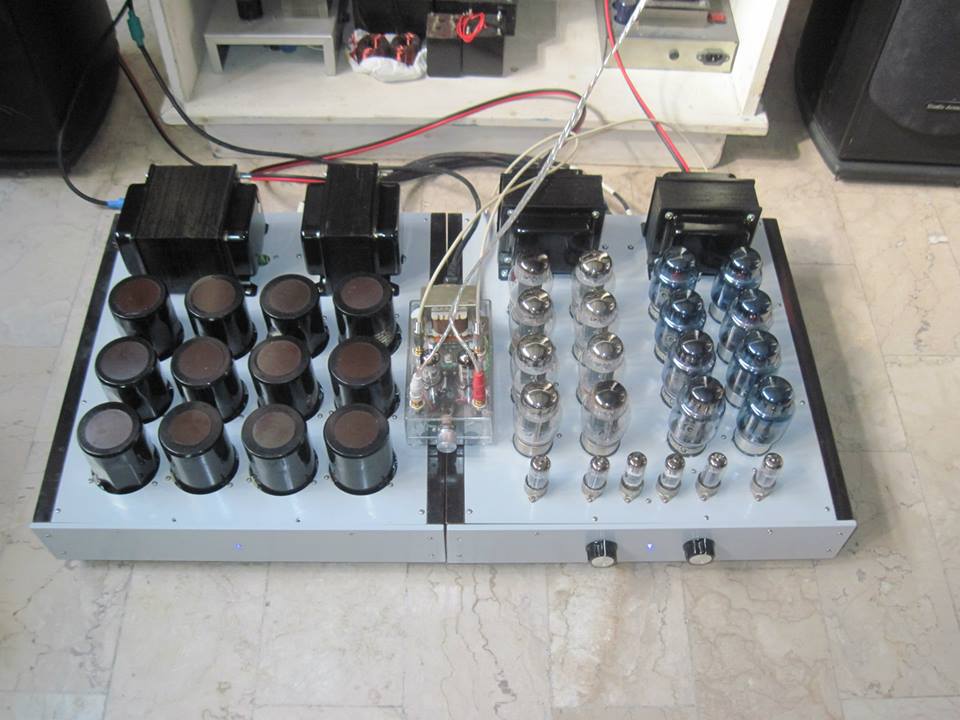

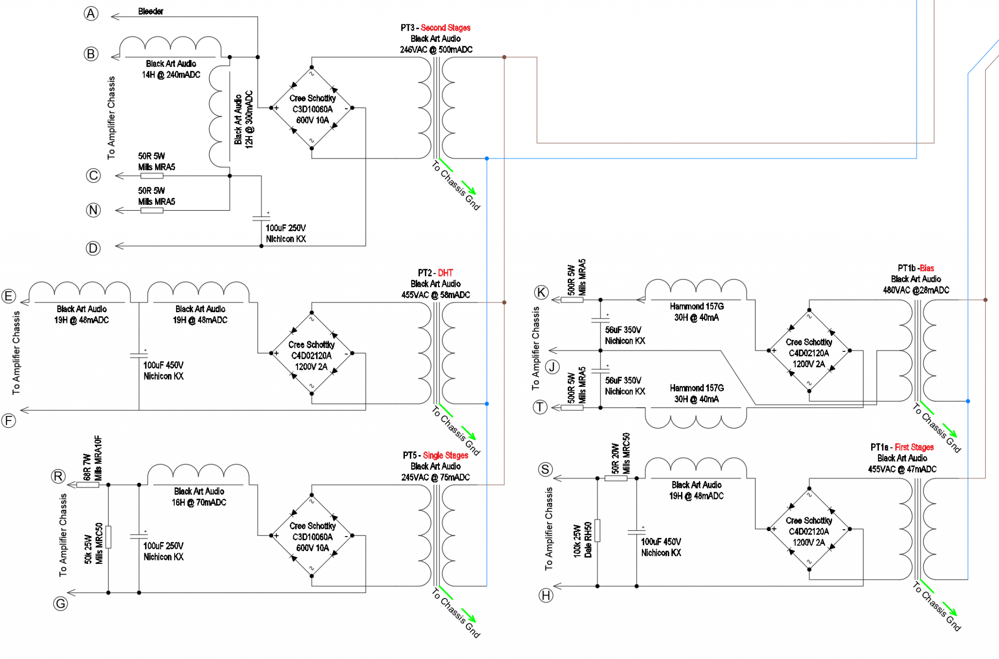

Andy, here is the B+ in the power supply chassis of one of my monobloc multichannel amplifiers:
The Black Art stuff are low DCR elements, oversized cores with minimal temperature gain in use. Tried snubbers but they really had little work to do thanks to those diodes plus they but did raise the impedance of the power supplies which for this build was certainly a no no.

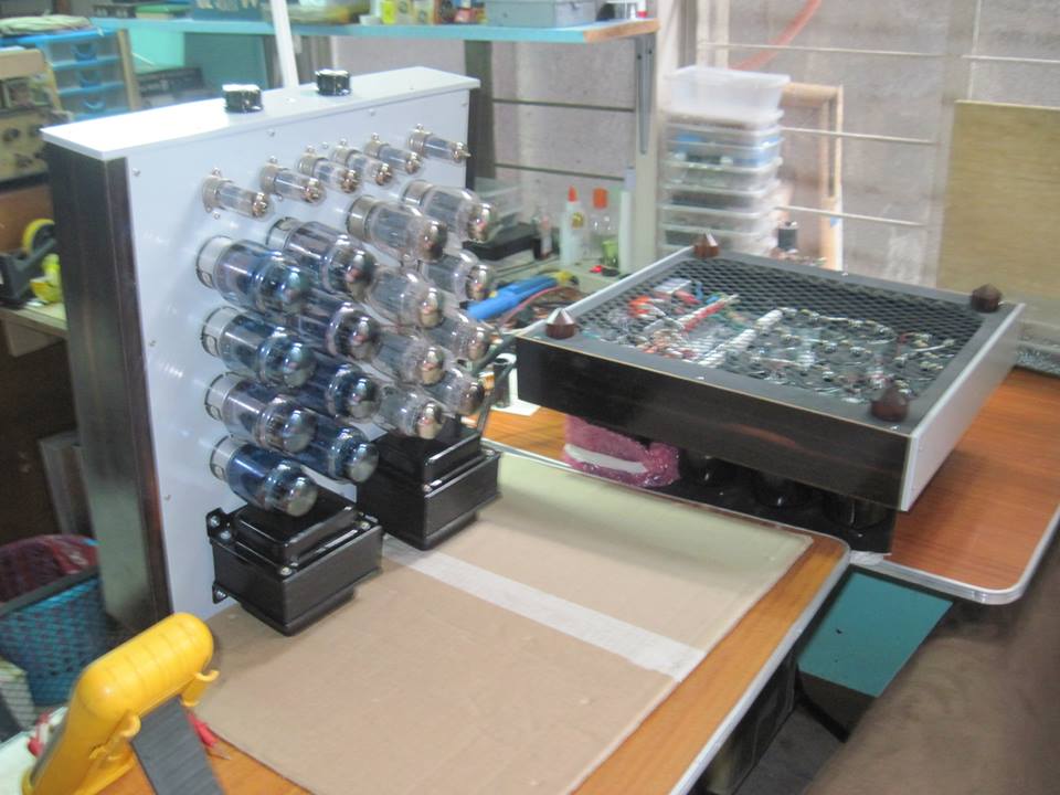

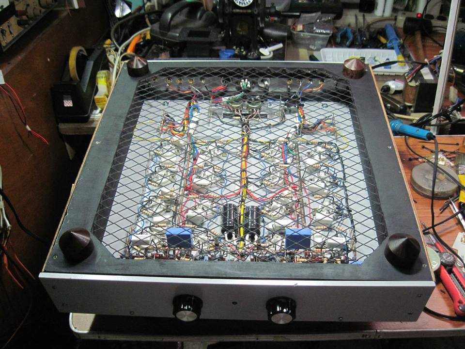

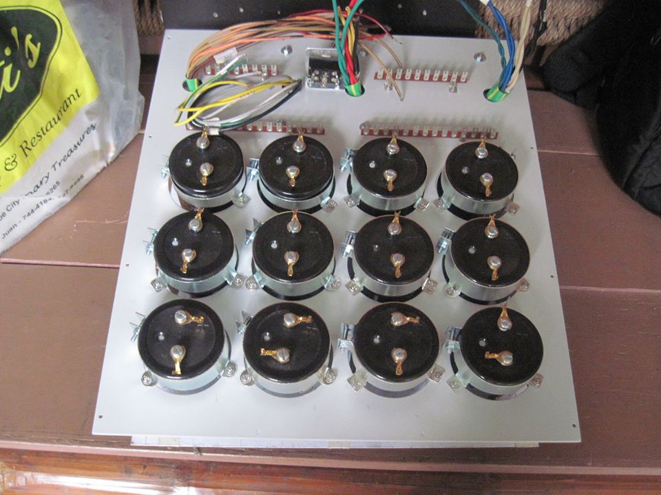

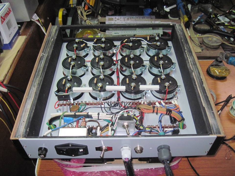

i used a 16A 1000V flatpack bridge rectifier on my 16KT88 triode mode amplifier, the owner was so ecstatic!!!, what tube rectifiers can you use for that?

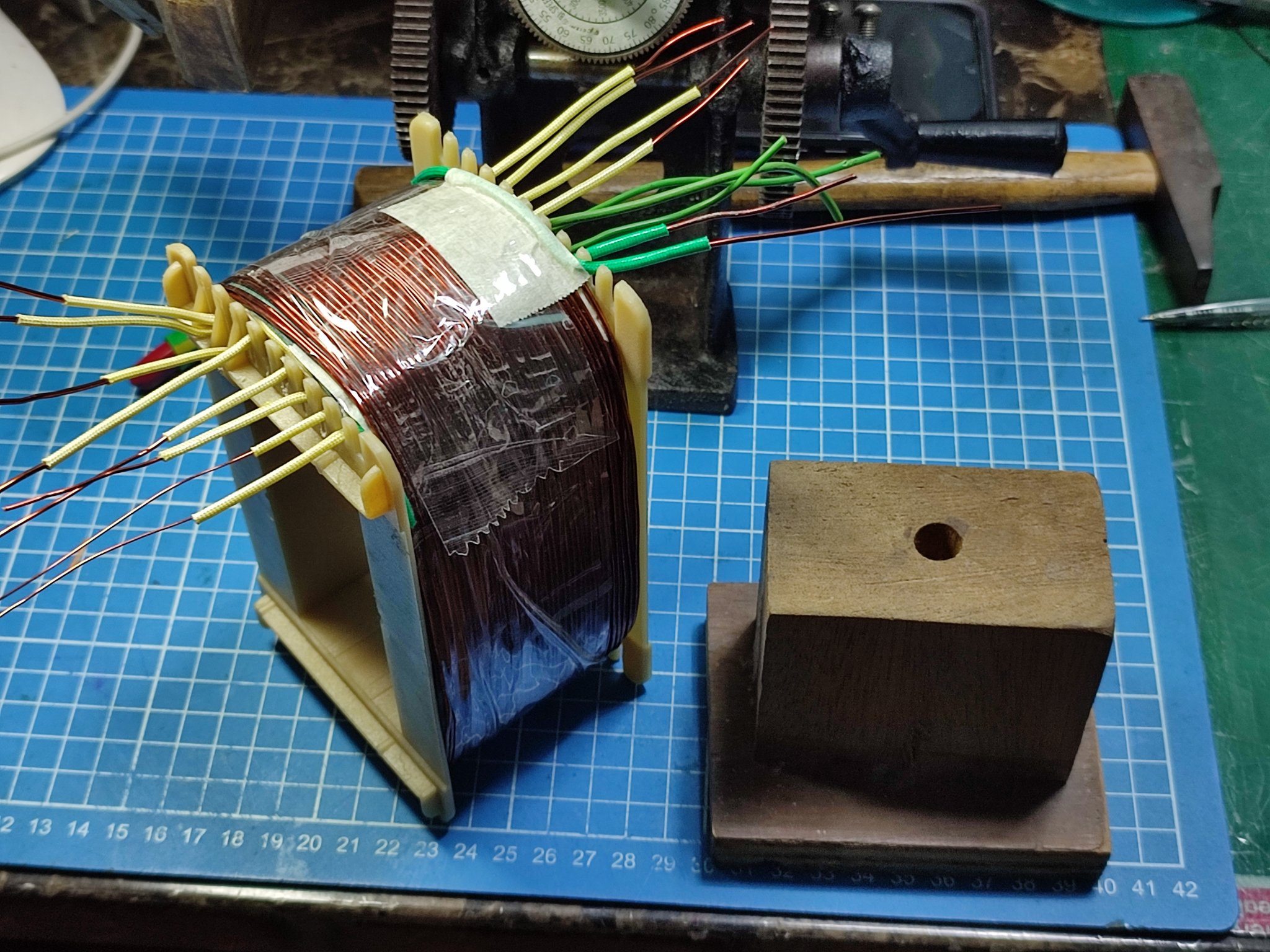

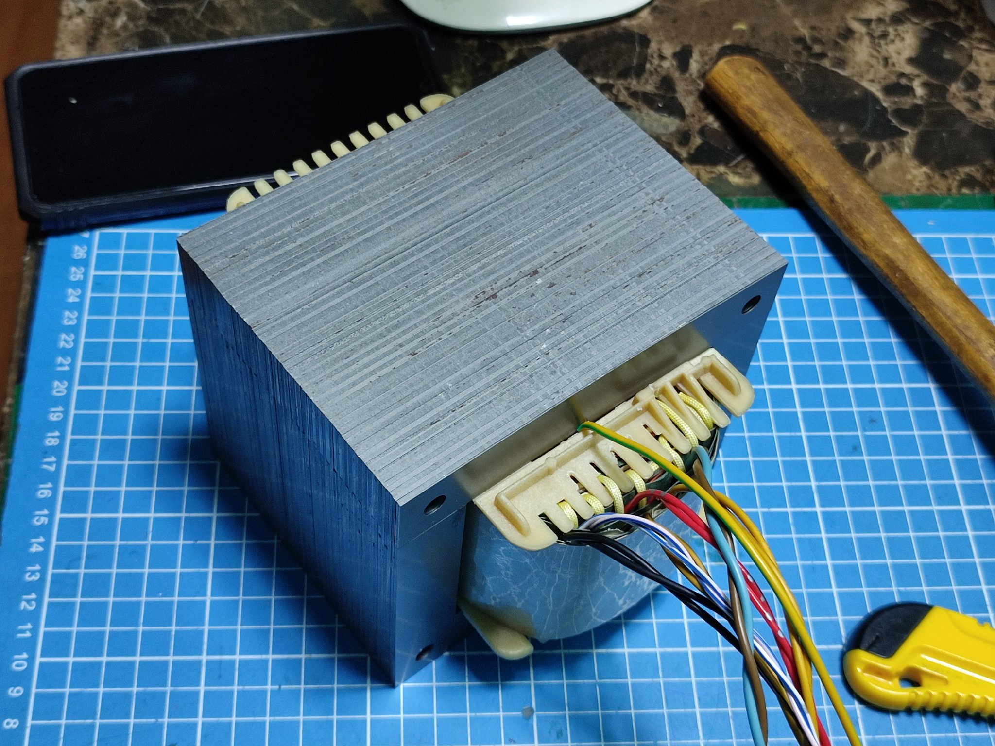

since i make my own power traffos to use in my tube amps, i have forsaken the use of center tapped hv traffos, a single 350vac secondary will work fine even if you use tube rectifiers, this is with the aid of some silicon rectifers...http://www.valvewizard.co.uk/bridge.html
the full wave voltage doublers are even better, used in the Harman Kardon Citation II and Pioner, Sansui Japanese amps followed too...https://www.ampslab.com/SCHEMATICS/LowRes/HarmonKardonCitation2.jpg
the use of the lower voltage of 350vac in the case of the hybrid rectifiers and an even lower voltage in the case of full wave voltage doublers make winding traffos safer, faster and best of all, more economical....
i made a power traffo with the 240vac primary as the highest voltage, followed by the 190vac secondary@2A good for 500+vdc rails...ohis ine has three screens, between primary and core, after the primary winding and after the main secondary windings.....

For the first iteration of my first from-scratch amplifier, I used a CLCLC arrangement that I more or less pulled out of a hat. Initial C was tiny (to cut the voltage), then got bigger as you went on (and bigger was always better). That sort of basic thinking. It sounded pretty bad, as many of you have no doubt already assumed! When deep bass came up in a song, the sound it produced was not unlike that of a car dragging a loose muffler down the street.More so in supplies with multiple LC stages and minimal DCR. The possibility of supply ringing increases dramatically. A damper diode's low dynamic impedance relative to standard rectifier tubes can exasperate this.
PSUD2 helped me come up with something structured and logical. It also allowed me to do that with the components I had on hand. Eventually I abandoned LCLC altogether because it was just so difficult to do right.
One other way I've used it: after straightening out my power supply, I tweaked the decoupling cells for the input stages in the amp as well. (The schematic I was using was the JE Labs 2A3 Deluxe). For example, I went from 20uF decoupling caps to to 1uF, using the basic method I showed above, and found the effect to be what I expected: faster, controlled recovery behavior led to a better-sounding input stage with no meaningful loss of PSRR (this was so late in the chain that this was effectively no longer needed).
The tube b+ is lower and will sag a lot more under load. The silicon diode adds 100mv to the sag after its .7v drop.
There will be a audible difference when the b+ can move 50v when compared to silicon.
