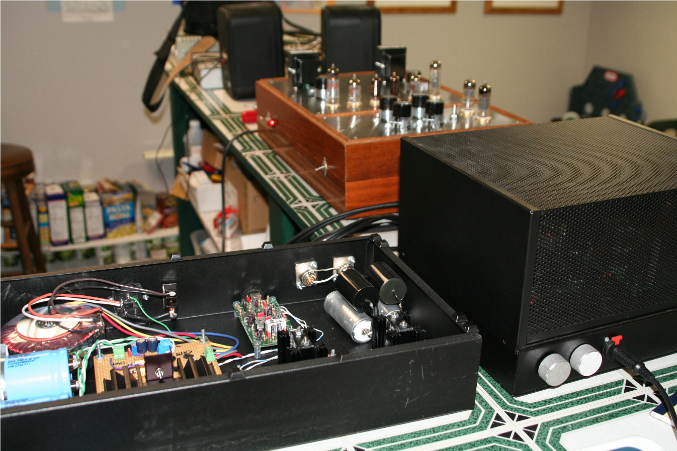

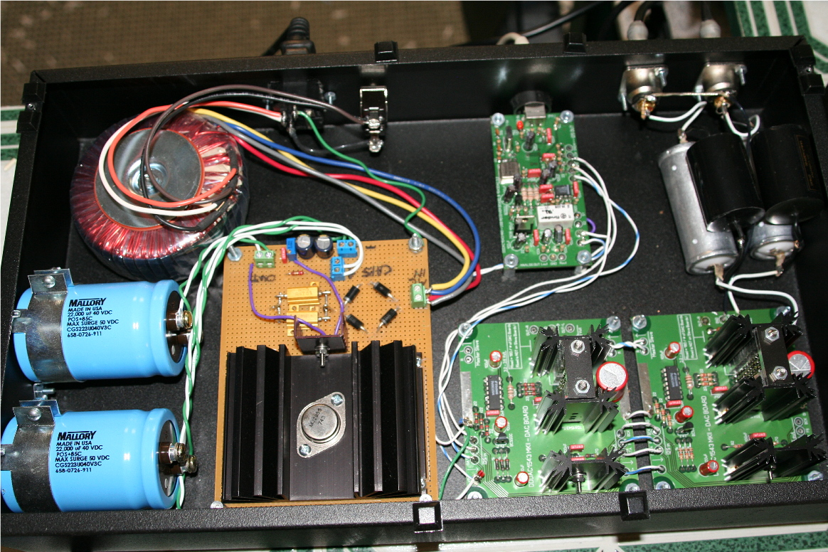

Well, I don't know. Perhaps it has something to do with the way my self build amp is grounded...
But with my own power supply, and even with a different 12V switch supply I had in my parts bin, there is no hum at all.

I've added a few caps too... Rubycon ZL 470uF 25V in the main power line, a ZLH 100uF 16V in the DAC power supply, and a couple of Wima & couple of Evox film bypasses.
But the latest version comes with a Rubycon YXG 220uF 35V power cap, which is good and doesn't require that you change it. It's necessary to remove it to change the opamp, though...
And as I mentioned I definitely recommend changing the two output caps, with more audiophile-approved Wima MKS2 4.7uF like I did, for instance. [...]

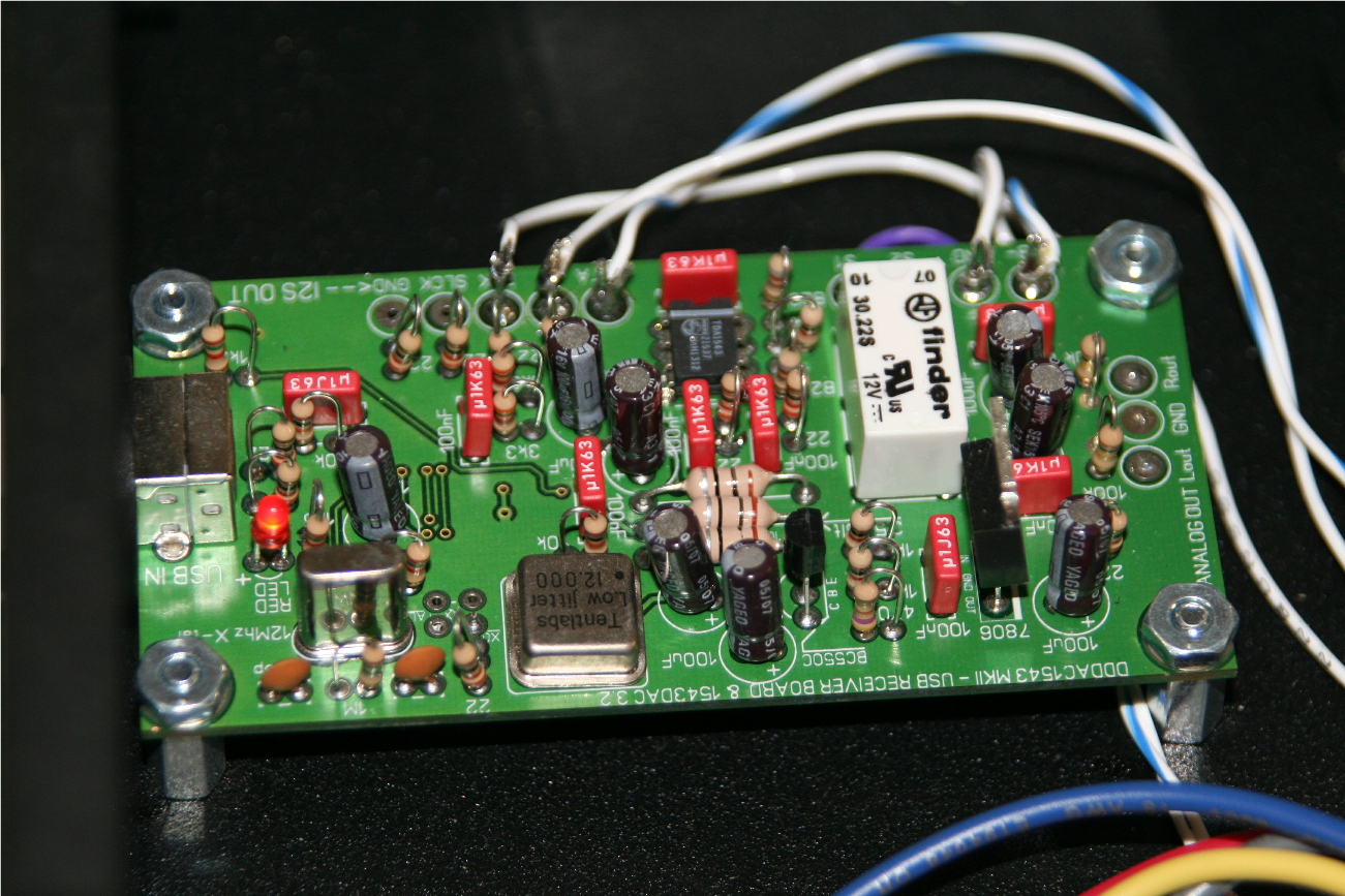

I've had really good luck with the USB interface using Doede Douma's design Description of the DDDAC1543 MK2 project and a 24 chip version of his DDDAC 1543 DAC. For the amp I am using a Cavalli Bijou with Grado 325i's. I've tried other DAC's, but I keep coming back to the DDDAC. I recently built the Buffalo from Twisted Pear, but it paled in comparison. Even more recently I completed "Franks Ultimate Linestage" to use with the Buffalo instead of the "IVY" linestage. While this did improve the Buffalo's sound, it still couldn't compete with the DDDAC. When I added Frank's linestage between the DDDAC and the Bijou, all I can say is wow! Talk about taking my setup to the next level (and I thought I was already close to being there...). I've decided that it will be worth the expense at some point to add 3 more DAC modules to bring the chip total up to 60 and really open the sound up.
I guess what I am saying is that even with the basic DDDAC (12chip) you would probably be pleased.

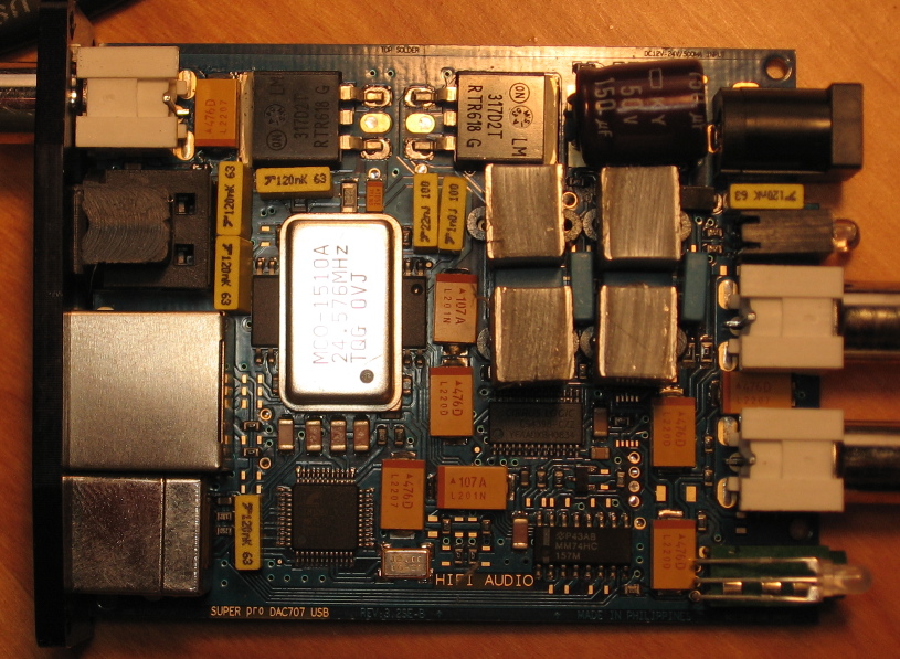

OK, help me out here (I haven't been paying attention)... The super pro is easily modded for superior sound???
In mine, that power cap is a 150uf 50V. Not sure who makes it -- there's no name on it...
The cap looks to be somebody's "KY" series. Legible in one or both of my new pics of the Super Pro board, here:

There's a slight change in parts from Super Pro to Super Pro, as it appears.
Mine had a Rubycon YXG 220uF 35V power cap, which looks a bit better possibly than that 150uF 50V. On the other hand, mine doesn't have the blue polyester caps in the low-pass filtering stage, it just has the same yellow polyesters used elsewhere.
Well I guess you would be more interested in seeing the 2.2uF 250V Solen's made to fit in there!! But unfortunately I have got no decent digital camera, plus I don't want to open mine anymore.

I wonder what these 4 grey block are? Are those caps, and are two of them the output coupling caps?
More important, but not easy to see on your pictures, are there still the 8 holes around the 1364 opamp to solder in a through hole adapter for testing other opamps?
Regarding the cap, no idea what brand this might be. But in my case, I think with a decent power supply very close to the pcb (all in one new case) I think I will left out the 150uF cap completely.

BTW "who makes it" is Poppulse, as I read on some site selling the Super Pro.

The KY electrolytic is evidently a Nippon/United Chemicon low-ESR, low-impedance cap with decent specs.
Don't hesitate about opening up the Super Pro -- the board slides in and out very easily, at least on mine. Pretty low-risk.
Yes, the holes are there for a through-hole op-amp. Andrea could tell us for sure, but you might have to do "op-amp rolling" with the case off. I'm not sure there's enough space to stack: a) a socket b) a DIP op-amp c) the power cap, and still accommodate the cover. You could then take the socket out, solder the DIP op-amp to the board, fold down the cap, and put the case back together. Looks like there's enough room for that....

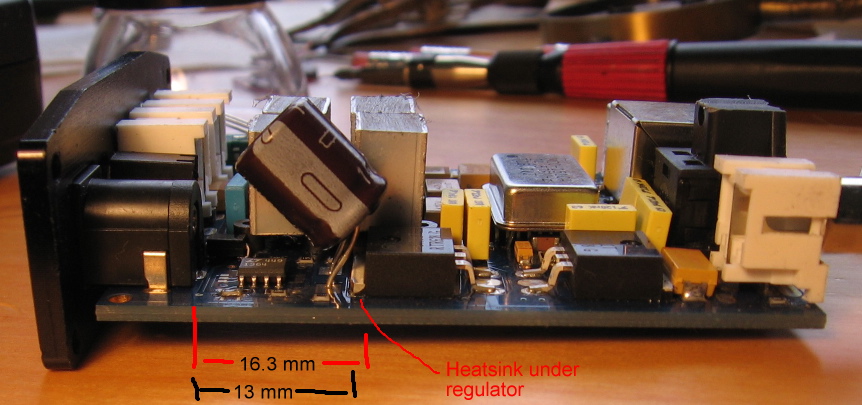

I think that one could fit a slightly longer power cap, if careful about bending the leads around heatsink under the adjoining regulator. See attached pic.

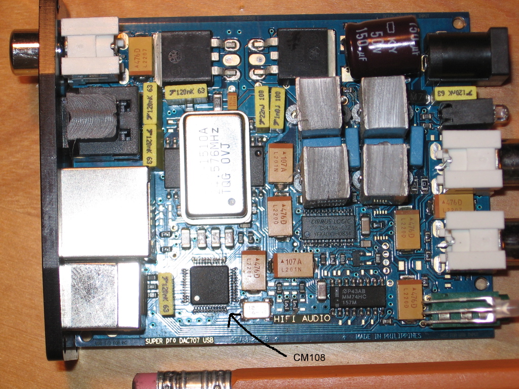

Thanks again to Andrea for information. I would be curious where the other electrolytic (47uf?) was added to the op-amp supply?
In case useful for dating purposes, the serial number on mine (long) ends in 85674....
Yours looks the same version as mine. I had a total of 3 of these DACs 🙂 and the former two were different in pcb layout from my last one and yours. 🙂
There are a few apparent differences though in how the board is populated: the power cap (as mentioned), the post DAC filter caps (as mentioned), plus the uF value of a couple of the chip tantalums (probably according to the different pre-LME317 capacitance values).
That other 47uF 25V (Rubycon YXH) was put in parallel with the larger 470uF 25V ZL. I'm a bit obsessed about the power supply 'speed'...
Ah, BTW a socket will fit well (in the current version of the board). Just mount the power cap towards the coaxial digital input instead of towards the power jack. I went as far as using a 10 x 28 mm (1000uF 25V) Rubycon YXH in one of the older Super Pro's. 🙂

One thing I don't like about this DAC are the RCA jacks. Unfortunately it'd be a little complicated to replace them with others available to me...so I've given up the idea.
BTW, beware... by replacing the LT1364 you're also going to replace its (the DAC's) current sound signature (provided you appreciate it) with something else... more or less satisfactorily.
