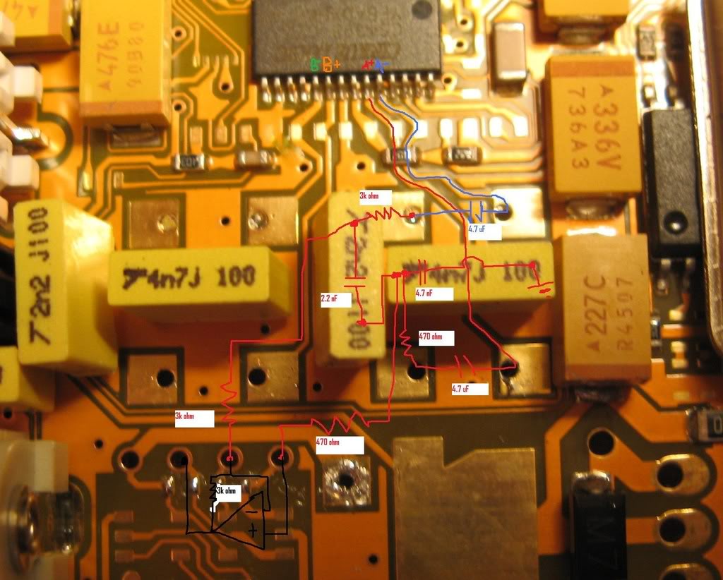

Can you point me where to connect the transformers ?
picture "borrowed" from the Head Fi forum
< DAC 707 Mods - Head-Fi.org Community >

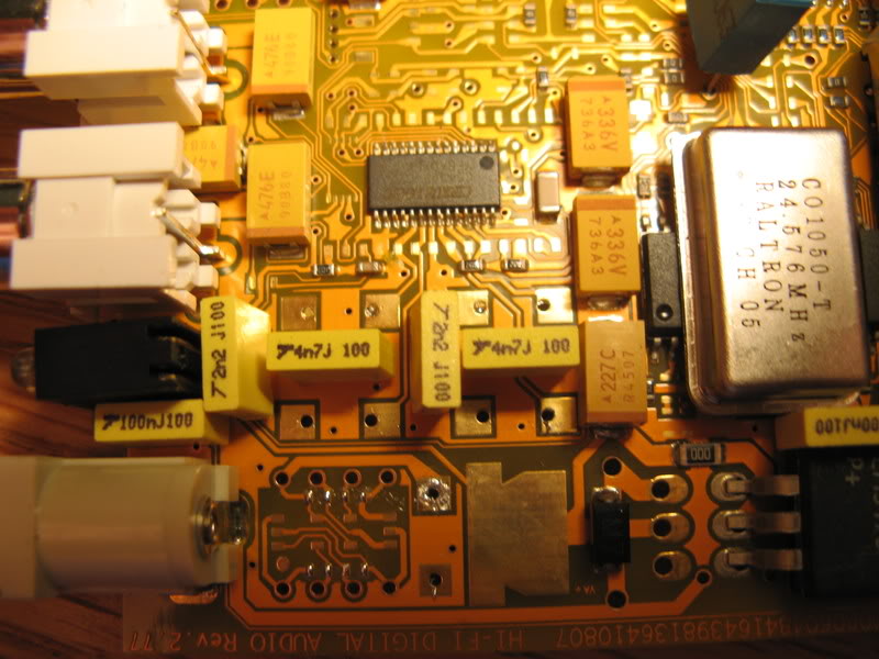

Well, its been a while since I looked at that board. Usually, the output from the chip is routed to the opamps. You can pick up the signal straight after the chip. I cannot recall if this was marked on the 707 board. I bought the ebay board which uses the same chip, but is much easier to tap into.
like, where "RDS" on the other forum marked the chip in this pic ?
oh, and I have to use a step-up to go directly to my cans or does this mod mean I will have to get a headphone amp ?
Actually, the 4398 has 2.5v offset at the output pins if memory serves. If you're just looking to drive cans the easiest way stick with the opamps. If you want great quality then it gets a little more complicated. Buffers, caps, transformers, they all can be used, but you need some kind of buffering for cans, except maybe high impedance cans.
