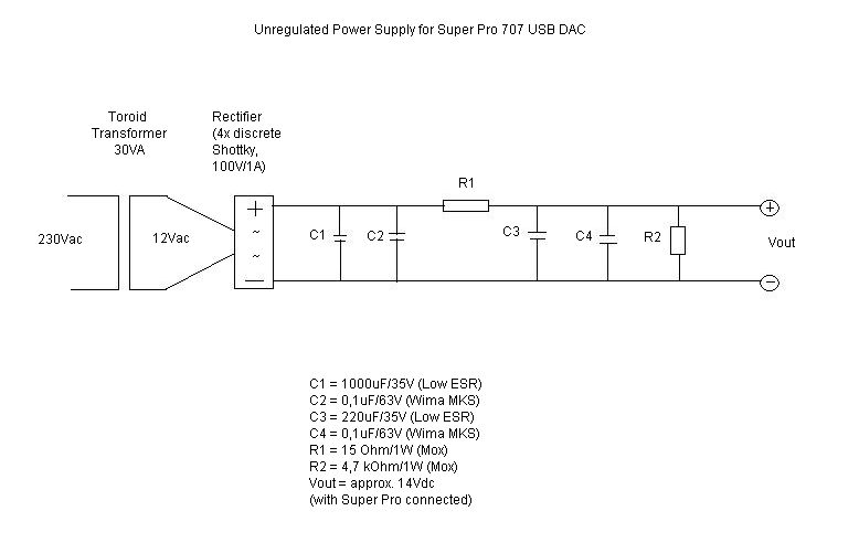

A quick update on the power supply thing.
I tried many different configurations the last days, but now I made my decision. This version sounds by far best to power my Super Pro 707.
It sounds better than all the other ones I tried, including various switch mode supplies, larger capacitors etc.
The sound is open, 3-dimensional, spacious, liquid, groovy, detailed, non-fatiguing, in two words: just great!
A few notes, if you want to give it a try:
- Use only high quality toroid transformers with AT LEAST 30VA rating. It really makes a difference! In fact, I think the transformer is the most important part here.
- The caps can of course be of lower voltage rating. Everything from 25V up is ok.
- Discrete Shottky's are a must!
- The small Wima foils can be of a value up to 1,0uF, if space is no problem.
- The large caps (220uF and 1000uF) should be low ESR types of a decent brand (e.g. BC Components or similar). Be careful when unsing Panasonic FC's! I found them to have a different sound which I didn't like that much (a bit more "holographic", but not as fluid and full-bodied than the BC's).

Thanks for the update, Martin! Glad to hear you have something you like. (The Panasonic FM have somewhat better specs than the FC and IIRC cost no more than they do, btw. Not that these BCs are a bank-breaker. --Which series BC did you use?)

I use BC capacitors of serie 136. I would not at all say that the sound is "overly" bright. I just find it to be a bit more on the bright side than on the dark side of neutral. The overall sound is indeed very good, and in the end it's a matter of personal taste. But to me, I would love it if the sound becomes a tad more dark and weighty. Than I would be totally satisfied, I guess!

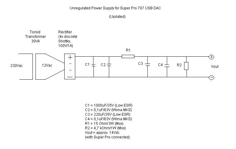

Important update!
IMPORTANT UPDATE!
I don't know if anybody of you wants to try the kind of unregulated power supply I suggested, but IF so, please:
Use a 3W/15Ohm resistor in place of R1, not 1W!
The 1W resistor runs pretty hot after a few hours. So use at least 3W here, like I did in the first place!
Thanks!
