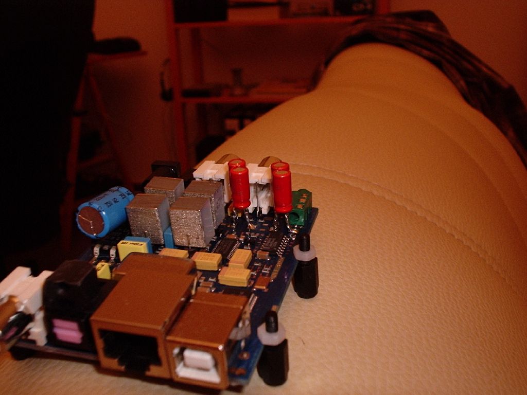

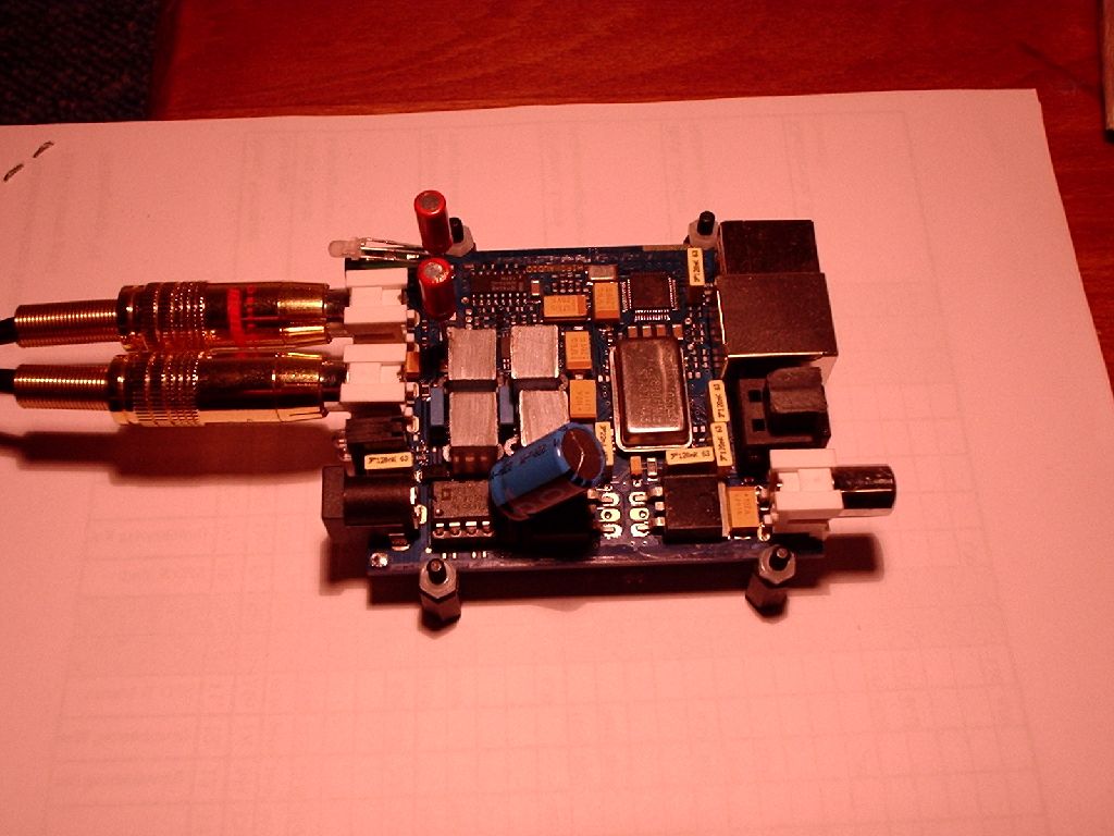

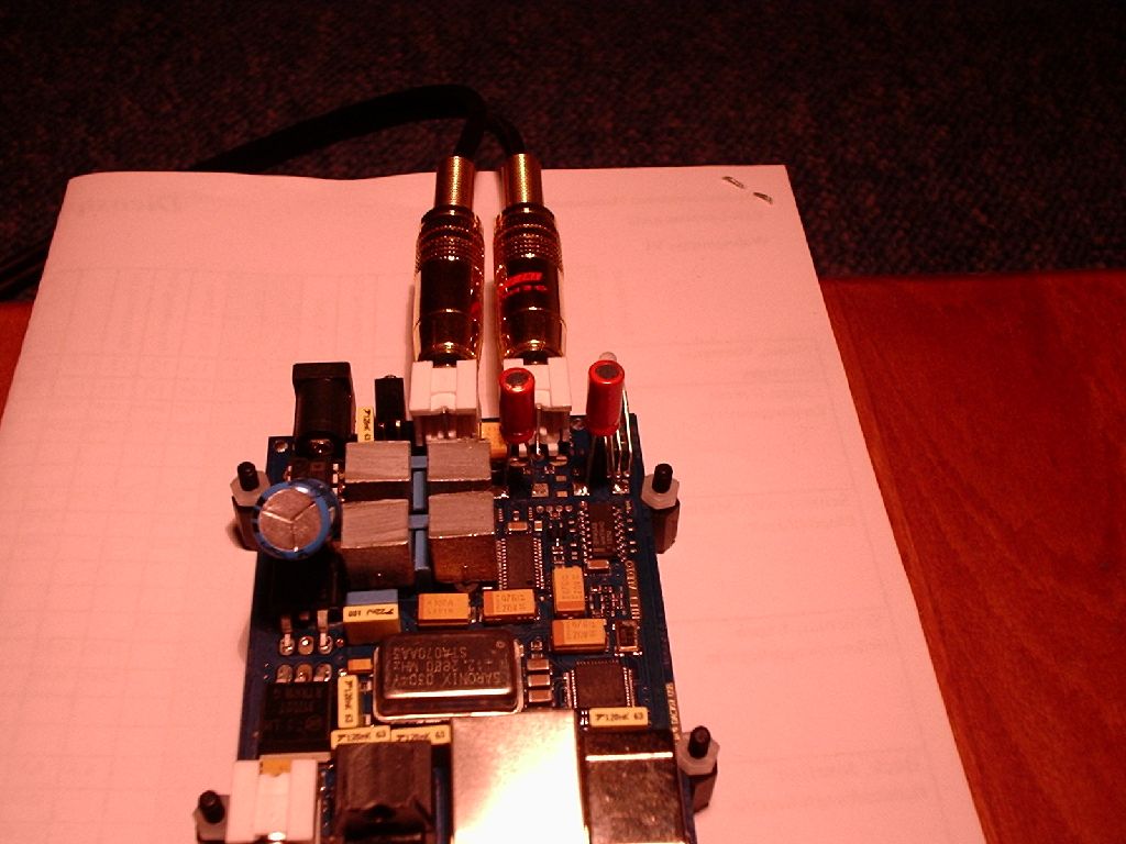

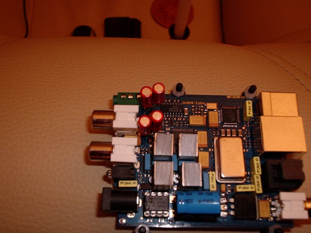

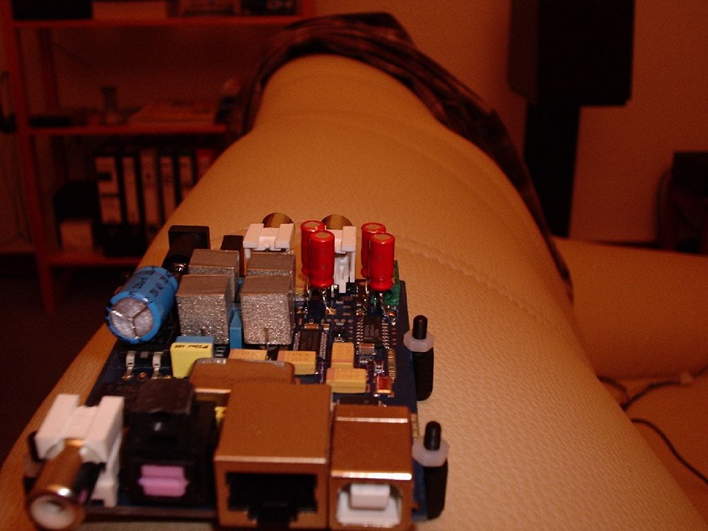

Can you post pics when you get a chance? Selfish request, admittedly. (Curious to see the replacement output caps and power supply cap.)

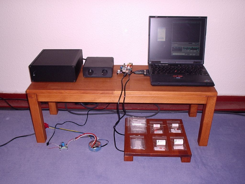

Pics, yes! I will shoot a few. I will post them in a few minutes ;-)
Martin

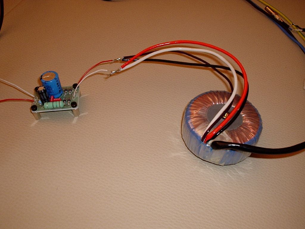

There you go...
On picture 1 you can see the whole rig playing.

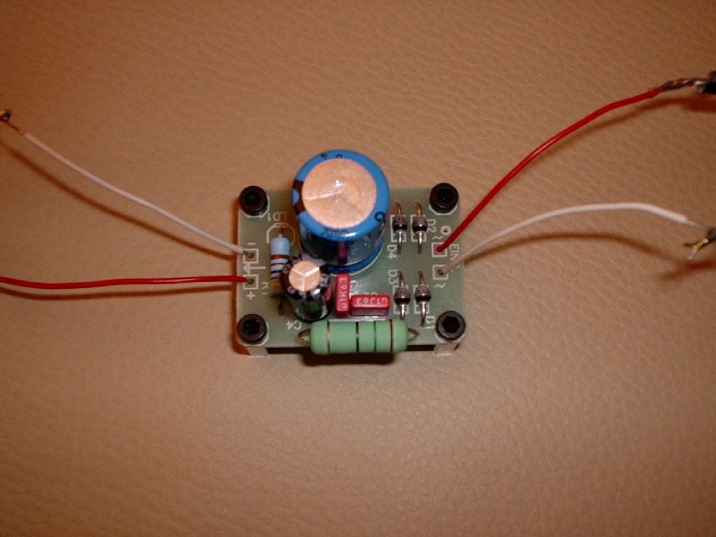

Then we have the power supply. I bought a pcb which was originally intended to be a simple regulated supply for a 78xx type regulator. Unfortunately I couldn't use the BC 136 cap in place of C3, so I had to go for a taller cap with less diameter, but it's a low esr cap, too. I used the BC 136 in 220uF on the dac pcb.
The trans is a high quality toroid from Sedlbauer, made in Germany (I now, means nearly nothing these days... ;-) in 30VA/2x12V (secondaries paralled).
Then we have the dac with the BC cap, the DIP8 socket and the OP275. And of course the two BG N 4,7/50. But later this evening I will solder in a second pair of BG's for a super-e configuration, which is imo really much better sounding than a single pair.
I'm really sorry about the lousy quality of the pics, but my digicam (model "Old'n'Cheap") really sucks!

(Thanks for the great pics! Very enlightening. Everything looks excellent. Fitting different output caps seems easier than I expected.)
