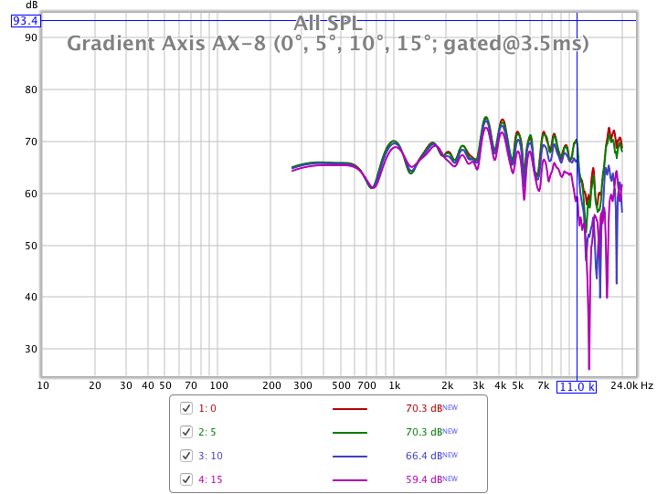

Here's the response of the Gradient AX 8 measured by a German online magazine. Very low variance between 0° and 15° which gives you a very consistent response over 30° which is outstanding for any full range driver. And if you're 50+ the huge dip at about 12kHz doesn't have any detrimental effect anymore 😉
Source https://www.lautsprecherbau.de
Waiting for one of these to arrive. Can't believe the HF is really that good.
...and it isn't that good. Someone obviously confused 5° and 15° 🙂 This is what the driver looks like in a very bad test box laying on the floor.
attachment.php
Frequency variance around 0° isn't bad and on par with something like the Seas FA22RCZ. Huge hole between 11 and 16kHz though.
