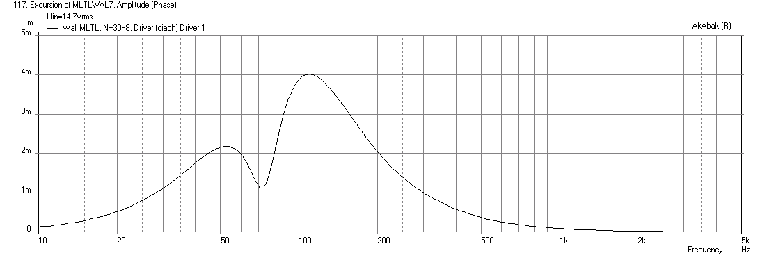

Here is a wall mount MLTL for a A7.3 that with a 120Hz BW2 HPF can get 102dB. Still not 105dB at LP but pretty loud.
http://www.diyaudio.com/forums/full-range/260758-full-range-wall-home-theater.html#post4028642
On paper (Akabak) assuming 13.7 volts to reach 4mm xmax and -12dB/oct Butterworth HPF at 120Hz is applied. It's currently my office speaker at work so can't really crank it up there to measure. This will provide an f3 of 80Hz.
Note that 102dB is 20w more than the rated 20w thermal max, so I wouldn't keep it there more than a few seconds.
