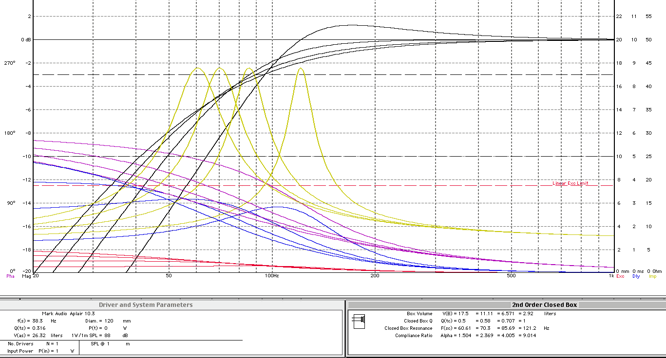

… Alpair 10.3. Any idea on the internal volume of a seal box and how low it would go?
About 6 litre for Butterworth Q, F3 ~86 Hz, F10 ~52 Hz.

Dave, thanks for the graph and the specs for the 10.3. If I have a clue of whats going on, here are the dimensions for the box (internal):
6L = 366.142 inches cubed or (14.5W x 8.4H x 3.0D)
Not sure what Butterworth Q, F3 or F10 means. But I assume the 10.3 will play down to 86Hz, which I'm guessing, should be fairly easy to mate with sub(s).

Q[tc] is the system quality factor. Which isn't quite what it 'sounds' like -essentially it's a mathematical descriptor of the low frequency behaviour of the speaker.
Qtc = 0.707 is Butterworth or maximally flat, which is what it sounds like: it's the flattest alignment available inasmuch as it stays flat to a lower frequency than any other sealed alignment.
Qtc = 0.577 is a Bessel alignment; it has the quickest settling time after an impulse
Qtc = 0.5 is critically damped; no overshoot after an impulse
A Qtc value > 0.707 is under-damped and will have a peaking LF response -how much so depending on the specific value. The higher the Q, the greater the peak.
F3 = the -3dB LF frequency under anechoic conditions unless otherwise specified
F10 = (surprise! 😉 ) the -10dB LF frequency under anechoic conditions unless otherwise specified
Short version: the smaller the box, the higher the system Q / system resonance, and the higher the F3 etc.
Note the caveats regarding anechoic conditions; in practice you can expect there to be some lift due to room gain, so what is maximally flat in an anechoic chamber will not be flat in practice. The values here are system Q, so any series resistance from speaker wire / the output impedance of the amplifier needs to be considered.
