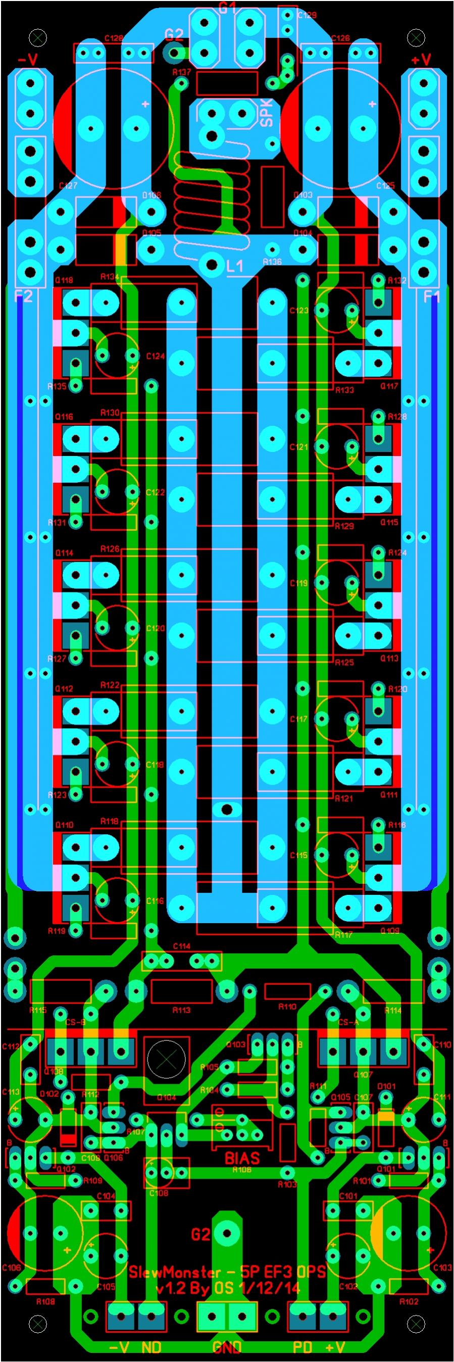

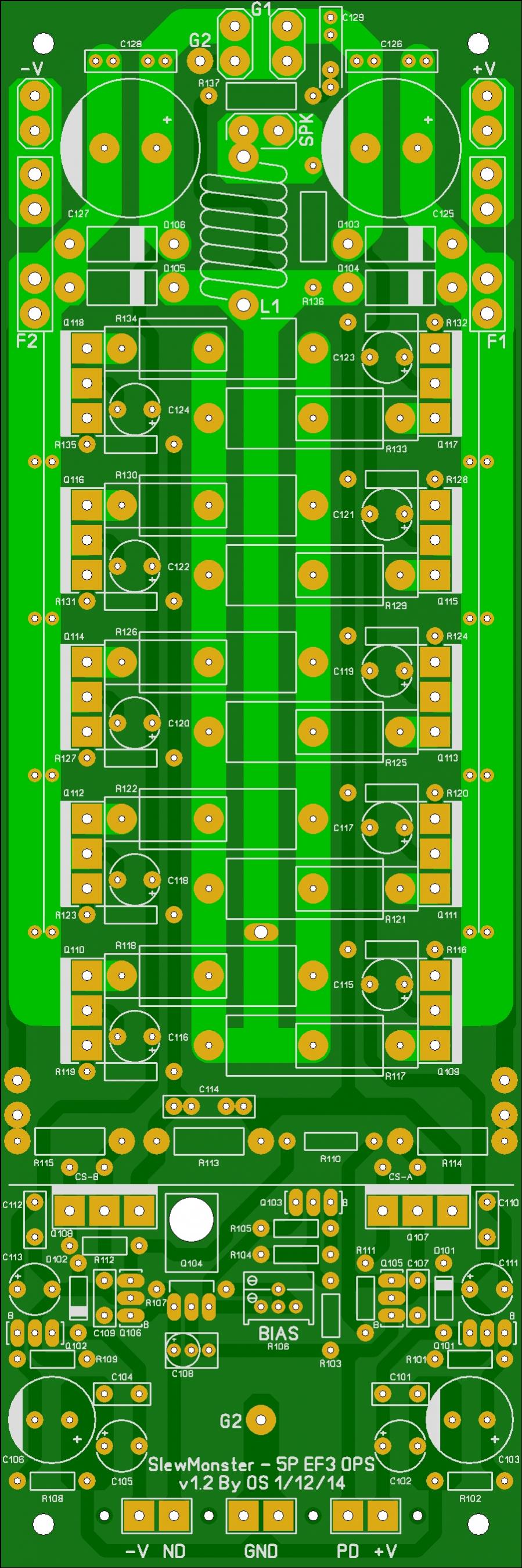

Creepage ...
We MIGHT see 150+ V signals on the driver output rails ...
The ground pads of the output collector capacitors are real close
to the driver "signal rails" (traces).
I know this is an amplifier output , and not a UL listed AC appliance ...
but just move those 10 capacitors back a tad closer(1mm) to the main
output pads.

Most PC MB's also use compounded angles at corners .. it's just how the CAD
works.
I did tape/photo .. too. There , the tape was flexible .. and it was
easier just to bend at a corner.

Ok, I can push those a little to gain some clearance. Anything else? I think it is getting really close now.
After that ... creepage.com says you could be UL listed !
Perfection !

Are we there yet?

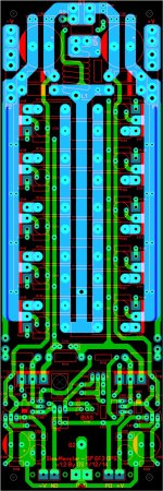

OK, a few more for your viewing pleasure. Hopefully this is getting down the 'fine strokes'.
EDIT: Aw, crap. I remember you saying to remove or reduce the 'rail augmentation pads'.
1.25mm (creepage), that will get you nearly US outlet voltage (RMS) ..
Overkill ...
OS
Overkill ...
OS

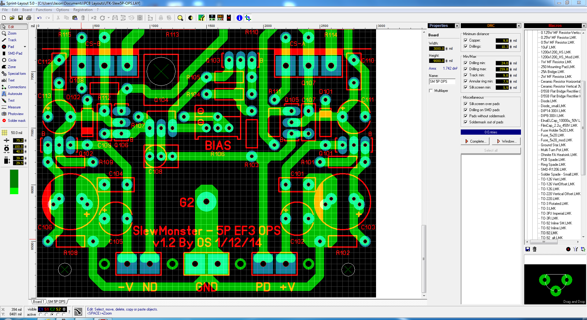

Does that mean we have arrived at 'OS Approved' status?
PS - I just noticed .. make top pads look like bottom pads ... F12 should do that.
I use V5.0 , do you use V6.0 ??
OS
ALL of the pads are PTH (F12 applied), do you see something? I just sent the latest to mfg since I believe I caught them before they started. Please say 'good to go'...
Oh, v5 is my version.
Multi-pitch @ Capacitance Multiplier...
Like this for C103 / C106?
I make 5 pair OPS now and found 470uF/100V have different pitch (7,5mm) than 470uF/63V (5mm). I must add holes on my PCB. Please use multiple pitch on 470uF cap.

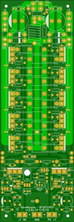

I made the multi-pitch change suggested by bimo and added text to mark the NFB point (the pad was always there but the text on the silk was over looked previously). I don't think there could be too many more 'tweaks' required. If something genuinely important is noticed, bring it forward please.
At this point are we ready to consider the SlewMonster 5P OPS artwork complete and 'locked-down'? I'll leave the question open for a while before blowing my wad and posting a new set of manufacturing files. I'll check in this evening and if all is a 'go' I'll put up the files.
Also , the OP collector caps I told you to re-position.Do Multi-pitch for
3.5mm/5mm. some Panasonic's are 3.5mm - most wima's are 5mm PCM.
One can use 2.2u to 22u /63-100v (EL or poly)- many options.
OS
OS
The OP caps were repositioned. If I move them any closer to the OP then there is no clearance to the base pad. As it sits now there's equal clearance between the OP cap pads and the base pads and driver rail. I'll add back the OP multi pitch, I only took it out becaise the drillings were VERY close. I could specify smaller drillings but we want to keep to just a few sizes ideally. I'll do these later and do more show and tell.
