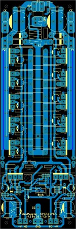

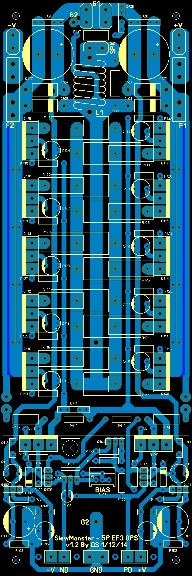

I think I've just about gone blind looking at the 5P OPS files and have them now fully 'tweaked'. Just adjusted a few hole sizes and have reviewed very carefully. Attached is a ZIP of the Gerber / Excellon files, including my Sprint file.
I have made every effort to ensure the information posted here is accurate and correct, but I can not make any warranty if you choose to use these files. This is the package I will be using personally.

Edit - consider larger pads/traces for the driver/multiplier section ... some manufacturers
have trace/pad lifting issues (in case of a rework).

The only reason I mentioned the pads is in other threads board Q issues
are surfacing. DIYA's "badger" PCB's... with my larger pads/their supplier has
been a real good combo - 0 lifted pads in all the builds. I personally
have reworked some pads 3 times with no issue - tough.

Jason, in your Fabrication Notes.txt it states 1oz copper. Is this typo - 2oz?
No typo. With the copper on both sides in play I don't see a reason to pay a premium for 2oz copper, at least for the first run anyway.

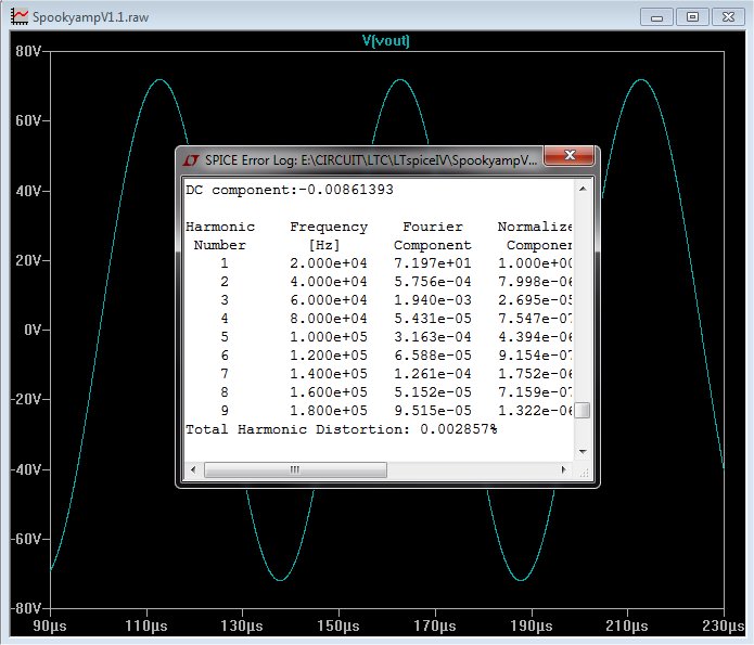

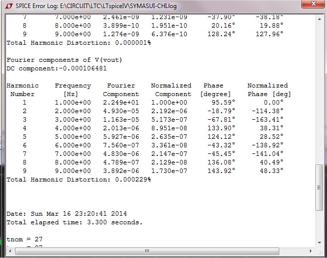

The "NAD" - same as Bonsai's NX , a CFA with positive FB servo/CCS's.
Same diamond/2nd CF stage as NAD M3 or many Marantz CFA's.
The "spooky Leach" is the Georgia Tech professors "baby" - dual cascoded LTP
fully symmetrical VFA. I gave it a hawksford ,2 CCS's , and an inverting
servo (hk990 servo) ... it is a CFA killer in this form. 70 parts for the IPS ..
it better be !! 😱
The SYM (or symasui) is a VFA - symmetrical single ended (LTP) cascoded -
wilson VAS . Has a current source , as well.
"Symasym" was the famous DIYA project - likely the most built
project for Class AB.
I brought all 3 of these to the limit ...
#1 is the the Leach - 2-6ppm 5HZ- 30Khz ...
able to leap tall waveforms (160V p-p), at 50 PPM. (check this out ! below)
Not bad for 25 YO design ... 30ppm is the worst it will do at 3R /150V.
Slews at 220V/us+ ... and it's a VFA !
SYM is also a "swinger" ...150V p-p is easy and clean.
The CFA is also nice , Hawksford's can really dish out a linear high
voltage signal.
ALL 3 clip marvelously . Just a tiny bit of saturation.
OS

My supplier is suggesting making all component pads PTH. I can say go ahead as it is if folks want NPTH in the less critical areas or I can quickly change the board for all PTH. PTH will make rework more difficult. I could (though not likely required) also fatten things up as per OS's suggestion. I may just go ahead as is and if more are needed submit those changes then. Opinions?
Some boards are on order without any modification to the files as it related to the PTH query. It can be decided later if it needs to be addressed with changes.
JK,
These boards are double sided? If they are double sided without thru hole platting doesn't that mean you have to solder both sides of the board to use the double traces?
>FacePalm< NO, where there is connection to both sides the holes are PTH, the question arose from the supplier as to why they weren't ALL PTH, even where the copper is only on the bottom. So, for the time being, in places where the copper is only on one side the holes are NPTH to hopefully make potential rework easier and where there is copper on both sides the holes are PTH.

The badger boards are all through-hole , even the single
sided pads. As I said , whomever manufactured them used
HQ material ... they can take multiple reworks.
But , they also have those "fatter pads/traces" 🙂 .
Using these won't increase stray capacitance or induce RF
pickup. It is not too dense a layout in the multiplier/driver area
of the "slewmonster".

An example ... and why ??
(below) is your board .. JK.
Larger pads + through hole for any device that might undergo
thermal cycling.
-All to-126/to-3p.
-Anything that will have physical stress.
-larger 1W power resistors (driver/predriver Re).
If something will "blow"... it will be these !!
- any "options" (boosted rails), that might get a future rework.
Just a few ideas...
