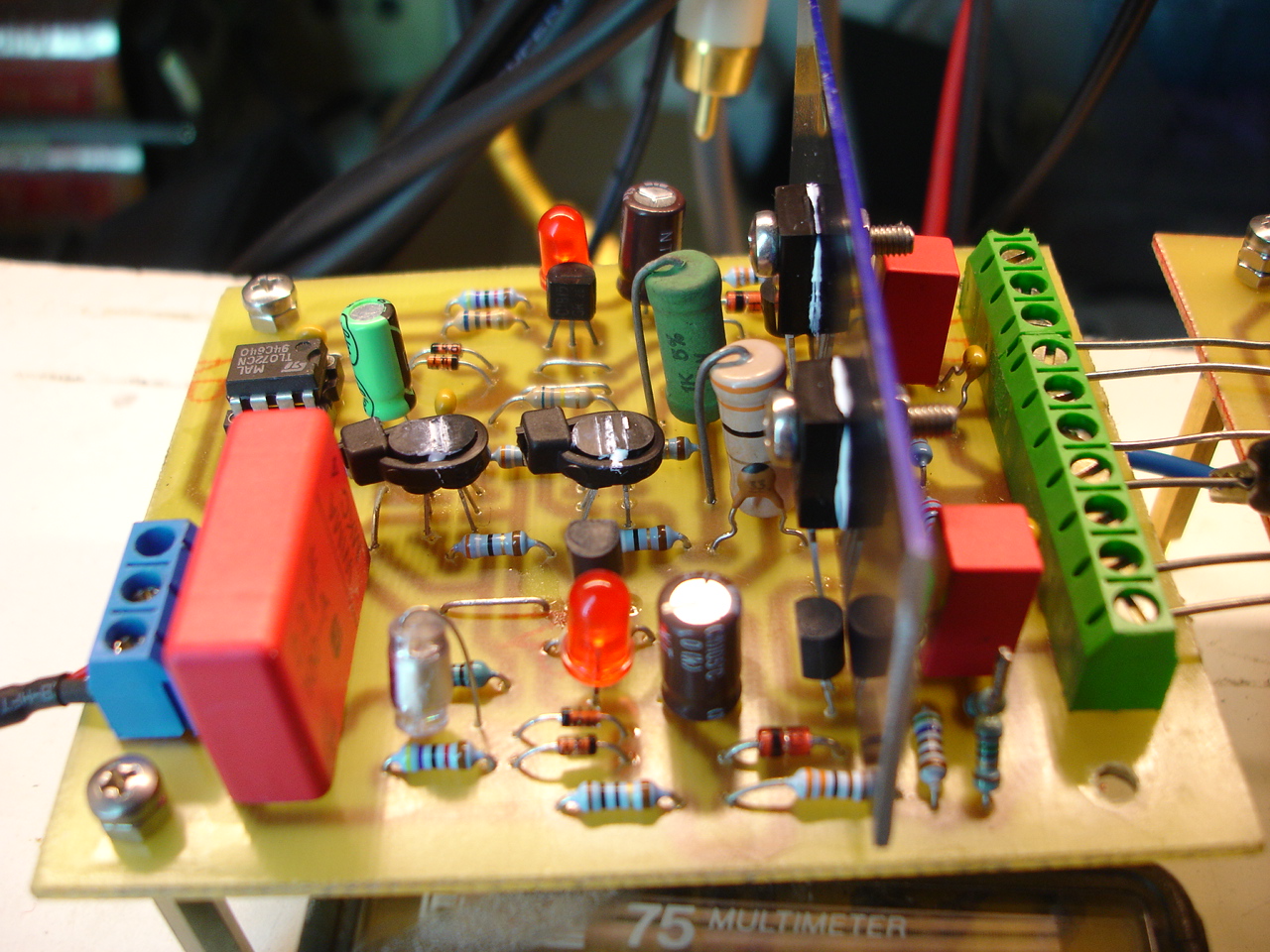

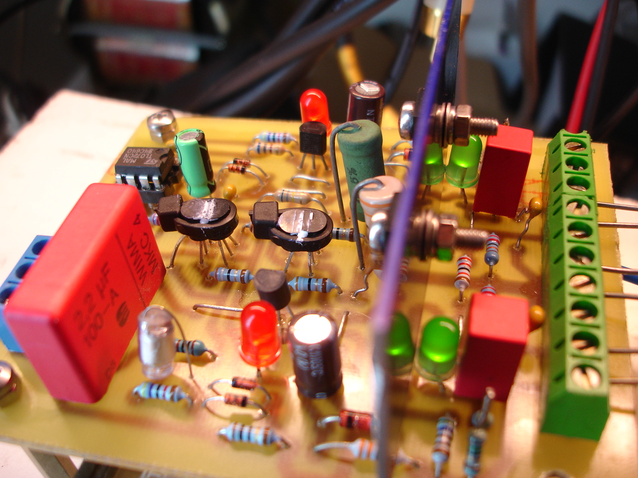

That looks nice but it appears there is barely enough room to fit the aluminum sinks and the led lights next to them.
Yes it's a little problem here because of these .47uf big red WIMA capacitors.Thimios,
Smallest capacitors (.68uf) will resolve this problem.

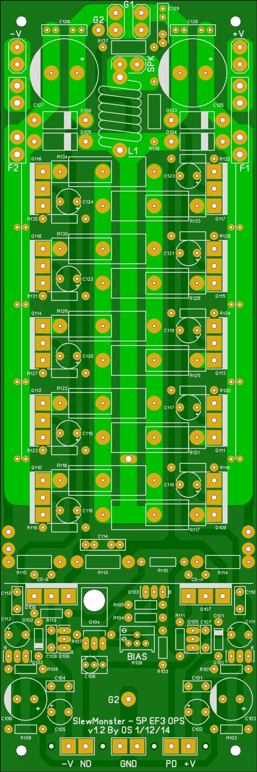

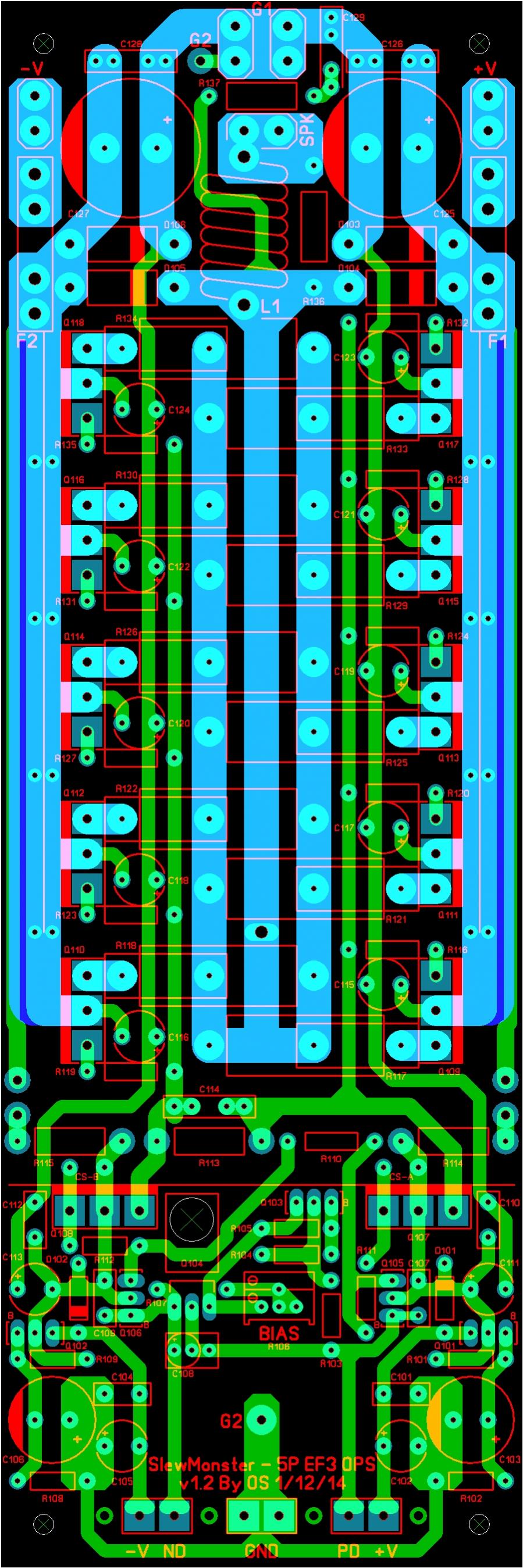

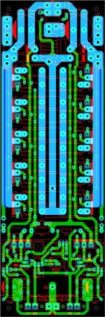

OK, beefed everything up and went all PTH. Only one issue, a ton of 'Silk Screen On Pad' DRC errors 🙁 which leads to a lot of clean-up work on the silk layer. Hang tight.
Is this possibly the one?
Folks,
Now all PTH, beefier pads on demanding components, thicker traces...
Should now be ready to run a toaster 😀. Please review, I will only put up gerbers if there are no issues brought up with these images. I haven't got confirmation of my order yet either, so I might be able to swap in these files...

One of my silly questions here. Is there a reason or is it related to how things would look when layouts used tape that all the changes in direction of the traces are straight sections and not curved? I see all the cut corners around pads and things and wondered why none of this is done with radius curves?

We seem to be as close as possible without getting "anal" ... here.
But I will.... 😀
The rail feeds to the collectors are double sided ... 12mm + combined.
With 1 oz copper , the combined sides have 16A capability each (10C rise) ..
The CircuitCalculator.com Blog PCB Trace Width Calculator
I calculated 20C rise/20A for 12.3mm - we are Good !
We would only see this worst case (or with "magic smoke"/short?) ... this is a DC
rating. Any fuse ,(for even the Semelab devices) would be 15A max.
You can omit the rail lines as that was for single sided augmentation.
The through holes between sides on the rails along the lines can
be single ones , as we are now "fat" (double sided - 12+mm total.)
The output traces are also fine (double sided w/ TH) , close to 12mm.
20A capable all the way .... 😎
OS
You just have to worry about long parallel traces in "sensitive sections".
Like the predriver/driver/Vbe area (bottom of board).
Also , AC creepage between the 150v p-p output signal and any other
trace needs to be 1mm coated or 1.4mm bare .... we exceed this.
Curved lines and such are purely aesthetic , I do try to avoid right angles ,
but this is audio , not a PC motherboard 😀 .
