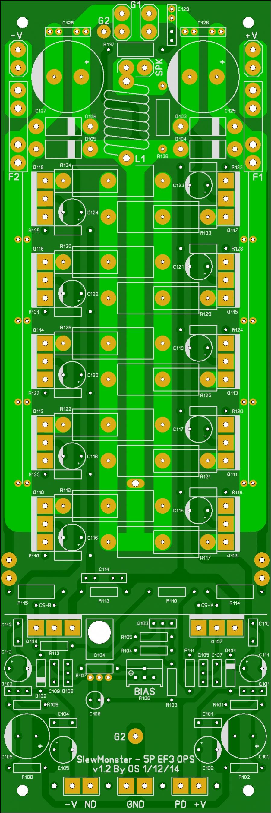

The IPS's can just be done by the individual via toner transfer / photographic methods as desired. I don't plan on having any IPS's manufactured at the moment. Since the OPS is common to all it makes sense to have that done professionally. If a particular IPS shines and is in demand then that could be done professionally too. You are right though, a few need to be built and listened to to see which ones, if any, have a 'superior' sound.

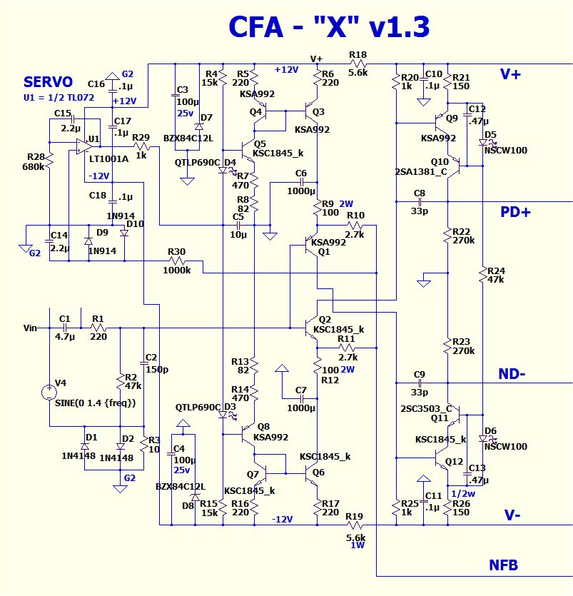

Take the old "VSSA" , "hide" it behind current mirror's ... add a
servo/voltage controlled dual CCS and Hawksford ....
And get a 15ppm , nV offset , -90db PSSR REAL amp ( ips).
No trimmers ... No worry. (below)
Bimo spoke of this , Miib (on the CFA thread) simulated it. Mine
is different , of course .... but it "flies" . 😀
OS

No, instead of them ... or the option to use either (multi-pitch).
The wima's are 3.5mm or 5mm LS.
Ah, gotcha. I've always bought those little box caps in 5mm LS, never bothered with the 3.5mm LS. The reason I took out the multi-pitch was a DRC complaint about the holes being too close, though going to 35 thou holes would prevent that. If you feel it is of real benefit to have the added LS options there then it is easy enough to put the pads back.

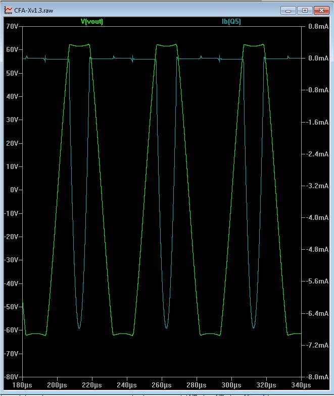

No - a better VAS will
-save tweeters with better clipping behavior.
-1/10th the load on the IP pair.
-Saturation of the cascode stays there ...
(below) is the load that the vssa input pair sees at clip. In a CFB amp ,
"current on demand" tries to provide the I.
Bimo/NAF say that the IP pair heat up when clipped at high levels (abuse).
Here we can reduce this load.
PS- it's worse on the non-hawksford ... 15-20ma !!
The servo/ccs/CM will offset most effects of any component aging/ambient
changes.

I like the way you inject the servo adjustment through a cascode. Very clever adaptation.
Now I suspect that you have performance close to my implementation. Problem is "sorry to say this, that it gets creamed by Sonny's TSSA.
Thanx ..Miib.
I won't "stroke the cat" for that last comment. 😀
His uses all sorts of stupid Jfets and IGBT's ... they all can have it. 🙁
I'm satified with 90db psrr/15ppm/good clip/1mv offset , all
with junkbox parts.

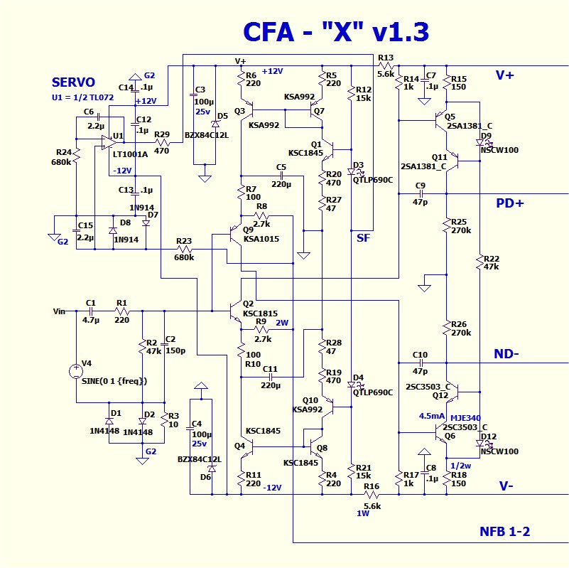

Oh well ...
I seem to get criticized for moving things along ... but if
I bother to print out an IPS ... it must "fly".
It (the 1.3) should sound the same , or better on a single PS (psrr).
The extra 2 devices on each half (CM's) are just 1.00$ and should take
up no space. Adding a servo is just like adding TL431's on the "TSSA" 🙄.
The whole amp goes to 80V rails with ease , the servo is better than
the nad - AND it's still a VSSA .... nothing new in the signal path besides
the hawksford.
Build it out of e-waste , it will still "fly".
.asc + schema below -

I think I've just about gone blind looking at the 5P OPS files and have them now fully 'tweaked'. Just adjusted a few hole sizes and have reviewed very carefully. Attached is a ZIP of the Gerber / Excellon files, including my Sprint file.
I have made every effort to ensure the information posted here is accurate and correct, but I can not make any warranty if you choose to use these files. This is the package I will be using personally.

I think I know the problem ... even the simulator shows it.
NAF/Bimo also reported this issue with the CFA's.
At least in the case of the VSSA ... it sucks (bass wise).
Having those virtual ground reference DC blockers at FB node is
an issue @<100hz. A similar VFA with blocker, (higher Z) does not suffer
as much.
I compromised with my last posted v1.3 , reducing CF and keeping
as large a cap as possible.
The NAD is pure DC at FB , as is the
spooky leach ... same gain/THD (<10ppm) for 5 - 100hz).
Original VSSA (and even mine) rise at LF.
But , at 20K ... they "rule" !!
Naf says the NAD rules the VSSA in bass , as well. Simulation
absolutely supports the real world assessments.
