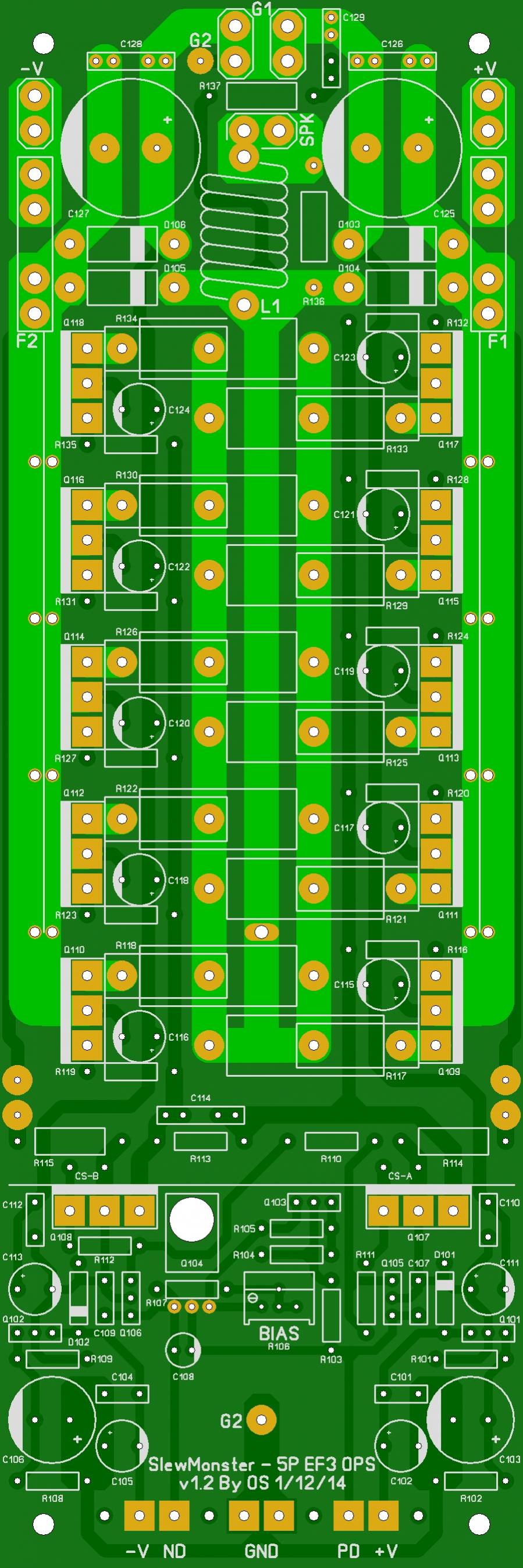

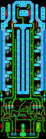

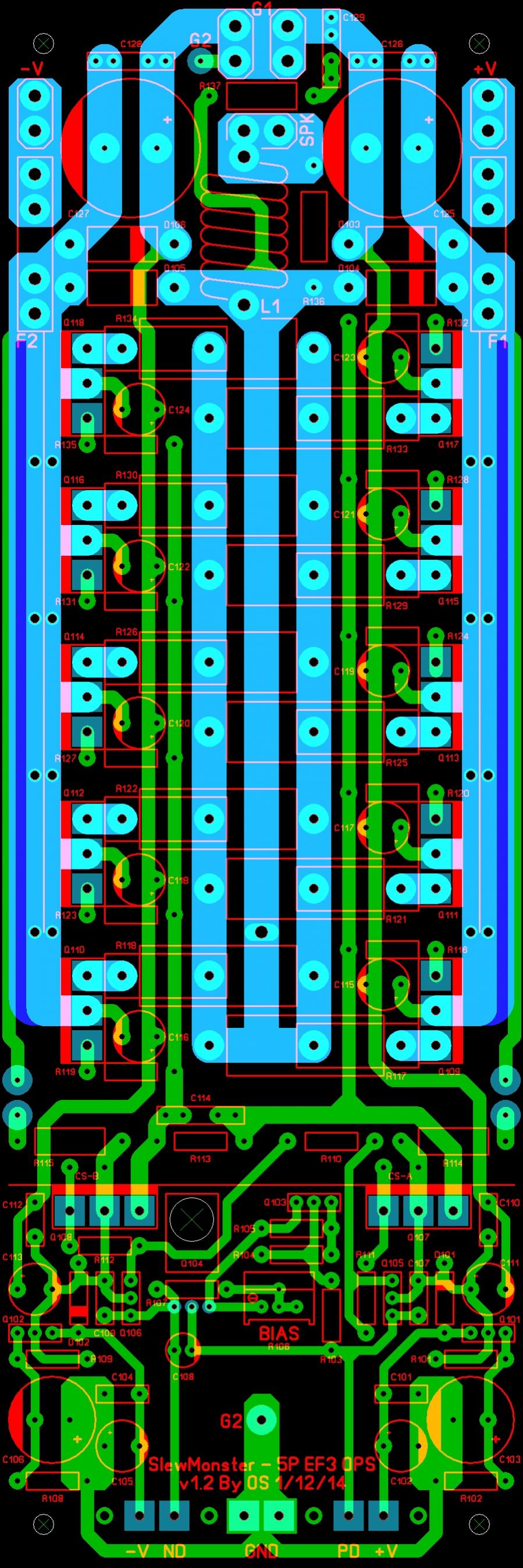

Re-Draw Completed
Folks,
Here are two images of my re-draw of the 'SlewMonster 5P OPS' boards. I believe all is correct against the schematic and should be a very close match to OS's layout with very minor re-alignment / repositioning of a few things. If anyone cares to have a look and make sure I have not missed anything then please do so. If an error is identified, please let me know so it can be corrected. I'm planning on using this to generate gerbers and drill data to send out for boards.
Folks,

It seems Jason is taking over from the groupsbuy
BTW, Jason like your layout very much
It was never my intent to 'take over'. Rather I just wanted just to bring the current art to a very high 'polish', frankly just to suit my personal aesthetic tastes. If someone wants to do their own thing, then to each their own.
If no errors are found I will post a zip of the required files (Gerbers, Excellon and Drill Chart) for anyone to have them made.
I will likely do an order, maybe 24 pieces, with excess on offer. I have not yet priced it so can't say what the cost will be. In any event I feel any 'group buy' must be done in it's own thread. I believe it is very important not to sully OS's thread with group buy 'static'. Please make no such requests here. If / when the time comes I will post a link to a new thread for the purpose.

OS, I figured if it made sense to use PTH at certain locations then why not use the top layer for added 'beefiness'. PTH requires copper on the top anyway so you are already into a two sided process, placing additional artwork there won't change the cost by much, if any at all. I realize we aren't after the kW+ commercial units, but at this point the copper is practically free so let's use it.
Besides, if you are going to do it then we might as well do it to the absolute best possible effect.
