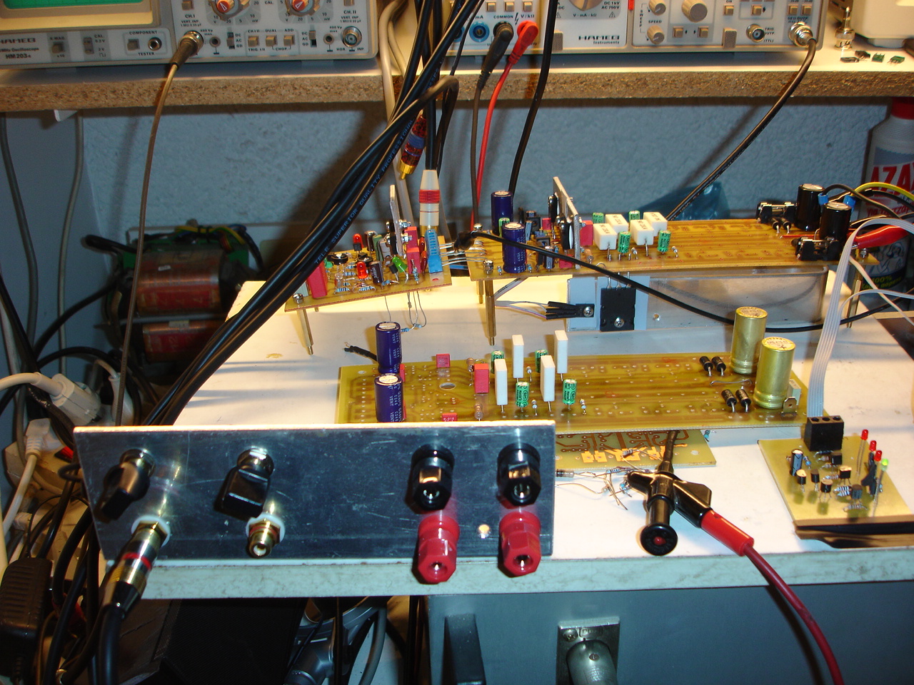

SlewMaster and his brother in progress!
Lookin' good ... T

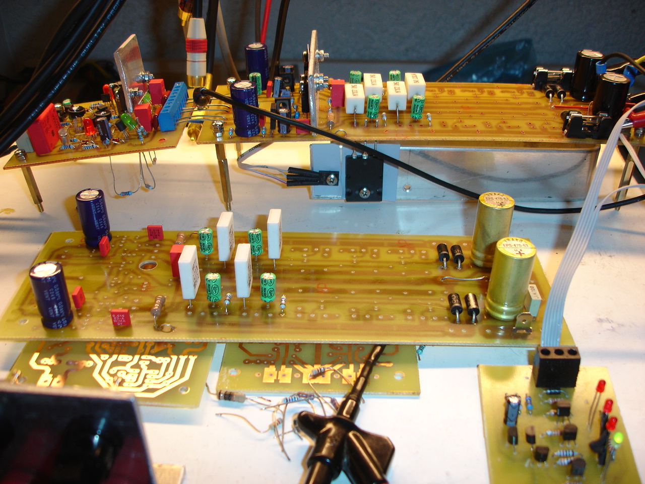

You know you could use just thin common roof/masonry flashing (.39-.45mm) ,
either copper or aluminum as both the OPS driver or IPS VAS heatsinks.
This material can be cut with small shears or even simple scissors !!
On the IPS's , I designed so the thinner material can fit right to the
PCB and almost go from side to side.
It's just the exposed area of the HS surface (CM/2) that counts ,
not the thickness.
PS- .68u on the Hawksford (IPS board) can be a very low voltage (smaller) , than
those huge wima's you have there ... more room for the green led's !
OS

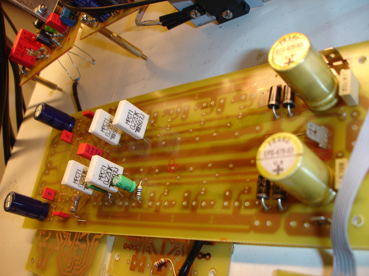

" PS- .68u on the Hawksford (IPS board) can be a very low voltage (smaller) , than
those huge wima's you have there ... more room for the green led's !"
OS
Thanks SO you don't like these non vertical green leds.🙂
These WIMA cap. are 0.47nF/63V ,at this time i have these only.
BTW i'm on the road for aluminium anodizing for these small heatsinks.
OS

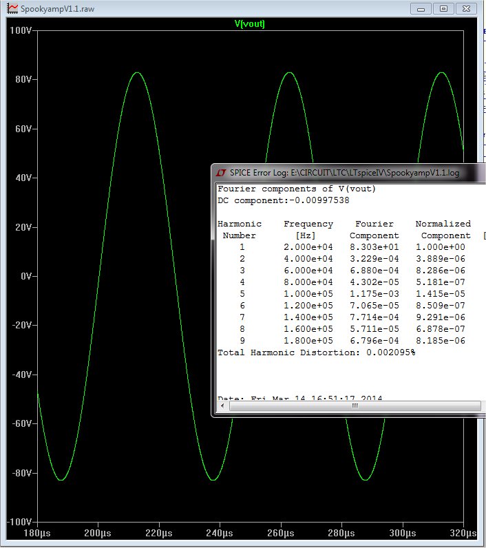

Spooky and symasui are VERY similar in how they behave at
the "ungodly level" ...
(below ) ... is just 20ppm at over 160V p-p /3R for the spooky.
One needs to go, (40Khz 200v p-p) for the spook to hit .005% ...
The SYM almost does this with 10 devices versus 14 for the
"spook".
These all use the RED LED CCS's - I chose these for 3 reasons ...
-slight negative co-efficient , no need to couple (led/bjt)
-having a cap multiplier on the OPS offsets less PSRR.
-they are super simple/reliable.
PS - I also have the original leach and symasym simulations. They
DO NOT even come close to the (spooky/symasui pair) .. 😱
Edit - these really "fly" because of their VAS's , the Hawksford and wilson/cascoded
VAS retain linearity at a VERY high voltage swing. I have concluded this is why my
listening impression of them at (ungodly) levels ... is "godly" (very,very good).
OS

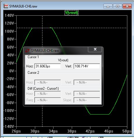

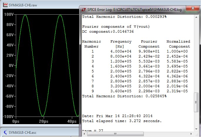

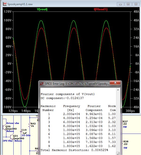

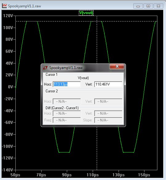

Spooky vs. Symasui ... battle of the "ungodly" VFA's ..
Went a little further and checked clipping , SW . and THD20
at 3R / 200V+ p-p.
Way ahead of any of the CFA's ,the Sym stays double digit PPM
up until about 180V p-p. Goes to .02 -.03% over 200v (below 1).
Clips beautiful at 216V p-p (below 2).
The "TOP DAWG" is still the spook' , it can still have 45ppm/3R
at 200+ V p-p (below 3). It clips out at 220V p-p (below 4).
This is for real .. boys ! The 5 pair with 85V rails @ 4R or 100V
rails for 8R plus some of those Semetech's will give KILOWATT
peaks with these amps.
These 2 VAS's don't even break a sweat doing it , as well.
Current feedback is nice , but it does not scale as well ... both
the CFA-X and NAD nearly reach 600+ ppm at these levels
The "current on demand" and the overly simple single input pair
is not able to stay nearly as linear at these "ungodly" voltage swings.
Yet another VFA superiority (a literal "BIG ONE"). 😱
An "augmented" nad-s with a cascoded second stage could fill in this
performance gap , but it would start to not be as "simple".
PS - even with the superior Hawksford , the NAD's second stage
produces the THD at huge amplitudes - current feedback at it's finest.
At 60V rails and "normal operation" , the CFA's are close to the VFA's.
Not bad for such simple circuits.
OS
