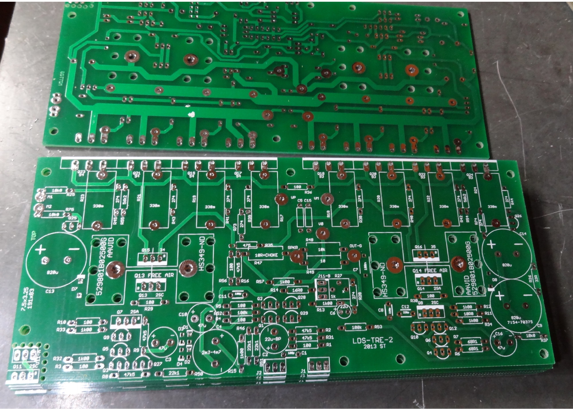

I think you have to order in groups of 5. Last time I did this I ordered 10 to have even numbers. It was less than $60 including shipping. Those were large boards like these. I'm not trying to ruffle any feathers or get out of line here, but I am constantly building and any place I can save some time and money makes a difference.

Not sure about FR-4. Don't know what that means. Yes on the 2oz. You can check them out here. They made the boards in two days but I chose the cheapest shipping so it took over three weeks to arrive. They are very nice boards. I am attaching a picture of them.

Did you send them Sprint files? What size are the boards you sent them?
They look super, I do not mind the wait on shipping gives me time to get parts together...😀
I saw the size on the board and they want 14 ea for them with shipping...
Hi Krisfr,
I sent them Gerber files. The best way is to send the files and they will send a price quote. My boards were 3 1/4" x 7 1/2" and they were less than $60 for 10 boards including shipping. If Patrick sends me the Gerbers I will get a quote and let you know. These output boards that OS designed will be really nice to have on hand. I'm sure they can be adapted to a lot of different topologies. I can probably use 10 just for myself.

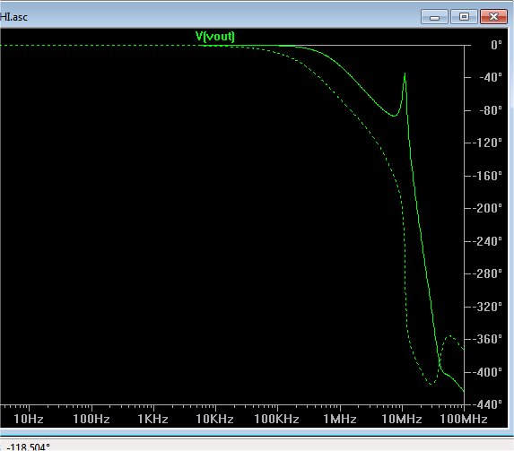

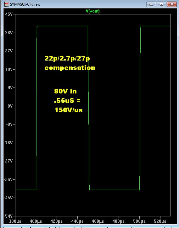

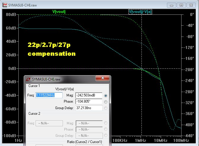

Did some squarewave tests on my SYM ... it nearly oscillated !! 🙁
Coming close to (failure) is a good thing for me. The sansui/HK 3
cap compensation... (Below 1) was the key.
The C6 and 7 , in the right combination (ratio 1:10) ... allows
you to use a much smaller C7. As well as being able to push the
amps bandwidth up to CFA UG freq's ( 1.0-1.4mhz) , you can have
CFA slewrates , as well 😎
(symasui CLG BODE - below 2).

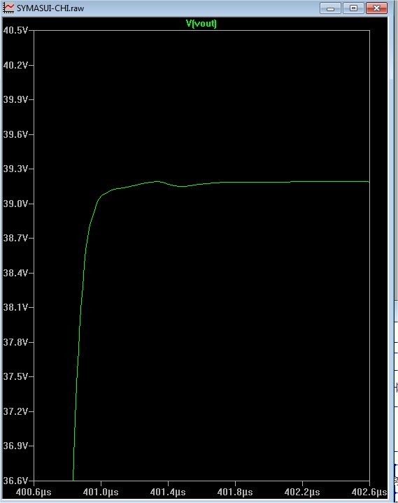

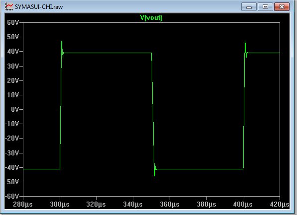

C5 is the "lag" ... with the right value you can eliminate "peaking"
(below 3-4 .. WRONG VALUE) - peaking = overshoot and ringing on a high slew square wave.
In fact, you can "round" the edges of a 125V+/uS rise-time square wave
without affecting the slew. (below "fixed" - 5-6)
Here it is ... the (up to) 150V/us slew , "ungodly" output level ..ultra
low THD (better) "SYMasym" ... (below attachment).

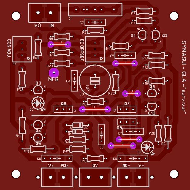

Pretty PCB ... too (last pix) .
