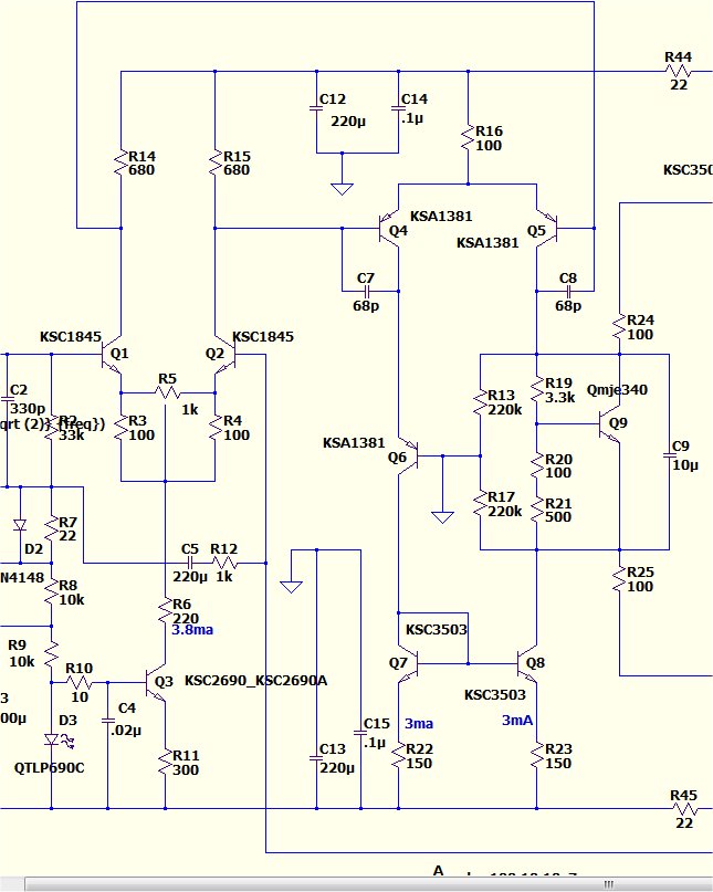

The one for my Subwoofer ...
I am now "proofing" my "symasui" ... I actually am
designing this for my subwoofer. I am quite sure it is
musical for HF , as well (33ppm 20k 120v p-p).
The "proof" is how NAF/Thimios get to hear it sing FIRST TIME.
NO smoke or oscillation ...
(below 1-2)

After I do the fancy colors , the "flow" of the amp/layout becomes
apparent , as does any "no-no's" ... like a long parallel set of traces
near C6 (5pF) , as a general example. 🙂

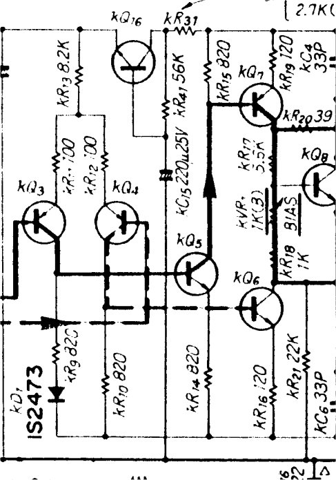

One more explanation of this topology ...
In it's simplest form ... the sansui Z3900 (below 3) , 3 transistors for VAS
(Q5) .. is the level shifter , Q6/7 form the push pull.
A very simple single ended symmetric amp. THD = .05% (500 ppm)

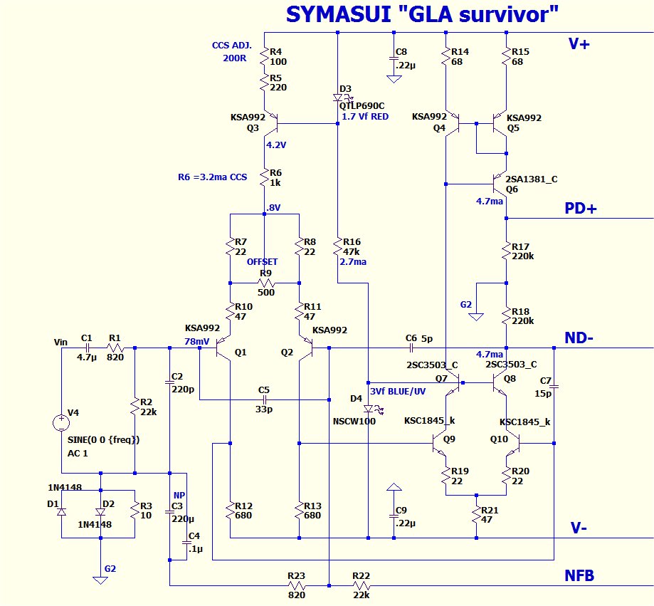

Then there is "symasui" .... V and I are separated.
Q4/5 + Q9/10 just handle "I" while the cascode (Q7/8) combines
with Q6 to generate all the voltage swing.
Same theory as the Hawksford without the feedback.

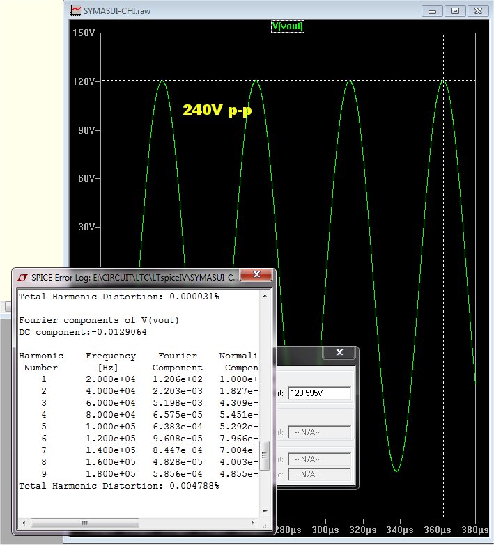

Blows the symasym away .... especially at huge output swings.
THD= 30-50ppm at "ungodly levels".
All 3 work the same way , but the last 2 are incrementally more refined.
The last one "works the least" to produce those huge waveforms.
