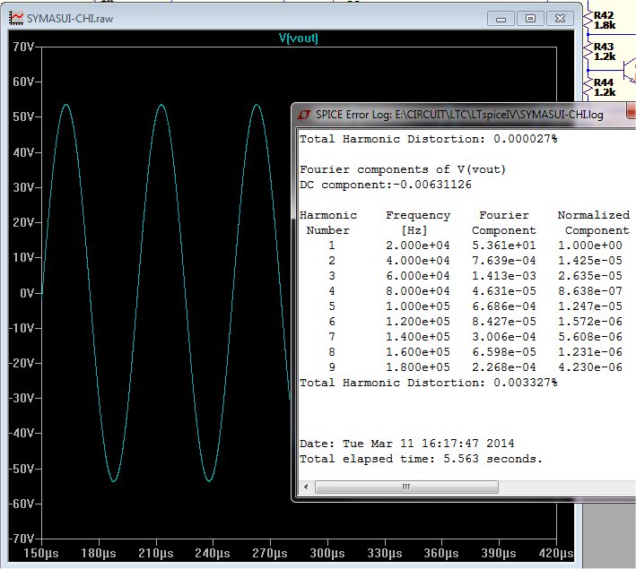

About 1-200ppm THD is what a typical symasym outputs.
This one is different ,
It uses a blue and red led to reference both the CCS and the VAS's
cascode. (D5/D3/R16) Simple , it also negates tempco and CM distortion.
The LTP is common fare with a more precise offset adjustment (Q1/2 +
R7-11).
The Wilson Cascoded VAS is the winning ticket. Q4/5 + Q9/10 can be
small low voltage (cheep !!) to-92's.
The "wilson" part of the Mirror (Q6) does all the work (acts as a cascode).
On the active side , Q7/8 (another cascode) do the "heavy lifting",
and are a good match for Q6 (A high-Z cascode).
All this is compensated with the Sansui lead/lag/miller "array" (C5/6/7)
C7 sets the pole , C5/6 "tweaks" phase for real good stability margin.

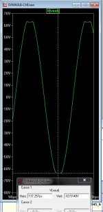

Driving a EF3 with this ... it does 11ppm 1/2 power and only 33 full throttle.
(below 2) .... clipping has only the most minor saturation and is
symmetric within 200mV. (below 3)
WAY better , by far than the original ... and able to leap tall buildings
in a single waveform ( 125V p-p with 70V rails ).

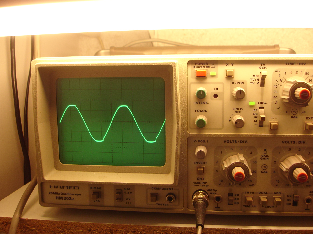

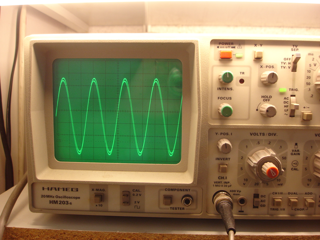

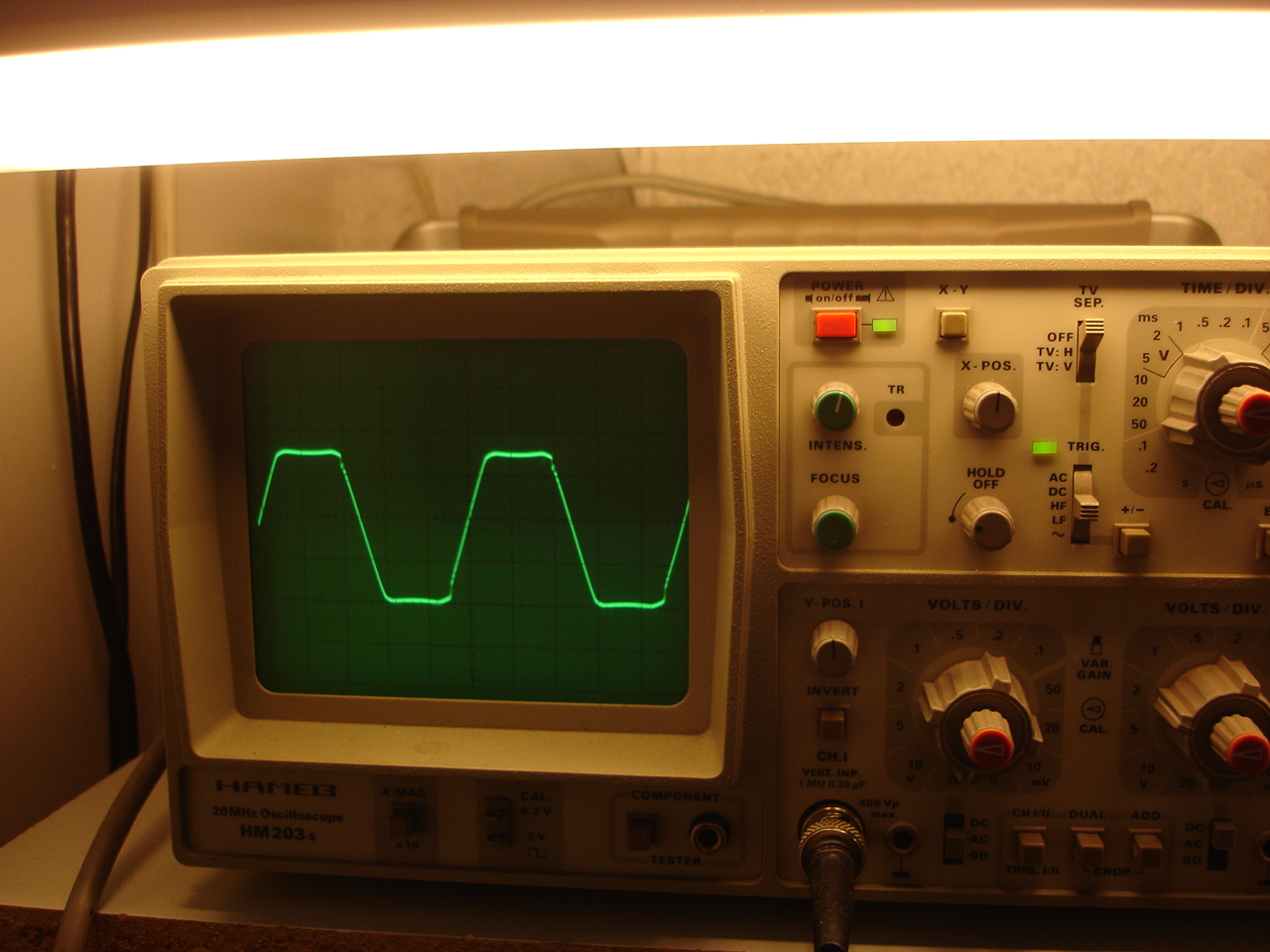

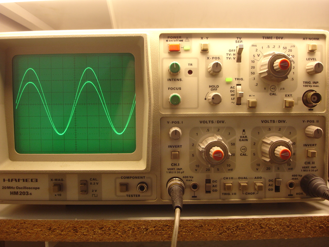

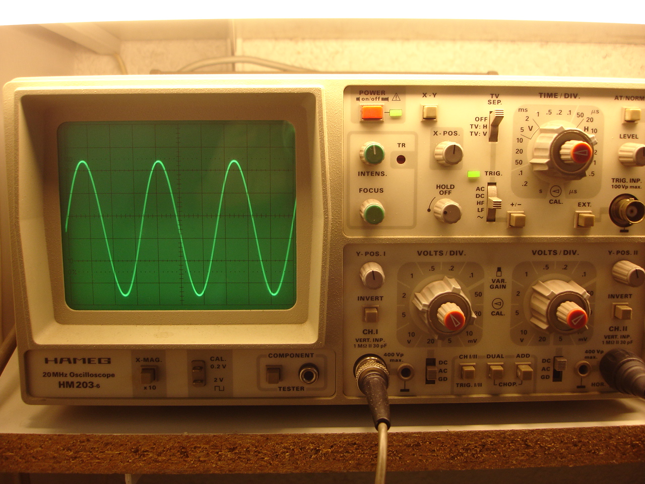

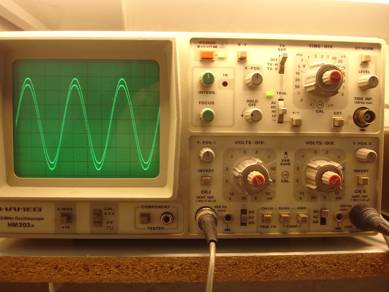

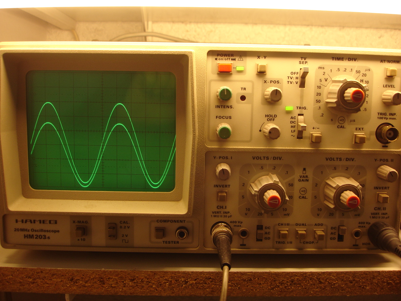

Now i have the rest of test.

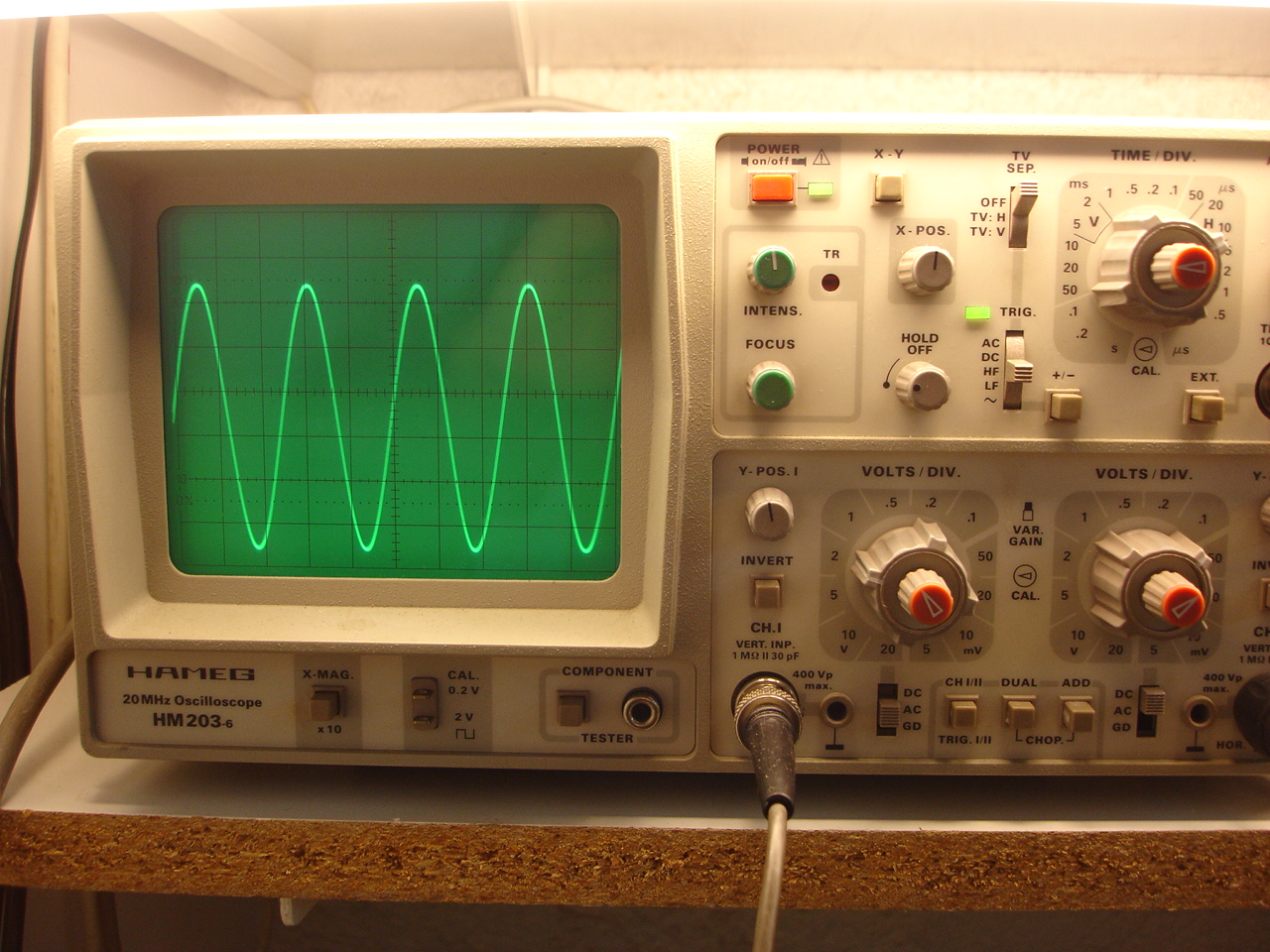

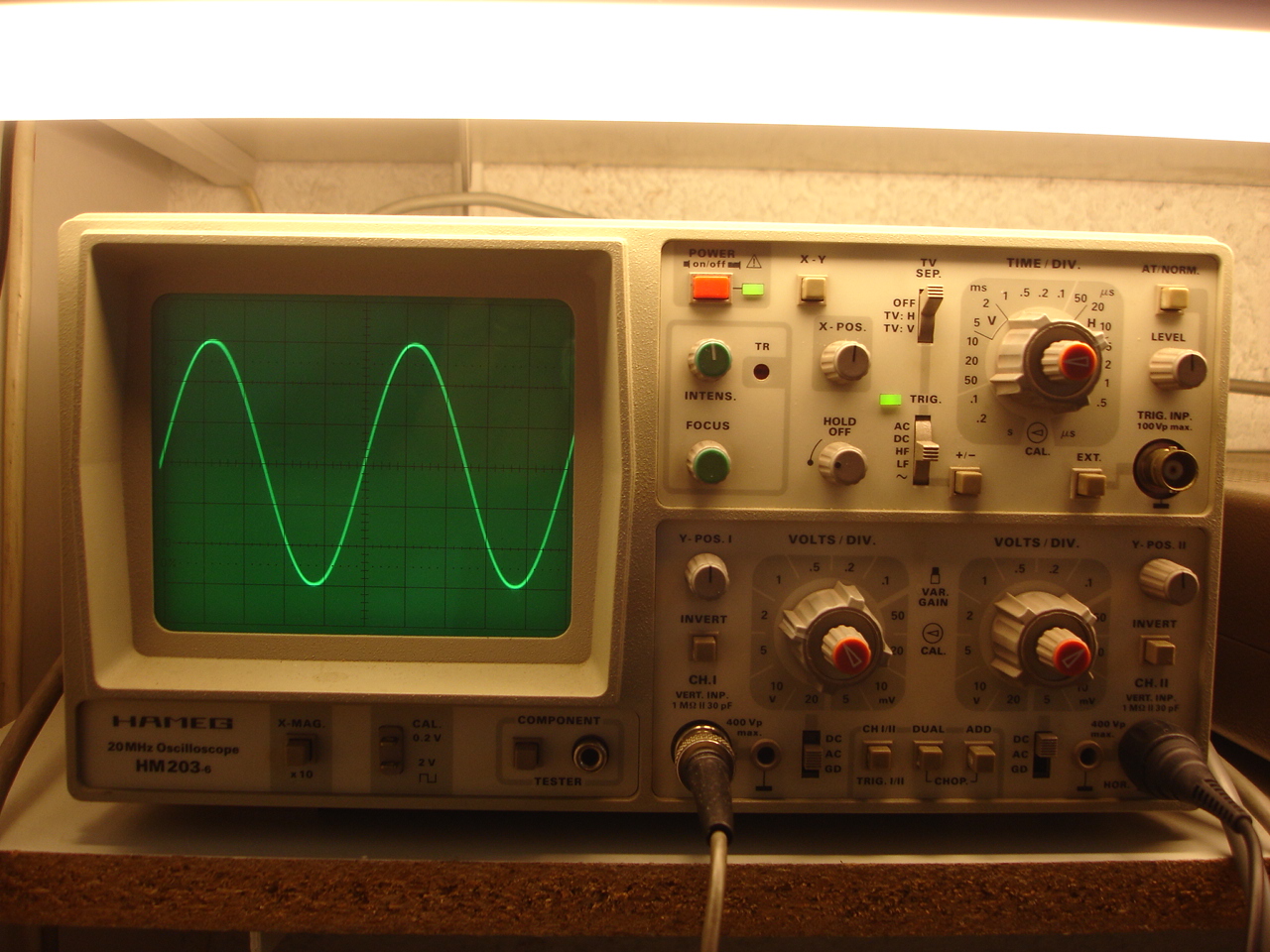

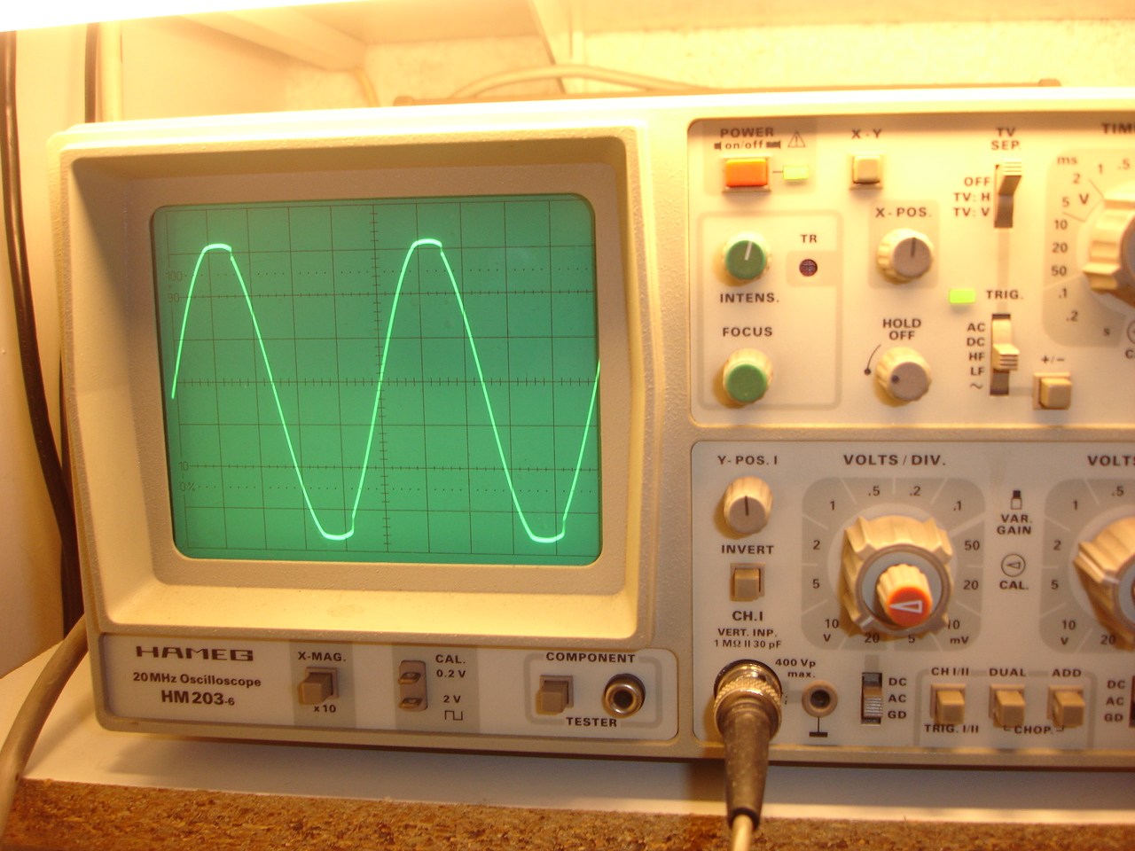

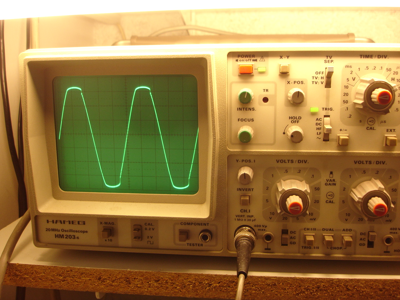

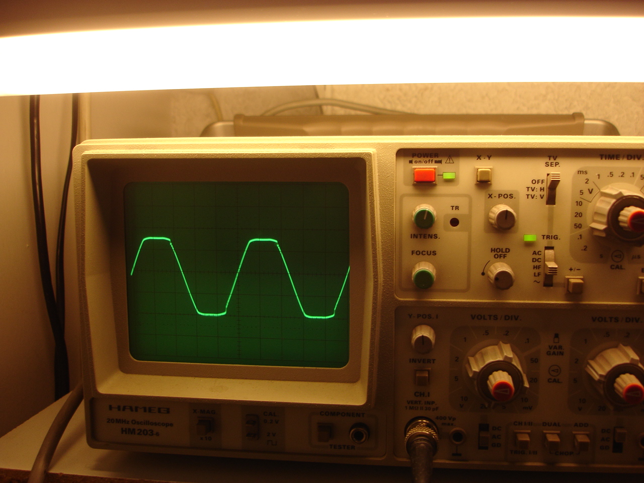

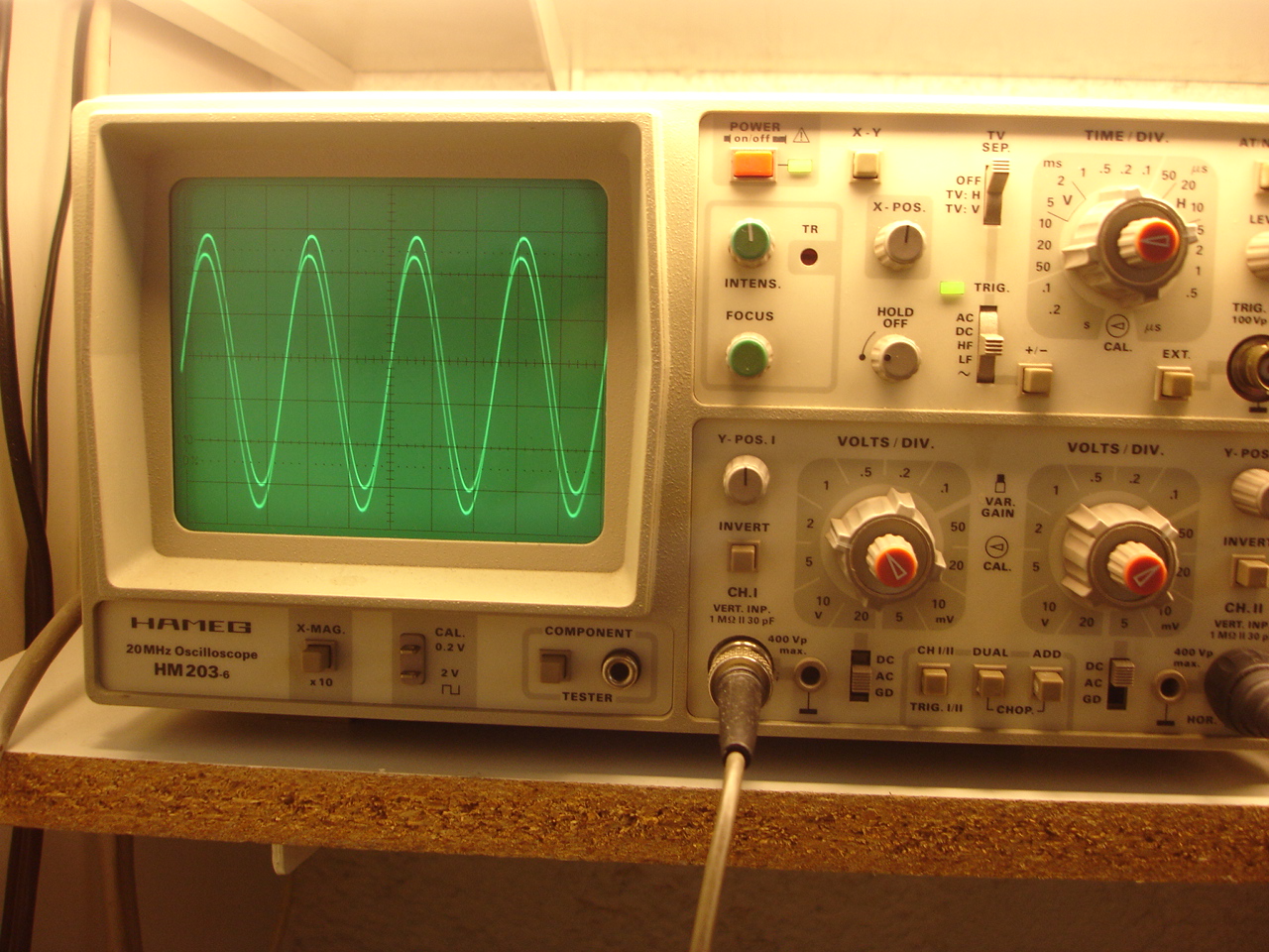

Clipping at 20KHz
1)Inp.=950mV RMS
5)Inp=1.5V RMS
6-7)inp. signal down,out signal up(20KHz)
8) same as pict 6-7 two signals superimposed.
9)30KHz
10)30 KHz signals superimposed
to be continued..
Clipping at 20KHz
1)Inp.=950mV RMS
5)Inp=1.5V RMS
9)30KHz
to be continued..

the rest
1)40KHz
2)40KHz superimposed
3)60KHz
4)80KHz

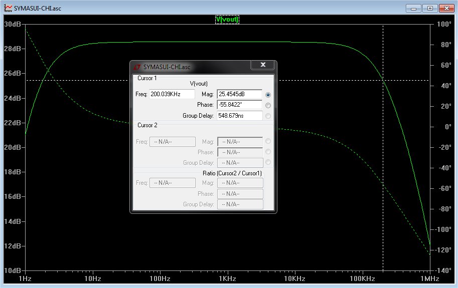

-3db at 2,7 HZ DOWN(Tested at 14v RMS)
-3db at 200KHz UP(Tested at 14v RMS)
1)40KHz
3)60KHz
4)80KHz

Yes ,amplifier tested at 16V RMS OUT. which is stable from 3Hz up to 200KHz. At 2,7 Hz this Vout =11,312V .At 200KHz this Vout=11,312V
(16*0,707=11,312)

LT is right on ... 28.5db gain / 2.5hz to 190+Khz (-3db).
PS- drops like a rock at <.5hz-1hz (servo is R/C .2hz )...

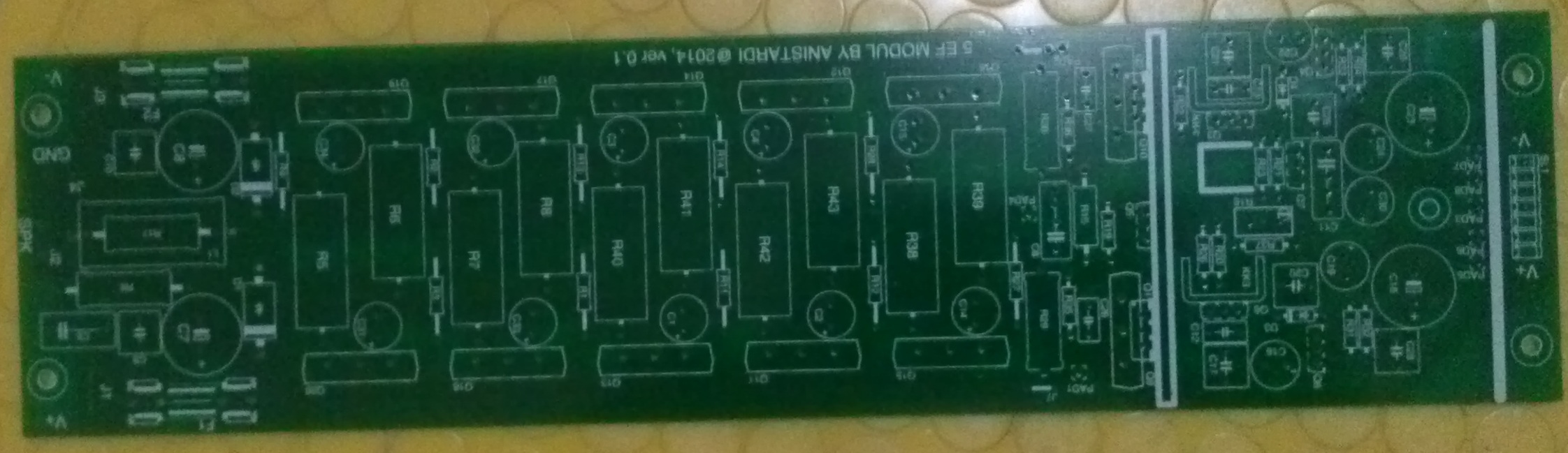

Almost done with the symasui .. (below)
kept it small at 76.2 X76.2mm ..
I would suggest to build this .... it "flies".
so simple , yet can do that 125v p-p with the grace of
a 2000$ amp .... I would prefer this over a badger/
wolverine...
OS

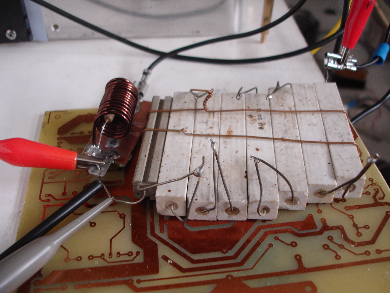

Hi bimo look here,isn't a luxury load: 8x1R/17WI like this.
Thimios, what kind of load do you use?
I can test again with a RIGOL ds1102 if it is interesting
