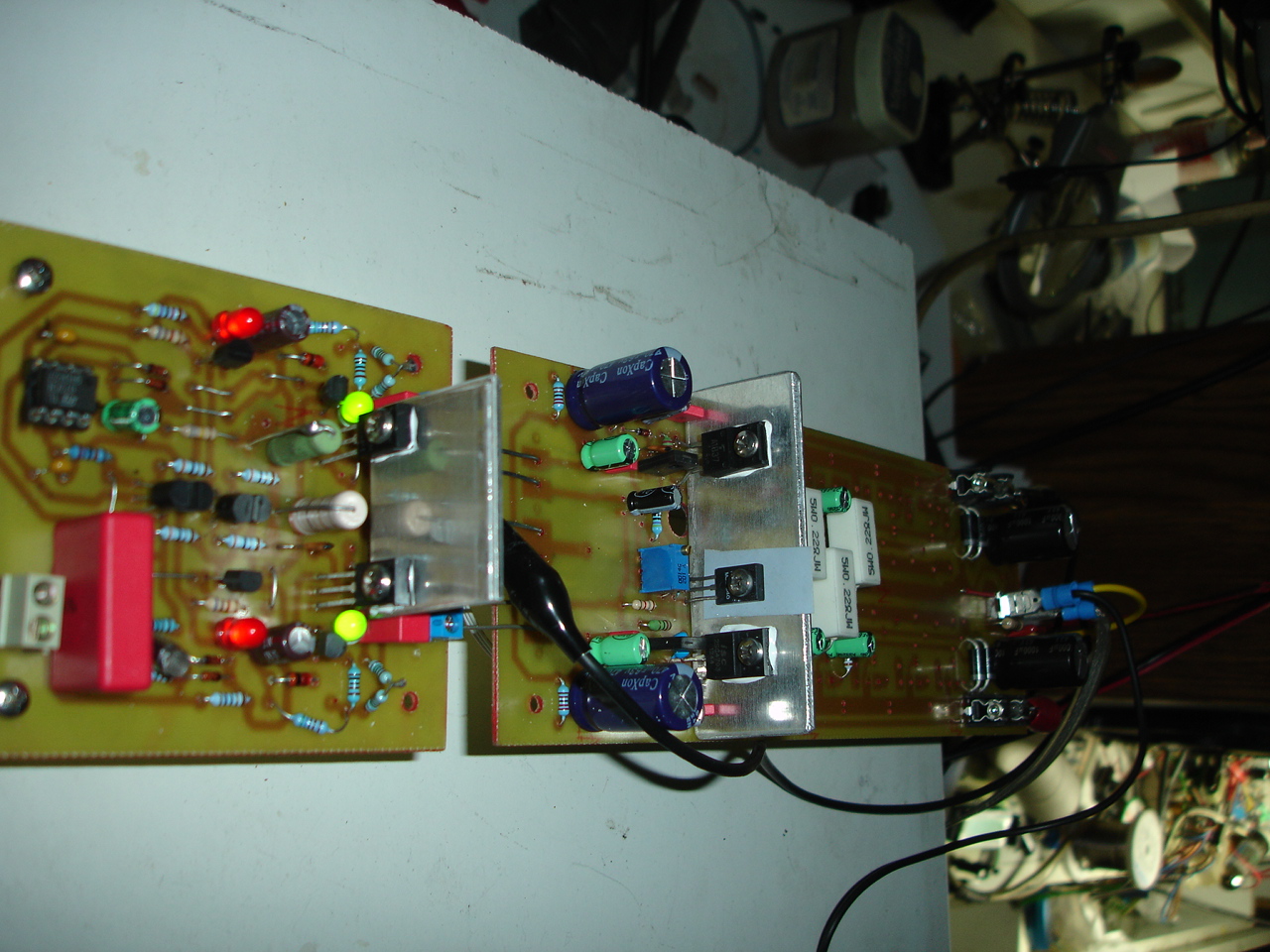

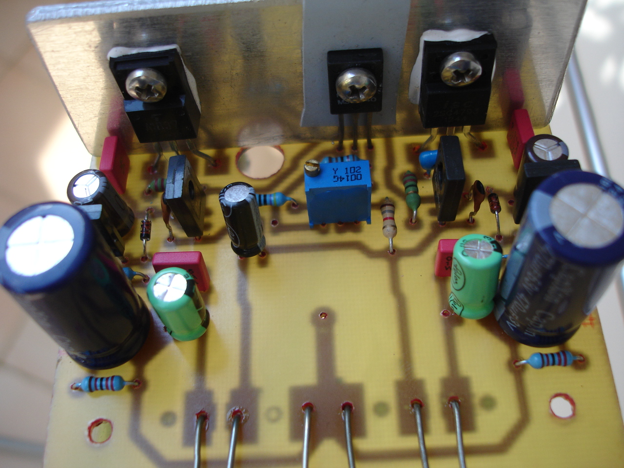

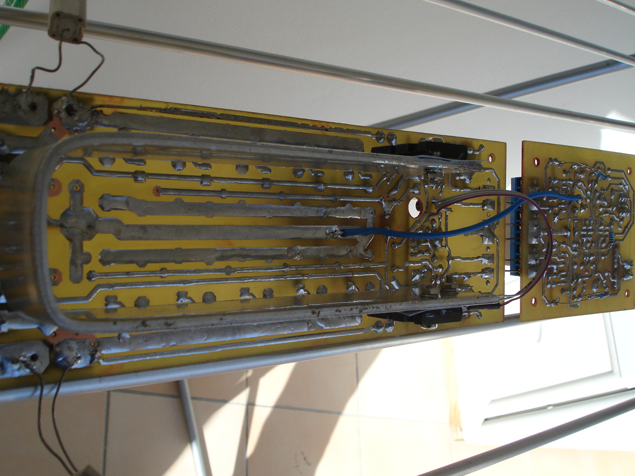

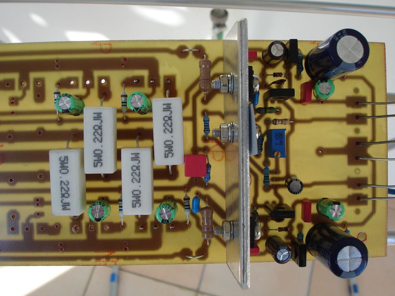

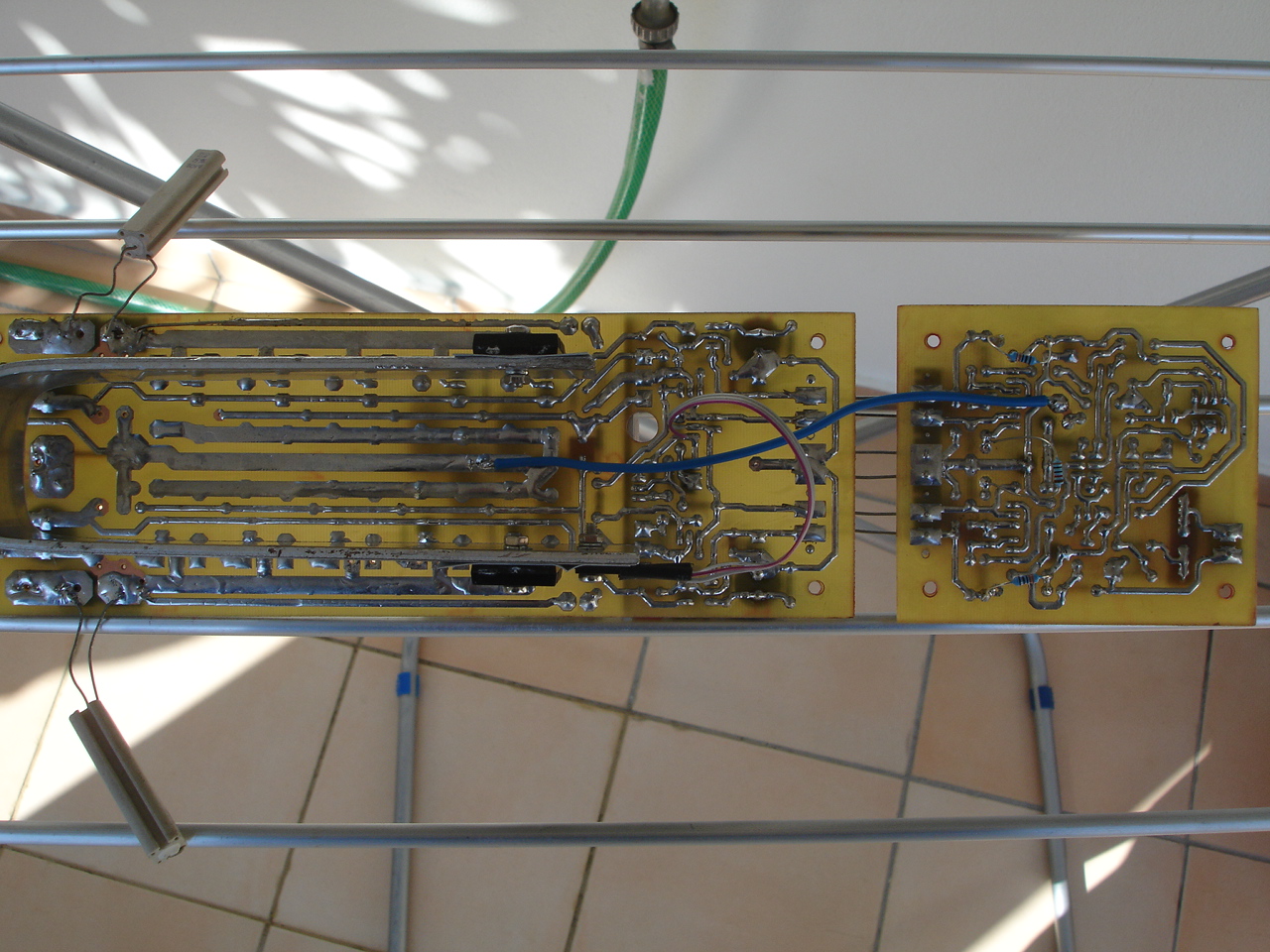

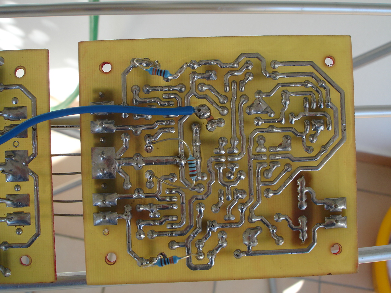

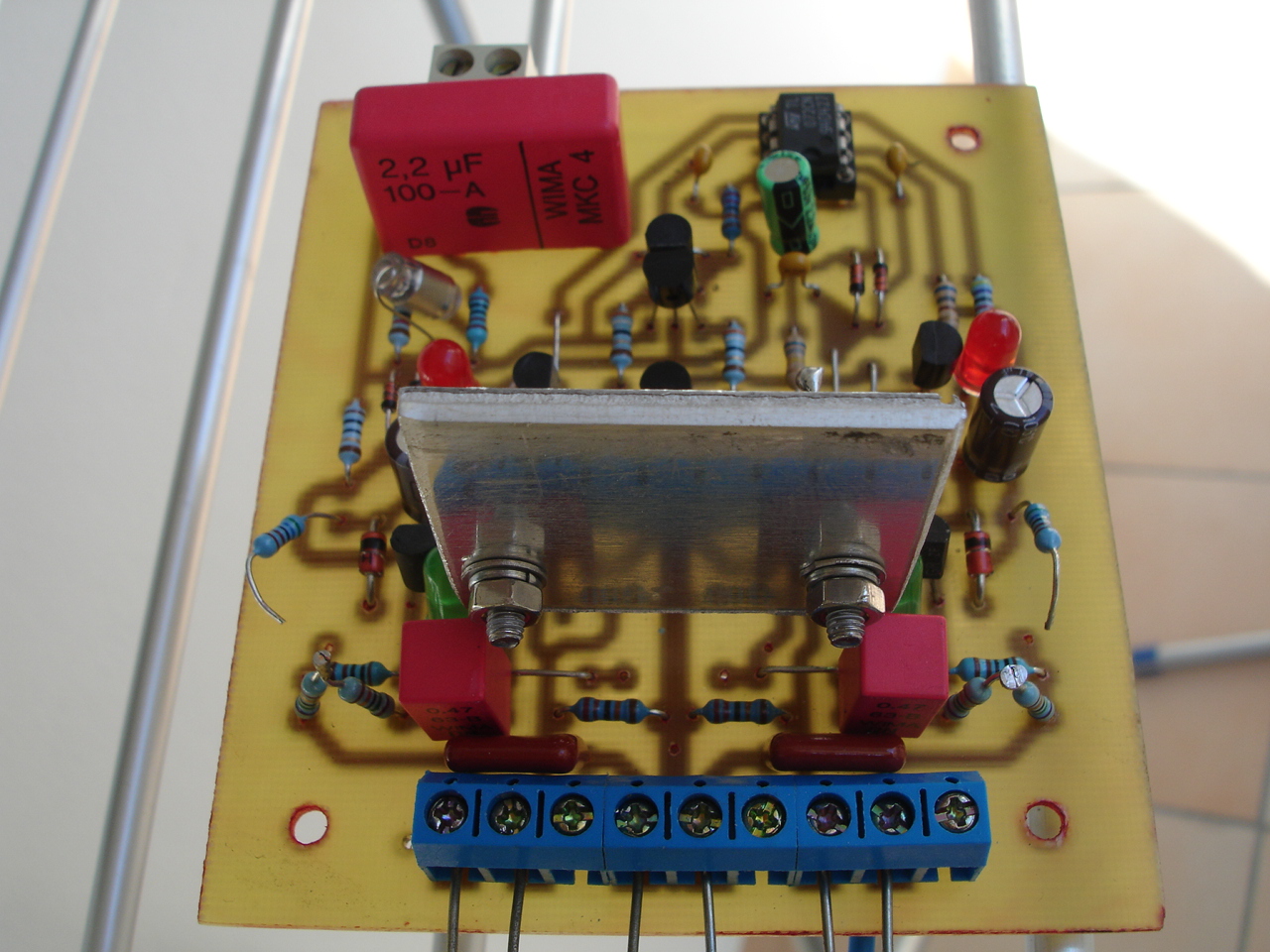

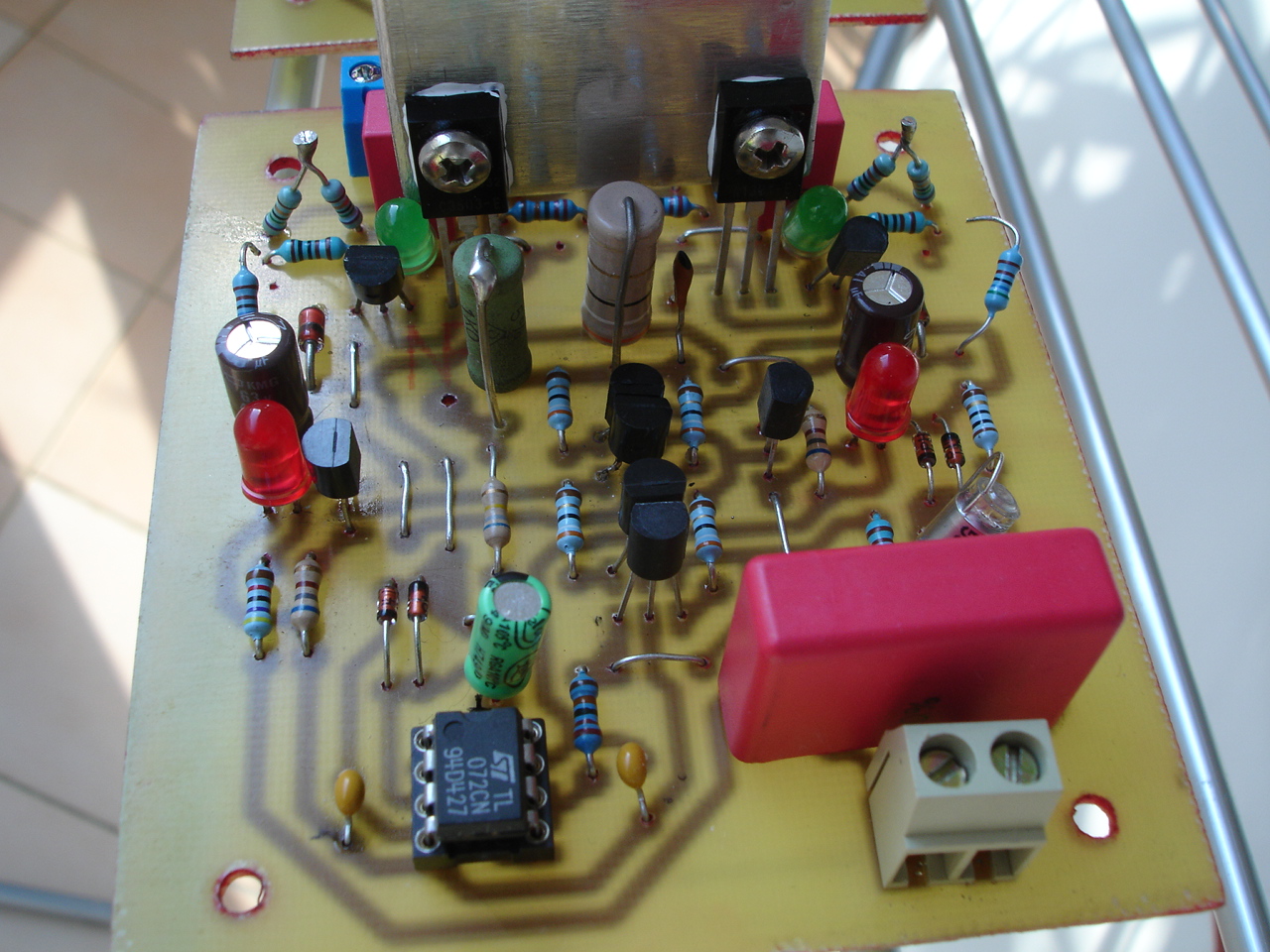

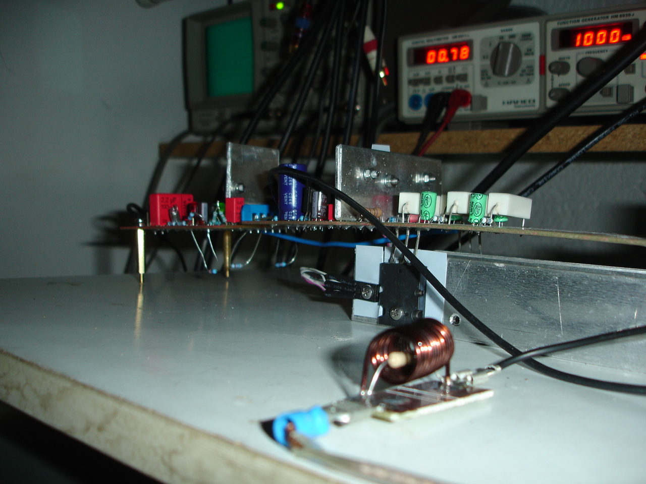

First test .
Amplifier is singing!
+/-44V
idle current =20mA
Offset= -1mV
One pair c5200 a 1943
Resistors R9,R11 changed from 5k6 to 3k3 because with 5k6 Vzener =5.3v only.
+/-44V
idle current =20mA
Offset= -1mV

SWEET Congratulations ENJOY
Thanks Krisfr .SWEET Congratulations ENJOY
I come back with first measurements later.🙂

This was predicted ... (zener "tweaking")
I will add this to the IPS schemas ..
3K3 for "baby" OPS 40-50V
4K7-5K6 for master - 60-70V
6k8 for 70-85V (monster).
This effect also reflects servo IC choice (2-4ma) , red LED current
and CCS current (all using the 12V supplies).
You do it just like I do ... start with 1 pair OP for 1st test 🙂 .

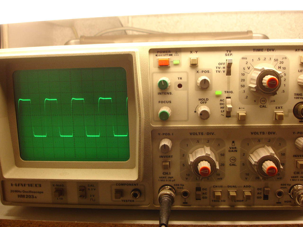

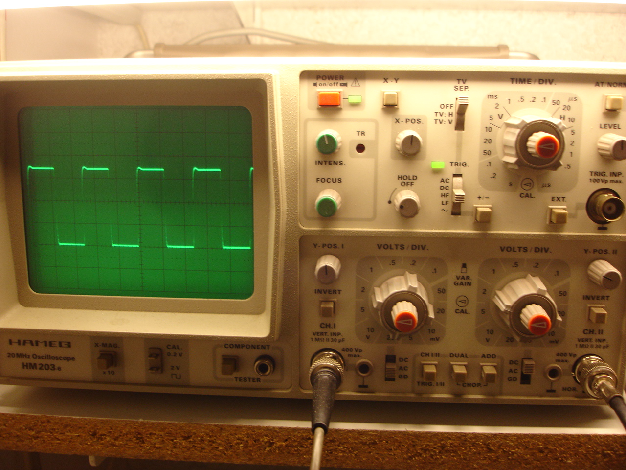

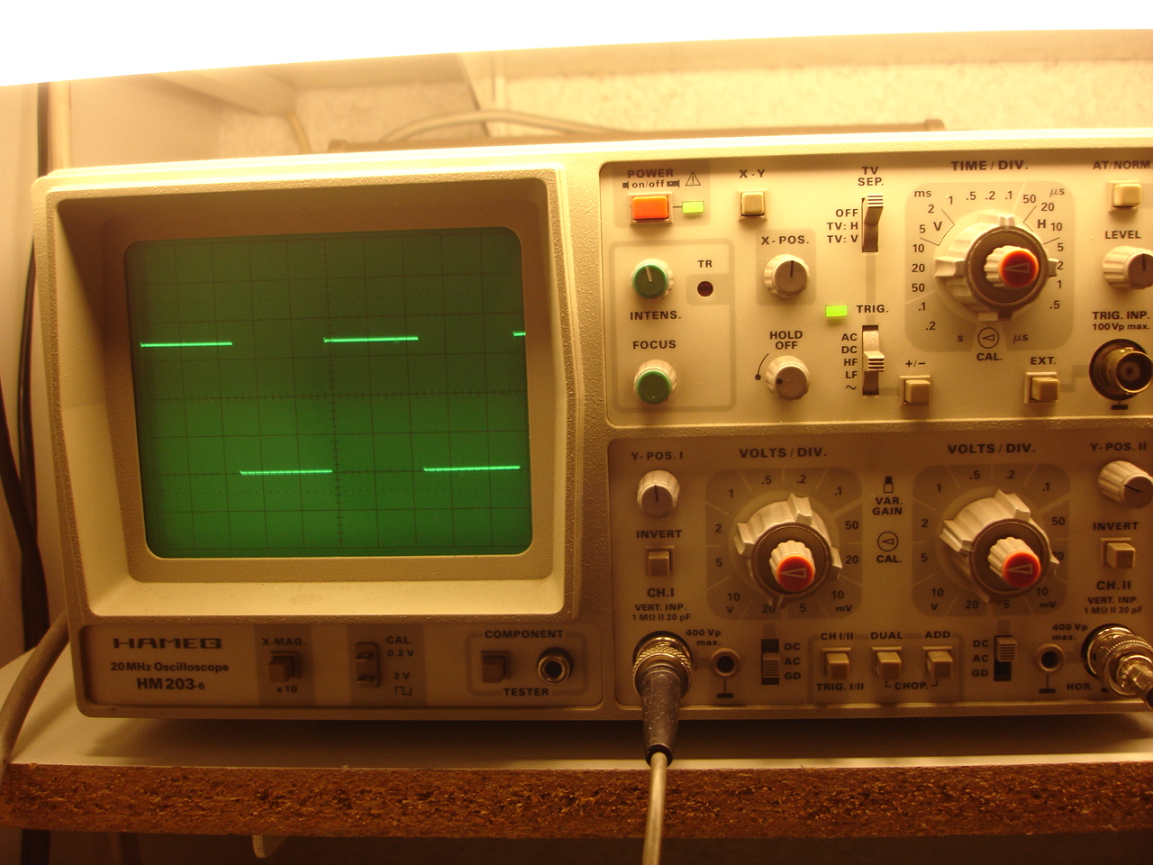

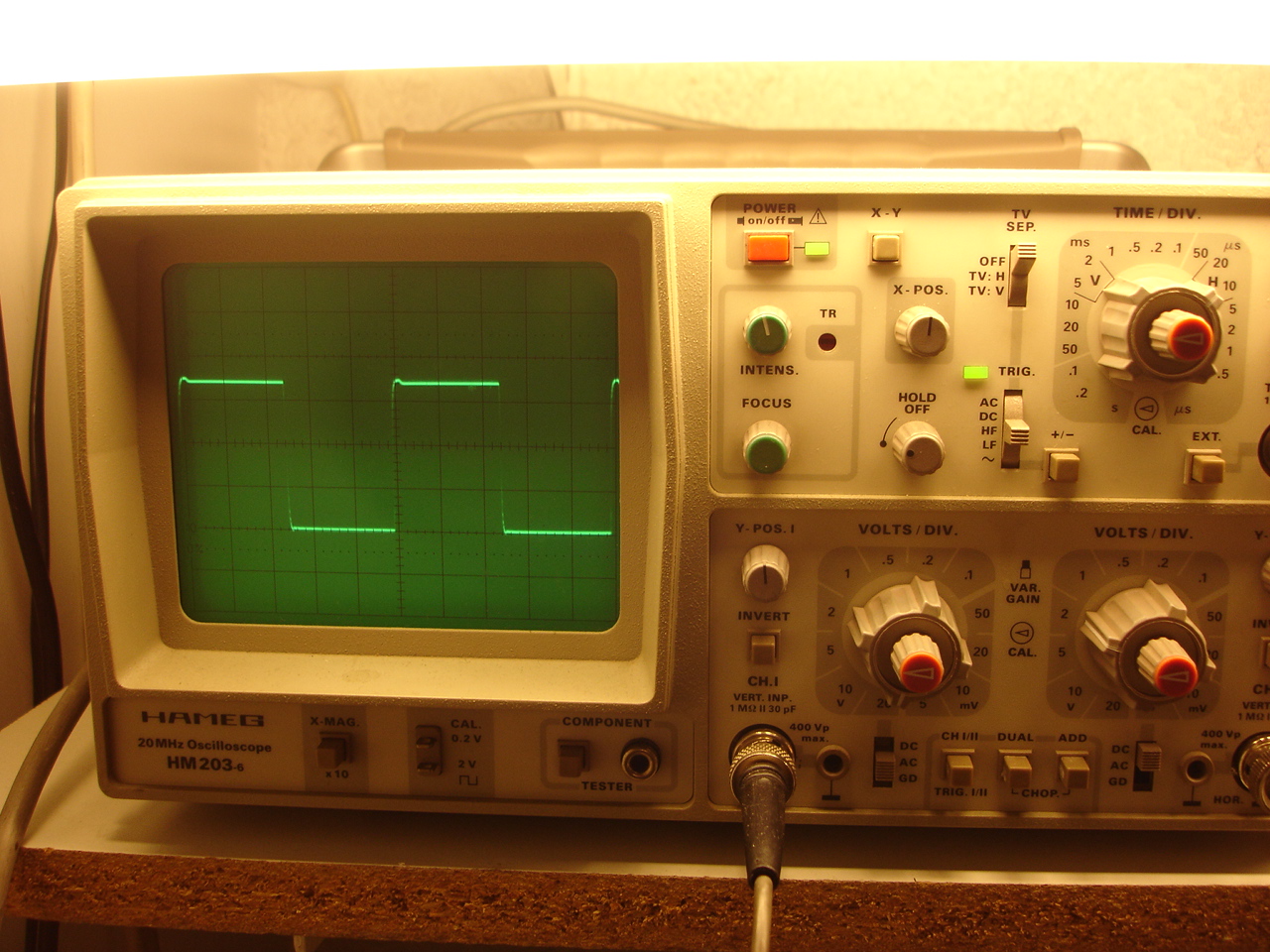

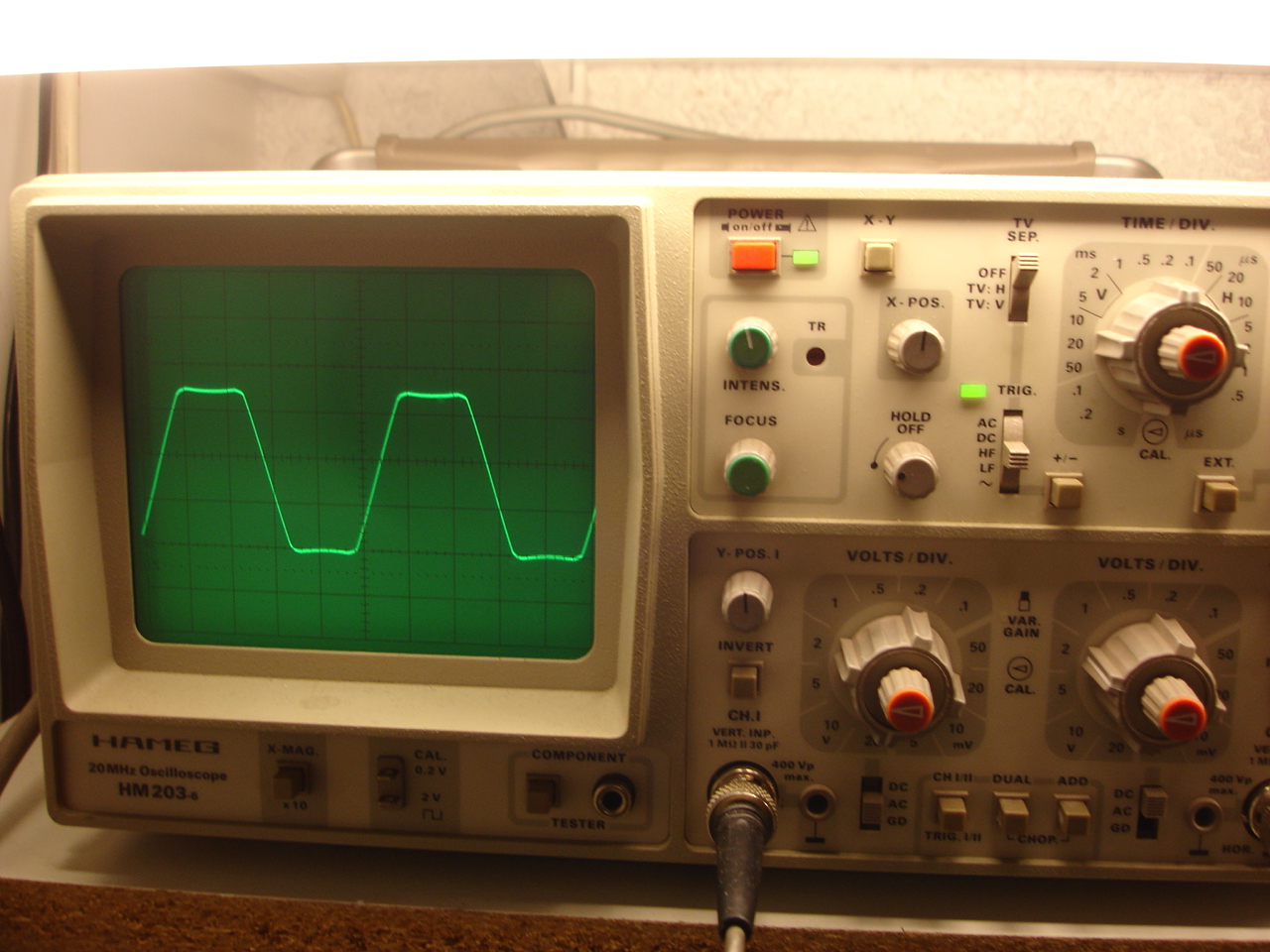

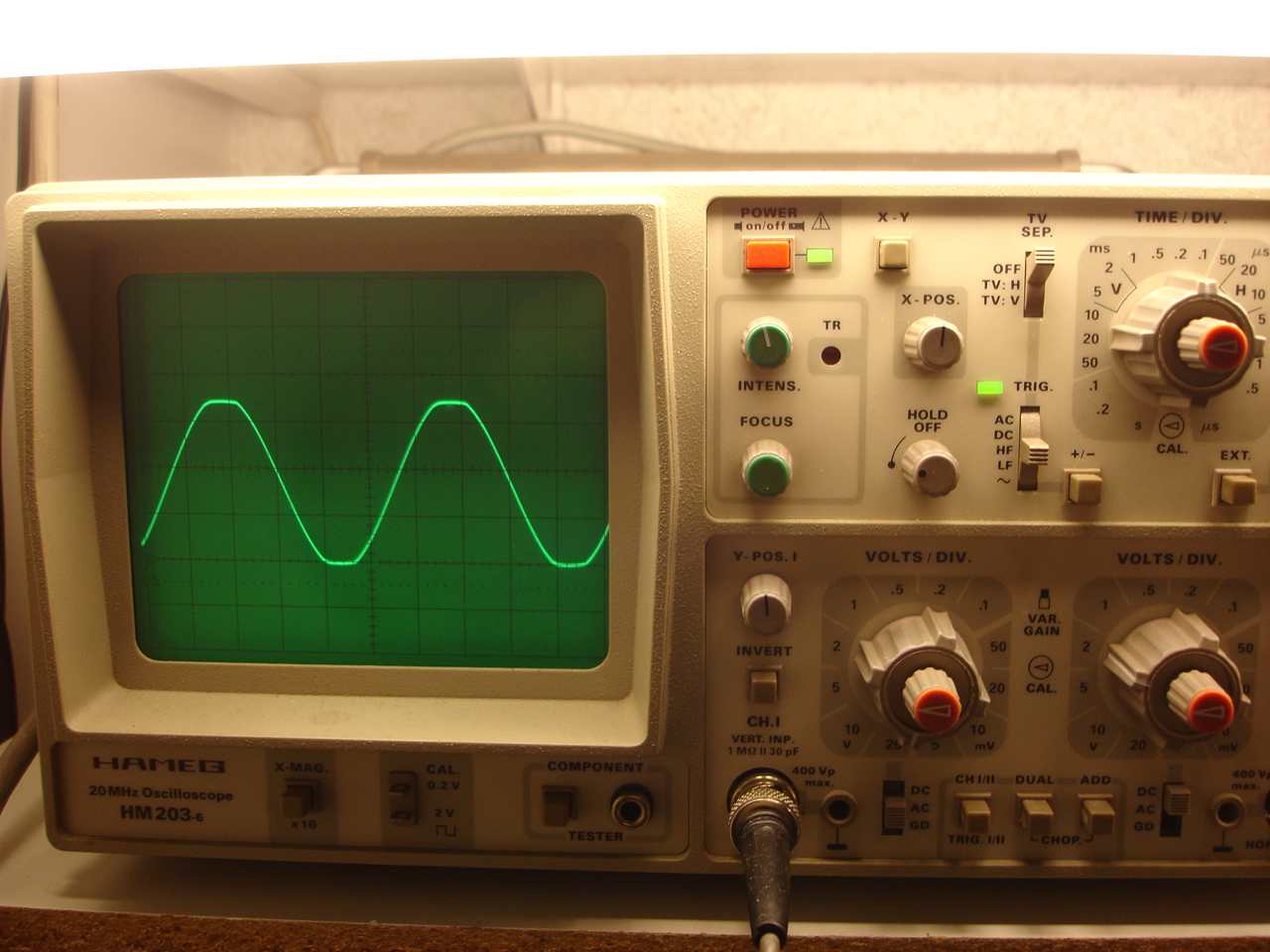

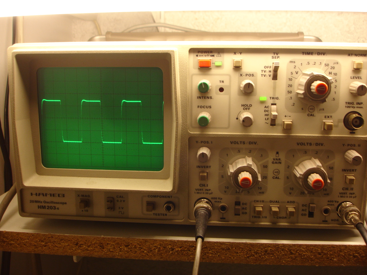

First measurements.1kHz,10KHz,20KHz,30KHz,40KHz.FULL POWER, PEAK TO PEAK 70V!
No:6 Nice symmetrical clip at 24V RMS
No:7 Hard clip.
1V RMS inp. 24V RMS out. just before clipping,72W RMS /8R/+-44V SUPPLY.
No:7 Hard clip.

When you have two channels... even before putting it in a chassis.... can you listen to it also and tell us how it compares to other?
THx-RNMarsh
THx-RNMarsh
Yes of course but now i haven't many parts for this second channel.When you have two channels... even before putting it in a chassis.... can you listen to it also and tell us how it compares to other?
THx-RNMarsh
I will try to find parts soon.
Thimios.
3 ways to reduce "overshoot" on your SW tests.
-39/43/47p C9.
-Inductor on the board ??
-fine tune the VAS Re/I
150Re - 1.2V =@ 7.5ma current.
This also might be the long wires or other
unknown/non-ideal conditions.
It's not bad at all - but could be a little better.
Clip behavior is supurb ... 🙂
OS

some people also use a capacitance of about 1uF in parallel with dummy load to view potential oscillation with difficult loads such as electrostatic speakers..you can use a small square wave input of about 10mv or 100mv at 10khz ancheck the response..

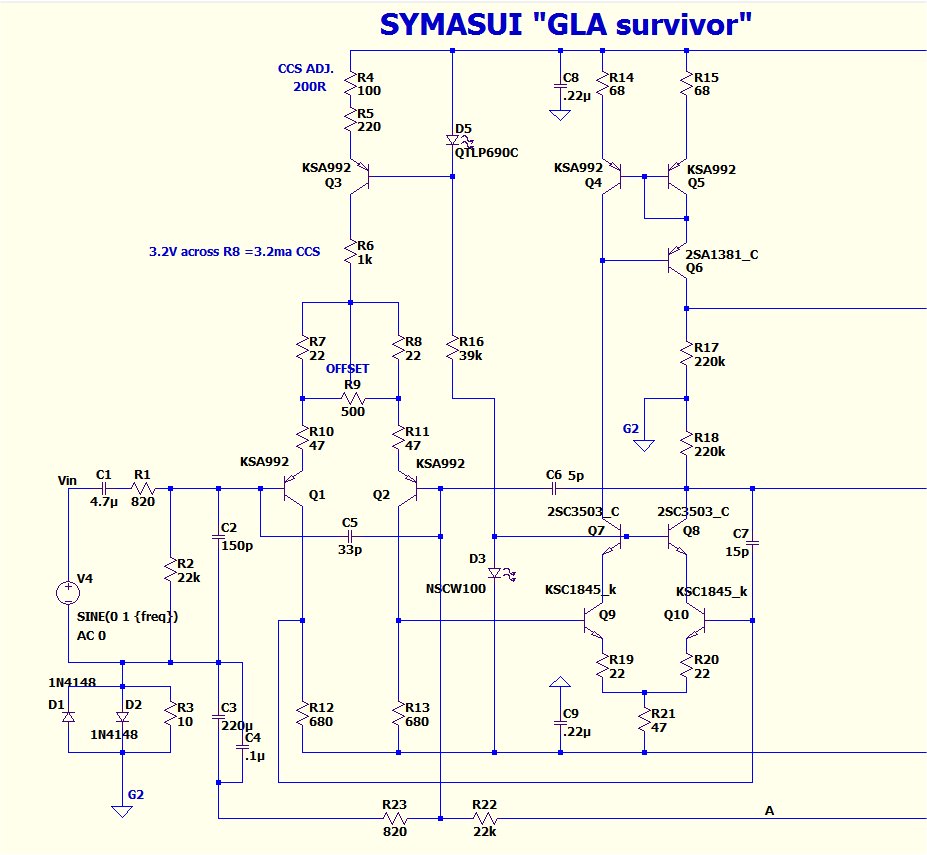

found my "gla-survivor" thread ..
To do that endeavor justice .... the best "symasym" type IPS
I could muster is about to be unleashed.... drum roll ...
(below 2 ) is the schema ...
(below 1) is the output ...
(attached) is the .asc ... it is cool !
A mix of the Sansui /symasym /and the HK680 IPS ...
A cascoded/ differential /wilson current mirror "mutt"? of a VAS ..
Any "symasym" fans - it totally "smokes" the original ...
AND is kind of simple !!
OS

@ thimios
What does clipping look like at 20kHz sine wave?
Be careful when testing with sqaure waves at 40kHz and up at high power, zobel and outputs will have to work very hard.

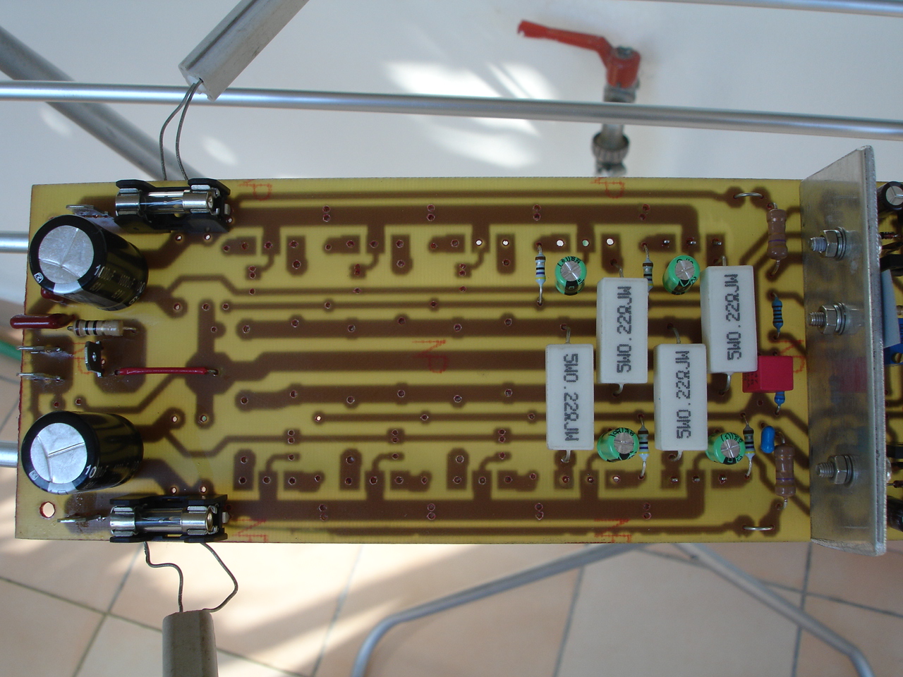

Uncle OS, post #504, the "monster"
C102/C103 have wrong polarity "Silk Screen"
just incase somebody non experienced build it
Thimios's 5P Monster has has correct polarity.

Please Ostripper have a look at measurments on the attached.
I will look for this(20khz clipping) soon@ thimios
Yes agree testing in such conditions is a hard stress very hard!
It is danger,and only for a little time.
Thimios.

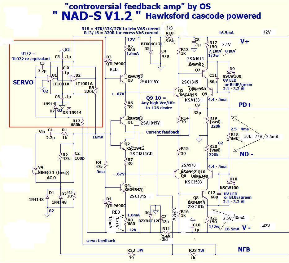

My VAS seems to run in double current.
You can change R5 and R8 to 750 Ohm. May be you put super bright red led on D3 and D4 which have higher forward voltage than standard red led.
