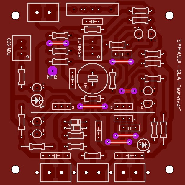

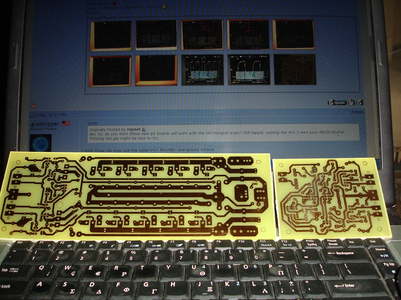

Hi OS... can you adopt SMT 1206 parts for the IPS to keep the board size as small as possible? I think this is important if we are going to mount these boards on the back of the case as you suggest.
76.2 X 76.2mm ... not small enough ? 3" is tiny !
I know many like SMD , but where would I get that 220u NP cap (SMD ?)
PS - the front of the case is also a option , leaving the rear for AC/in-out.
OS
SMD only for resistors, ceramics and small signal transistors. Electros could be through hole
With SMD ... I could most likely do all the resistors , small PS decoupling.
VAS main devices , silver mica's , and that dang big electro would
remain through-hole.
Maybe <50mm X 76.2mm would be the net result.
(below) is the 76.2 X 76.2mm pcb.... just a little larger than a credit
card ... printed it out , fits in the palm of my hand.
Any case worth its salt that could accommodate these large amps
would have 10-15" interior width (250-375mm).
This would leave 4 -8" extra as 2 IPS's would use 150mm. Front
panel mounting would also be a option.
Most do not have SMD soldering equiptment ... for a commercial
venture .. I WOULD go for at least a partial surface/through-hole
endeavor.

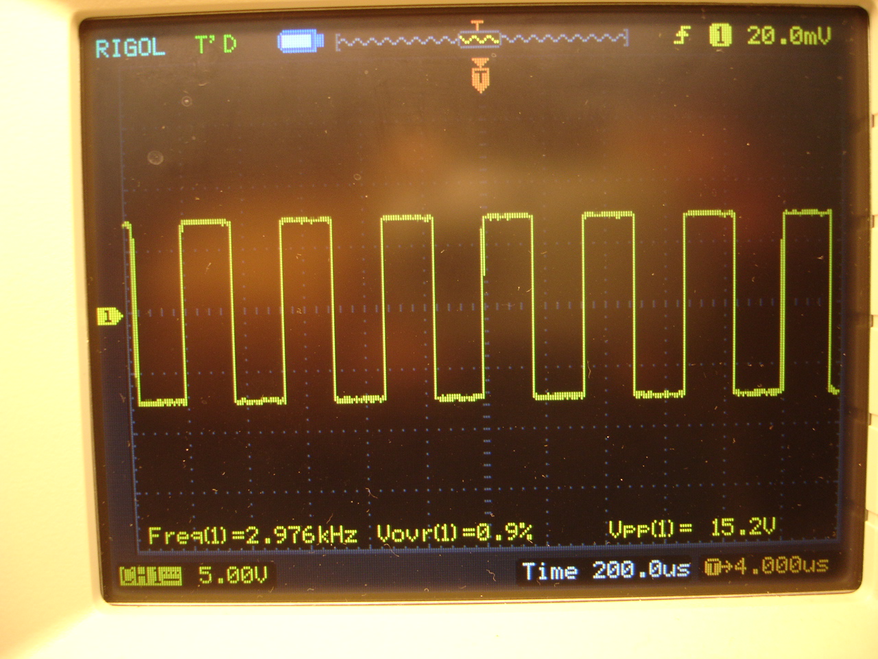

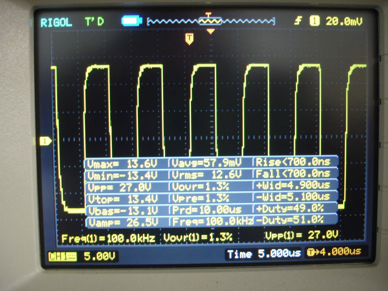

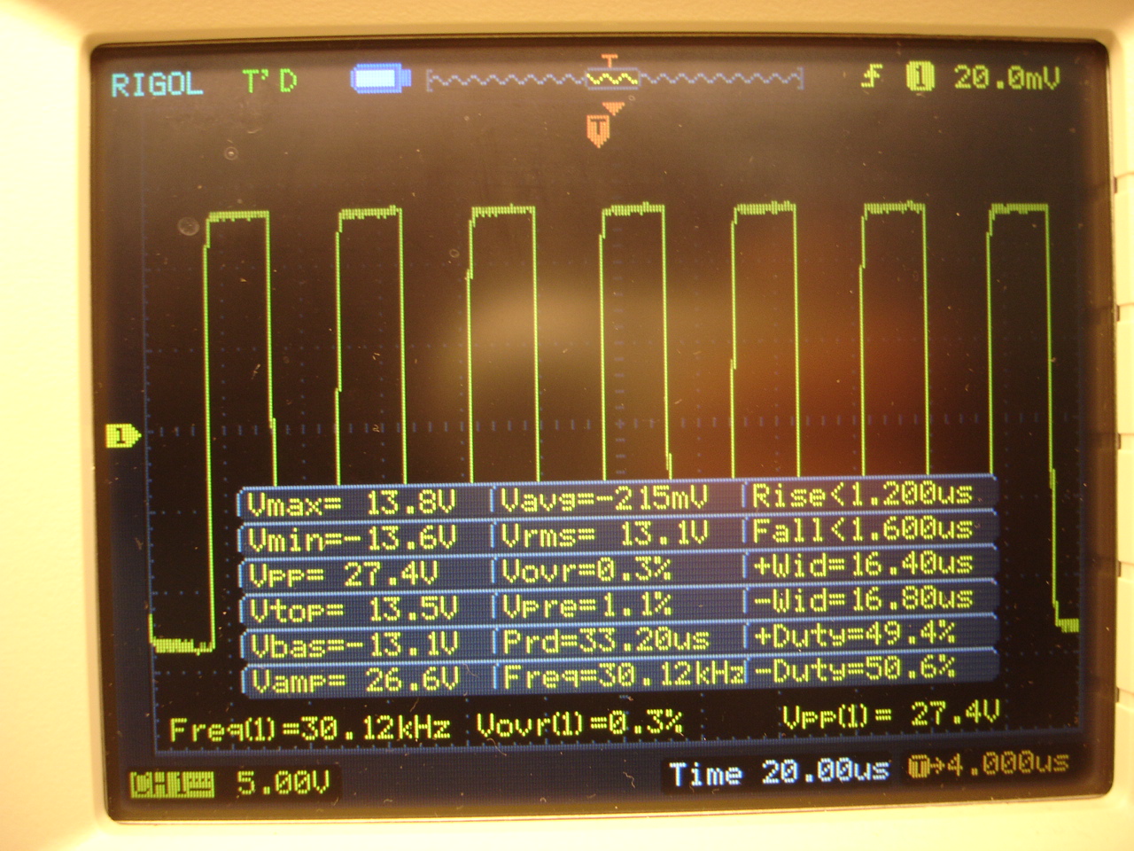

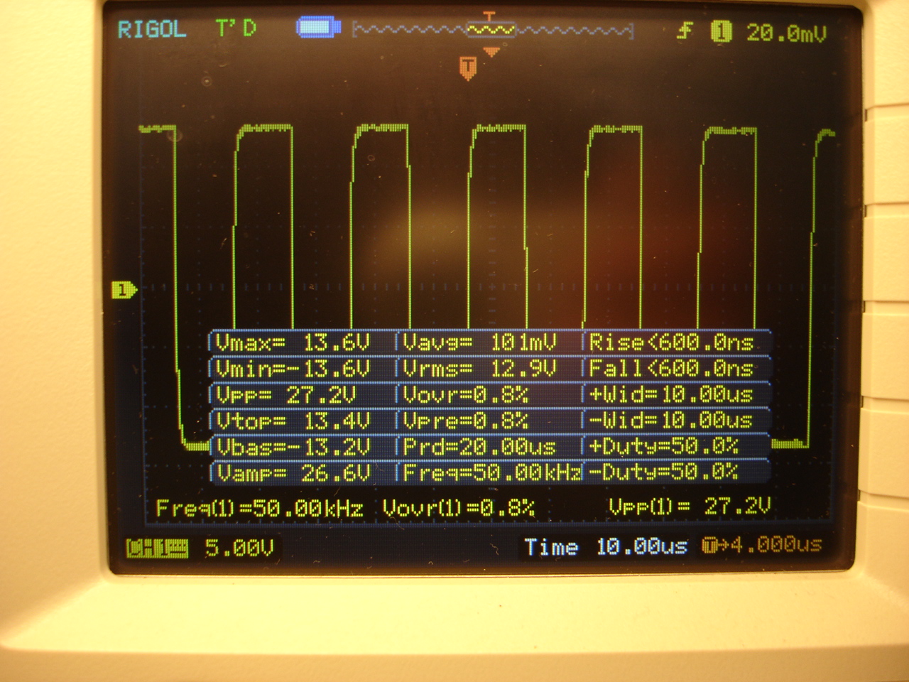

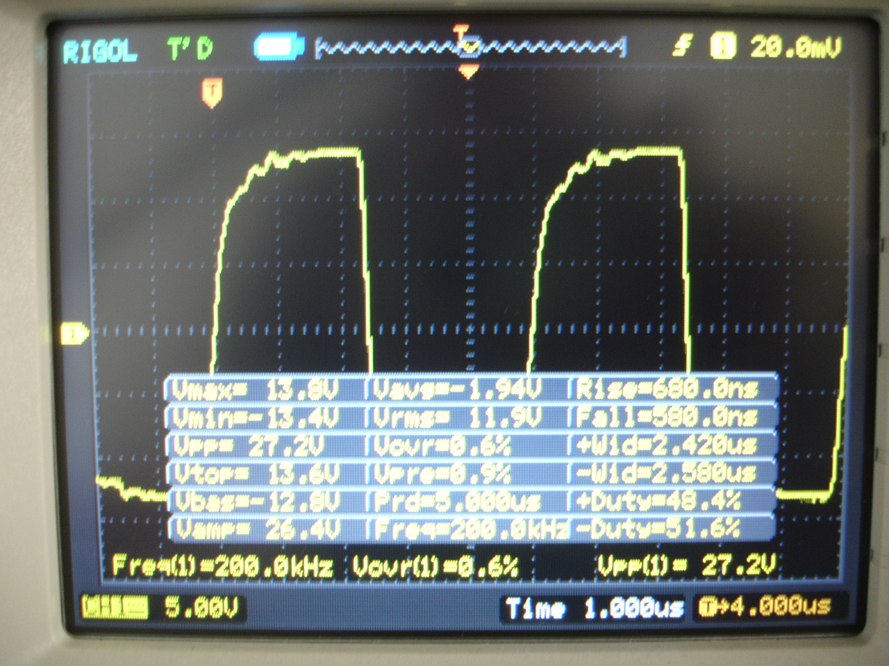

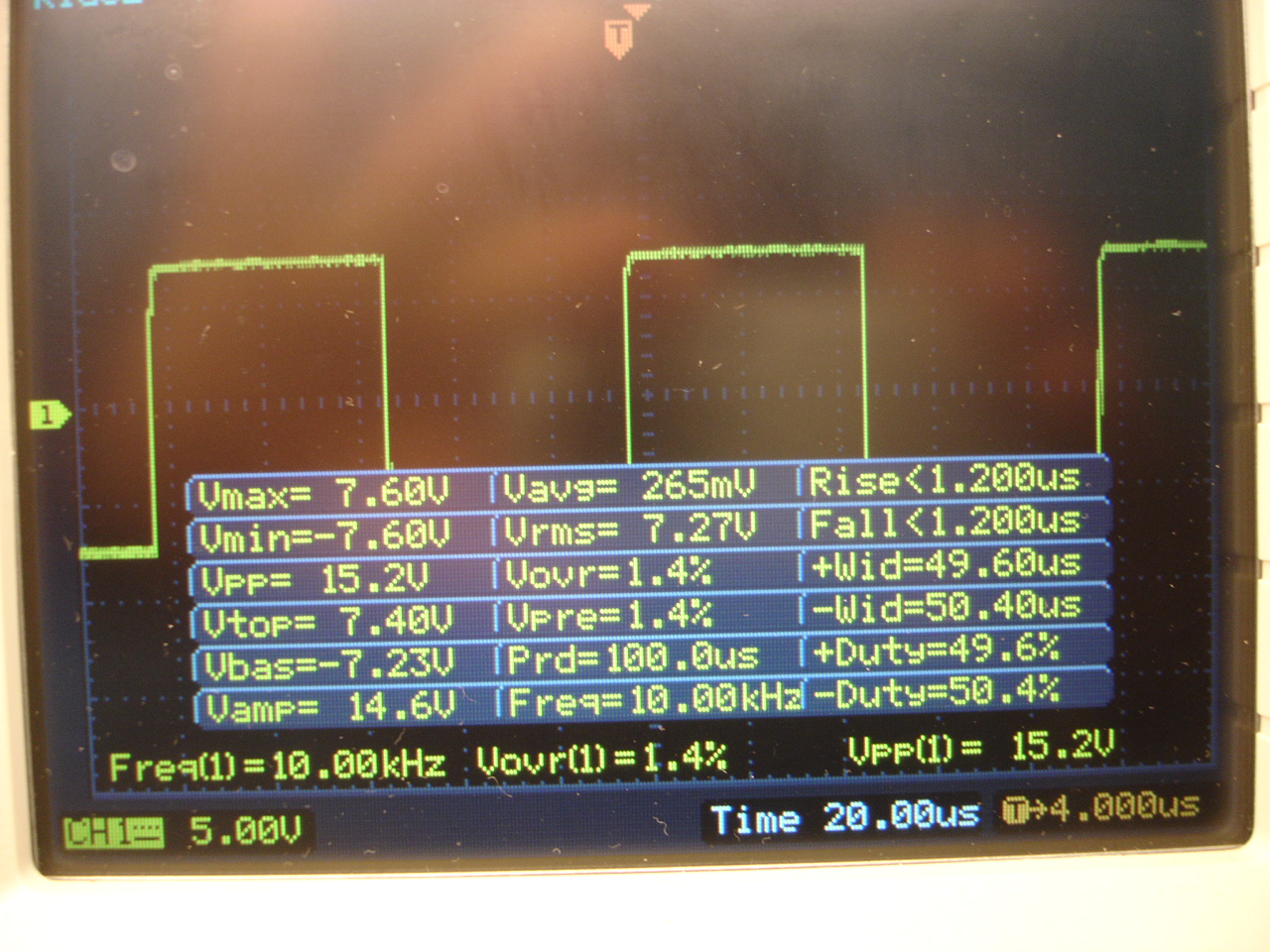

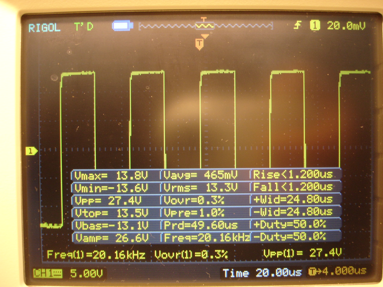

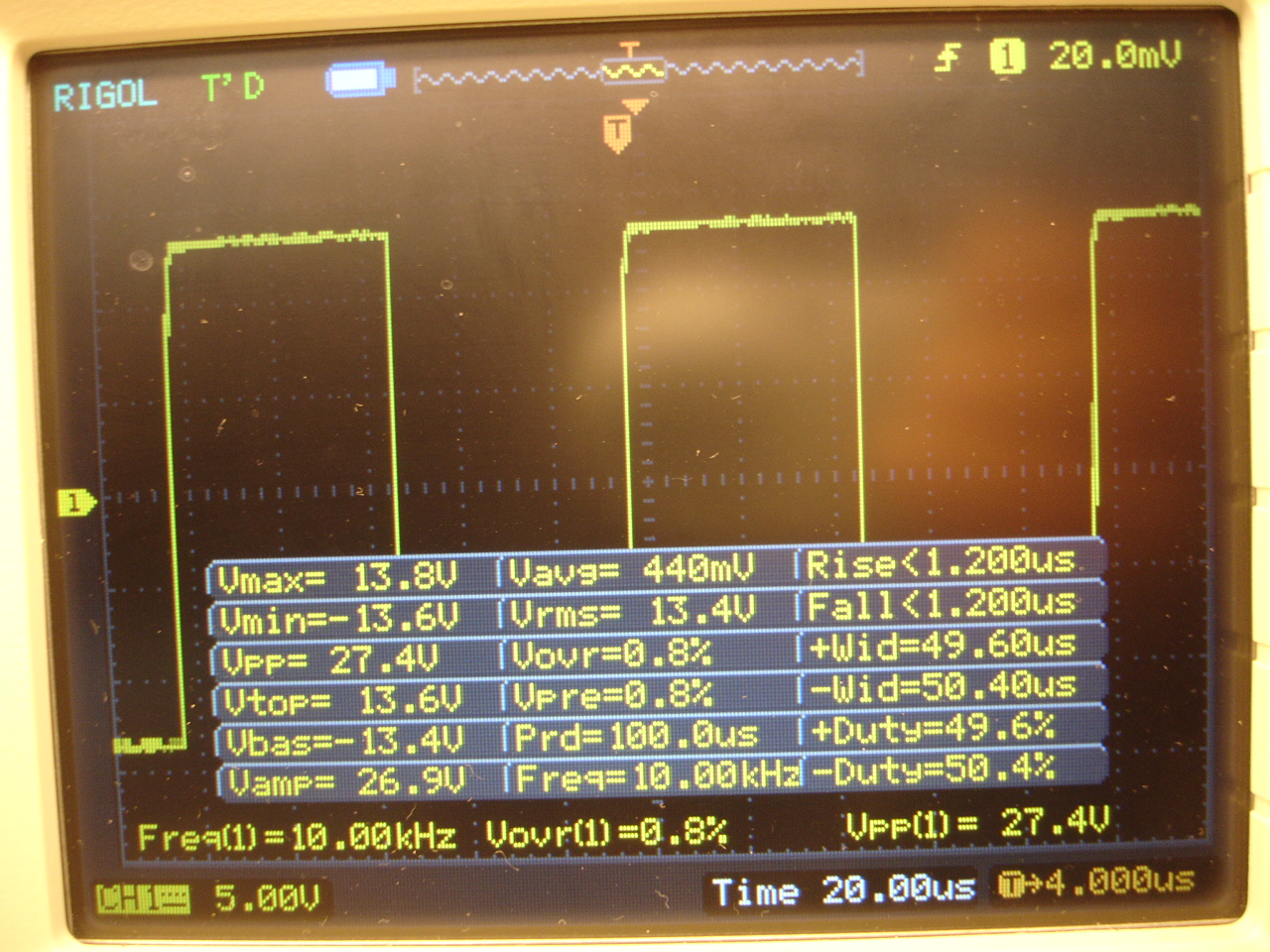

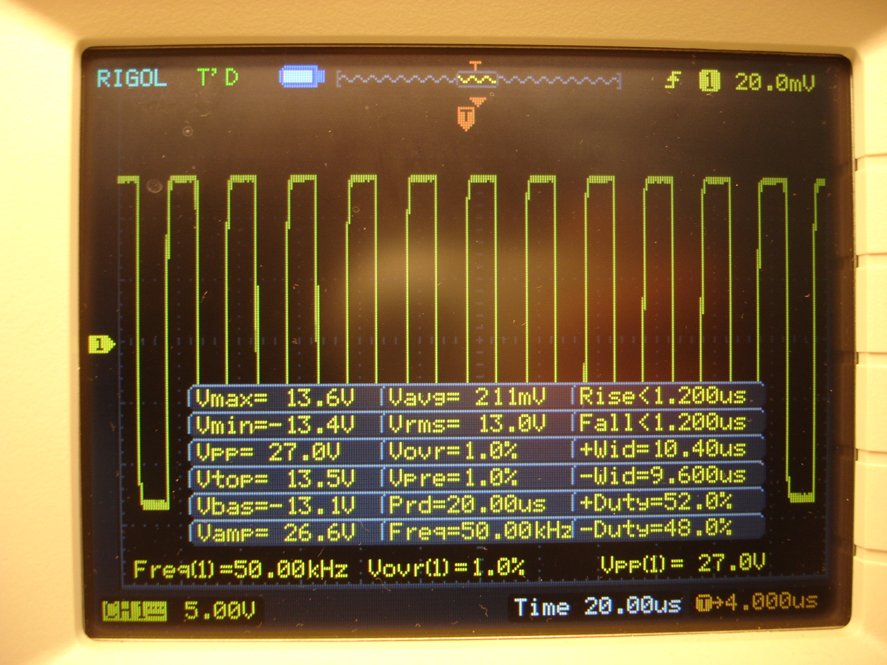

Today i have trim these resistors R16,R13 to take the recommended VAS current 7,1mA-8mA.
So new values for R16,R13 are 560R.
With this value(R16=560R) Vr21=1.1V SO I VAS=V/R=1.1V/150R=7.33mA.
I have change value of R18 also.
New value for R18=22k so Vr18=79,2V I=V/R=79,22/22.000=3,6mA.
I have a small test on digital oscilloscope also,and ONLY a burned 10R .😱
Zobel network.😎
I have an alternative IN board in stand-by.🙂
Thimios.

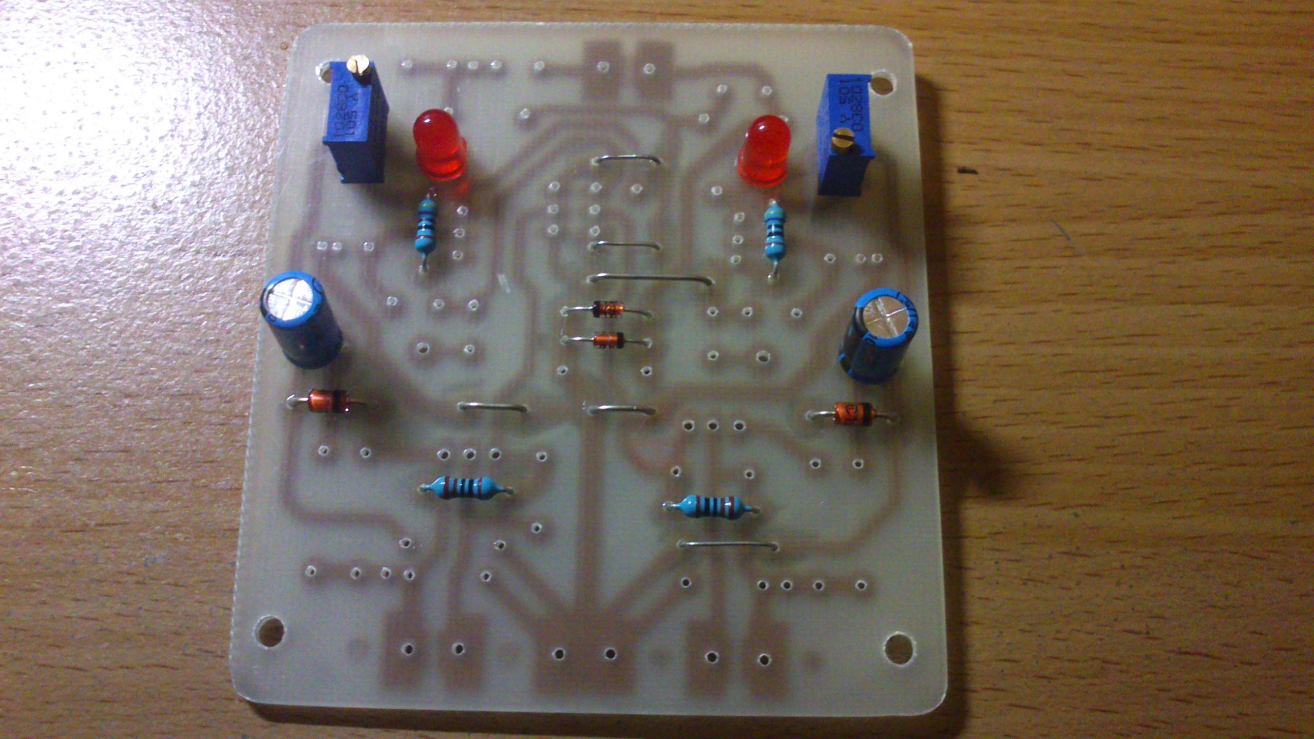

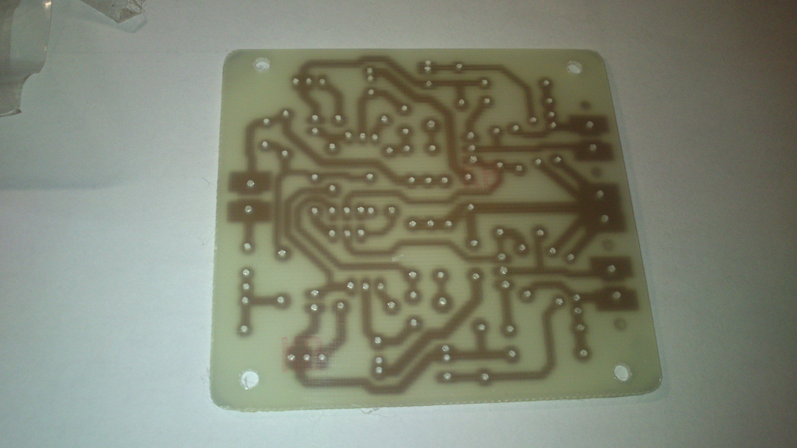

this is my progress of so far... I have some questions about CFA-X
1)Capacitors C5-C6 must be nonpolar?can we use single polarity electrolytic caps?
2)what alternatives can we use instead of ksa992-ksc1845?
3)do transistors Q1 and Q2 have to be matched ?
1)use 2x2200 back to back for each of this.
2) 2sa 970 or 2sa1015-2sc1845 or 2sc1815
3)yes.
Good luck.
