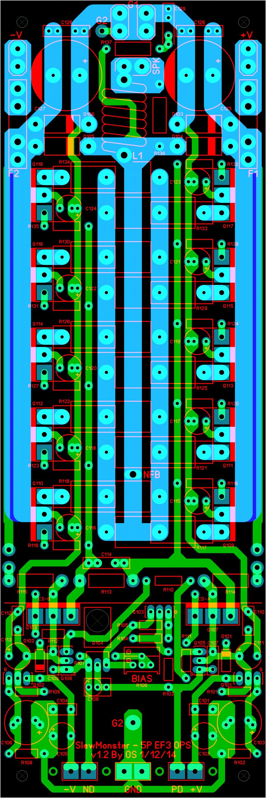

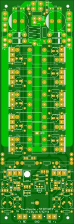

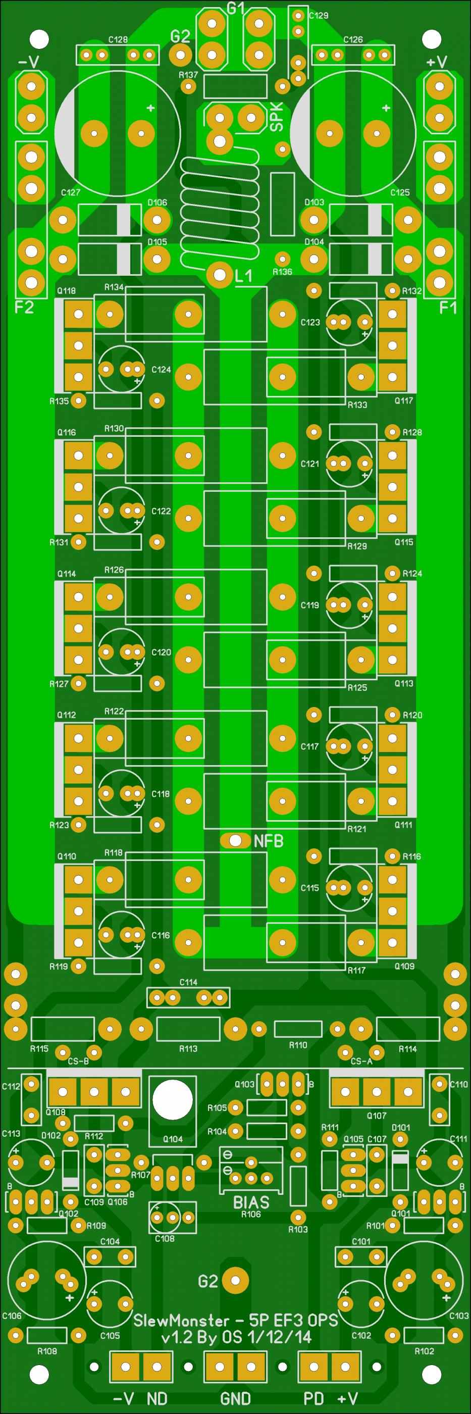

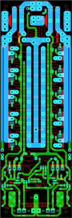

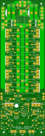

OK, multi-pitch back in for the OP decoupling capacitors and verified maximal clearance of 1mm is available, unnecessary 'stitching' pads removed from power rails, multi-pitch added to CM capacitor. Thoughts?

I will go back over the file again and do an export shortly. I have a slightly earlier set already on order, so hopefully I can find some folks who are interested. No really big differences, just missing some of the multi pitch pads.
These are really cool! DIYA at its finest. I can see having a set on a couple big sinks sitting and waiting for the next cool front end. Probably all kinds of topologies that will just bolt up and fly, as OS puts it.

He he. Well for me it would be great. I am getting quite a pile of boxes in my room. I'll never find homes for all of them. Having an OPS like this set up on heatsinks with speaker jacks and inputs ready to "plug in" the latest IPS.......well that's the DIYer's dream set up.
One other question. Is there a way to have the "jack" for the NFB somewhere more accessible? How do you go about plugging that in or do you have to solder it in each time?

Realease the hounds! Er, Files?
Are we ready? There were just a couple of very minor 'touches' just to satisfy me after not having looked at it for a few hours, mostly silk touch-up. I will post the files if OS thinks they are really ready.

I'm sure a good solid locking connector could be found, either an 'in-line' type or a PCB mounted type. Heck, so long as it is snug, or doesn't become loose with repeated use, a spade would likely be secure enough.
OK, I probably just solder in a good size wire with a female spade connector on the end. Just seems strange that we have releasable connections for everything else and just a solder pad for this and it's sandwiched between the big resistors.

I would make the disconnect on the IPS and leave it soldered to the OPS, or do an in-line connection as you suggest.
I think OS just doesn't want to see the amp go 'open loop'. That has the potential to be baaad.
That and I think the concept wasn't to be constantly switching / swapping the IPSs, but rather to allow a choice for the builder. Though I'm sure some of us will swap things about a few times....
