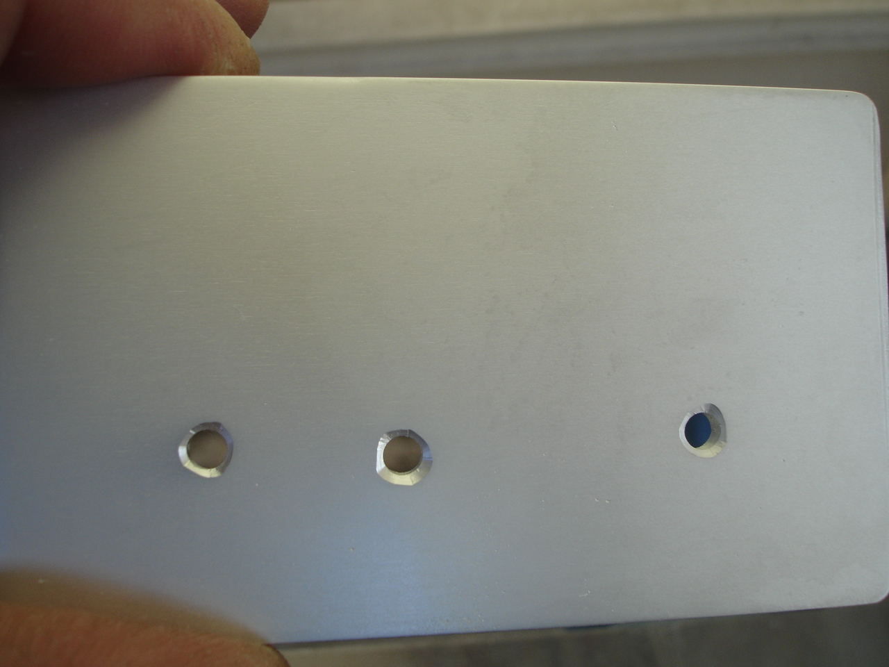

My first try in aluminium anodize.

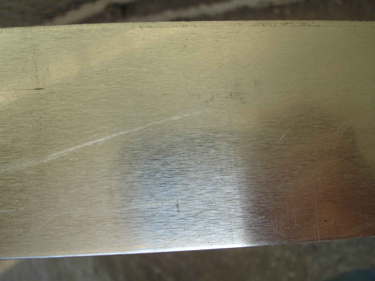

First picture ,aluminium before anodize
Second,aluminium after anodize.

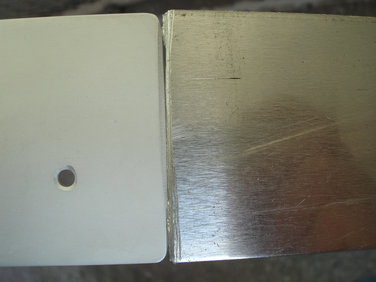

Third ,left after ,right before.
Sorry ,i know this is of topic but this ampl. deserves a beautiful heatsink!

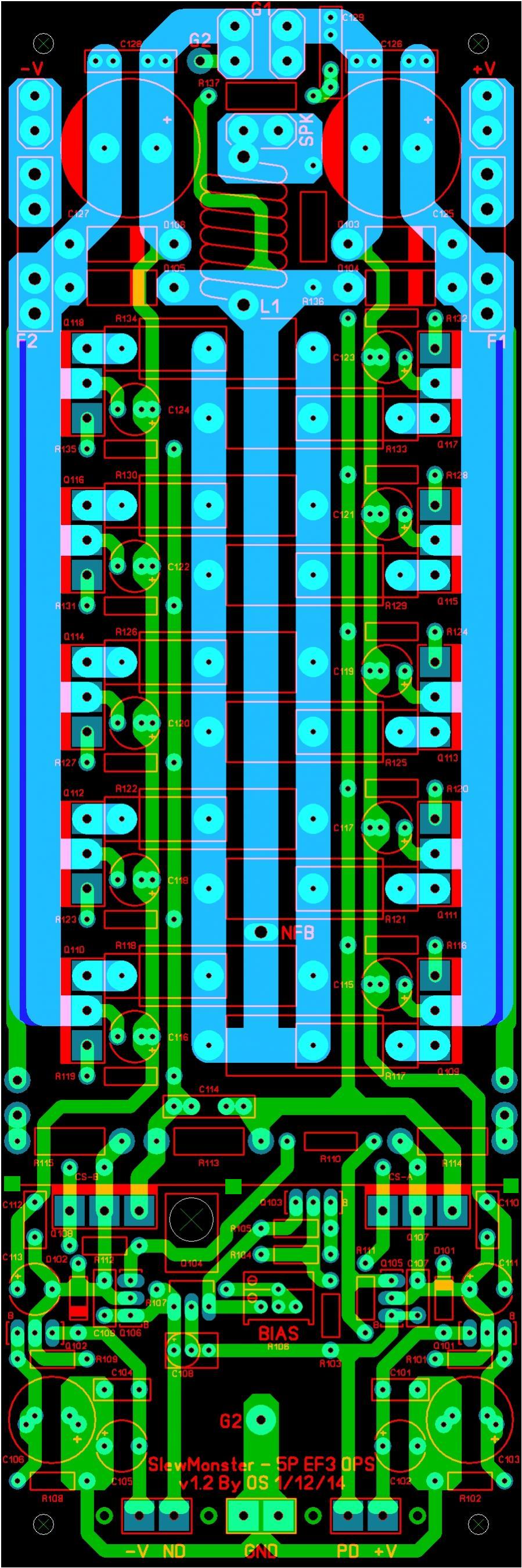

Output Stage:
on the OPS would it be possible to have pads etc for appropriate connectors to be used for the NFB? For example something like:
1212 - KEYSTONE - TERMINAL, SPADE PCB | Farnell UK
Cheers
Rob
Output Stage:
Cheers
Rob
so a fly lead may be the only option? Was just a nice to have ad the OPS appears to have everything 🙂

Pads added for a spade. That should be workable.
That works REAL good , T !!
They charge exorbitant fees for anodization - please explain the
process - that looks pro !! 😱
OS
Ok Peter i will try to explain with some photos soon or with a short video.
Just now i have find a similar process here:http://www.thefintels.com/aer/homealuminumanodizing.htm
