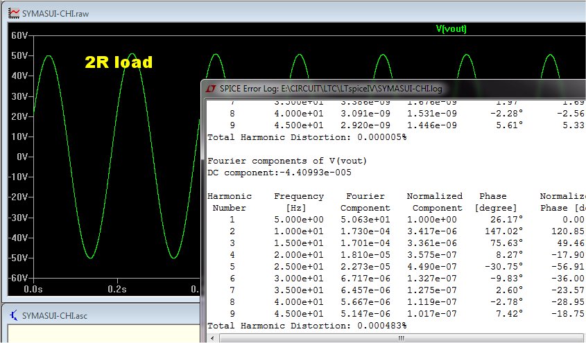

Hi OS,
Did you find a measurement which might explain why the SYM would be better for bass?
THx-RNMarsh
-It's tempco is the closest to zero , good for an enclosure.
-It's ability to create those HUGE waveforms with little thd degradation,
and the fact that it shows the lowest "blocker cap" THD at LF. (below)
-It's utter simplicity.
os

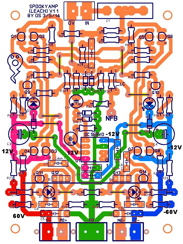

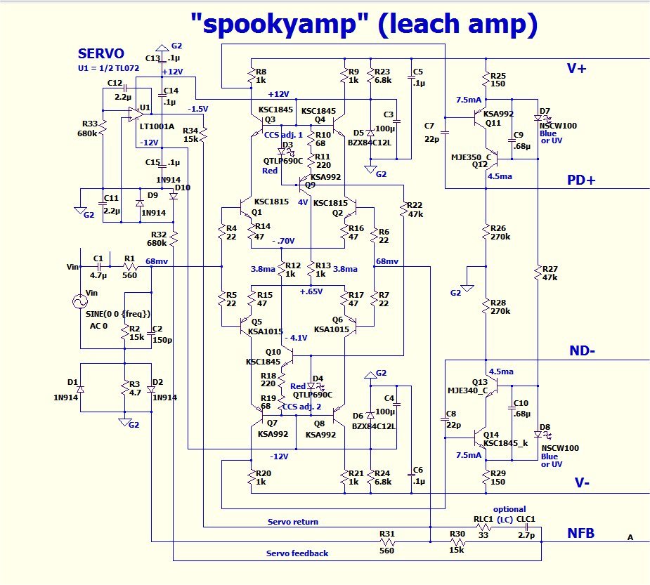

Ostripper,
I am studying the schematic for your SpookyAmp v1.1 from post #803 and comparing it to the PCB. The only difference that I see is that D3 and D4 LEDs are wired to ground thru a diode rather between the bases of transistors as shown in the schematic. I presume that was on purpose.
My real question is to ask which resistors had you planned on not being 1/4W? I presume R25 & R26 are 1W rated. What about R26 & R28? I presume there are others. What have I missed? I'd rather not screw this up!!
And mica caps at C7 and C8. Anywhere else??
D5/D6 are 12V zeners ..all is correct here , they regulate the traces
connected to the servo,capacitors,cascode bases and CCS's/(leds ) .
R23/24 feed those zener diodes from the full rails ...
Maybe I should designate them "ZD5 / ZD6" 🙂 .
All the larger lead space resistor placements are best 1/2W+ ... R27 might
also be 1/2W depending on rail voltage/value.
Edit - yes , mica for Cdom1/2 (C7/8) ..
I think NAF already proofed and etched a pair of these.
OS

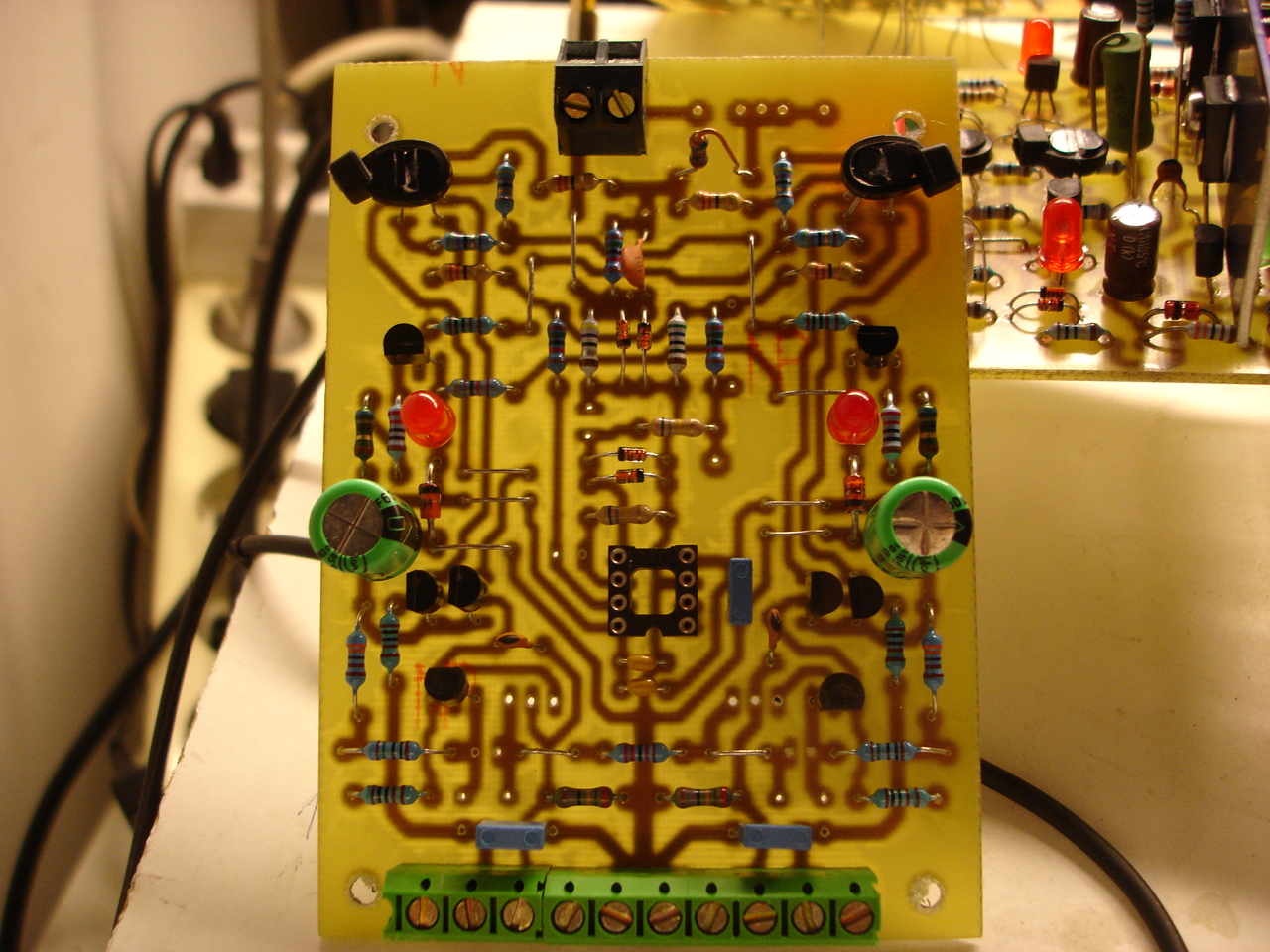

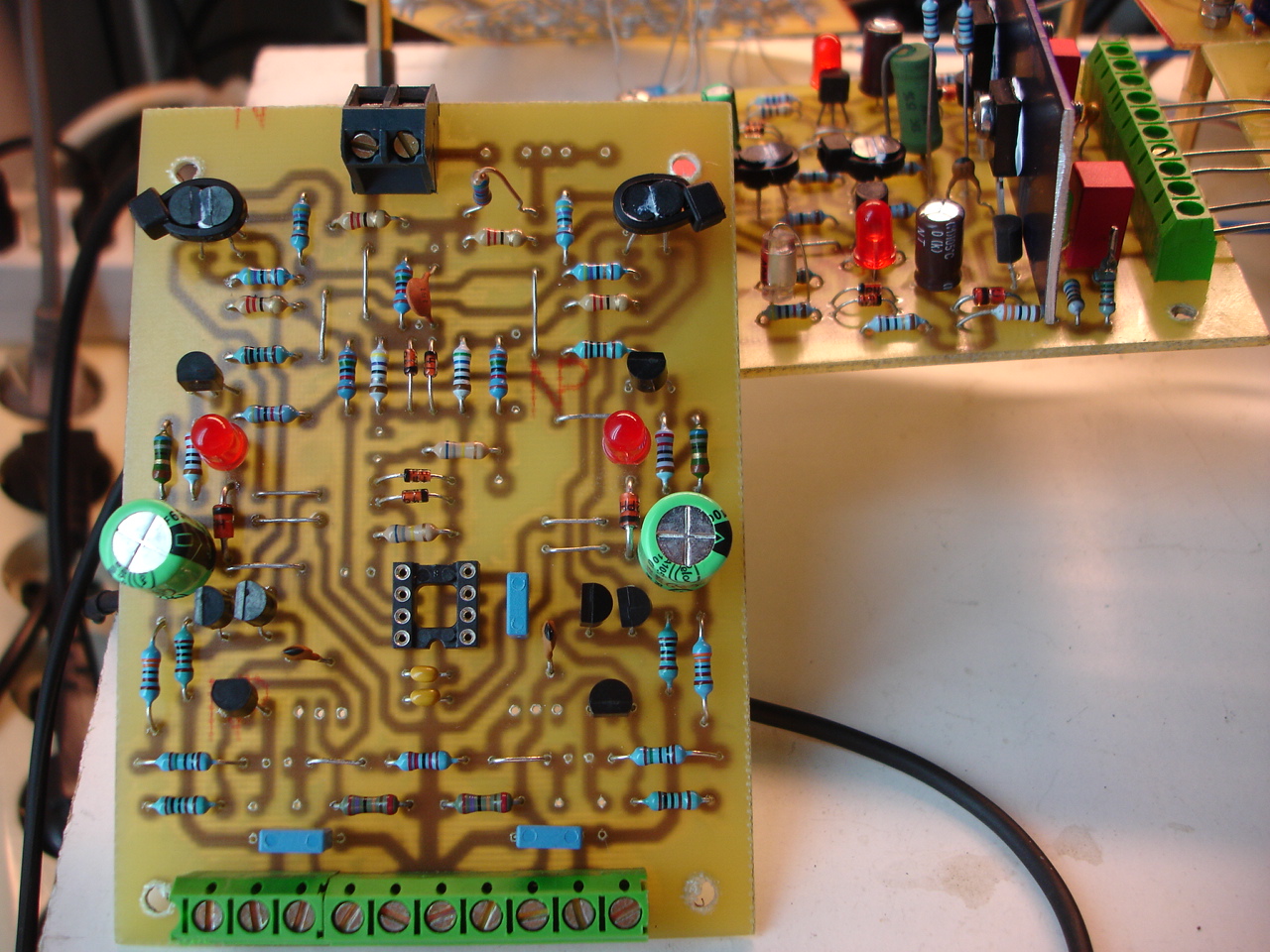

Spooky just before finish
Saved your good parts for the spook ??

Pete, may i have a question?
Which resistors must be changed on this Spooky for +/-45v?
Maybe just a slight I increase to the green LED pair. And a slight
reduction of the dropping resistor value to the 12V zeners .
all that is +/-12V is rail independent.
OS

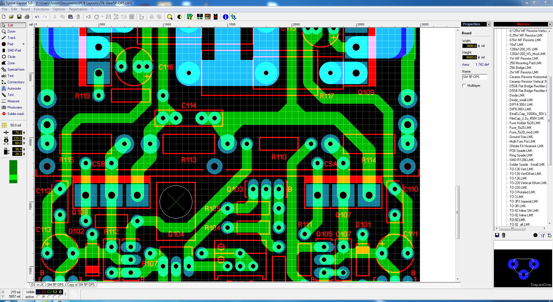

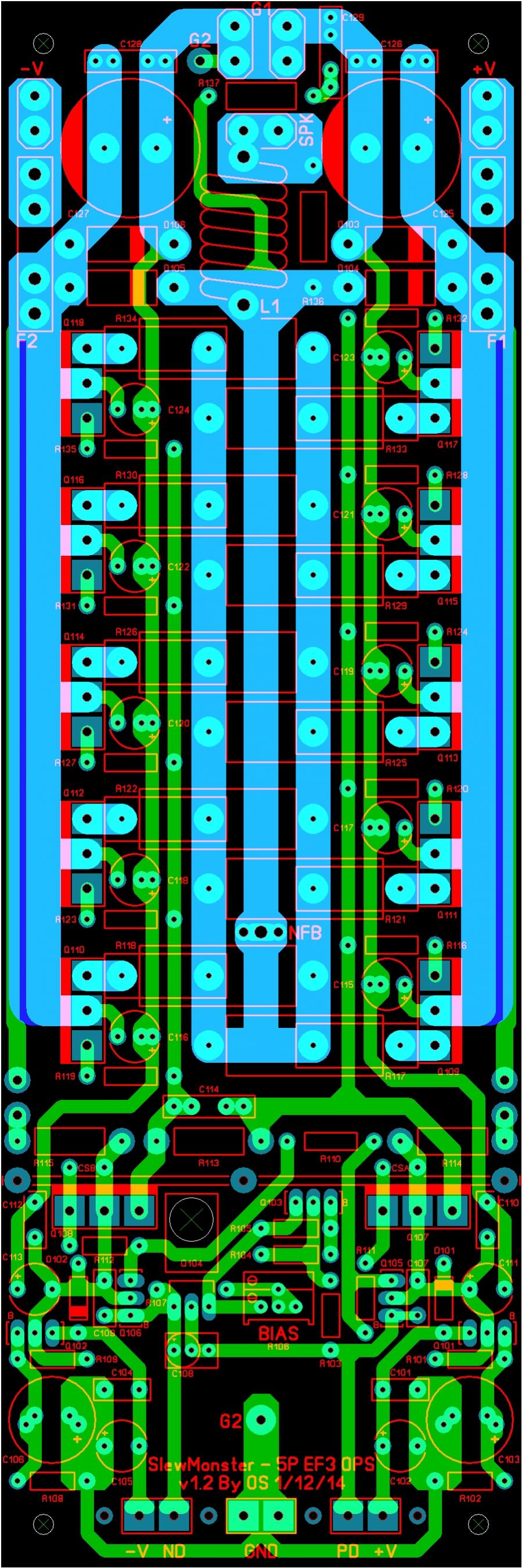

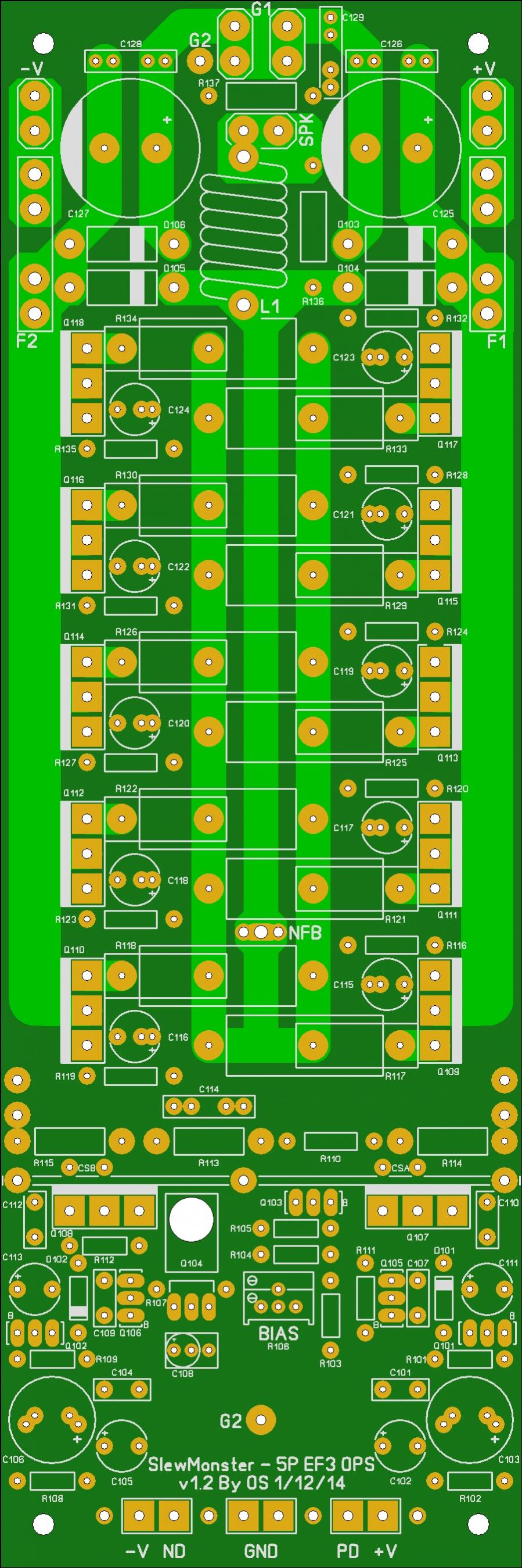

Mounting holes for the main driver HS, if needed. Does the positioning look OK? I have limited space so this looks like a workable place to have them.

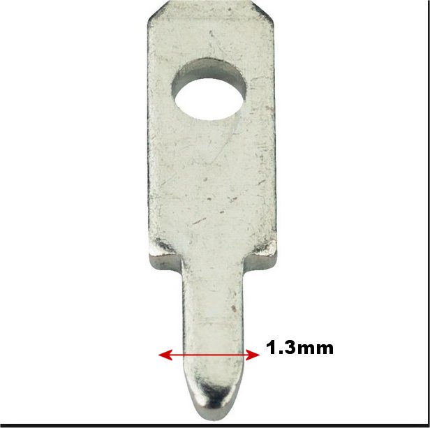

If you want to do it ...
Find a TO-3p drawing , calculate the mm from the pins to the device
die plate ... add 2mm for the HS.
Then you will have an exact idea of available space.
PS - also just 1mm PTH holes would be better , you could use a solder based mounting
solution - or drill for screws...
OS
Everything is exported and ready. If this gets the 'Green Light' I will pit up the ZIPs with the required files.
here is what I meant about a solder based mounting system.
Vogt Verbindungstechnik 3780A08.68 Solder Spade Connector from Conrad Electronic UK
One of these (above link/below pix) ... screwed to the HS and
soldered into The PTH holes - the holes would be 1.3mm dia. and be
behind the 2mm HS.
These can also be salvaged from old CRT/TV vertical and horiz.
PCB mount heatsinks 🙂 .
PS - just one of these in the middle hole ... combined with the 2 to-3p
devices ... would hold the HS VERY securely.
OS

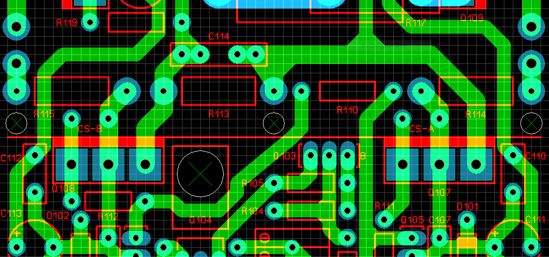

OK, the holes need to move a little. I am indisposed for about 2hr, I'll have to get to it a little later.
Good .. just -Holes moved for potential solder mount pins. on the driver HS.
Smaller pads (with the same 1.3mm holes) -Too close to those "ungodly" rail voltages
near those 1W resistors (R114/115). 😀

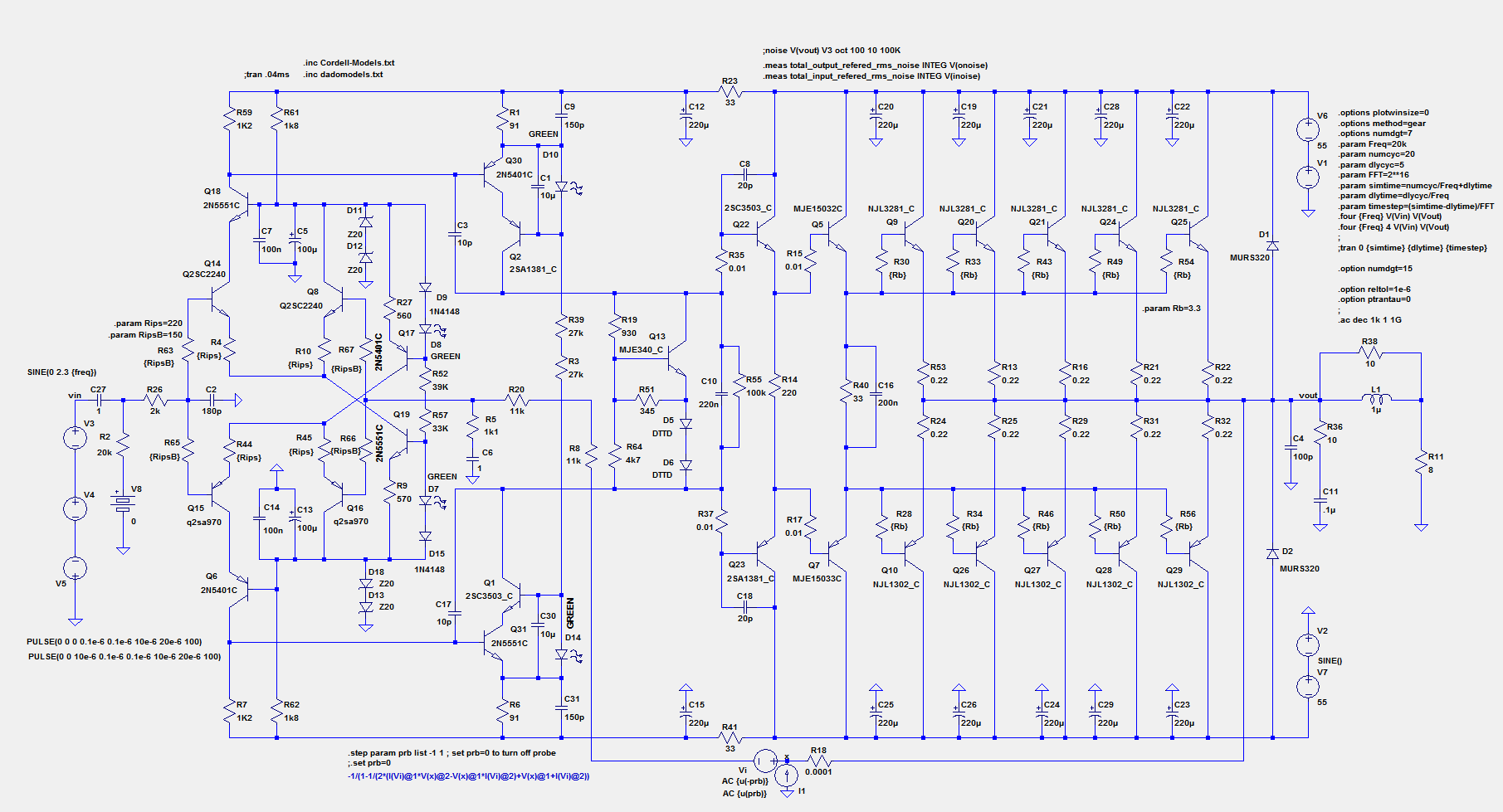

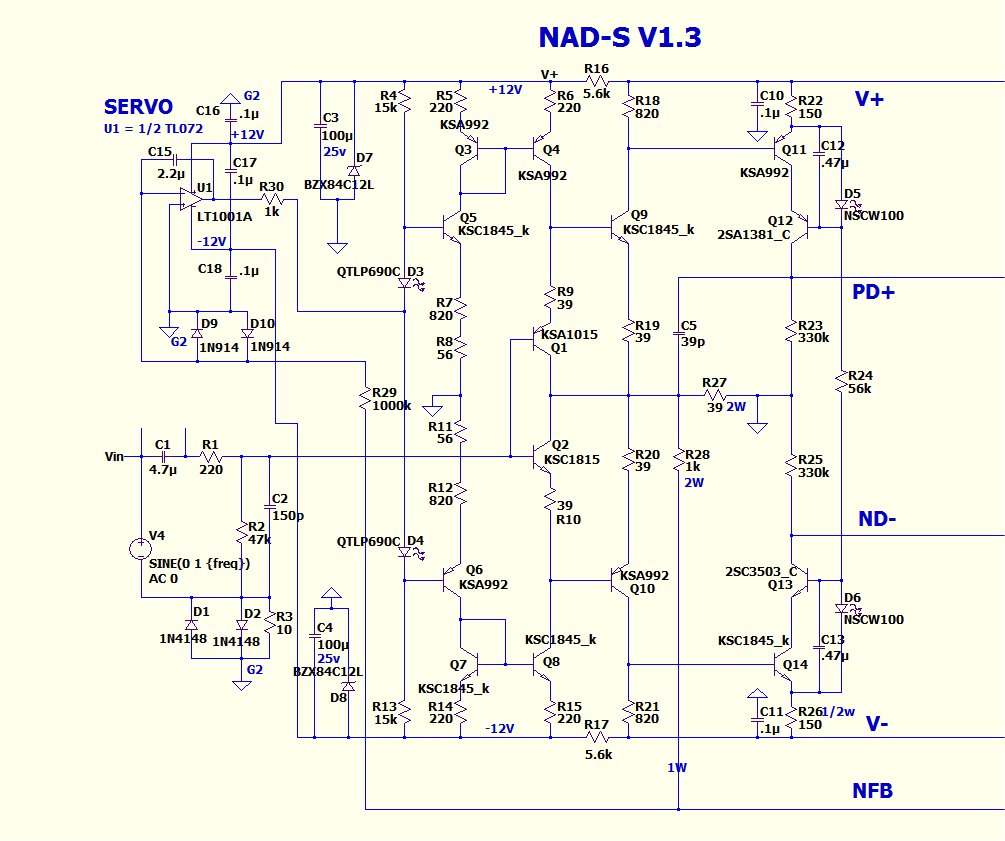

NAD-S v1.3
Member Dadod's input pair works. 🙂
FULL current FB for both stages (inv. and non-inv.).
I added my servo'ed CCS/CM , kept the 1 cap compensation , and
the 12V low voltage supply.
Single digit PPM is now normal for this design - matches the "spooky". 😎
It should fit the same layout as the V1.2 with minimal changes.
PS - the V1.2's servo arrangement is also very good , as the diamond's input is
very sensitive to the smallest offset. It only needs to offset a few mV's ...
The 1.3 bypasses ANY DC feedback into the signal path by adjusting the
CCS/CM circuit(s). The CM's also increase PSRR.
OS

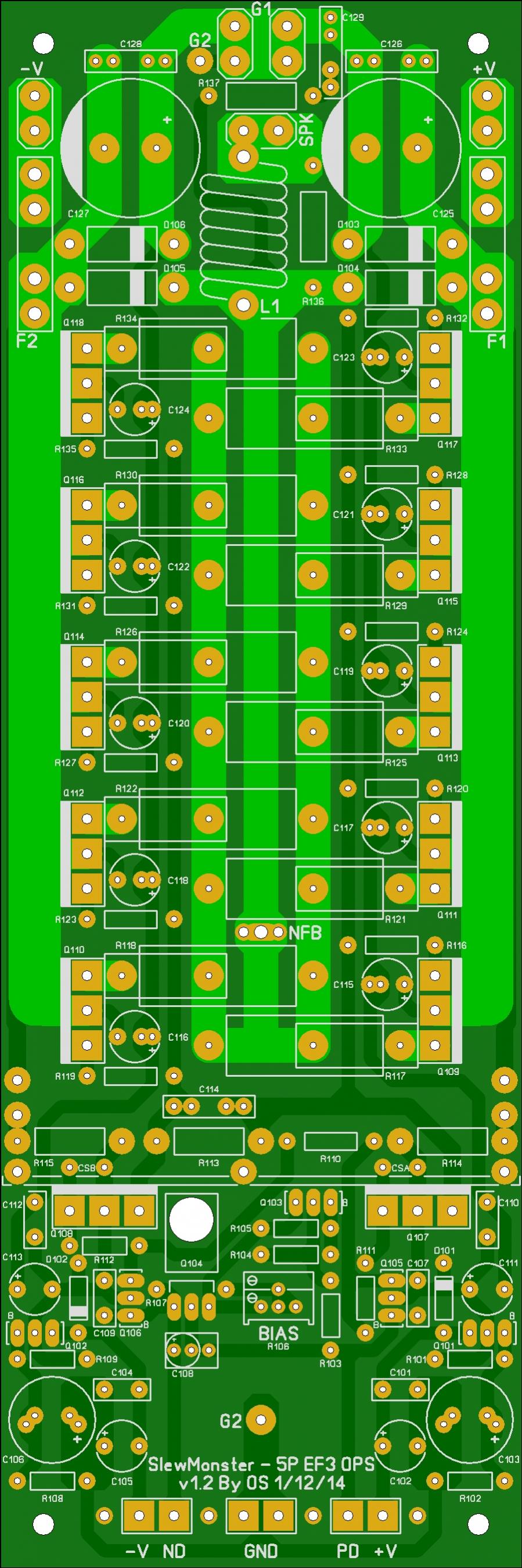

- Slewmaster - CFA vs. VFA "Rumble"
