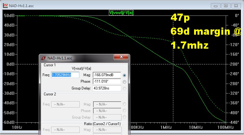

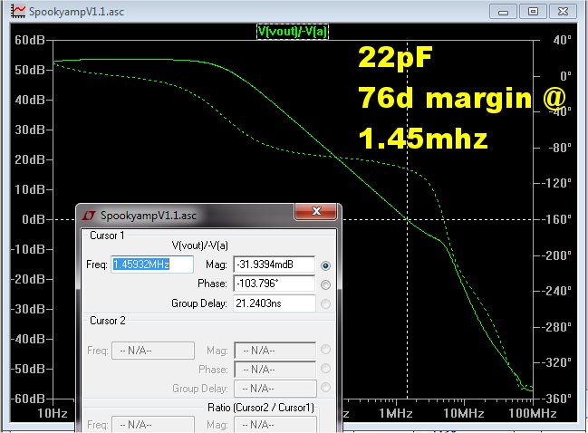

ostripper what are the gain and phase margins of spookyamp and nad-h amplifiers in ltspice??
They are both close to
-1.5+mhz UG
-70-80+ degree PM
-52-53 db CLG - 1hz- 10k+
Very similar , slightly over- compensated.
They are a good match VFA --- >CFA.
You would need to reduce Cdom in each to 1/2 value to
get ringing.
Below , you can see many similarities. Both are new designs (to me) ..
I have not had much experience with them.
OS

As the NAD simulates nearly exactly -SW/slew/CLG/THD ....
I would say it also has (none).
PS - I spent the most time on these 2 symmetric topologies ...
I already have built many (blameless/symasym types).

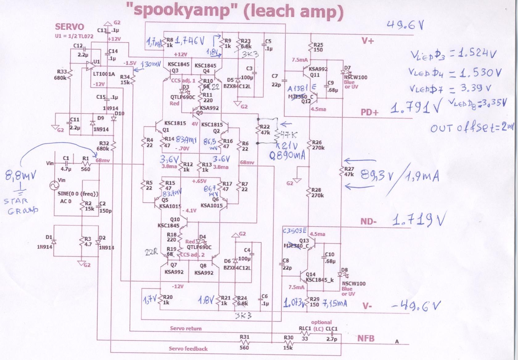

I forgot to mention that I changed the resistor value R27 FROM 47K TO 22K. for +/-44V .
Is this in the right way?
You forced more juice through the LED's.
(both LED strings could benefit at your low rails with a lower R)...
The way to know you are "there" is to see where
the optimum bias is on the OPS.
4.5-5ma VAS puts you right in the middle... 225-235R (500R).
So i must trim these resistors(post#1274) and then trim R 27?
The post resistors get you close ... if you are close ... let it
be.
If you need more VAS I reduction/increase , R27 can go from
22-56K , depending on rail V's and VAS dissipation.
PS - best distortion profile is with 1/3 I through the LED's , 2/3 to the Cascode's.
OS
Thanks a lot my friend.🙂The post resistors get you close ... if you are close ... let it
be.
OS
Best regards.
Thimios.

Suppose the first singing Spooky...
A little more VAS current ,Pete is this a problem?
Pay attention please i have a mistake AT SHEMATIC on post #1267
The right is:
V R20=1.43V
V R29=0.78V (VAS undercurrent), not the opposite!
Sorry for this.
Thimios.
This time with +/-50V.
So new trim resistors(R10,R19 FROM 68R TO 22R & R22 FROM 47K TO 23K) FOR +/-50V are here.
Please Pete look at this.🙂
Thimios.
Thimios.
Thimios.
That looks good... 1.7mA from the LTP cascodes producing 7.15mA at the
VAS re's.
Real close to spec.
The real way to see is to observe where your final OPS bias point ends
up.
OS
VAS re's.
Real close to spec.
up.
OS
Thanks OS ,but i can't understand this"The real way to see is to observe where your final OPS bias point ends up"
Can you explain more?
Sorry my bad English
I see that if amp. is on hard clipping U.V leds comes dimmed (if that helps).
Regards.
Thimios
Regards.
Thimios
At 4.5 -5ma VAS , the Vbe circuit's trimmer should be 180-225R for
60ma OPS current.
I you have to much or too little current , you might "run out of trimmer".
This can be changed ,however. The resistor in series with the trimmer
can be changed for a different VAS current.
This is normal (dim UV/BLUE) - the hawksford is saturating and
"stealing" the LED's current .... 😀
PS - you could even use this side effect as a protection trigger node!!
OS
Thanks againAt 4.5 -5ma VAS , the Vbe circuit's trimmer should be 180-225R for
60ma OPS current.
OS
I have used 1K multi.trimmer and ,as i see, it is posible to trim bias very well as recommended.
Protection via optocupler // U.V led? Good idea!
Thimios.
