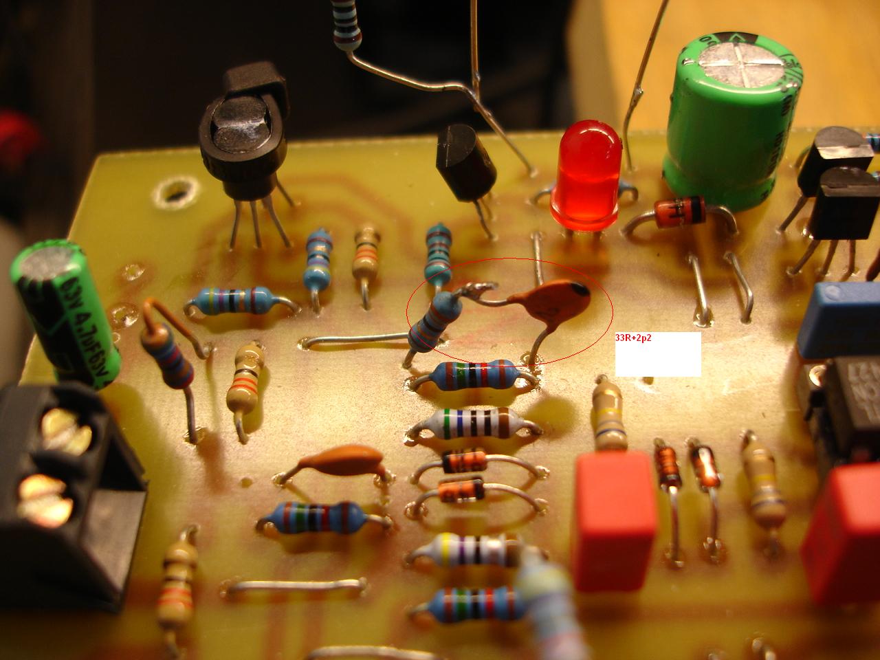

I can say that most commercial amplifiers uses these ceramic capacitors for all stages.Don't generalize ceramic caps, some are very good for audio, as NP0 or C0G.
Damir
Thimios.
Good , as long as they aren't ceramic. Ones like that would even be better
for Cdom1/2 (instead of ceramic).

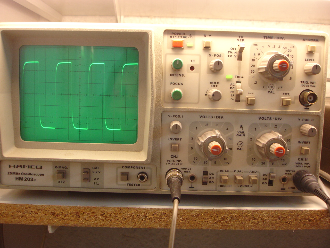

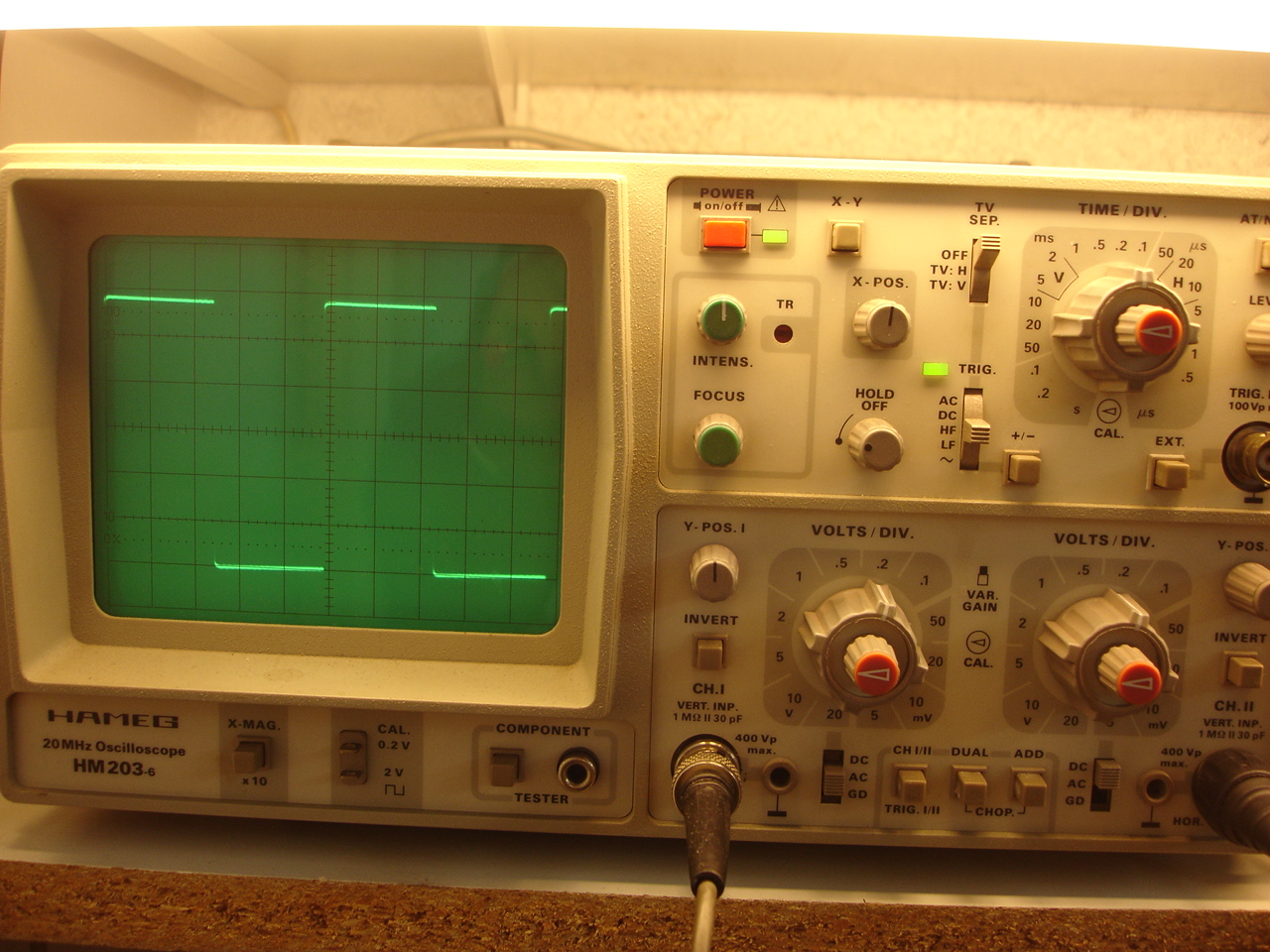

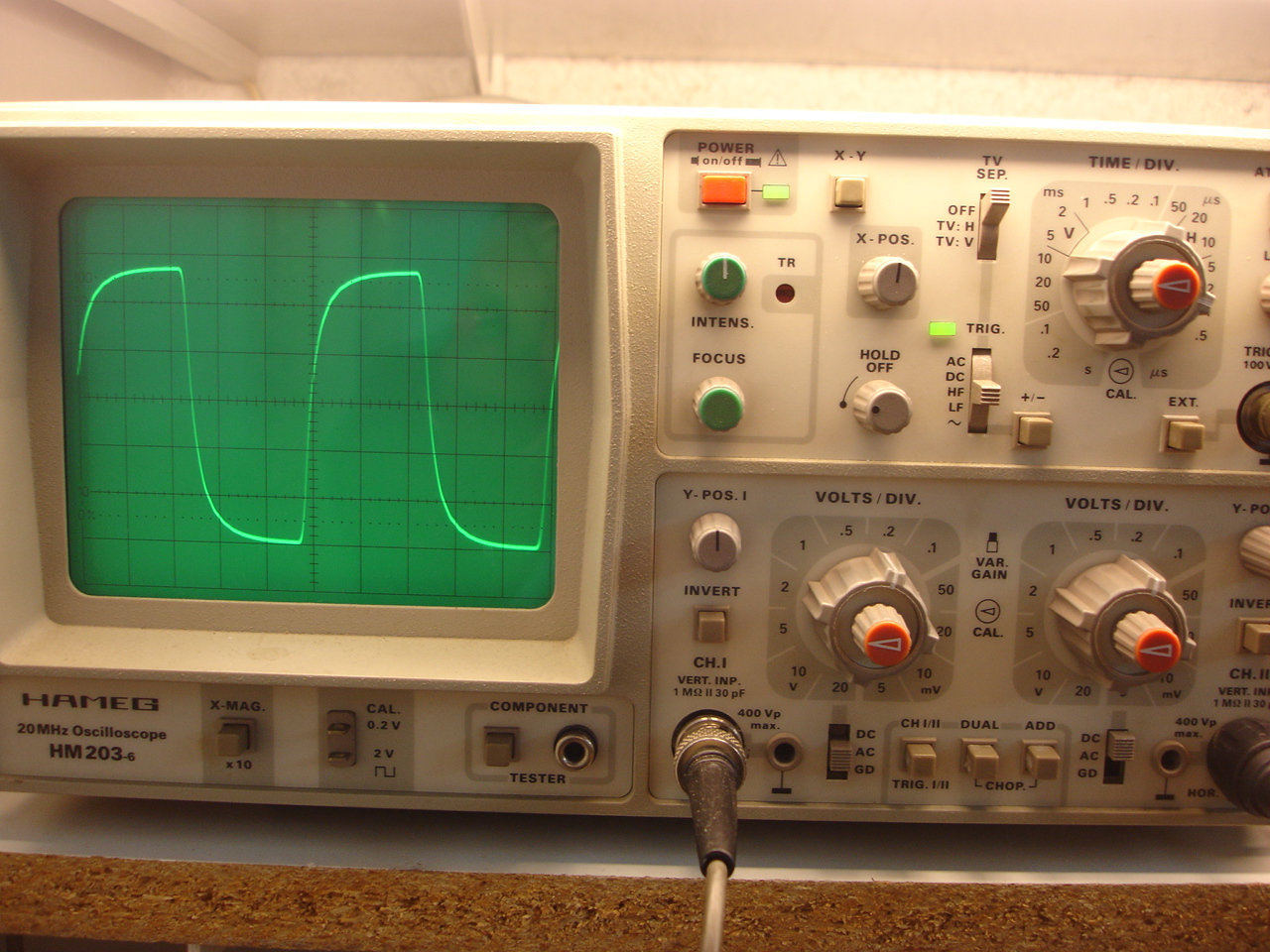

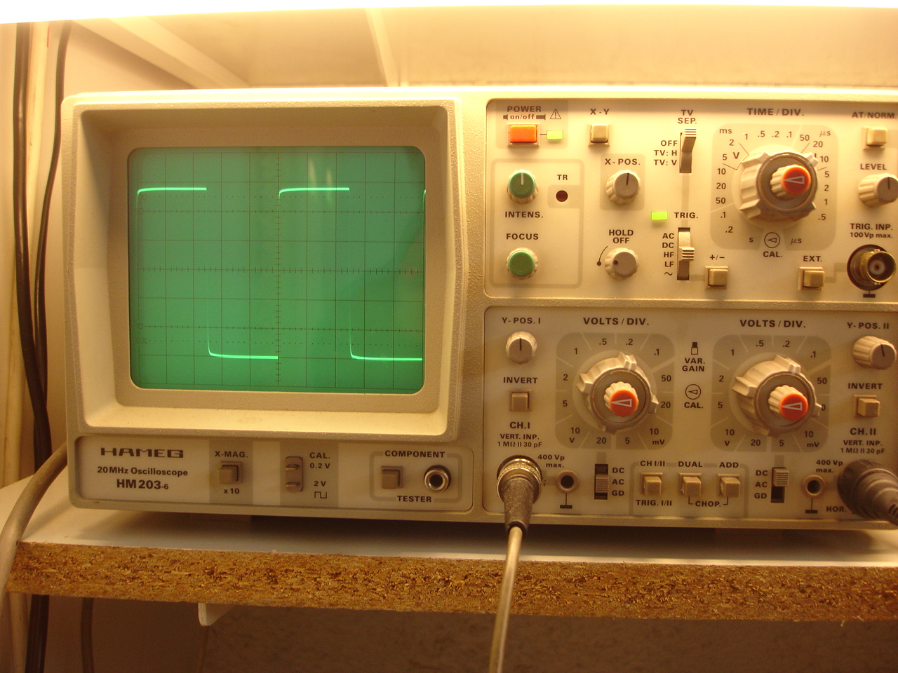

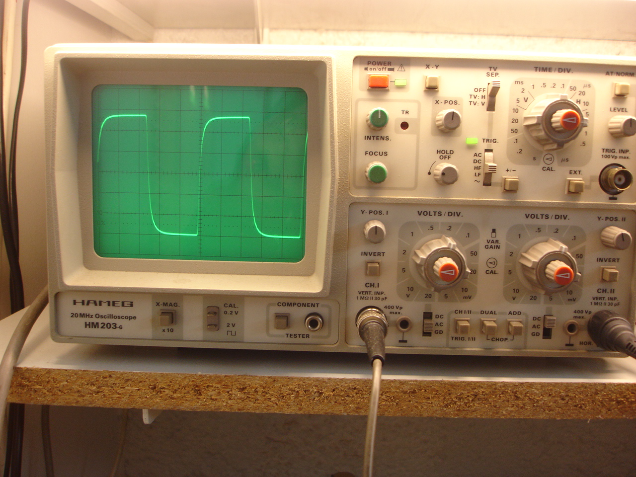

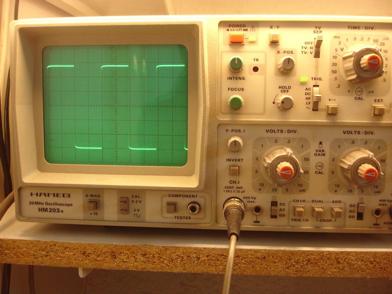

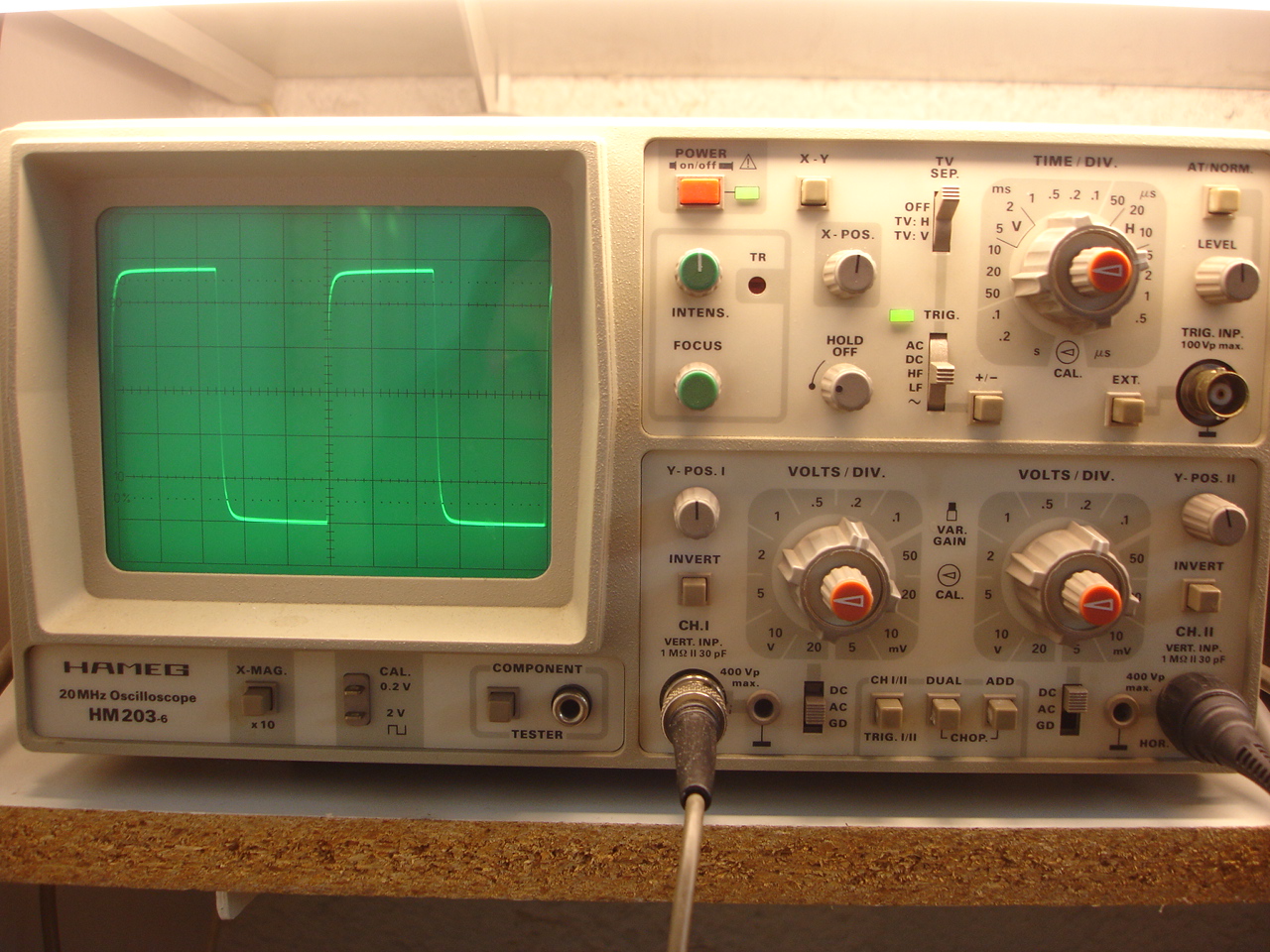

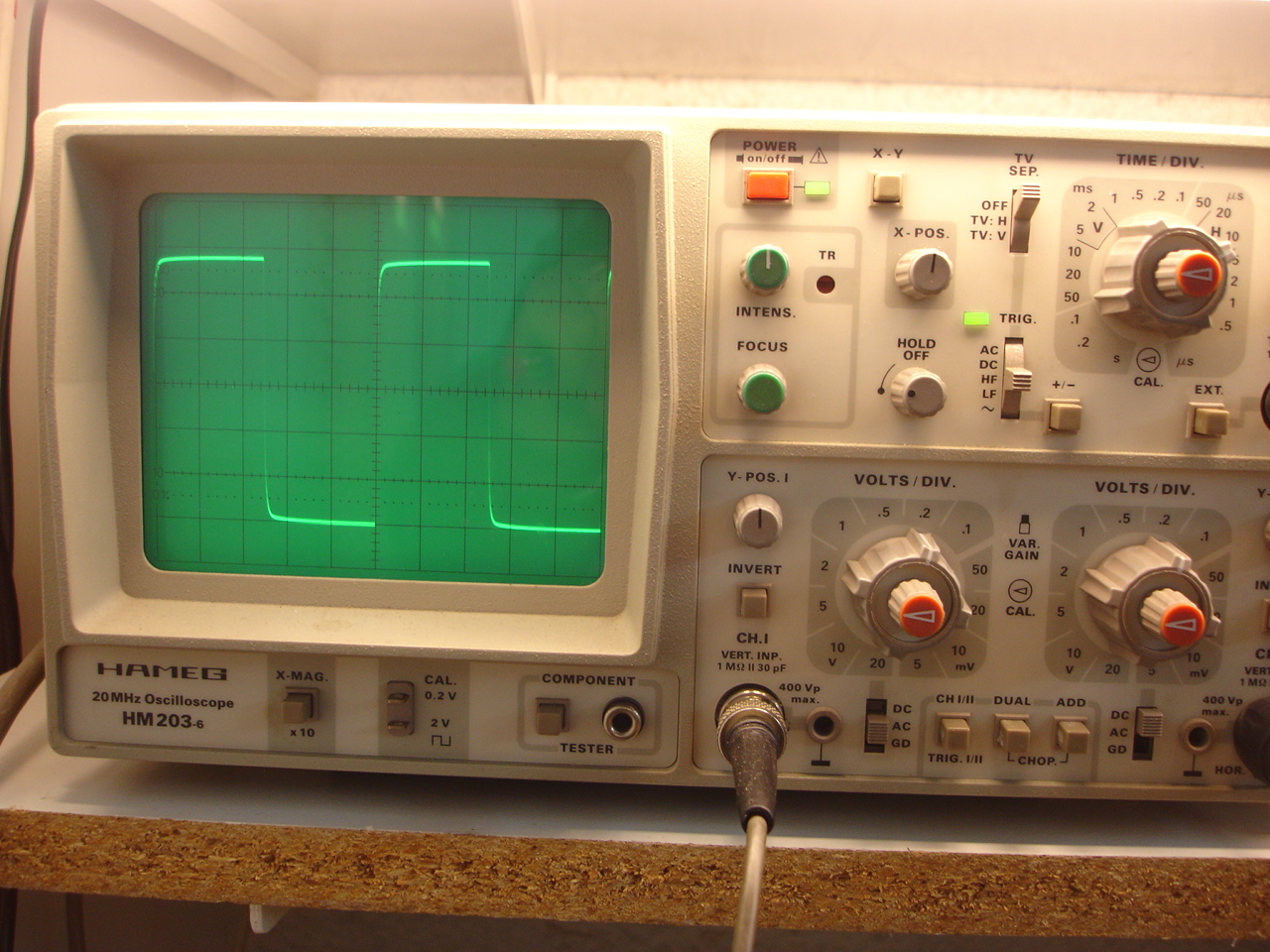

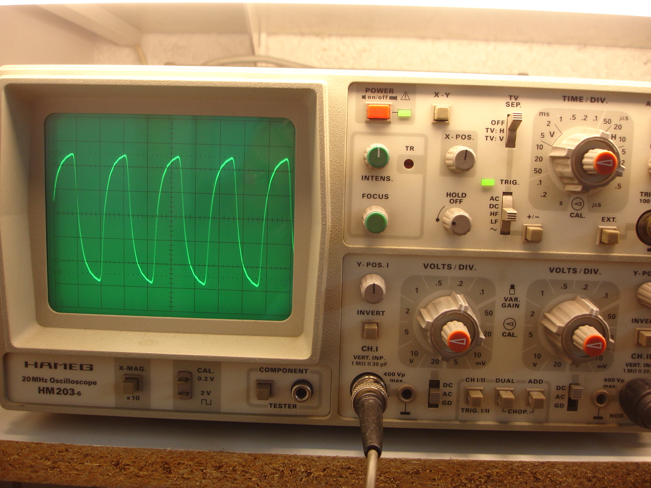

Today NAD, Spooky tested with 3.3uH and 5.6uH shorted inp.OS or Thimios, can you short the amp input with a 5uH inductor to see if it oscillates? Also try higher and low inductor values if possible.
I didn't see any oscillation.
Spooky also tested with small inp signals.(80mV RMS)
1)1KHz
2)3.2KHz
3)5KHz
4)10KHz
5)20KHz
6)30KHz
7)40KHz
8)70KHz
9)100KHz
10)200KHz
11)450KHz
450 KHz and the recommended R.C unfortunately with ceramic cheap
to Thimnios,
When driving the amp to clipping and when the amp comes out of clipping,there are not any signs of instabillity ok?
also have you tried a low level square wave test on a 8ohm + 1uF (or 2,2uF) dummy load?any stability issues here?
If i remember correctly the ceramic with black cap is NP0 and some say that they are reasonably good for use in CDOM and compensation, even for preamp tone control caps.
The resin dipped multilayer C0G ceramics are hard to physically identify whether they C0G or X7R or other.

No there isn't any instabillity when ampl.clip.to Thimnios,
I haven't try this .

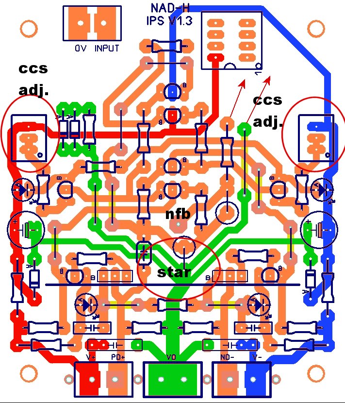

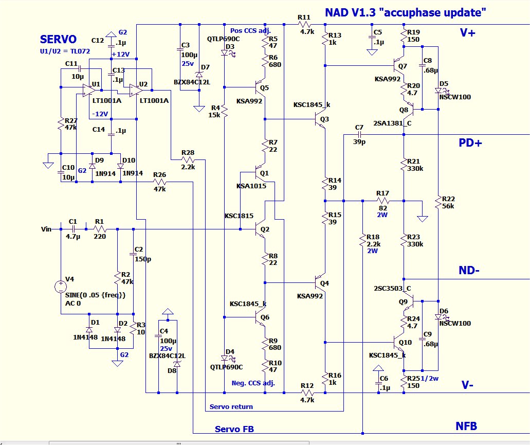

"NEW" NAD CFA ....
Same great design ...
- slightly less current feedback , will allow for more precise servo control.
The Zener dropping resistors had to be changed to 4.7K (60V) to
compensate for the servo's "hunger" (more mA) 😀 .
- non-inverting servo feedback to the current node. It is like the
accuphase 210e OEM amp. They used 2.2k for FB , this will only
allow 5V MAX offset in case of a servo failure (safety first) 🙂 .
-trimmers for CCS's , no more swapping resistors !
-better star ground
-"magic resistors" for the hawksford .... Memory Distortion Philosophies - Part 5 : Circuits, continued
with these-you can calculate the actual cascode current , as well.
-"pretty" symmetrical layout.
By adjusting the trimmers , you can "lighten the load" on the servo ....
since the diamond gender mismatch is the source of the offset.
Might have it done tonight ...
OS

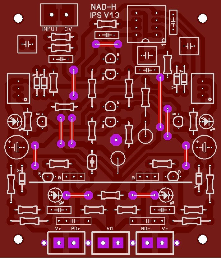

Used every square CM ... whoa !
Pullin' hair 😱 .... but it's lay...ed out... 😀

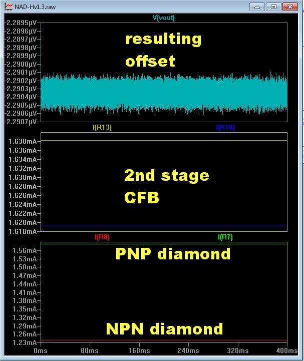

(below) The servo is a 2 stage with .2HZ Fc. Nearly as many parts
as the Leach (spooky).
It should please all.
In order to balance the gender mismatch (PNP/NPN) on the diamond IP
stage , The NPN is running at 1.25ma ... while the PNP is 1.5mA.
Like this, the servo just needs 100uA to correct offset. With all set equal ,
the servo needs 1mA+ to do the job (works harder).
If you closely matched the P/N on a curve tracer - no issue.
Anybody designing a CFA without a servo and dual adjustable current sources
is making a "toy" of an amp.
DO NOT worry , if you are deaf and dumb .... and put any junkbox "partz"
in the input stage , the buffered low Z servo will "clean up" after you.
(below 2) is when you trim the CCS's ...
you still get uV offset... no signal - worst I got was 6mV at LF - 1.8mV typical. 🙂
PS - this exact setup does 15-20ppm ... best combo of servo/FB/component
choices - more tolerant of model "swaps" , as well. Still 10 active devices.
OS
