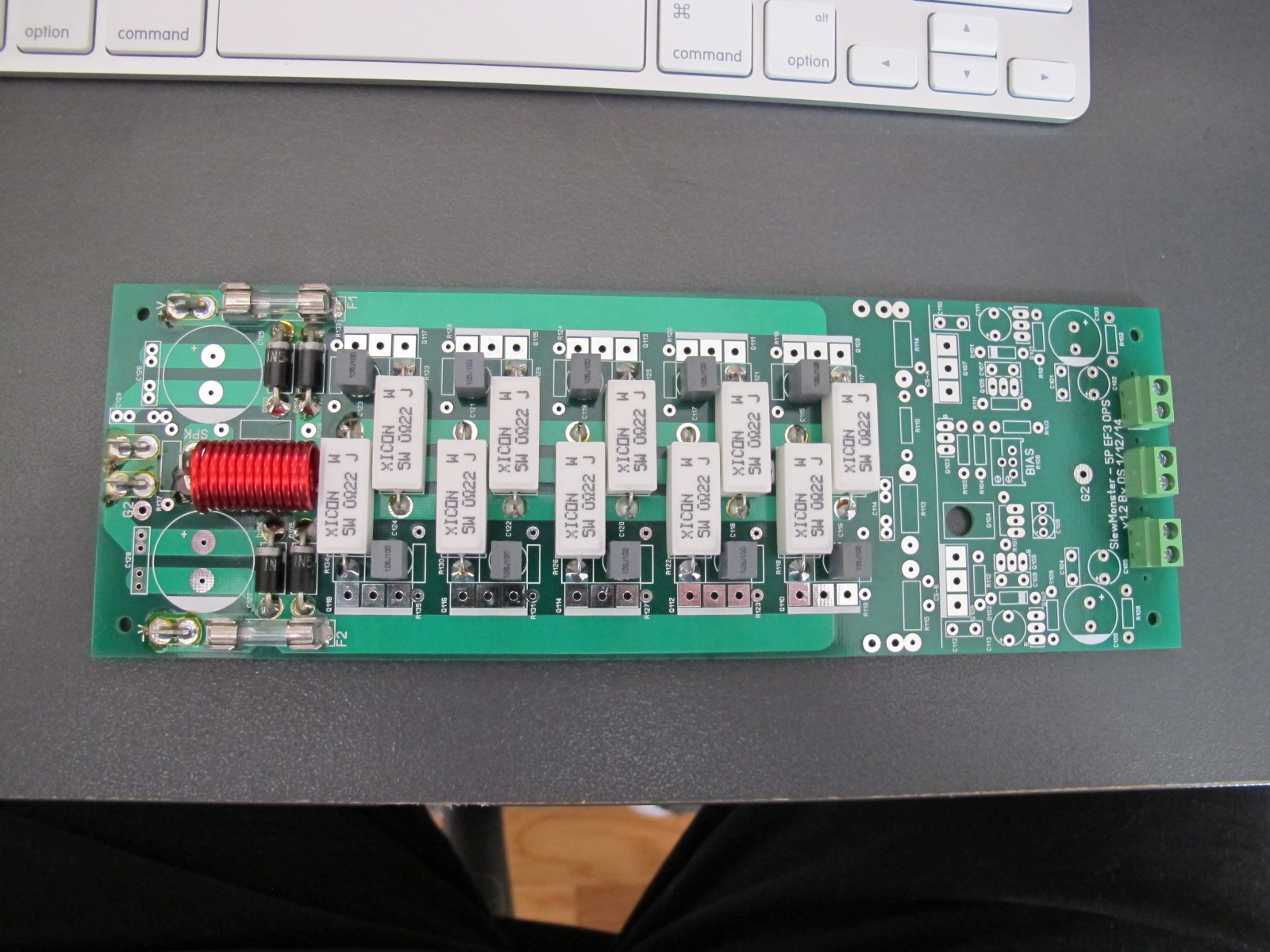

This version is before you added the multi-pattern holes for the various capacitors and the move of the mounting holes for the heat sink plate? Are there really any major differences between this board and the final version beside the tiny improvements that OS suggested?
No functional difference, just missing some multi-pitch holes and there actually are no added holes for the small driver heat sink. I think that the drivers are stout enough to hold the small piece of sheet aluminum just fine.

The output decoupling is only the 5mm LS, no 3.5mm LS there and for the 470µF caps in the CM supply they are also 5mm LS, no 7.5mm LS. Also, I verified that there are no added holes for the driver heat sink, those came too late and I already submitted my files.
The first of the SlewMonster boards. I pulled the trigger a little too soon, so though close to the final art these are a slightly earlier version.

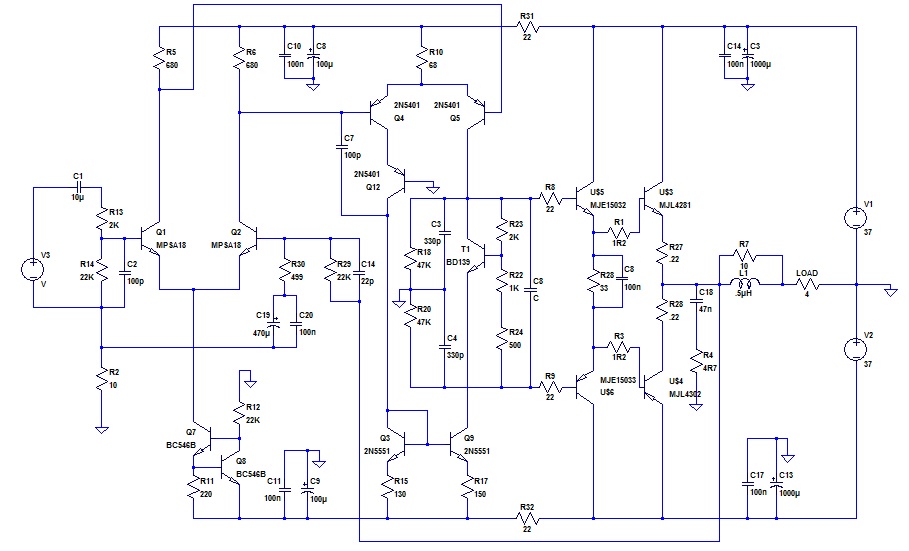

I have a question. If I wanted to try using my Symasym boards as the front end. Where would I attach them to the Slewmonster boards? I am attaching a schematic.
Thanks, Terry

These were a reasonable price considering the supplier's speed. I don't want to derail OS's thread with board sales / distribution, so any interest needs to be expressed via a PM an NOT here. As to your question Terry, I'll answer it privately.

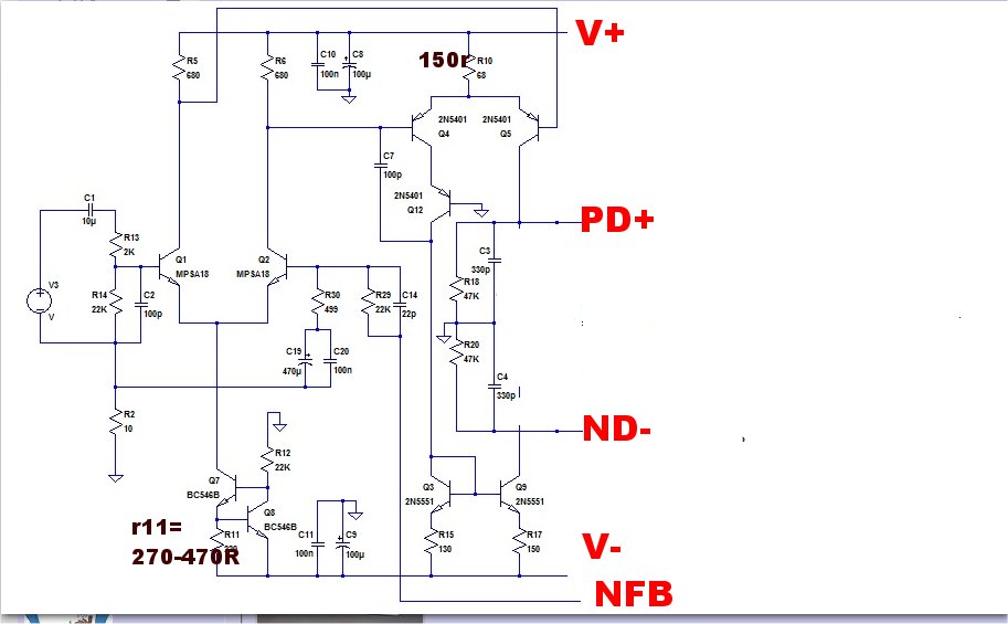

As for the Sysasym as a front end, looks to me like +V would connect to the left of R31, -V to the left of R32, PD to the collector of Q5, ND to the collector of Q6(? image is lowish resolution), NFB to the bottom of R29 / C14, and GND to the ground on the Sysasym board.
Edit the edit: Ah, I see OS has added an diagram for you, even better.

look below , the classic SYM with just the IPS critical components.
Note the Re change at VAS and the CCS modification.
Just make sure VAS collectors are passing 4-5ma , OPS will love it !!
PS - you could add 2 1k resistors to VAS collectors - feed back to nfb , run
IPS independently. Then calculate the I from the resistors. The sym ... as I remember,
might already run at 5ma VAS .... but this (the slew), is a higher voltage amp !!

As for the Sysasym as a front end, looks to me like +V would connect to the left of R31, -V to the left of R32, PD to the collector of Q5, ND to the collector of Q6(? image is lowish resolution), and GND to the ground on the Sysasym board.

Thanks. I realized I should have asked about the boards in a PM after the edit time limit. I had though it would attach at Q5 and Q6 but I noticed that on the Symasui it looks like OS kept R18 and R20, (R17 & R18 on Symasui). I only ask because I have some empty SymaSym boards that may get me started while I figure out how to get some boards etched for some of OS's front ends.

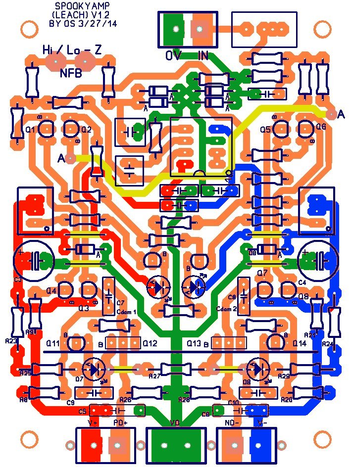

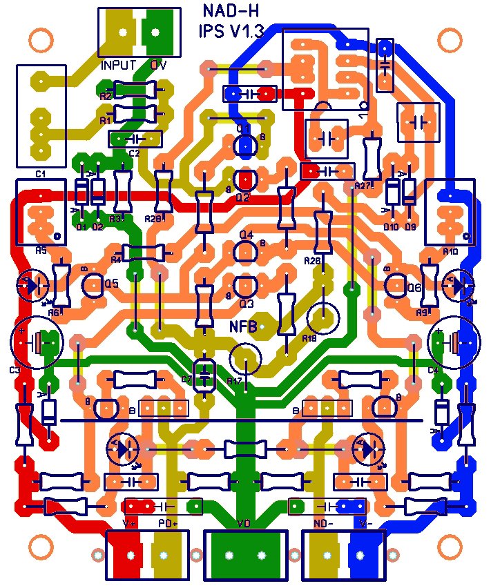

spooky/gonad at the proof stage...
Checking rail/ground traces.
Both are my last posted .asc/schema's (with "embellishments"/features).
The spook was a hairpuller like last time. SO MANY "crossovers" (+ stuff
to the - side) 😡 .
Every CM has traces - dense layout...
Now to do 150 component lables .... 😱
Without these perfect .... the OPS won't "sing" !!

I'm not that fast ... It took me hours to get that second one - (spook).
Got so mad/frustrated that I shut down for a while ... ate
/drank something
I also have the last versions to help with the tough parts.
Everything gets it own ground trace on both boards ...
-regulators
-servo
-main decoupling
-lifted ground
Low/high voltage separated and NFB (curse the NFB 😀 ) separate.
Should be very quiet "lab grade" performance ....
