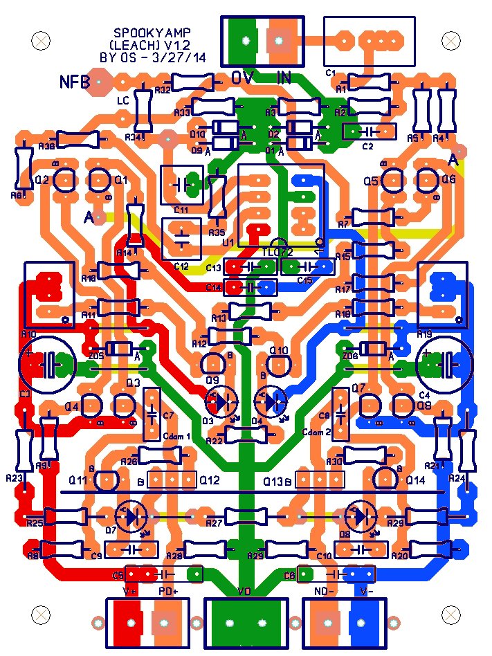

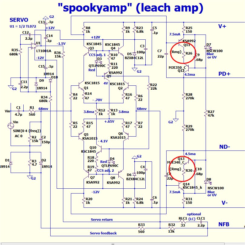

I am so impressed with your layout skills! I've been doing this for a while and I can honestly say that your layouts are some of the best that I've seen.
Thank you !!
I use a combination of "prior art" .. for example - the spook ..
The professors layout , the "leach like" harmon/ kardon , and what I
know of each section of the amp.
-The VAS has to be "alone" on the board ... this leach can do 200V p-p !!
- the cascode/regulator above the VAS is the "change-over" point ,
everything above this is just low current/low voltage (except for NFB ...for this setup).
-On my last spooky ... I have the LTP's pretty far away from the cascodes
and also have long traces to each of their current sources. Now I
have the CCS's in the middle and "crossover" at the center ground trace ..
short paths from ccs to ltp AND short paths from LTP to Cascode.
This may seen "anal" .... but not really - I believe the slew rate and thd
can be positively influenced by short paths and a "sectioned" layout.
I applied the same thinking and style on all the IPS's - I'm sure with
premium parts .... we can match the accuphases and other high
priced premium equipment. 🙄
OS
OS,
Which parts are you talking about being of premium quality, all of the devices or only the active components such as the transistors and output devices? Would you need to match components or is your design such as that is not necessary.
Matching ....
These are symmetrical designs - this mean equal.
Not to the point of curve tracing a pnp/npn pair .... but at least go
through a few pairs on the DMM to get "close" (hfe).
The Gonad is the most "picky" (diamond IP) , I know better matched
{models} will give lower THD and better offset.
The spooky NPN (pair) and PNP (pair) should be loosely matched.
The PNP/NPN (difference ) is not as critical.
In the spooky simulation , you can use a totally different P pair compared
to the N pair ... and still do PPM at 150V. Servo works a little harder.
Both amps will ALWAYS give <3-4mV offset. Those trimmers can also
be helpful on either amp ... if you have a slight mismatch.
NO ebay semi's ... new old stock - just the normal from mouser/digikey
fare will be fine.
Caps should be poly/silver mica. Resistors 2%. Electro's 25V-35V for the IPS's
and a straight 100V for the OPS.
OS

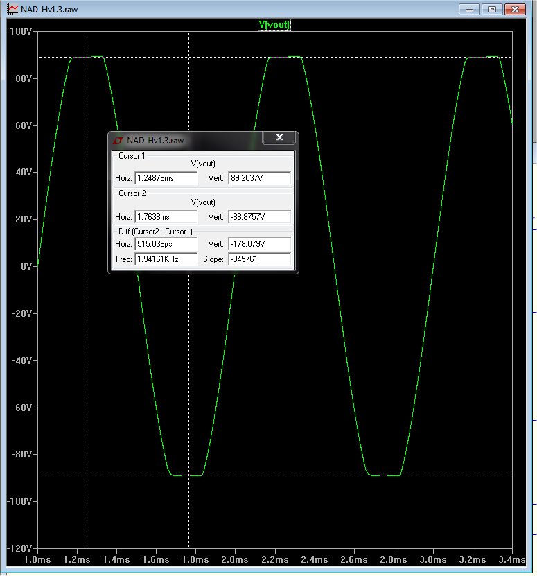

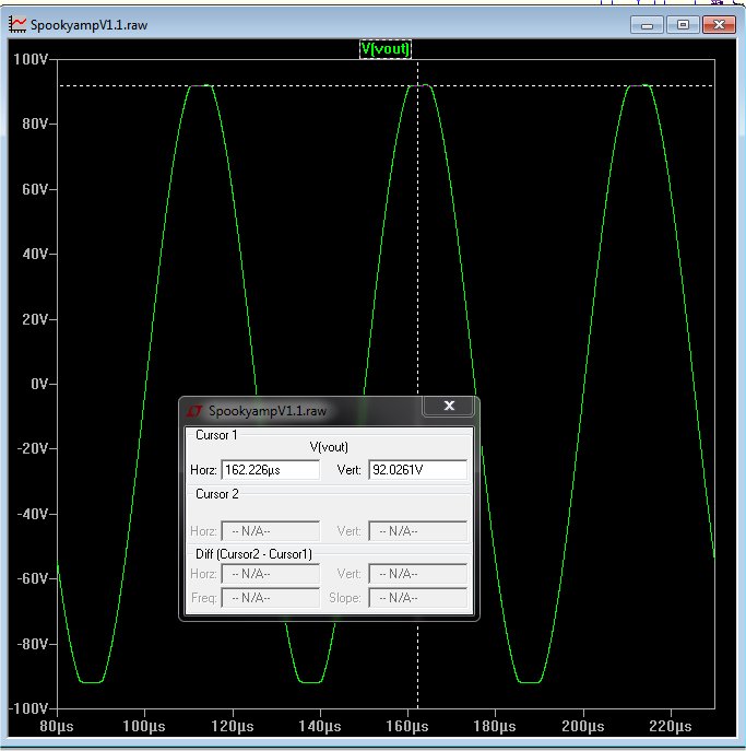

Magic resistors + playin' with the "embellishments".
"Magic resistors" (below 1-circled/ R26 and 30)on the hawksford(s)
(memory distortion).
4.7R - 10R lowers H3/5 slightly and also reduces (nearly eliminates)
saturation at the VAS !!
Both the gonad and spook top out at 45-50ppm *170Vp-p.-
-then clip gracefully (below 2/3) at 184 (spook) and 179 (gonad) p-p/4R ... both on 100V rails.
These 2 IPS's should give JK's OPS's quite a "thrashin" - absolute headroom.
80V rails will clip at 146Vp-p !! 😎
PS - yes Kind ... I will concentrate on these 2 amps (BOM as well).
Edit ... WHILE clipping - servo keeps <6mv - both amps ... these are really "primetime" !
FEEL free .. to hook up your 85-90V per rail PS's to these ... they are made for it.
OS

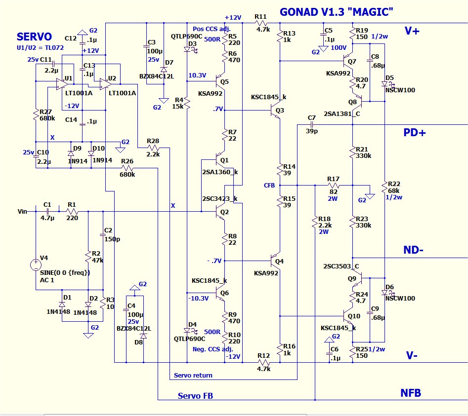

It is ready for the "embarrassment phase" .... show me my errors.
(below 1/2).
Updated the board , the schema , and a BOM.
-"X" will also allow to run the servo inverting (like the 1.2) .... cut the
thin trace above C10 , R27 to "X" , jumper the other X's. Default is
non-inverting fed to current FB.
-labeled "ccs pos/neg adj." , (R5/10)these could be jumpered and omitted ...
(R6/9) - can be a cheap 680R ... if you can't afford 2-2us$ trimmers. 😱
Servo actually makes the trimmers redundant , but you might want to
"tweak" the VAS current with them (or balance a "sloppy" input pair).
-input cap is 3.5mm wima / 5/7.5/or 10mm LS.
-Seen thimios's v1.2 - every spacing and layout consideration has
been "anally" addressed. 😀
Gonad 😎😎 is by far the best "simplicity to performance" amp I've
run across. Only the "spook" can beat it (not by much).
OS

OS,
I like the name Master Slewmaster by OS, better than Gonad, easier on the marketing side!
Are you going to update post #1 to the V1.3 and will this just point to this or another later post #? How does the first post work when you are all done, will it contain the latest files or do you just go to the pointed file #?
