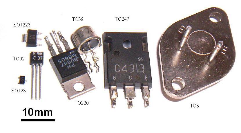

Relative size.
I will stay with D-pac - TO-252 - Wikipedia .
And SOT -223 - Small-outline transistor - Wikipedia
SOT23-3 is alright.
, no-363 ... I might have to go SOT23-6 for those cool matched pairs.
no 2mm parts , I'm older , too.

SOT-26, for but there is a SOT-23-6 as well.
SOT-223 is your mid power device.
D-PAK for more power.
All the popular devices 2n440x,390x, are available in the SOT-26. Even Toshiba makes some parts in the SOT-26.

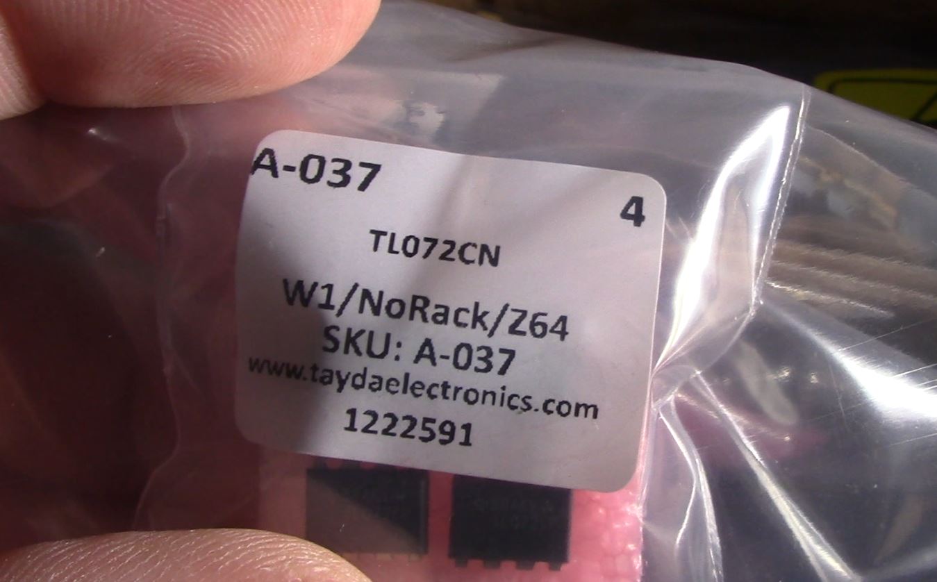

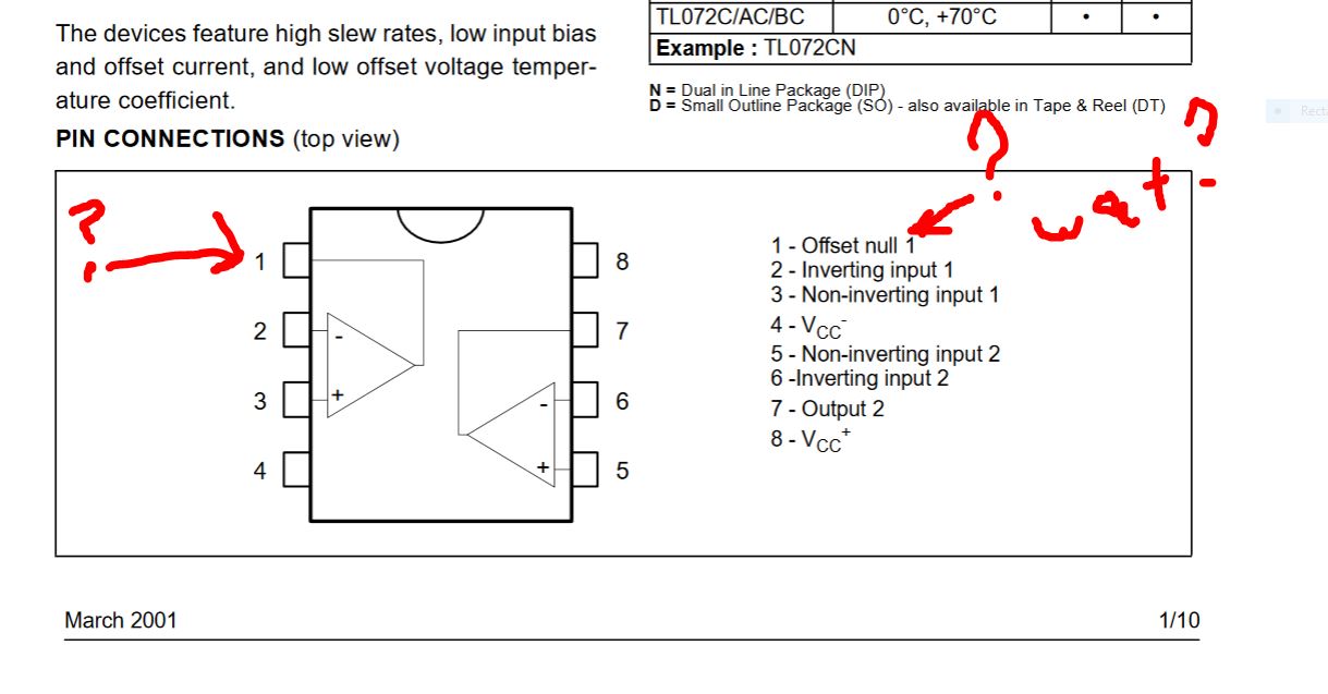

Greenam V1.2 U1 correct part
hello is this U1 TL072CN the correct one it ends in CN? I just wanna be sure maybe is a typo error I'm not sure also I'm confuse cause pin 1 is output why it said Offset Null 1? 😕

It is usually the single op-amps that have the offset null pins.
The datasheet shows the output = pin 1.
Any dual 8 pin dual amp DIP does not have any extra pins for "null".
OS
Looks like an error on the data sheet.
The datasheet that shows the output = pin 1.

ST has "mixed" the pinouts for the single opamp and dual opamp configurations somehow 🙄
Here is a good datasheet from TI showing the possible options correctly:

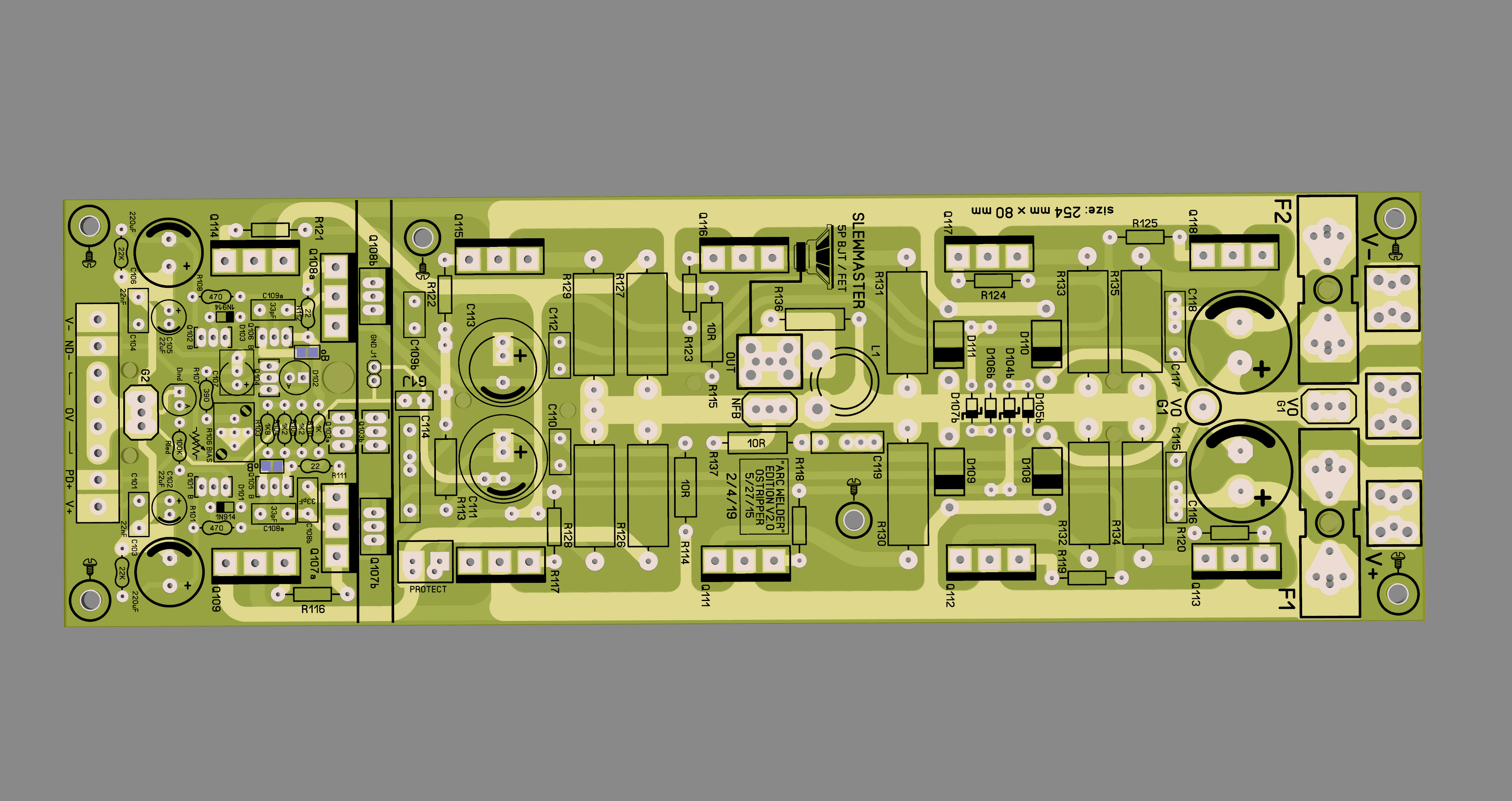

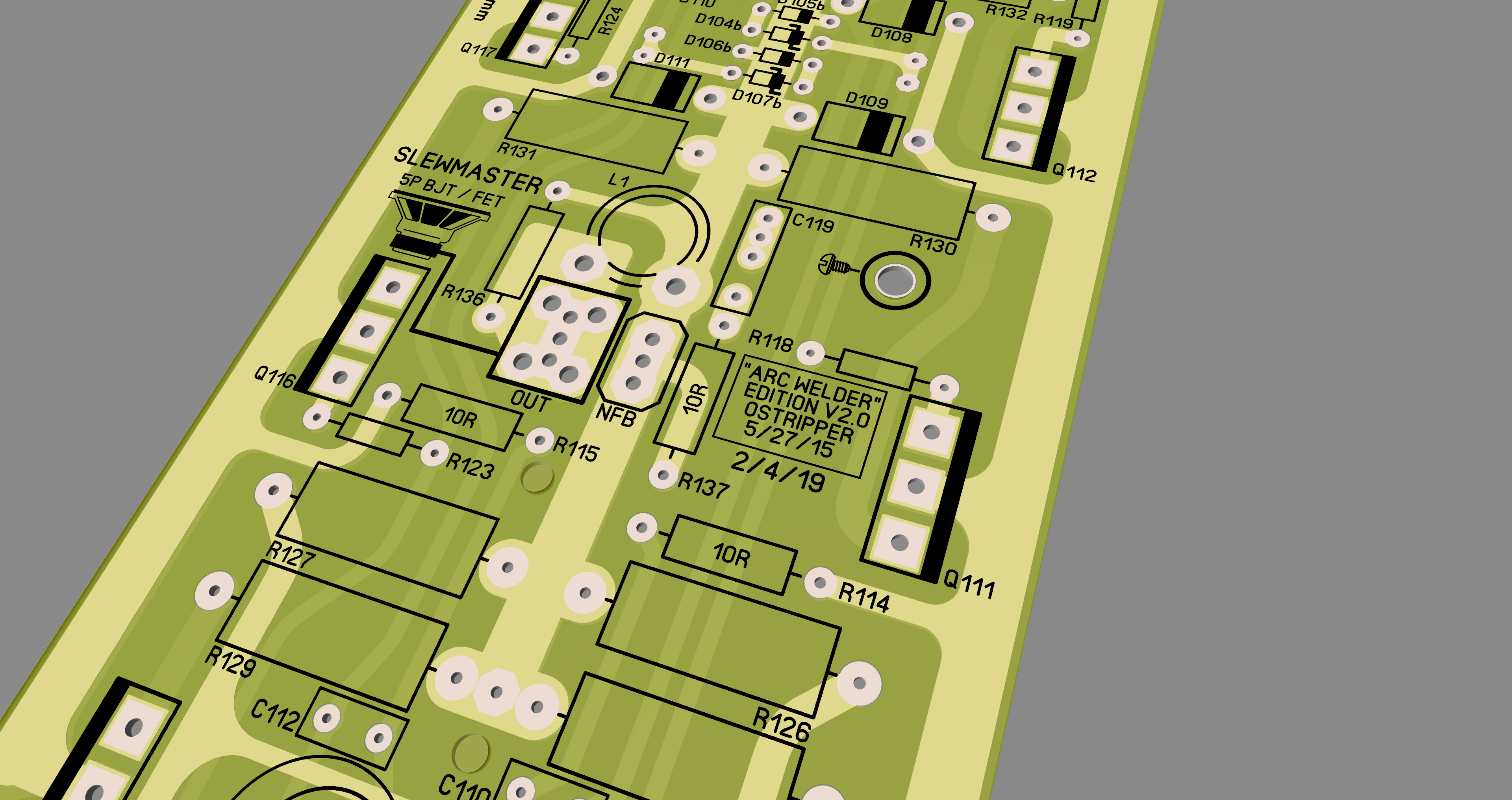

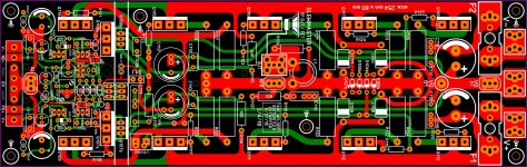

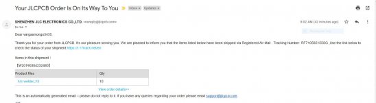

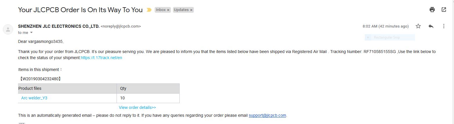

JLCPCB are gonna sponsor my order they did already
hey guys I was lucky that JLCPCB are gonna sponsor me an order that I did of the Arc welder I have the files for a long time and I always wanna to try the new OPS "I mean few year ago" I know that OS is making a new OPS but I be just happy to have this one this is the same one I just tweaked a few weeks ago to my needs I mean fancy style 😀
Vargas

That is NICE !!!hey guys I was lucky that JLCPCB are gonna sponsor me an order that I did of the Arc welder I have the files for a long time and I always wanna to try the new OPS "I mean few year ago" I know that OS is making a new OPS but I be just happy to have this one this is the same one I just tweaked a few weeks ago to my needs I mean fancy style 😀
Vargas
I think it is the best on this forum - by a long shot !
