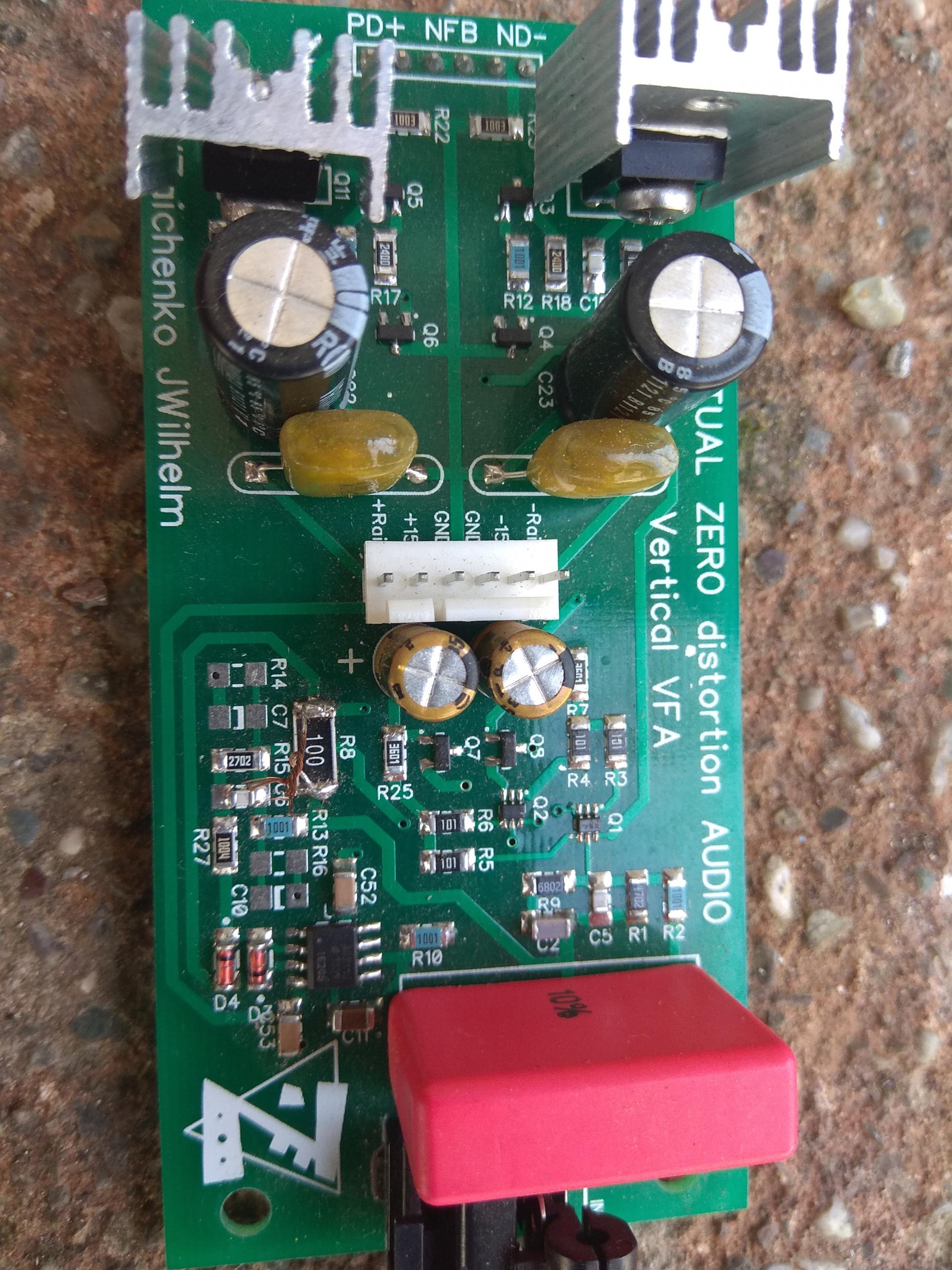

Your PCB looks like it wants to "sing".

thank you I just gonna "yolo" and I order a few PCB last night they are in process right now I will keep inform 🙂

hey Krisfr I only order a few to prototype only sadly I don't have scope or any testing devices to check "thimios is really good with that" I only can use audio signal from my PC to tested after I get the PCB and put it together and tested I will inform if my design was successful or not no matter what happen I'll keep posting oh yeah in my case the total cost was $18.00 USD with shipping Puerto Rico was $11 bucks and $2 dollars PayPal fee included and boards $5 bucks for 5 PCB for proto only I be like yolo! well wish me luck guys 🙂
Note: I don't have any intention to do a group buy just to let you know this is for me to enjoy 80's music especially 😛

Thimios , I see that smd op-amp , does not look too difficult.

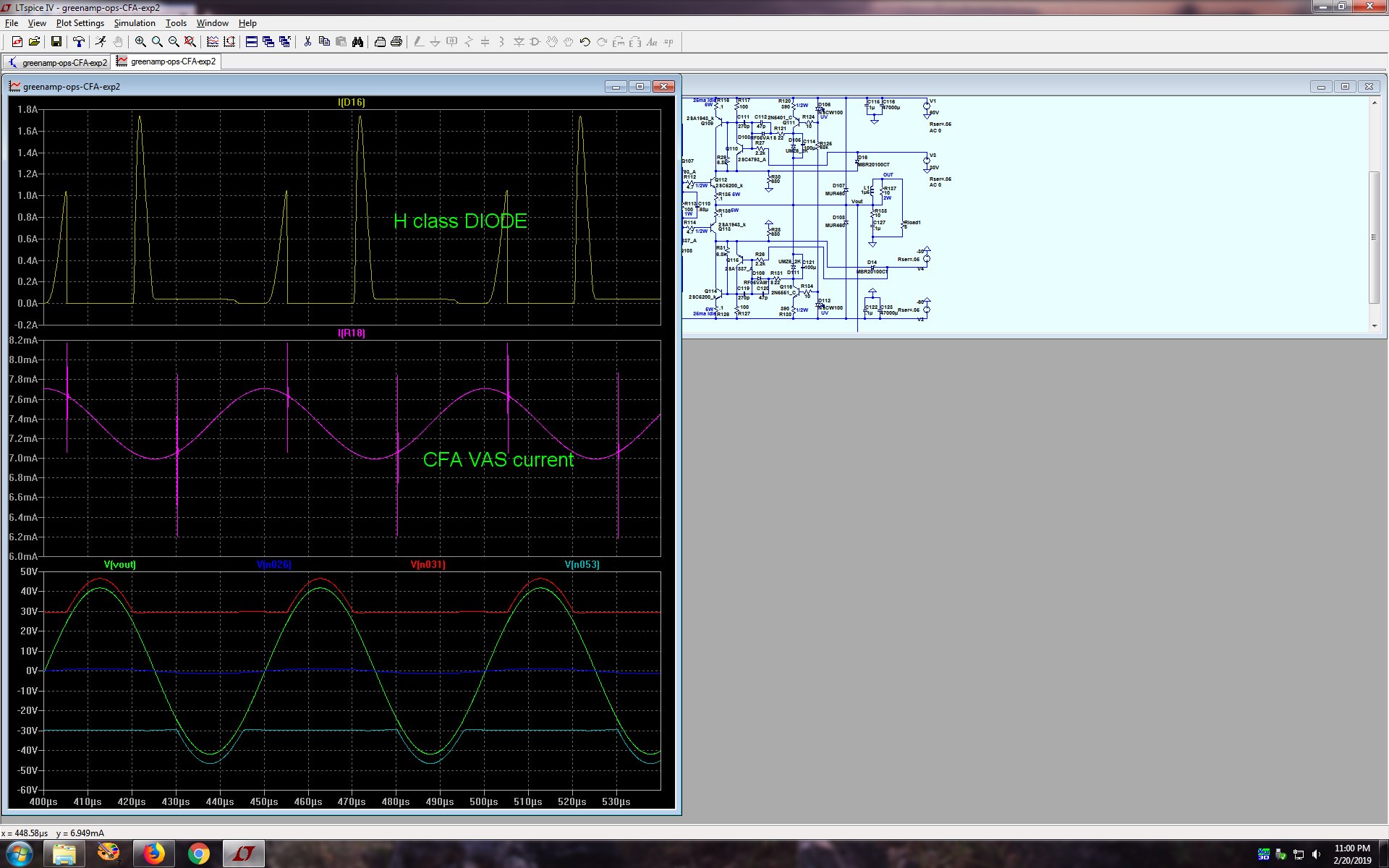

Something to chew on ...
The voodoo of a non-switching output stage is really un - needed.
If you look at the middle VAS current waveform , you see it "glitches"
right as my class H + schottkey diodes switch. It is correcting all that and it still
can output 18ppm/ 4R/ 20khz.
In a triple EF , switching distortion at crossover is 1/10th that. The fast CFA
would easily error correct that without NS.
Another trade-off , add error correction or NS to the output stage and slow it
down or keep things simple and "smokin' fast. Any positive feedback loop you
add to the OPS is a negative.
The greenamp CFP trackers are much faster than the EF3. Before they kick in ,
the core EF3 is "virgin" and running at 30V.
So , up to 30V - you have a small slewmaster EF3.
Many options here , run dual mono 30-0-30V analog PS's for low rails. Get
one big 600W SMPS for both channel high rails. Have a light weight amp that can
put out easy 400w peaks. Or go with 2 SMPS's , my PSRR is way above 100db.

Not at all, the only difficult is here, Q1, Q2

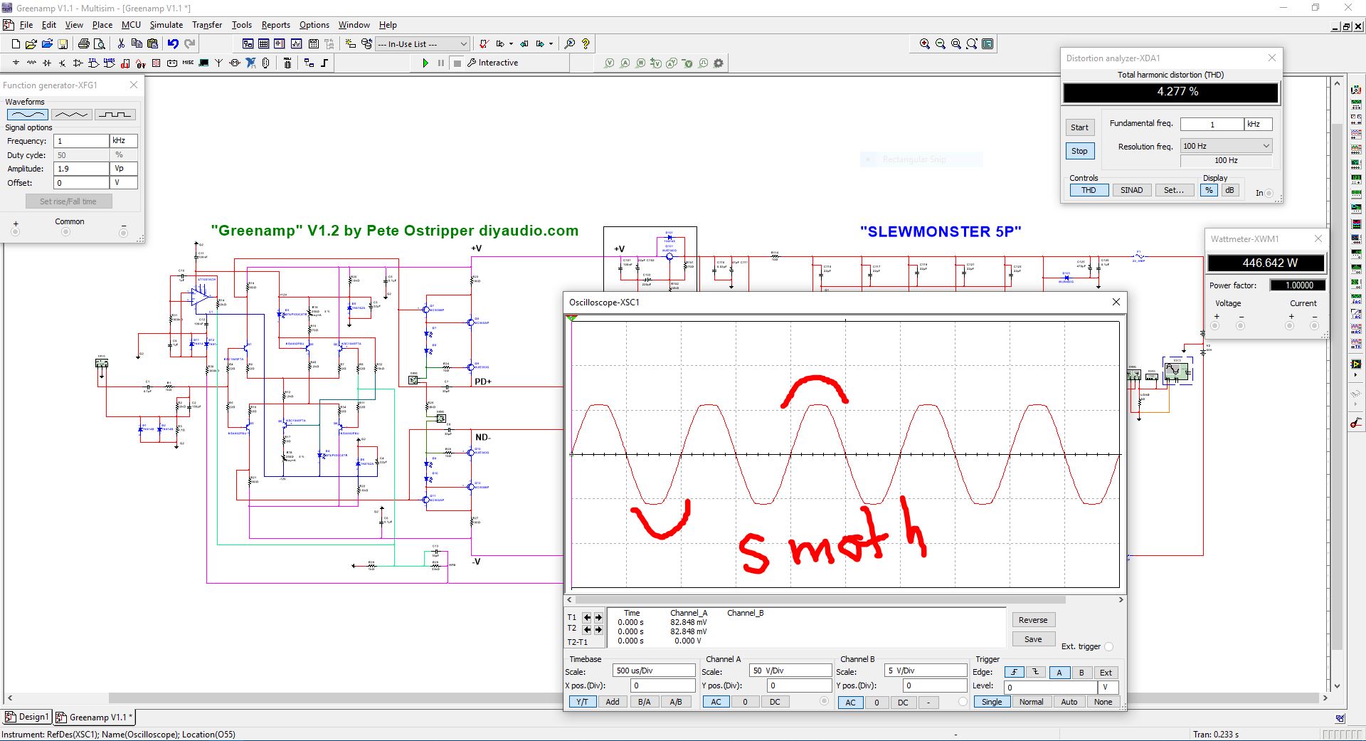

hey OS I think you mention that the IPS GreenampV1.2 is gonna clip "smoothly" yes is in fact correct awesome no harsh clip very nice 🙂 this is after 446 watt with 65V supply rails I misspell smooth on the note image xD

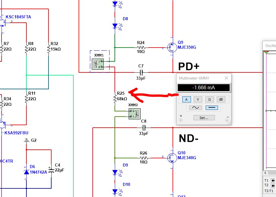

oh other thing I can't really adjust R25 to have a reading of 1.5 mA exactly I got 1.6 mA is that be ok and not need to be critical that value? I was think to increse the value of the trim pot CCS adj 1 and 2 to 1K maybe? let me know when you get a chance

R25 current can be anywhere from 1ma - 3ma. I run mine at 2.5ma. This
is an easy way to lower the main VAS current. Yours runs at 5.5ma , mine at
4.5ma. My LED's are brighter (2.5ma). Change R25 value ... 33k,39k,47k,56k,
68k - to get what you need.
oh ... ok thank OS 🙂

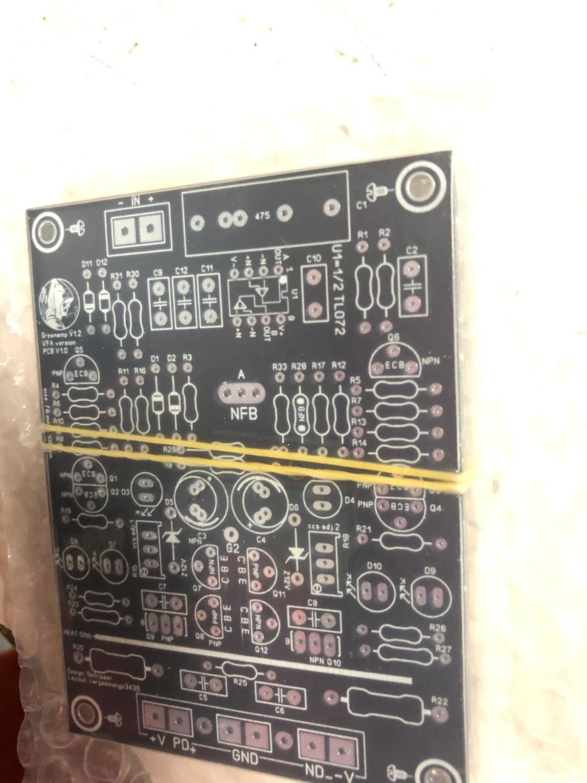

hey guess what? the first photos of the Greenamp V1.2 prototype boards 🙂
Now it's time for test!😉
I hope all goes well that is why I call it "prototype" 🙂 wish me luck I will inform if success or not success on the designNow it's time for test!😉
