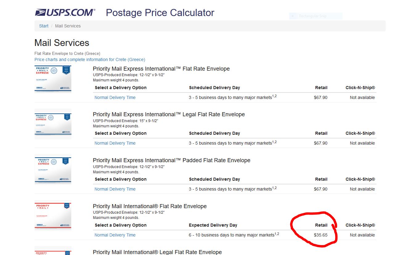

oh man I think is too expensive 😕 don't spend that money on that thimios I wish it was like $5.95 USPS but is not 🙁If you want a second tester just Sent a set to Greece.
What is the cost?
Yes agree, it is too expensive.

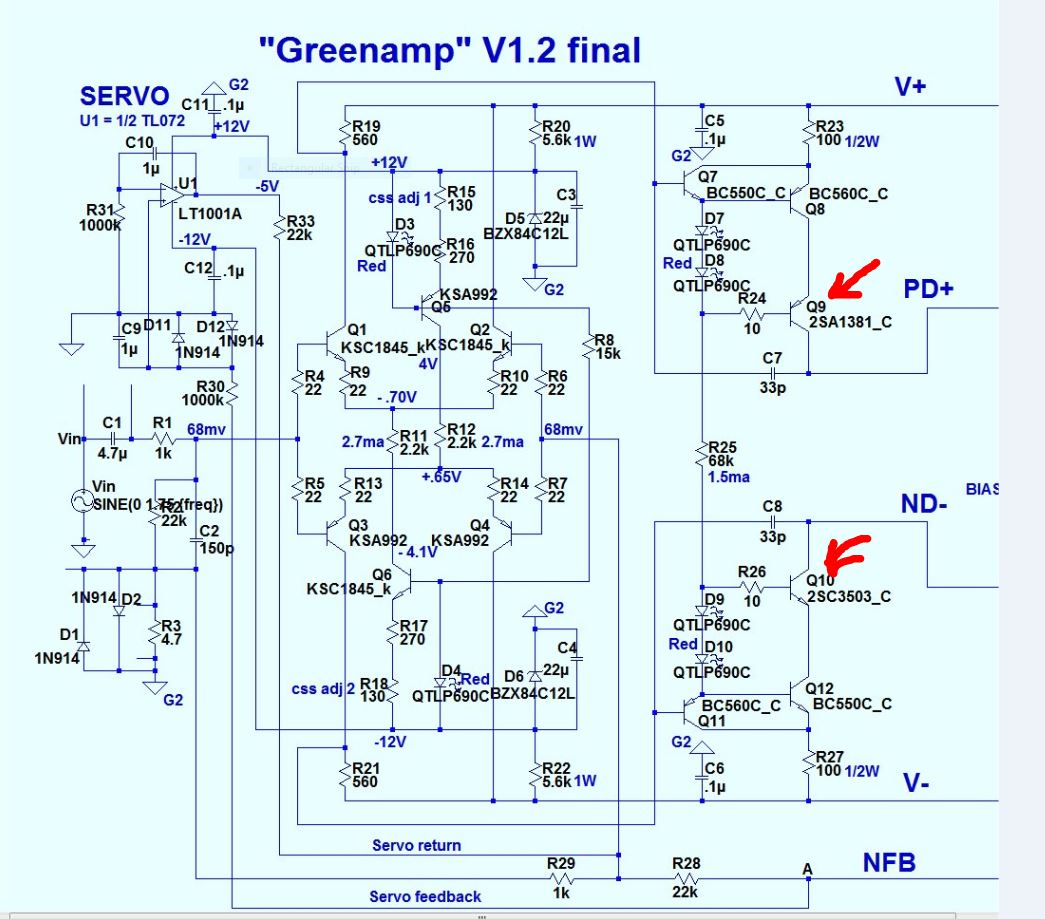

Greenamp V1.2 Q9 and Q10 need similar ones
oh boy, hello guys can some one recomended me an equivalent for Q9 and Q10 I check Mouser and Digikey and they don't have on stock the KSA1381 🙁 I got all resistor on order and caps but I'm stock with Q9
Vargas
Vargas
TTC004B,Q PNP 160V 12pf Cob 120mhz.
TTC004B = NPN 160V
OR , KSA1220A pnp - KSC2690A npn - also these are 160V. Only for 60-65V rails. NO higher. You could run MJE 340/350 , but with reduced performance.

TTC004B = NPN 160V

thanks OS for the info, and yes you are right those devices are fading away sadly 🙁 , SMD yes I think I need to update myself to SMD devices too

Parameter search at Digikey and it gives you KSA1142OSTU :
https://www.digikey.com/products/en...103&quantity=&ColumnSort=0&page=1&pageSize=25
KSA1142 -O = the lower gain group.
Seems its partner , the KSC2682 is obsolete.
Both Mouser and Digikey are out of 300V P - channel fast TO-126's. 😡 MJE340/350 ..... lots of them.
Mouser does have the Toshiba TTC004B/BQ pair.

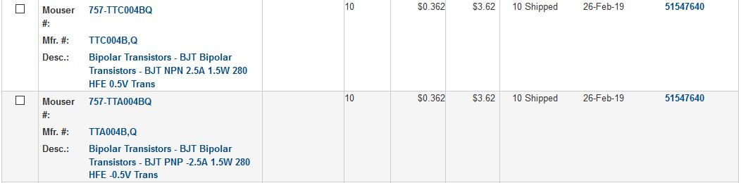

hello OS I was able to order TTC004B and TTA004B and all the rest of the parts just gotta wait for them 🙂Vargas
TTA004 is the PNP
TTC004 is the NPN.
I am sorry , mouser listed both as TTA's I should of looked right at the datasheets. I need a break. They are at a good price , and a new product. At 160V , they would do most of the forum's VAS's.
OS
