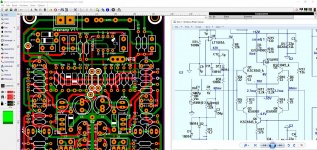

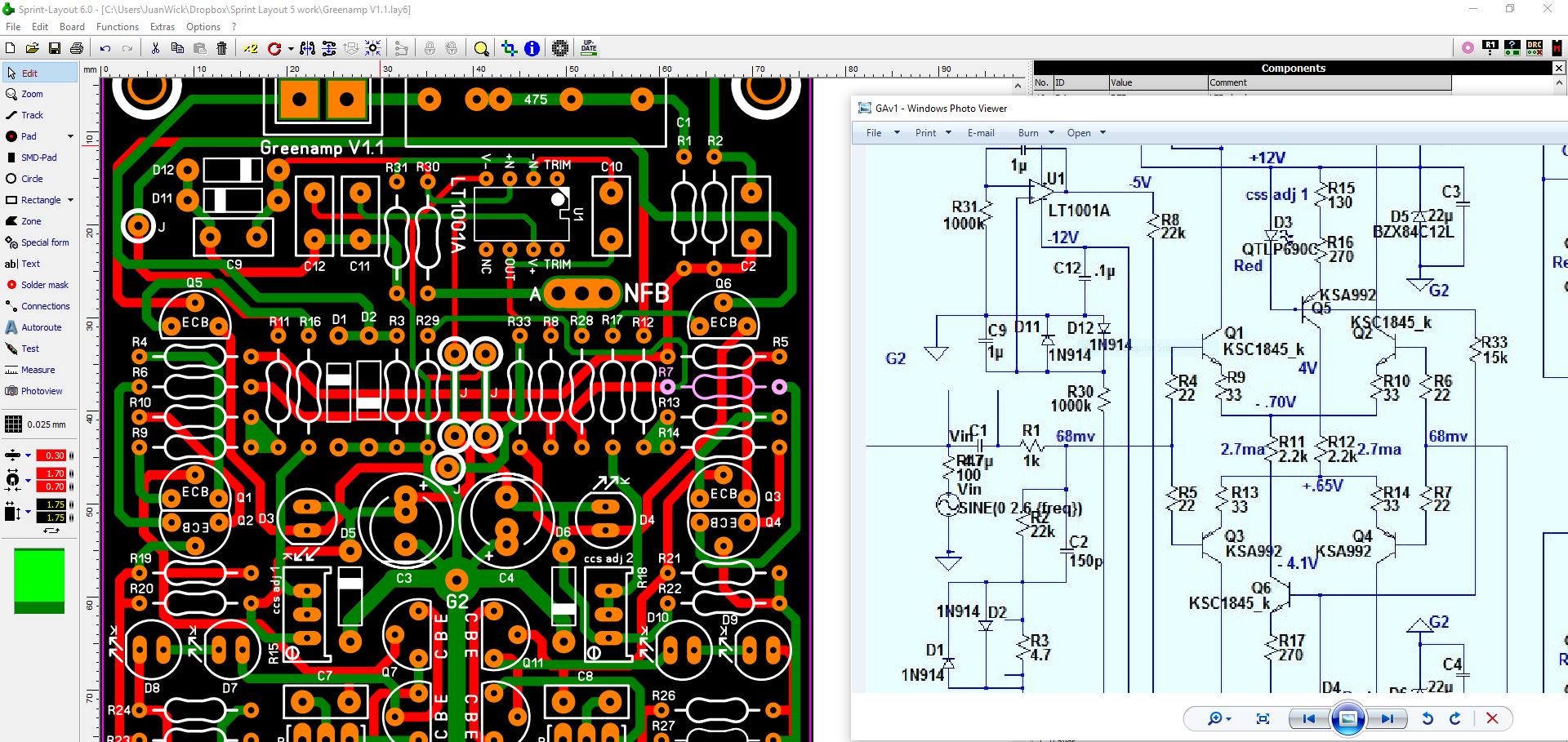

hello OS I decide to give a try to the new Greenamp V1.1 IPS I'm not done yet this is how it look for now 🙂

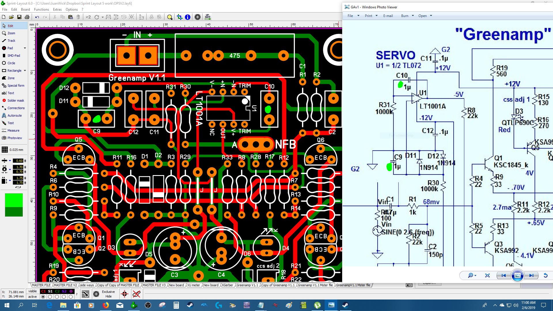

caps and connection question

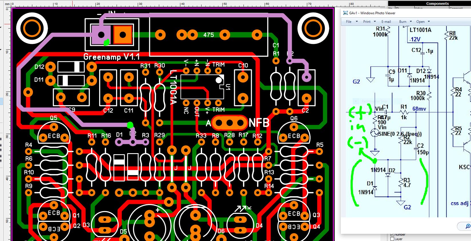

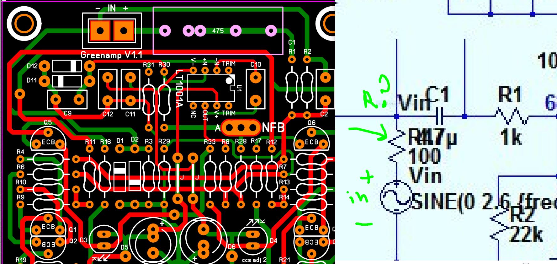

sorry I should add this other question on the last post OS, what is the resitor ID? I can't see what it is, also is this resistor need it on the circuit or it was just placed for analyzing the circuit with the sinewave ?
and lastly for the day is this connection correct of the audio input signal (+) and (-) placed correctly?
No need for that 100R , I sometimes use multiple sines with a mixer.
+ and - is correct.

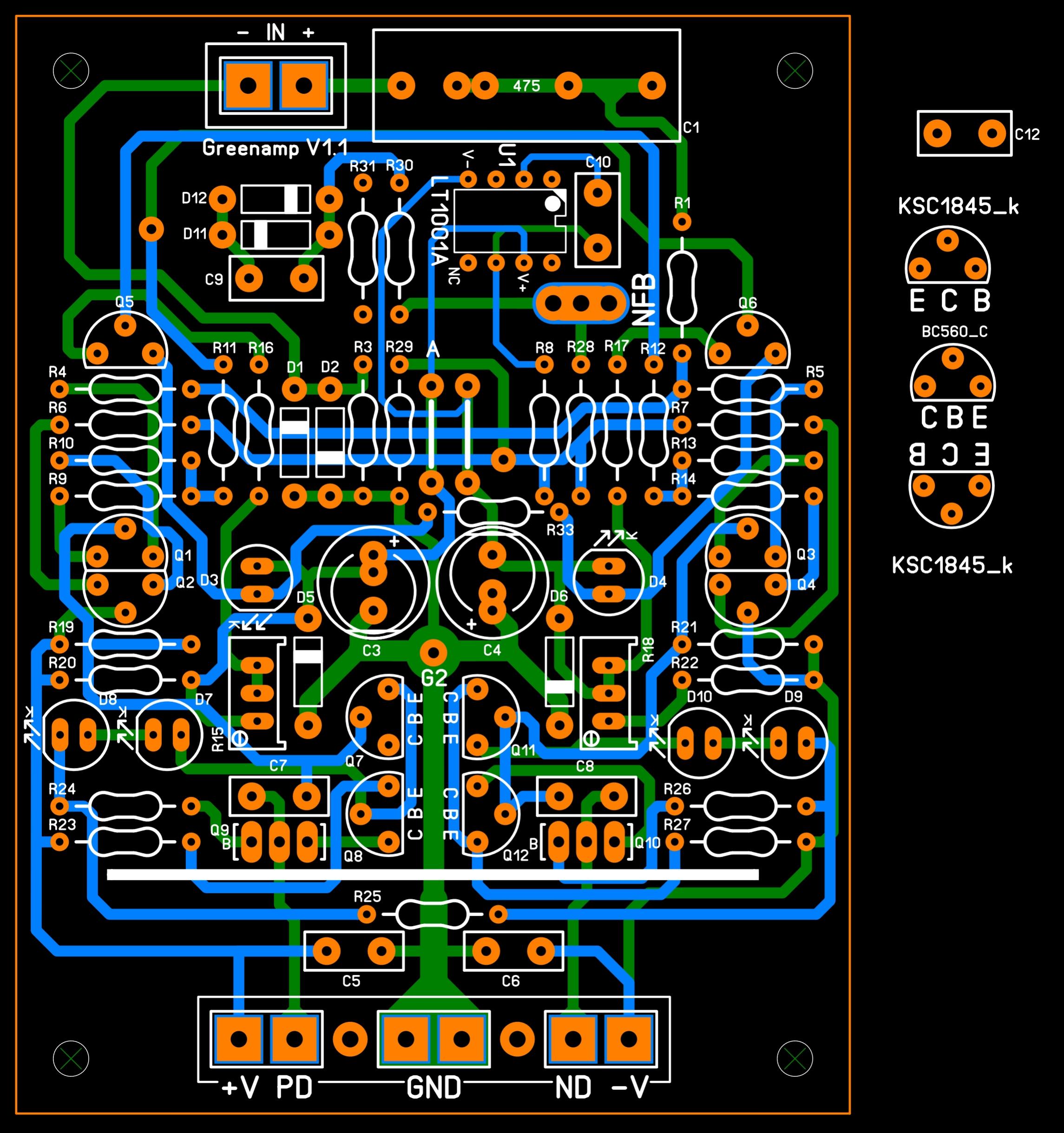

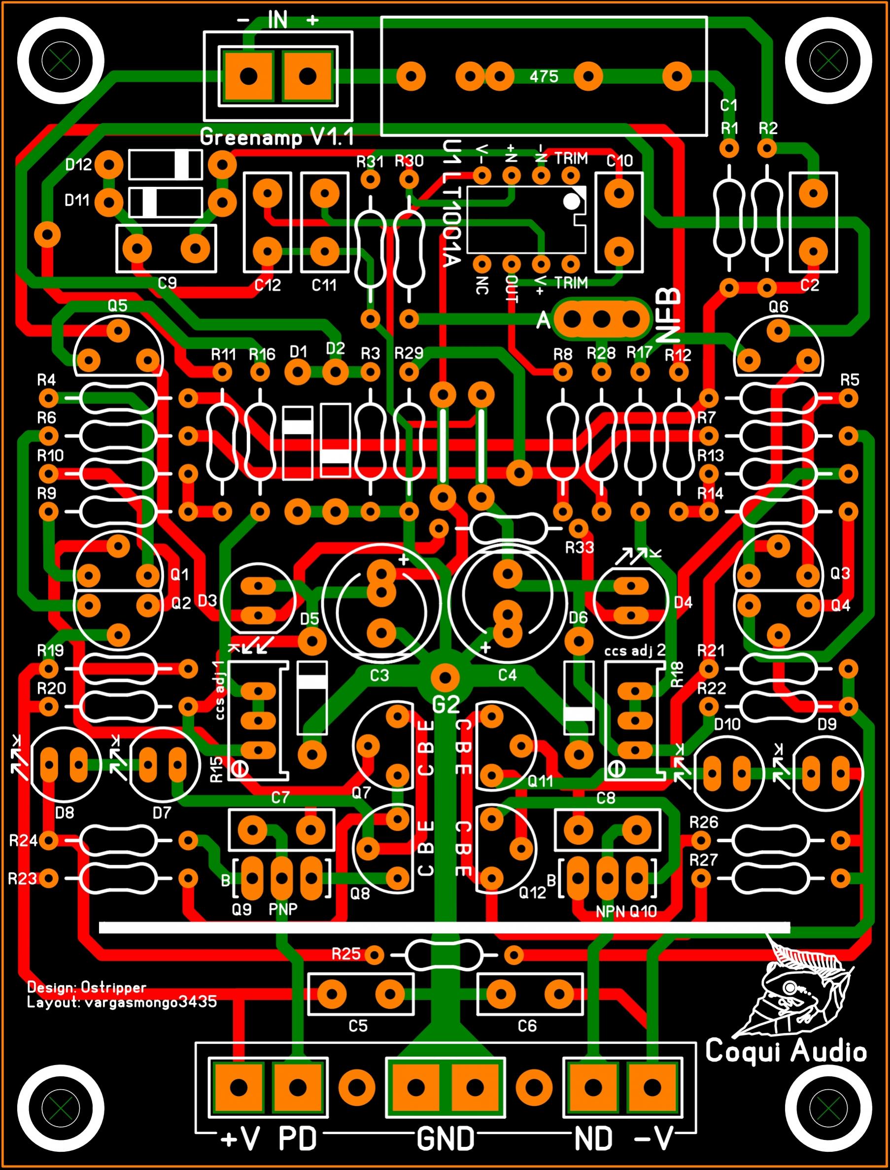

Should this layout and every thing "GreenAmp" related not be in the "GreenAmp ++ modulated Class G output" thread
U1-7(V+) seems to only go to C11?
Something this complicated should have synchronization between schematic and layout to make it much easier to check other stuff rather than wondering if the layout netlist matches the schematic netlist.
Seriously OS, home etching is coming to an end when we can get pcb's done in Asia for very little. yes you need proper gerber/drill data but that ain't so hard these days.
OK , with the greenamp/OPS combo I will get serious if and when it is first
perfected,built and tested.
As a final project it will be an "all in one" PCB with gerber ,netlist , BOM.
I threw the greenamp IPS to this slewmaster thread to let it be tested
on the known separate OPS here. Free testing and confirmation of the simulation.

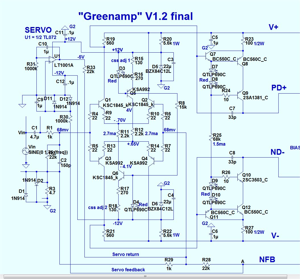

Hey , Vargas . I had no idea you would do a separate IPS of the greenamp.
It is absolutely slewmaster compatible.
(below) is the final. It should be close to your present work. Sorry for
letting you work on a unfinished design.
PS- R15 and R18 are 200 or 500R 10 turn trimmers. They adjust both LTP and VAS standing
current. 130R is for simulation purposes.

Hi Mr OS,
Very interesting IPS design. Would it be possible to label some of the different building blocks of the circuit so less experienced people can work through it. Things like the differential pair transistors. Current mirror. VAS current source etc.
