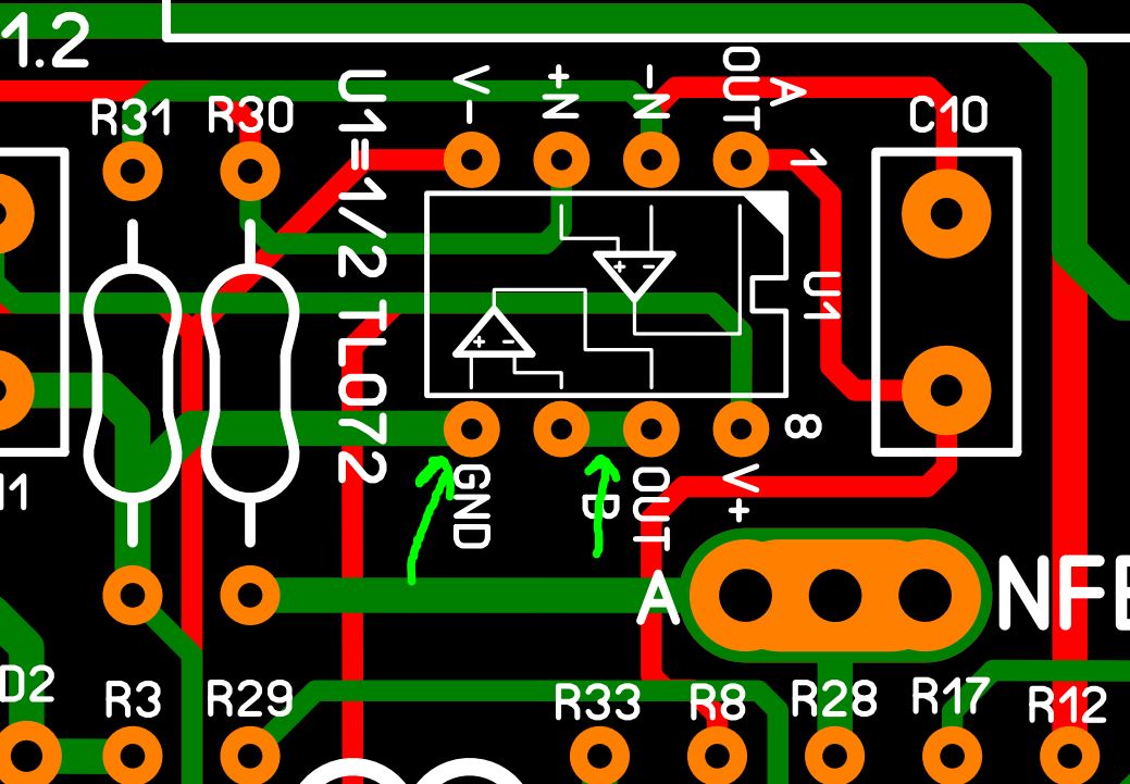

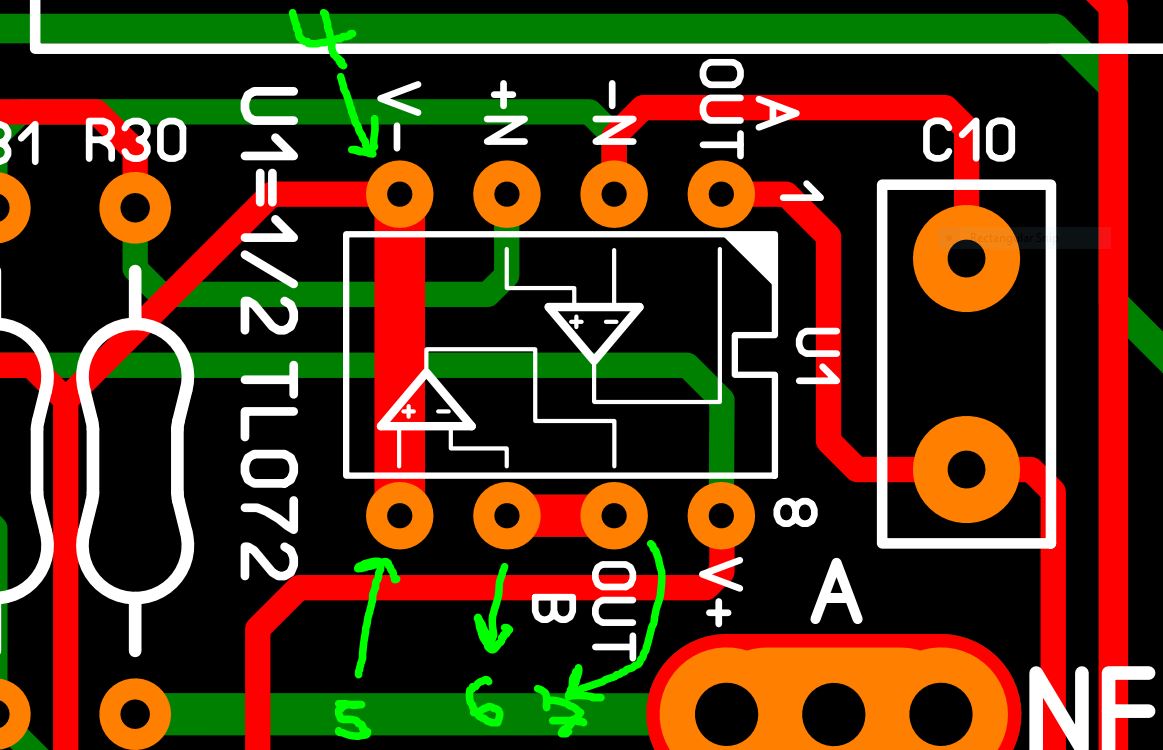

So all you need to do is connect the output of the second op-amp to the inverting input (-). You already have the non inverting (+) input connect to ground so that correct.
I sent you a picture.
servo connection revision
thank a lot so this is final should we wait for the other guys to comment about this connection? 🙂 just in case 😉 thanks again Mr. ST
Yes I have used this connection on my Soft start board. Its what you need to do.

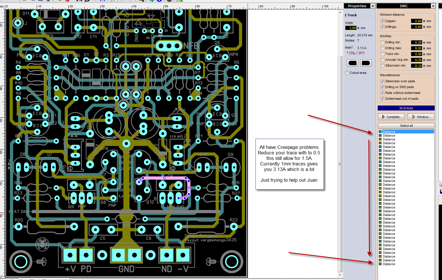

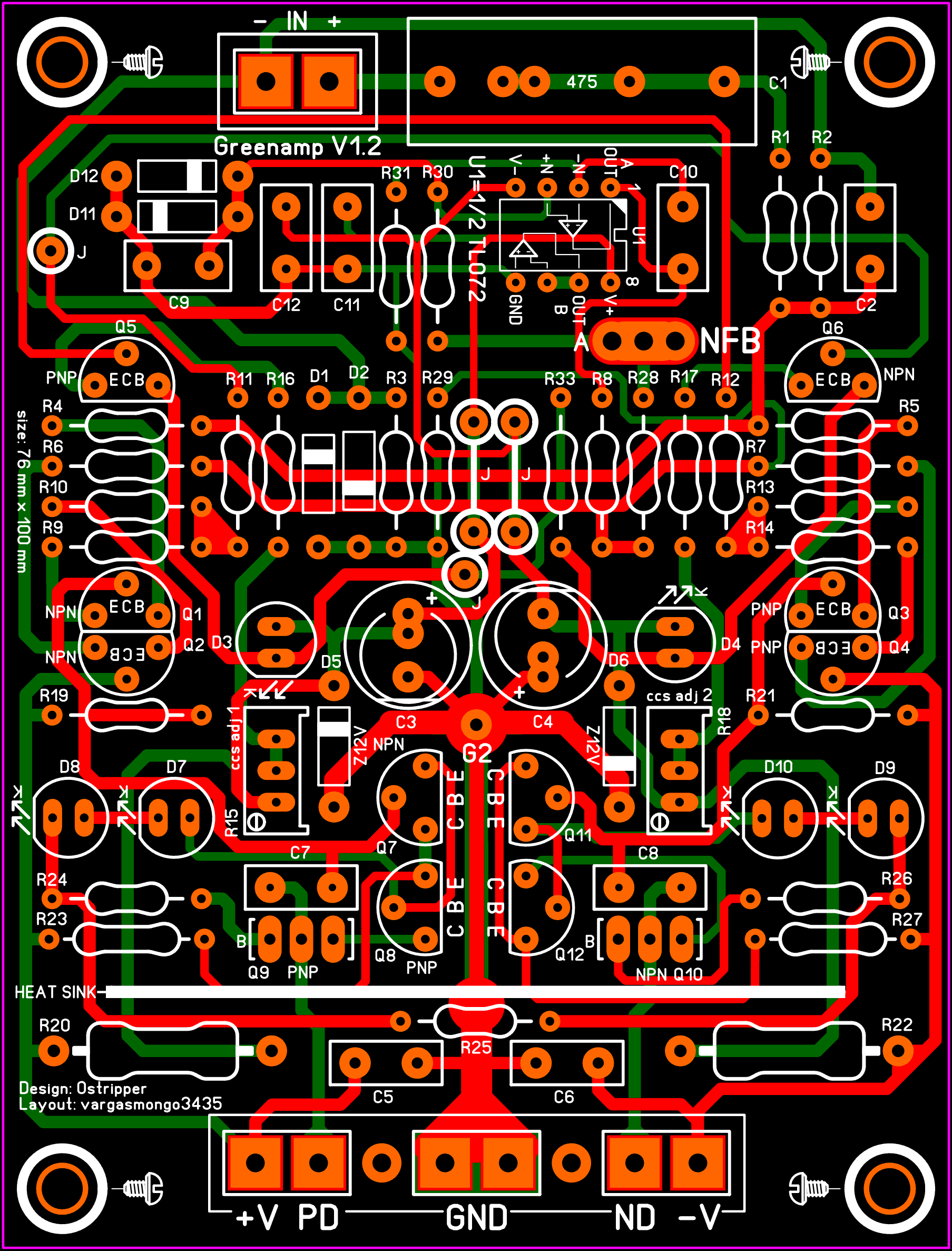

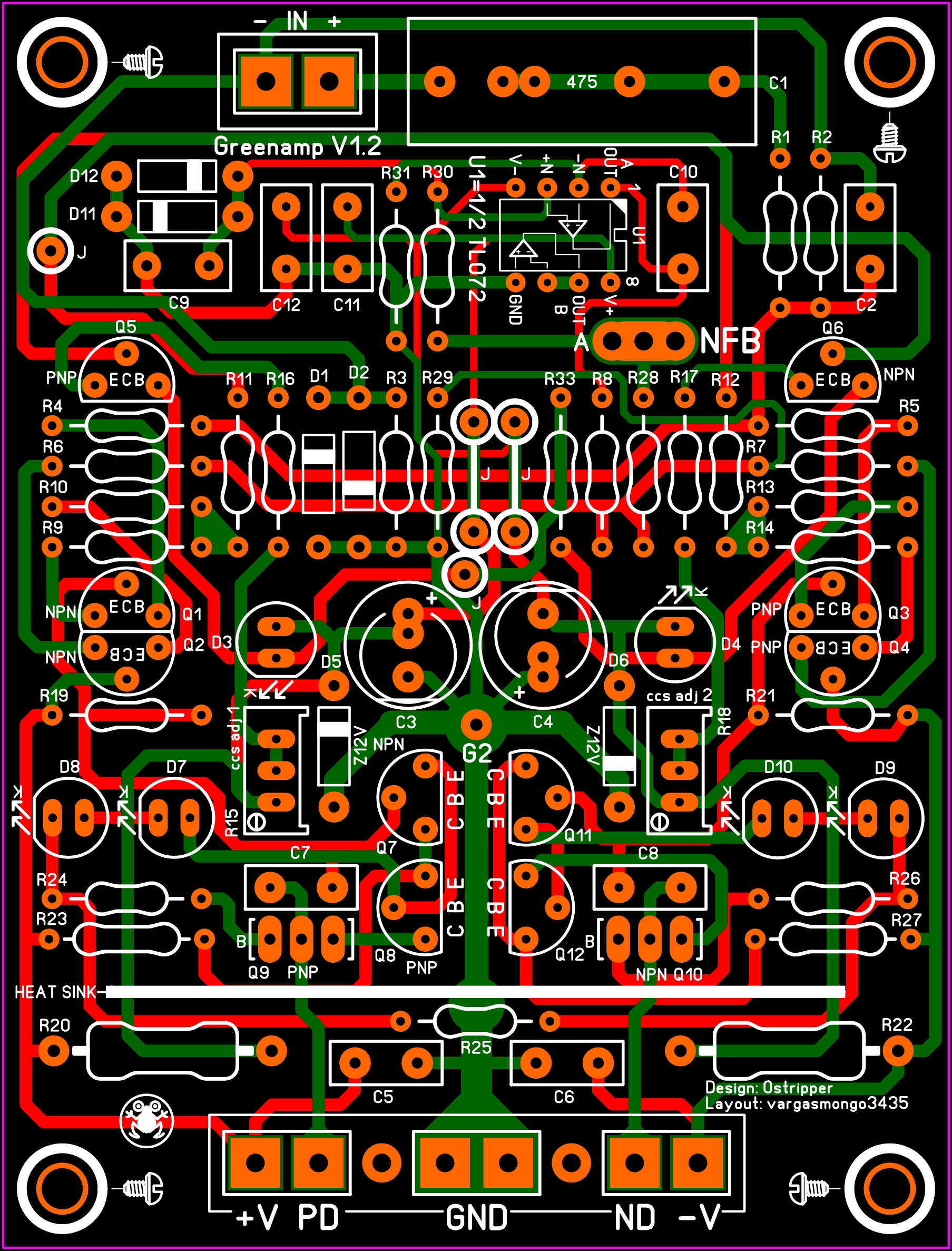

Maybe consider looking at your trace width and creepage as I found a few possible problems. But I did not check it against the multisim file.
But from experience you may able to reduce your trace width to get better creepage. See attache photo
good thinking ST
I'll see what I can do since I made the layout on a small area is gonna be dificult to use creepage rules I will try my best to adjusted the best I can no problem man 🙂

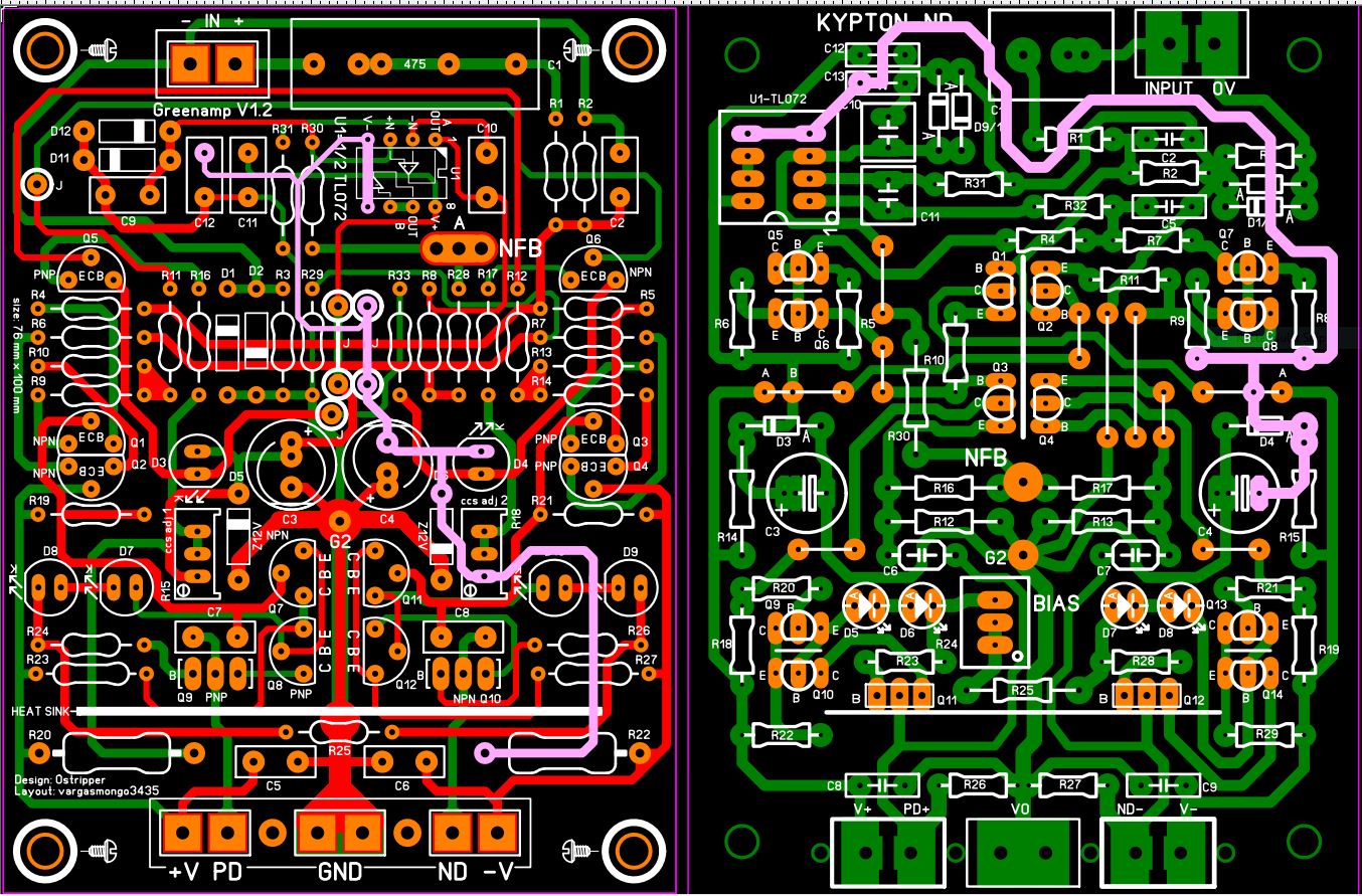

Pin 5 to ground, pins 6 and 7 together and the rest normally connected. Here are the pcbs of Kypton-ND and Kypton-V2
thanks maouna

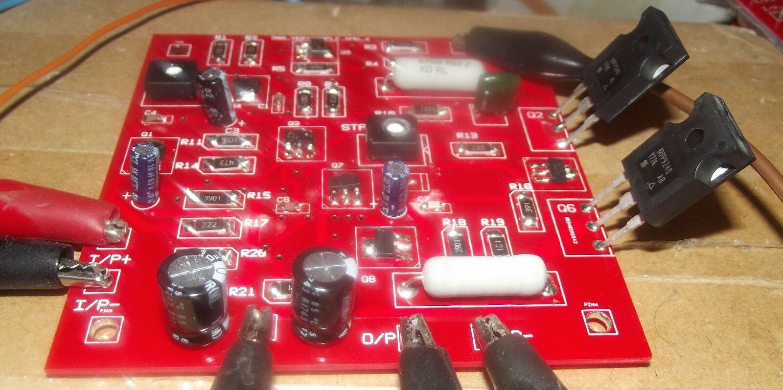

both channels working... bias 70mA OPS and 2,4mA IPS ... just sold my old scope, so I will make some measurement, after that I will received my new one...
so let´s put it to chasis

You do not have to use the second op-amp. I grounded the unused one
and set it as a buffer.
As a buffer doing nothing , IC uses about 7ma.
As a inline active buffer , IC uses about 12ma.
Adding the buffer does nothing to the servo filter Fc.
OS

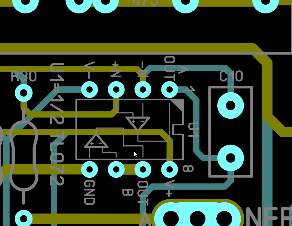

sorry OS about my confusion if servo use 1/2 of the TL072 I'm using pin 1 = A OUT pin 2 -N pin 3 +N pin 4 is V- and pin 8 is V+ as usual so having pin 5 to GND and pins 6 and 7 connected will not make any diference and it will work just fine? sorry for keep the same subject over and over I just want this to be sure

oh ok excellon ok, the 1/4W resistor have a pitch distance of 12 mm from pad to pad and I use only the Wolverine IPS board reference that jkuetemann made layout, the size is 76 mm x 100 mm and yes it was difficult but since I been doing this for about 5 years I got it this time even faster 🙂 good night is 12:59 AM time to sleep xD
Don't build my layout of the Greenamp V1.2
hello guys I still check the layout of the GreenampV1.2 please don't build it till I see all is correct I eventually order a few PCB to tested first I don't have a scope but at least put it together and tested with audio files so please don't build it, and I know that I post the sprint files here on this section for just revision only, Mr. OS most be really occupied doing the G-amp? I forgot, so I really don't want to bother him so he be concentrated on that, the layout I'm making is on me if I screw it up that be me no you guys so I'm gonna order and test it then I will let you know the result good or bad that be me if I made a mistake on the layout

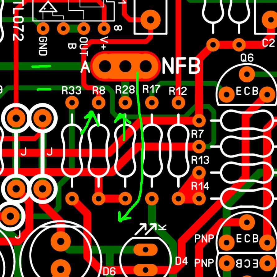

If you look at post 10081 , the kypton's .... You see that I kept NFB away from any low level input. After the huge NFB waveform is reduced to a small one by either the 1M servo resistor or the 27-33k feedback resistor , it is ok to "mingle" with other small signals. Just something to consider. Look the layouts of my IPS's over , method to the madness.

NFB placement
I will take a look OS thanks, is that bad where a place the NFB faston terminal?, ok ok let me check post 10081, after check, I see what you mean the NFB faston or pad is preatty far away from the input I think I might be able to move down I hope so

hello this is the last post about the servo U1 connections I found the layout of the Kypton - ND for what I understand pin 5 goes to pin 4 and 6 and 7 are going to be connected together is this correct? see image of the Greenamp V1.2 and Kypton - ND 🙂 I think my English is not clear 😀
