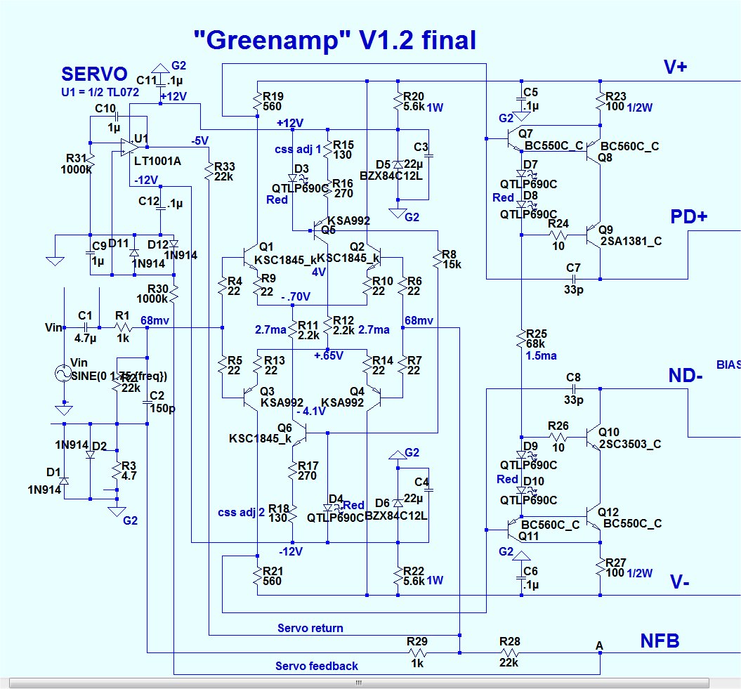

Can you post the updated .asc file V1.2?

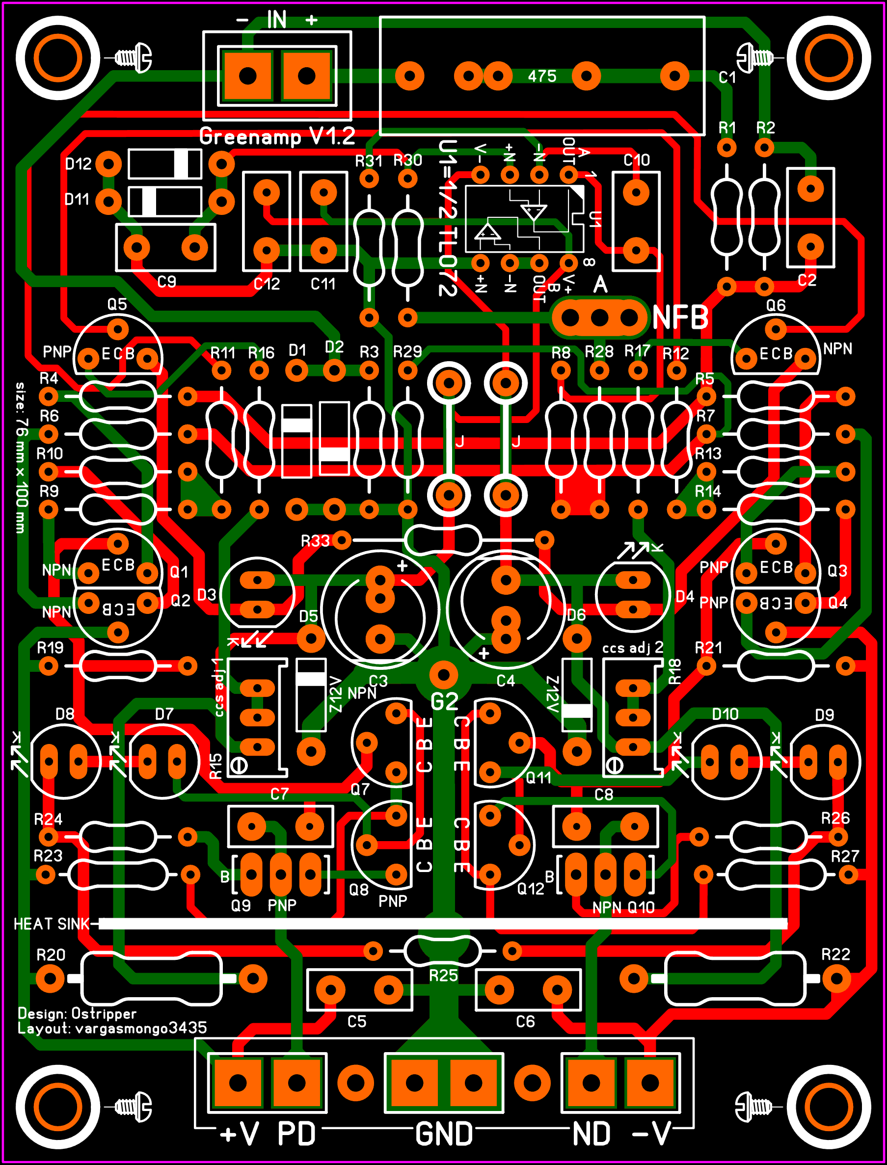

ugly jumper be gone!

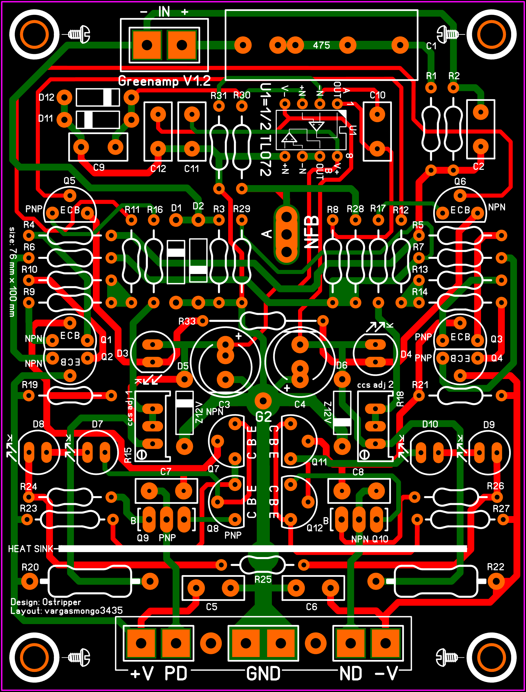

hello guys man finally I was able to remove those ugly pads that I was thinking that they be ok but no enough for me I stay on it till a figure it out on how to remove them yes sir 🙂

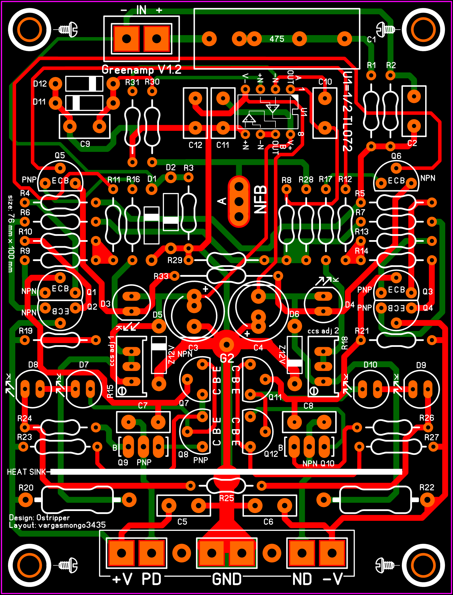

C11,12 could be moved right beside the power pins of U1. The rule of supply filtering is to have the feed go to the cap then a very short trace/stub, on the same layer(smt), to the device power pins. TL074 are pretty forgiving, so your placement would work, a faster opamp might have issues. this is an integrator, so it has lots of AC feedback.

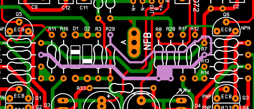

While you are at it, rotate R29, 90 degree CW, put above R33, shortens that trace from R7, will have to move parts above up some, but I see room 🙂
TO-92 footprint could be all pins in straight line, 100 mil lead spacing since these parts come on paper tape with that lead forming i.e KSC1845FTA, BC560CTA
The U1 wiring looks to be correct.

Well done, have a cold beer or smoke, I am having a tea and a smoke 🙂
maybe tomorrow you can generate gerber/drill I can look at it better.
