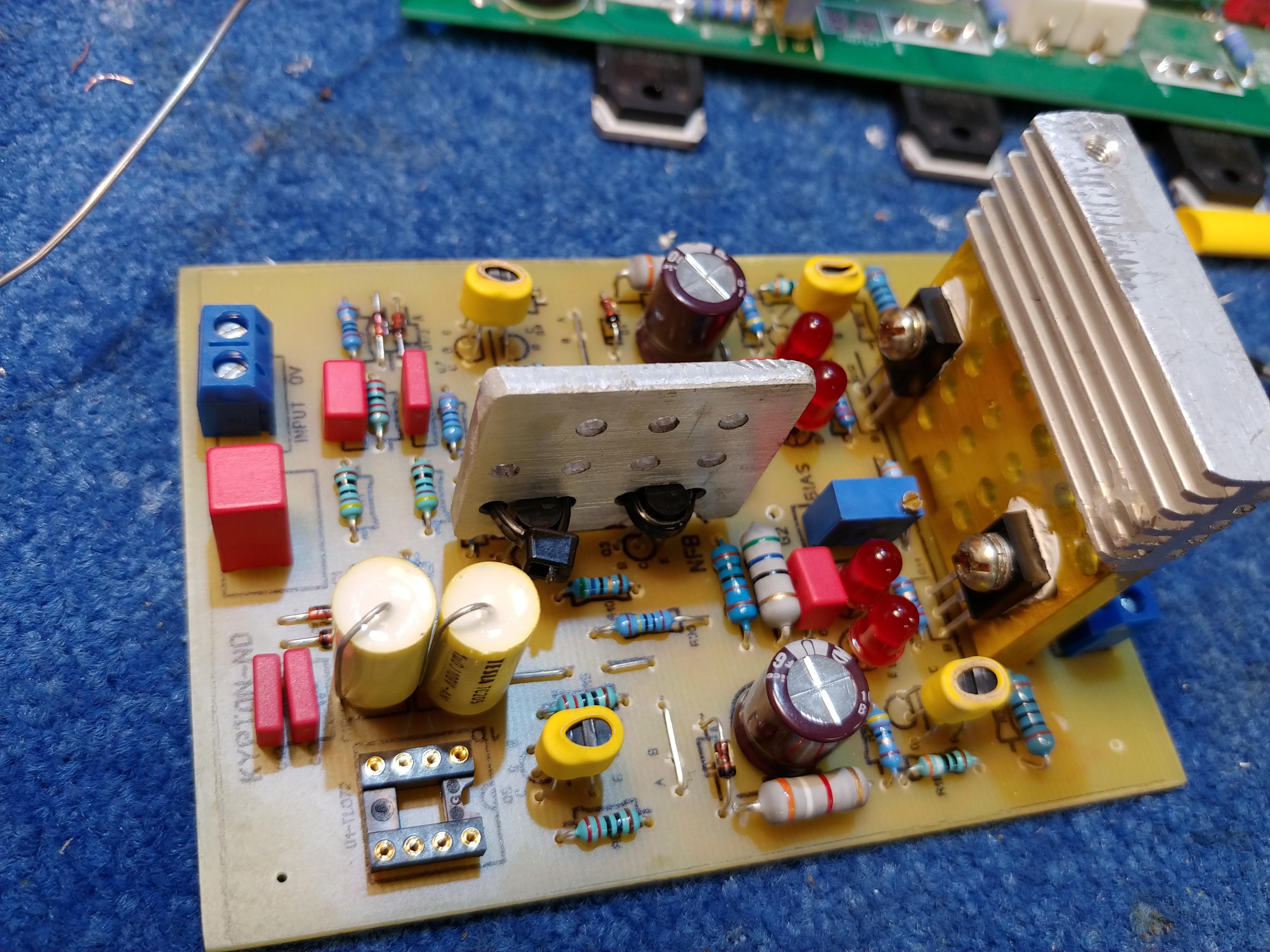

Problem solved...second chanel working well...my mistake with TL...

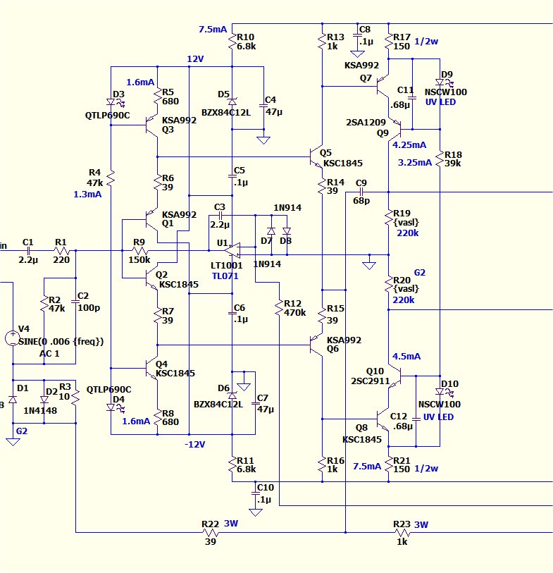

Nice , yours is the 3rd build of this topology.
BTW , my new "greenamp" is similar to this IPS.
It uses the "spooky" input with the kypton VAS (below).
PPM + it can clip all day (self clamping VAS).
Offset is servo'ed with current mirror/source feedback.
It is a unique design.
Thanks for building another.

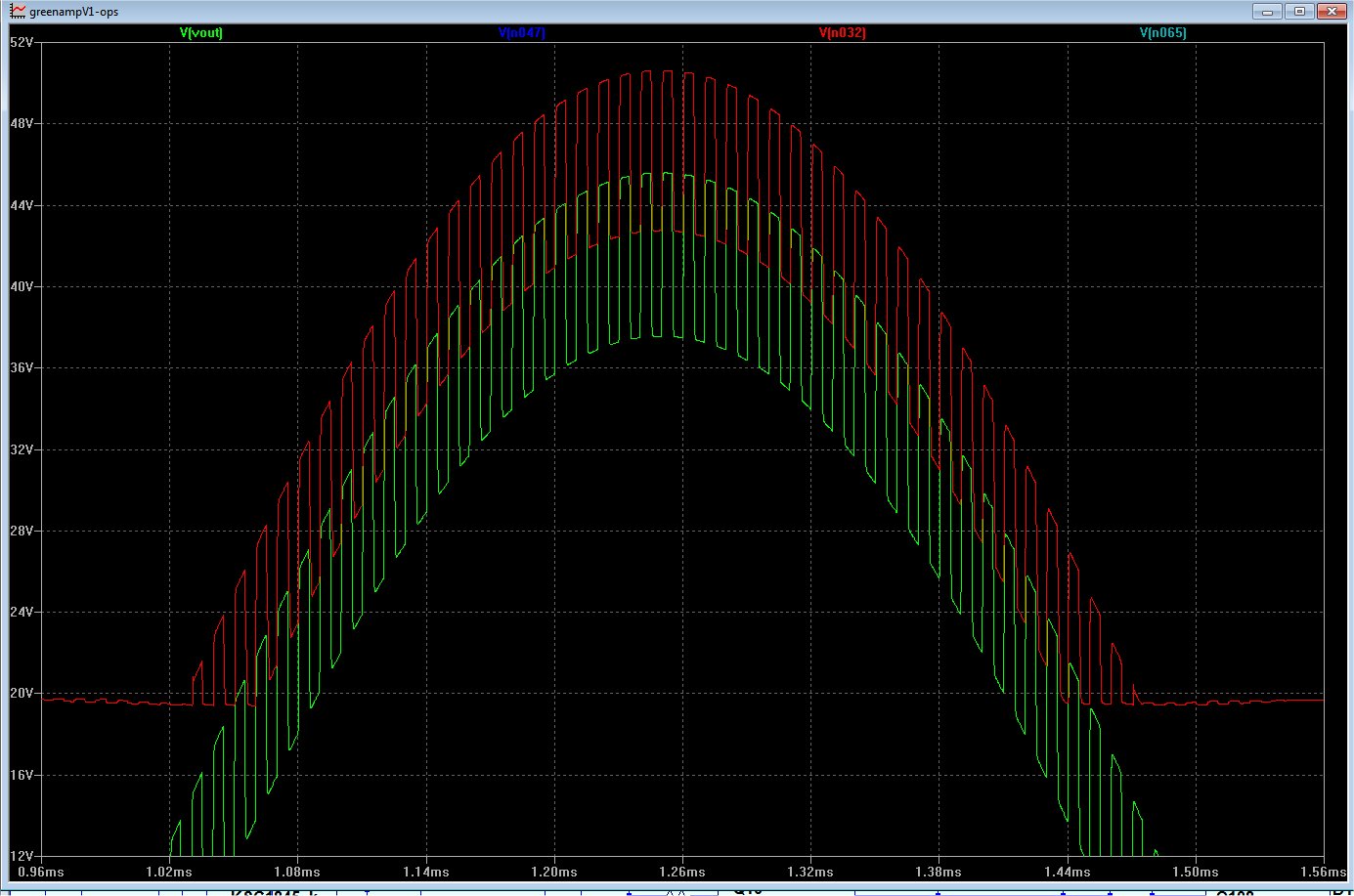

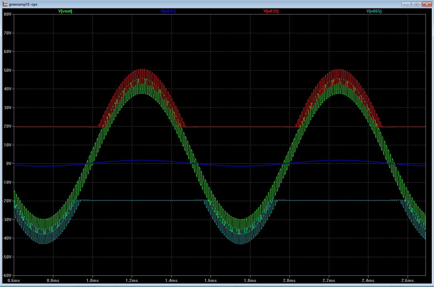

Not yet , very close.
Greenamp uses special output stages - modulated class G (.
4 devices , 2 active will give 200/400w
8 devices will give 400/700w. All on a 100w amp heatsink.
With half the power supply size.

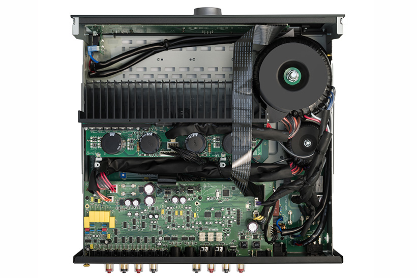

You do need two supplies. The arcam (at 200+ watts - below) has
the little trafo for it's +/- 30V supplies. And a big 70-0-70V.
(Below 2/3) is my faster ,simpler, cleaner class G with 200khz square
waves on a 1k carrier.
Just testing the carrier , it is still at 10ppm despite the rail following of the
HF square wave.
"Greenamp" thread is where this new tech is.

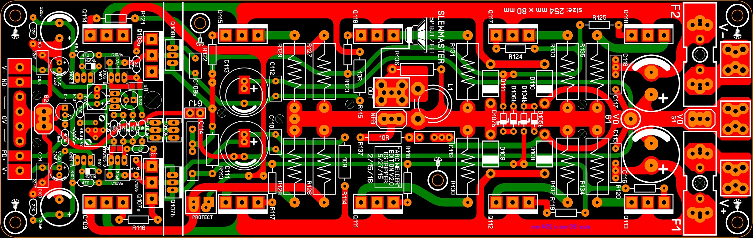

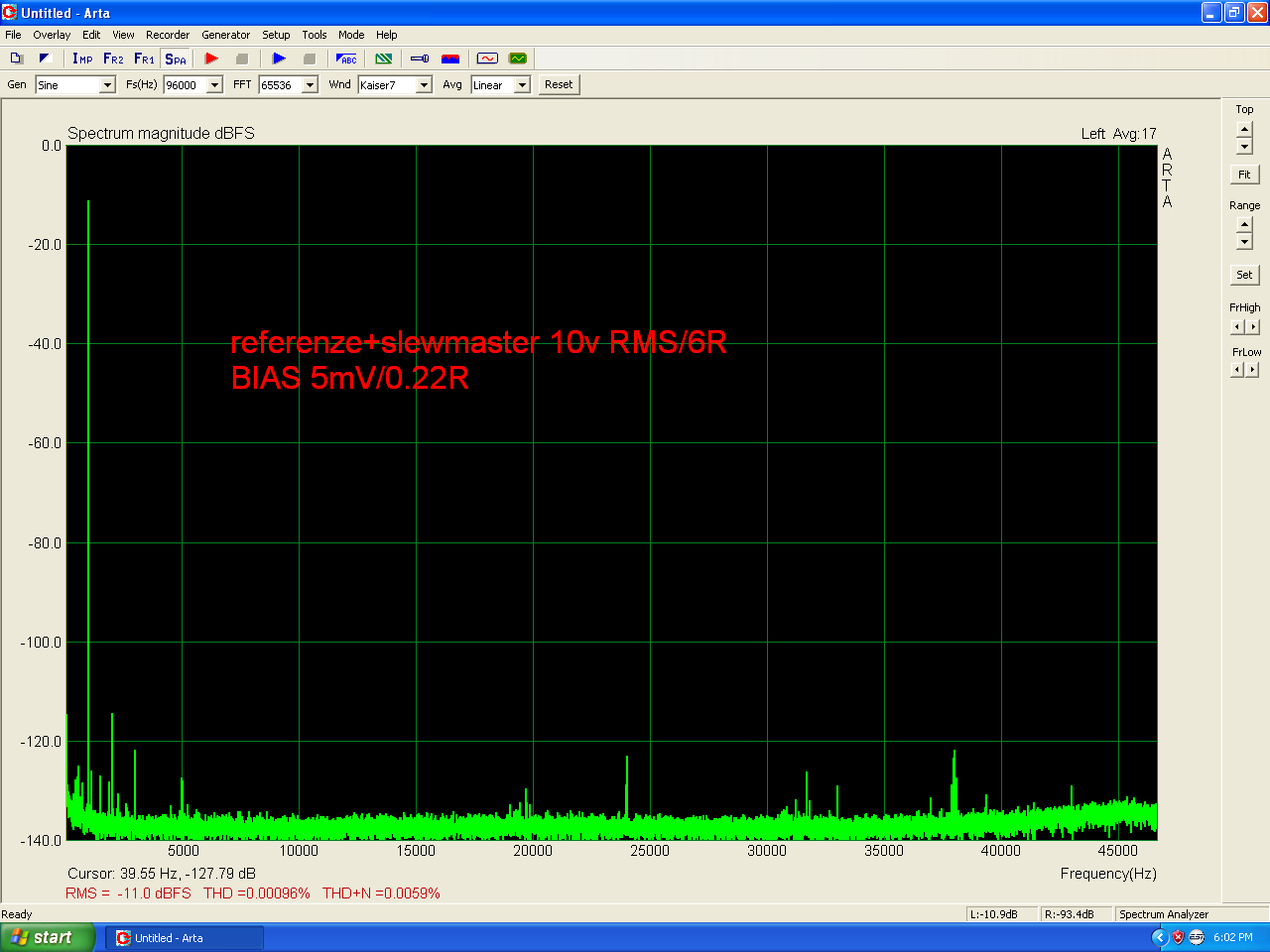

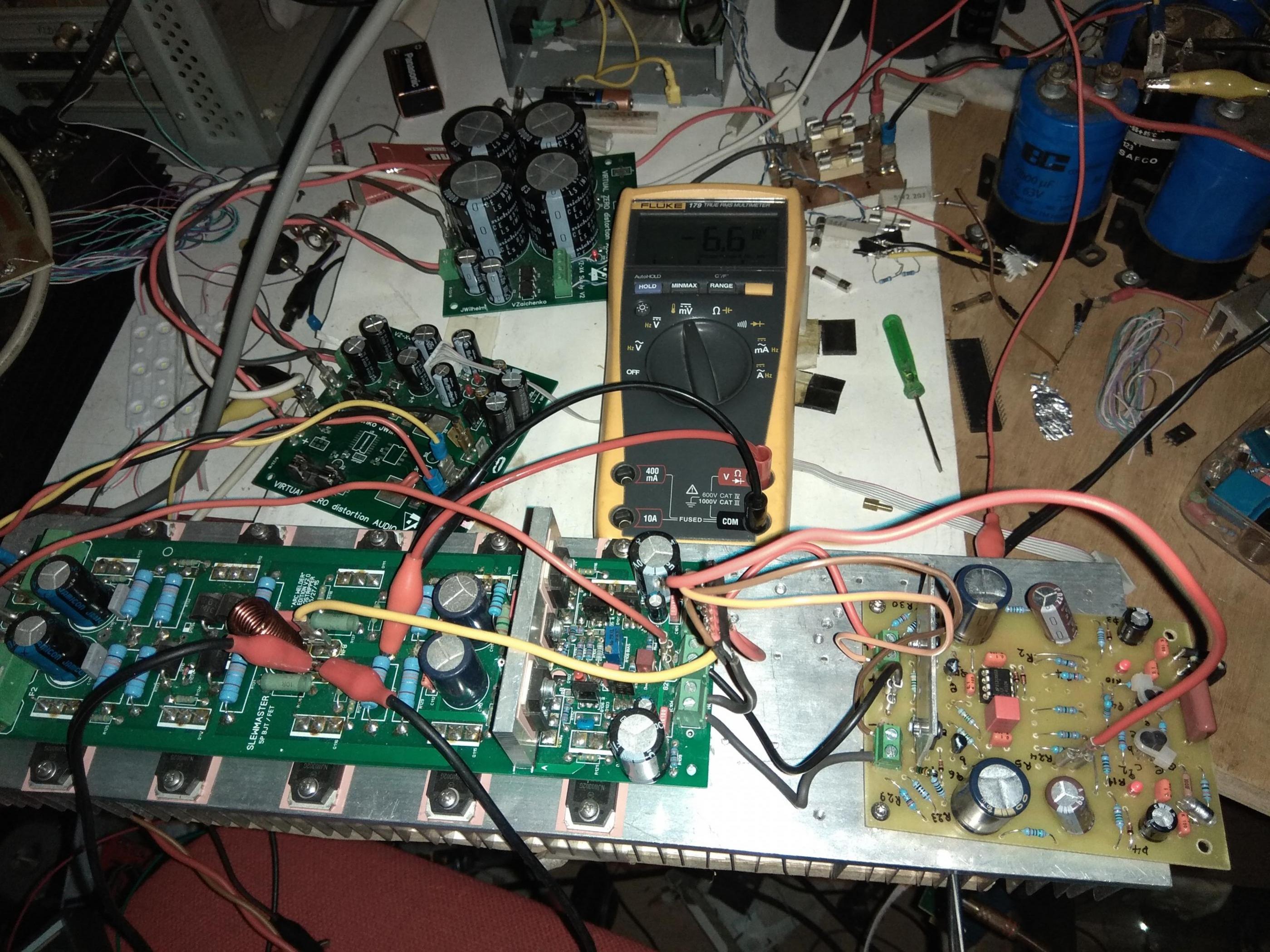

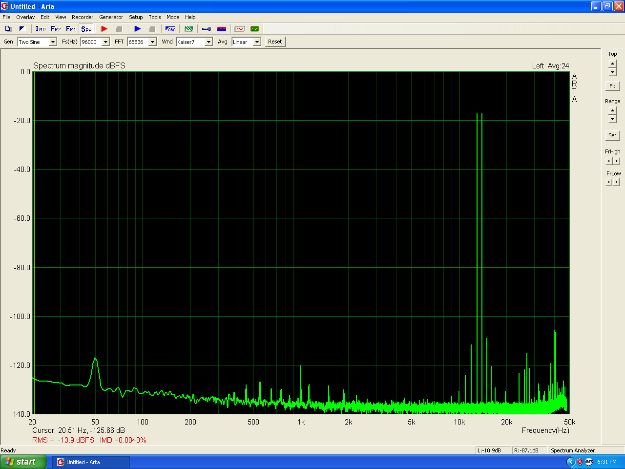

Valery referenze+Ostriber Slewmaster

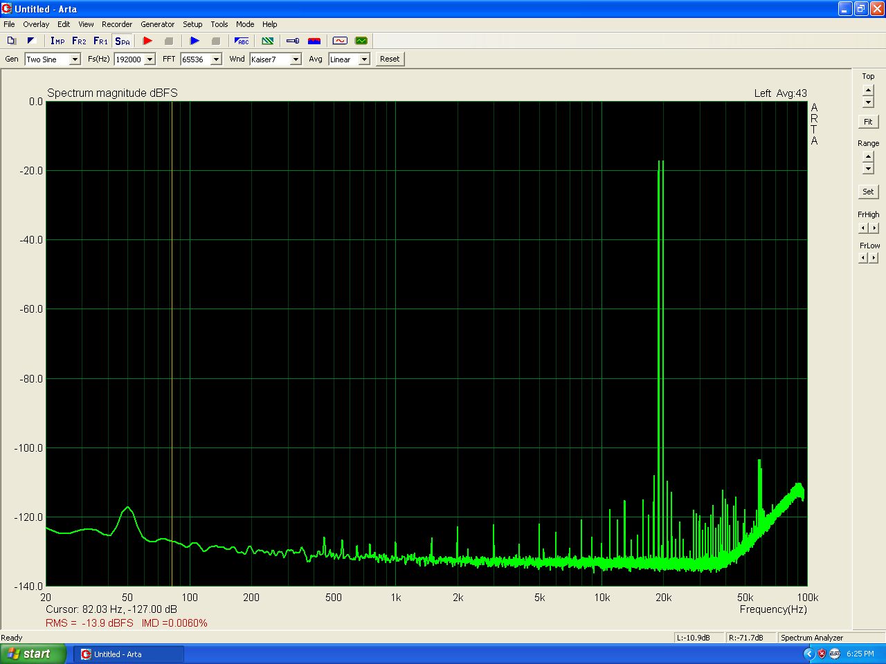

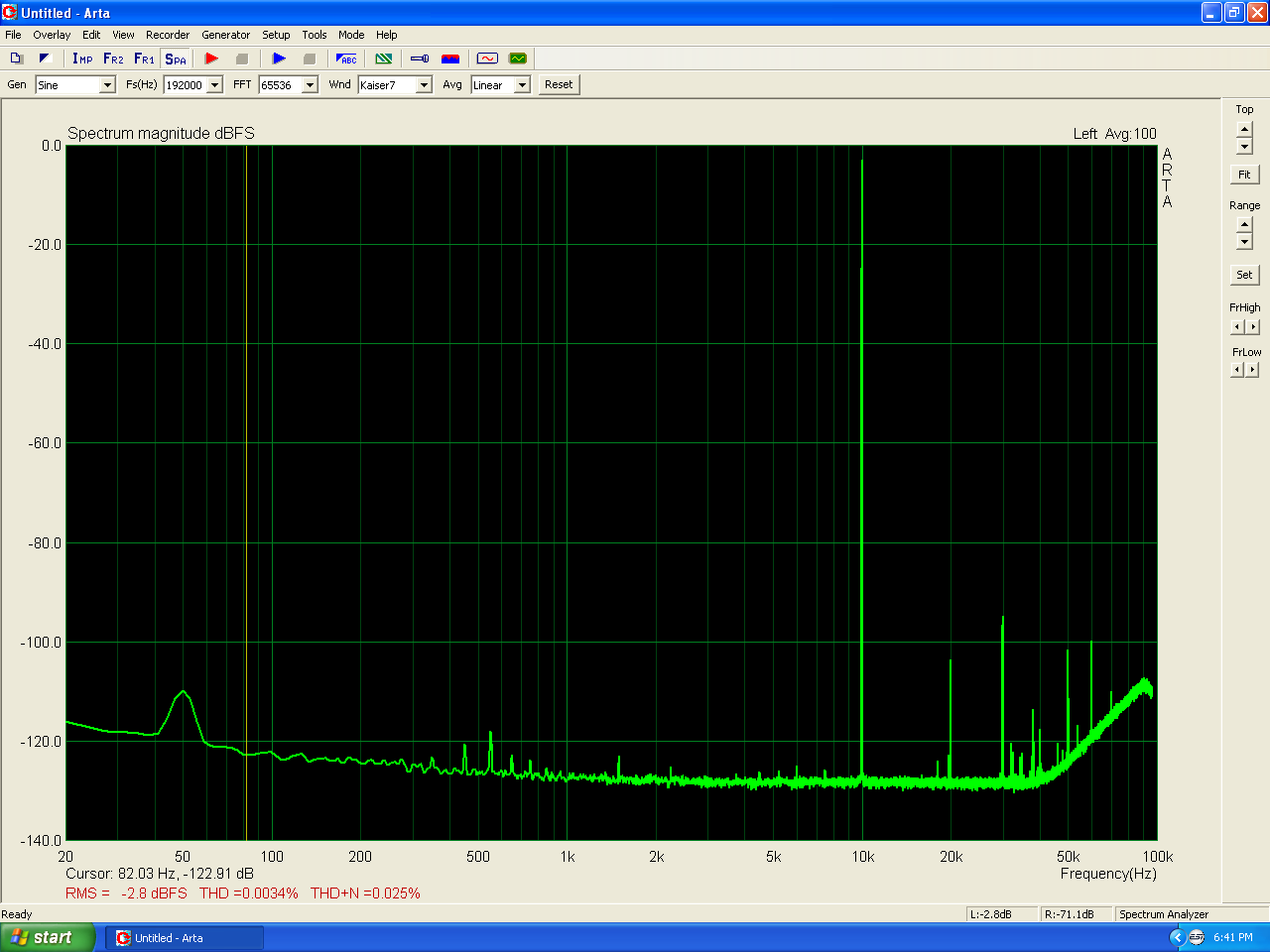

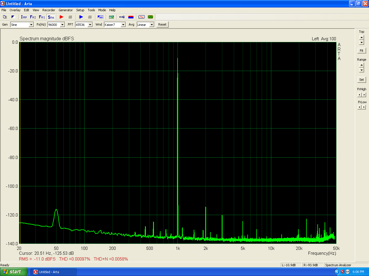

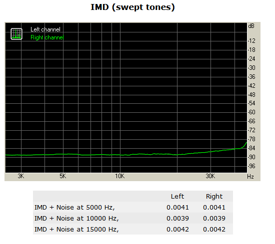

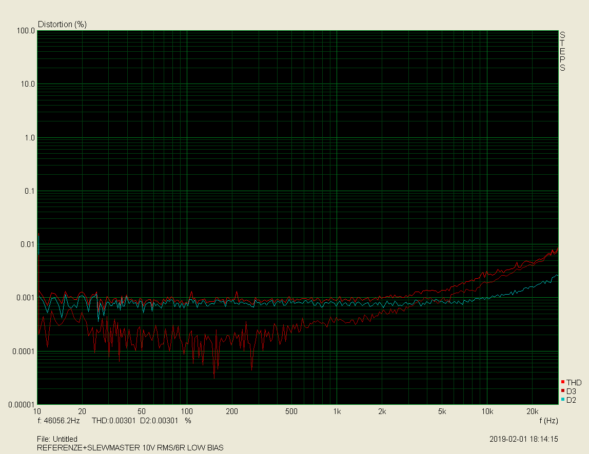

Testing an IPS by Valery using an OPS by Pete (well known as Slewmaster).

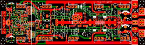

Nice , some of them slew ops"s are still around.
Maybe I will make separates for the "green ops".
It seems to outperform a 5 pair slew with just 2 active pairs.
A true test of whether the class G non-switching is good would
be a "thimios test" 😀.
OS
OS

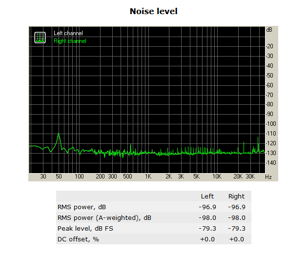

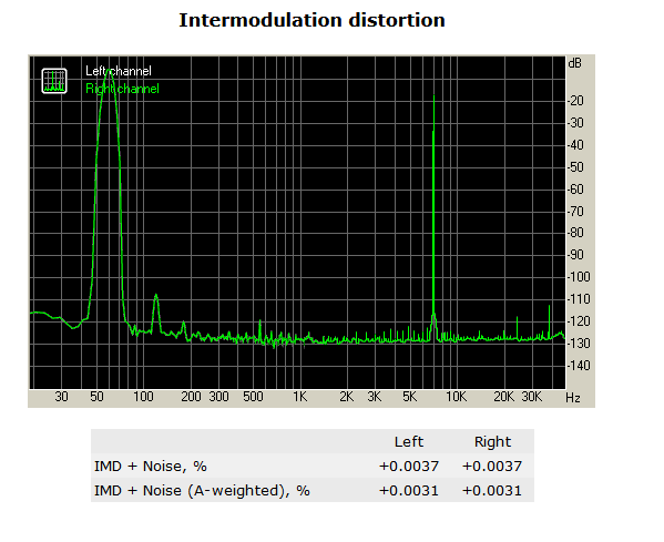

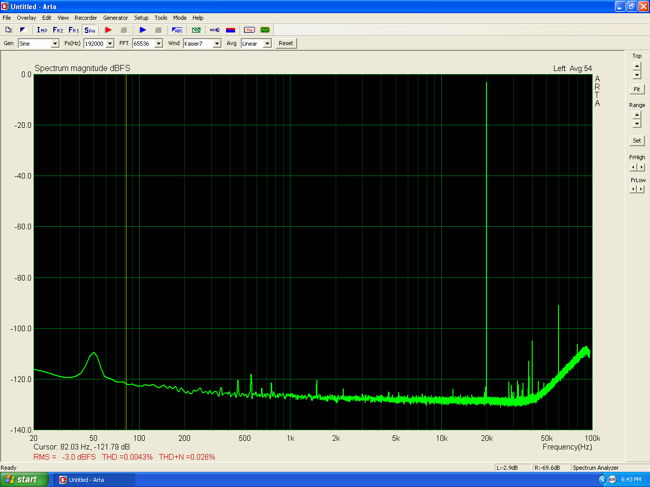

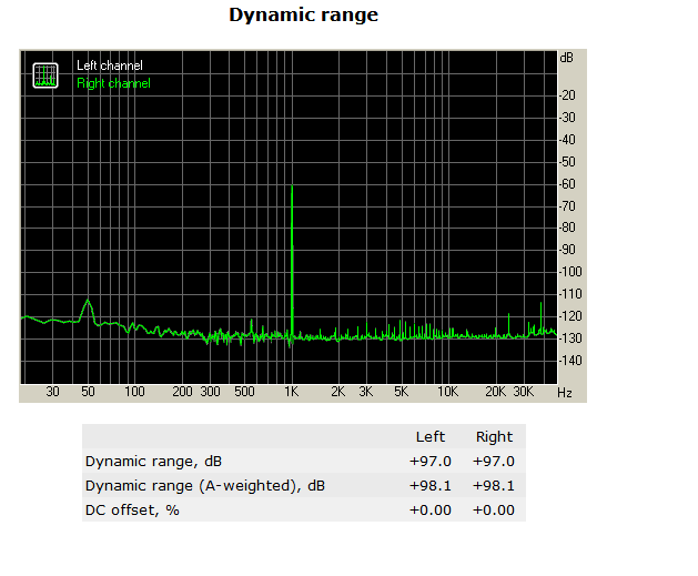

Real test against simulations. 😉
RMAA
Hello folks, nice work thimios, thanks for sharing.
What IPS design is that?
Referenz - high-quality low-cost diy-friendly amplifier
Look here, is an IPS by Valery.
Now is tested in combination with Non-Switching and with the Slewmaster.
No , thimios. Remember post #105 of this thread. (below).
Referenz = (below) ... minus the Hawksford.
positive servo fb + red led ccs.
I think you built it. So , you build it again. 🙄
